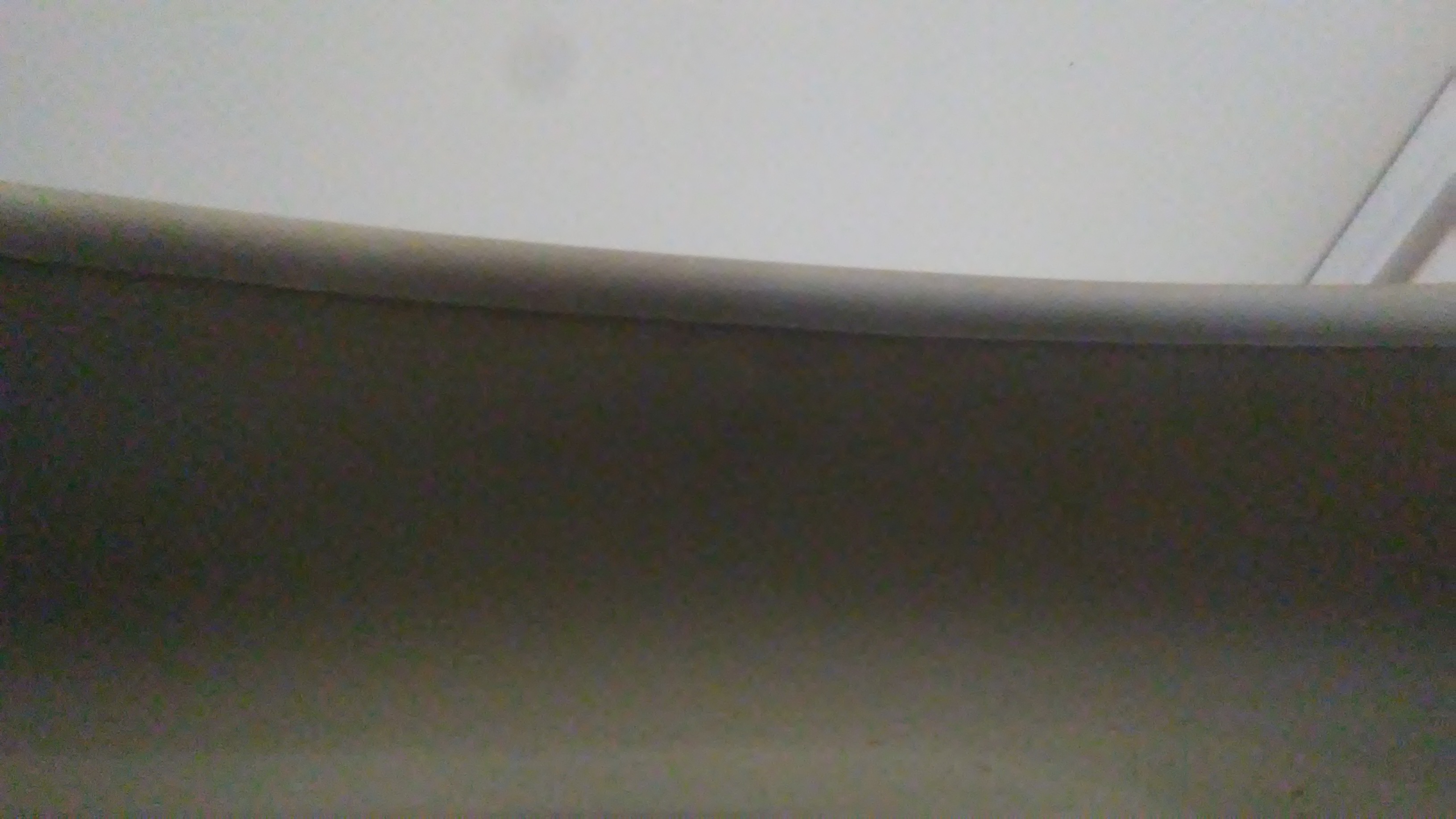

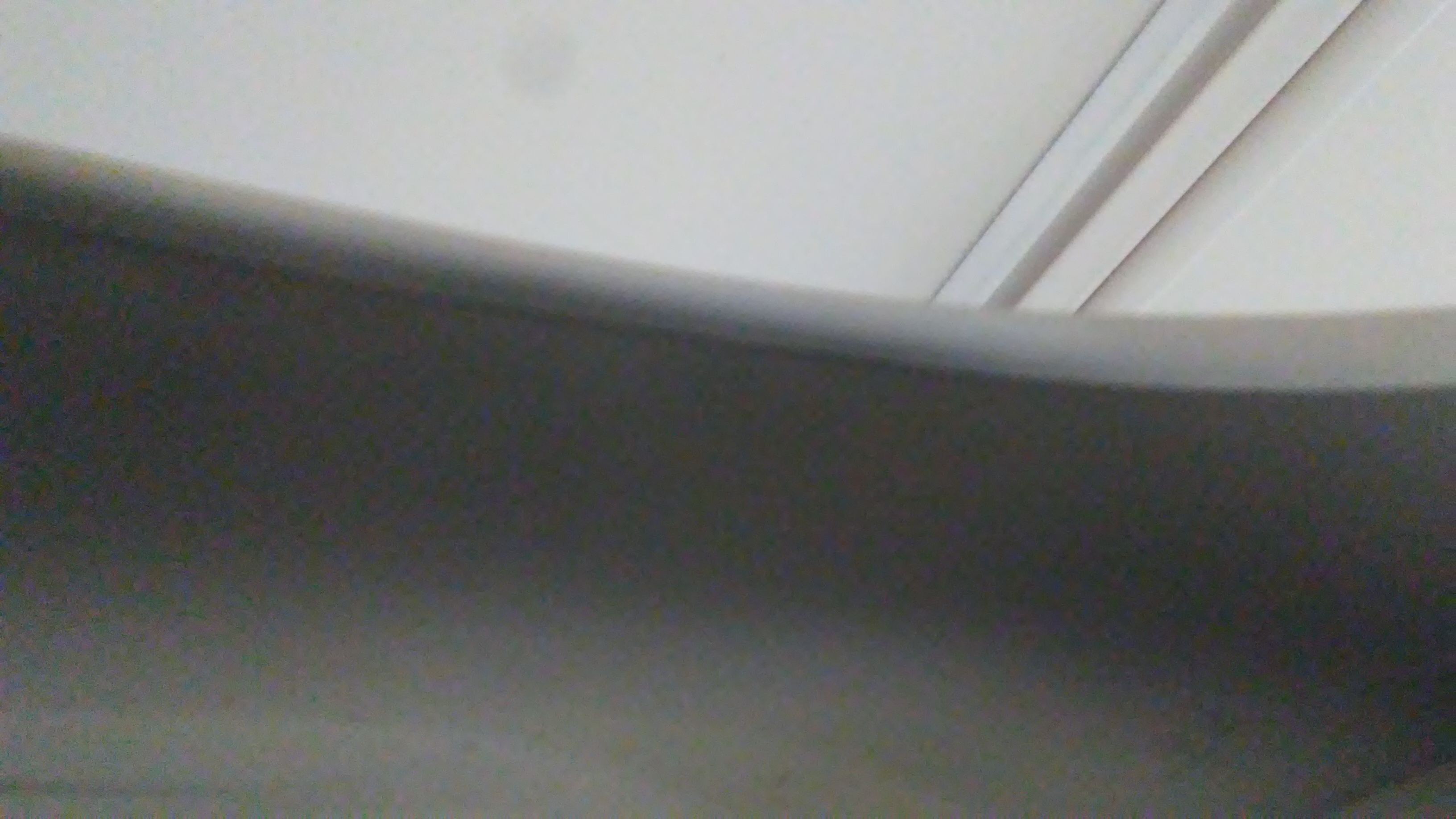

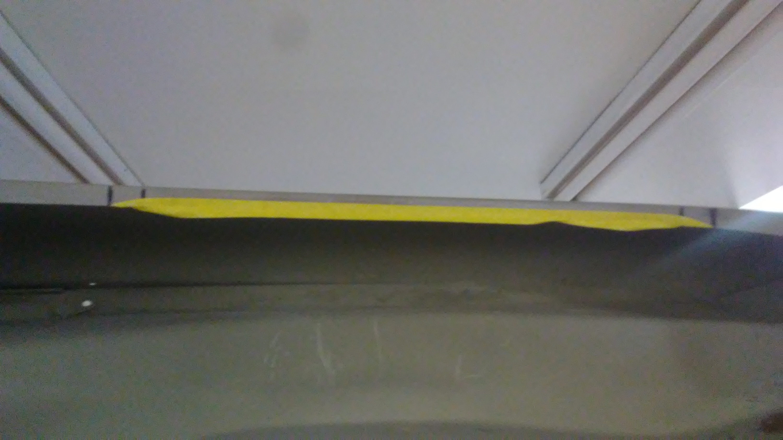

Pic.

QUOTE(Cairo94507 @ Oct 18 2017, 07:26 AM) *
Timothy_nd28 - If it comes off in one piece, you can have it for the shipping. However, I believe it will not come off well or in one piece. (IMG:style_emoticons/default/sawzall-smiley.gif)
One of the reasons we are replacing the nose on the car is it is creating issues with the whole front end and panel alignment. Evaluating it, we decided it would be easier to replace it rather than trying to remove and re-install it. Stay tuned for pictures of that in the near future once Kent has the new panel in his hands. To be honest, I am really excited to see this front end get buttoned down and finished.
Correct me if Im wrong, but the /6 front panel has different depressions in some areas. I dont know how nitpicky you are getting, but here is the correct depressions on a /6 front latch.
Pete

Really? I would be a bit surprised if there was a special nose panel for the Sixes. No reason for there to be really. I am sure the one I bought is just a new NOS panel for an early car. I hope someone can confirm this special detail.
I had never heard of a difference either but I do t have a real 6 to check

SocalAndy's car hard to see.

That's a bumper tit front panel ,,,close but not it....73/74,,,

No special panel for -6,,, 70-72 is what you need

OK, correction. There is not a /6 specific front latch panel, but one for the 70-72 chassis.

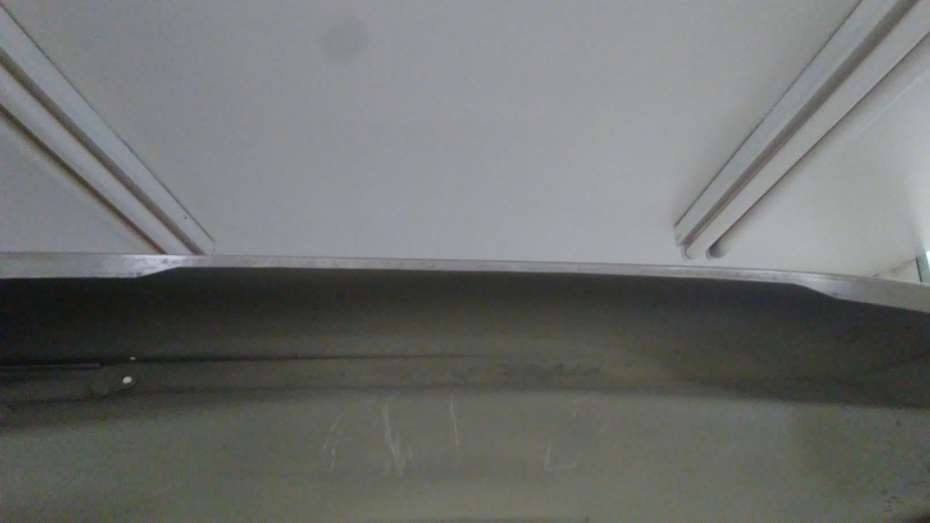

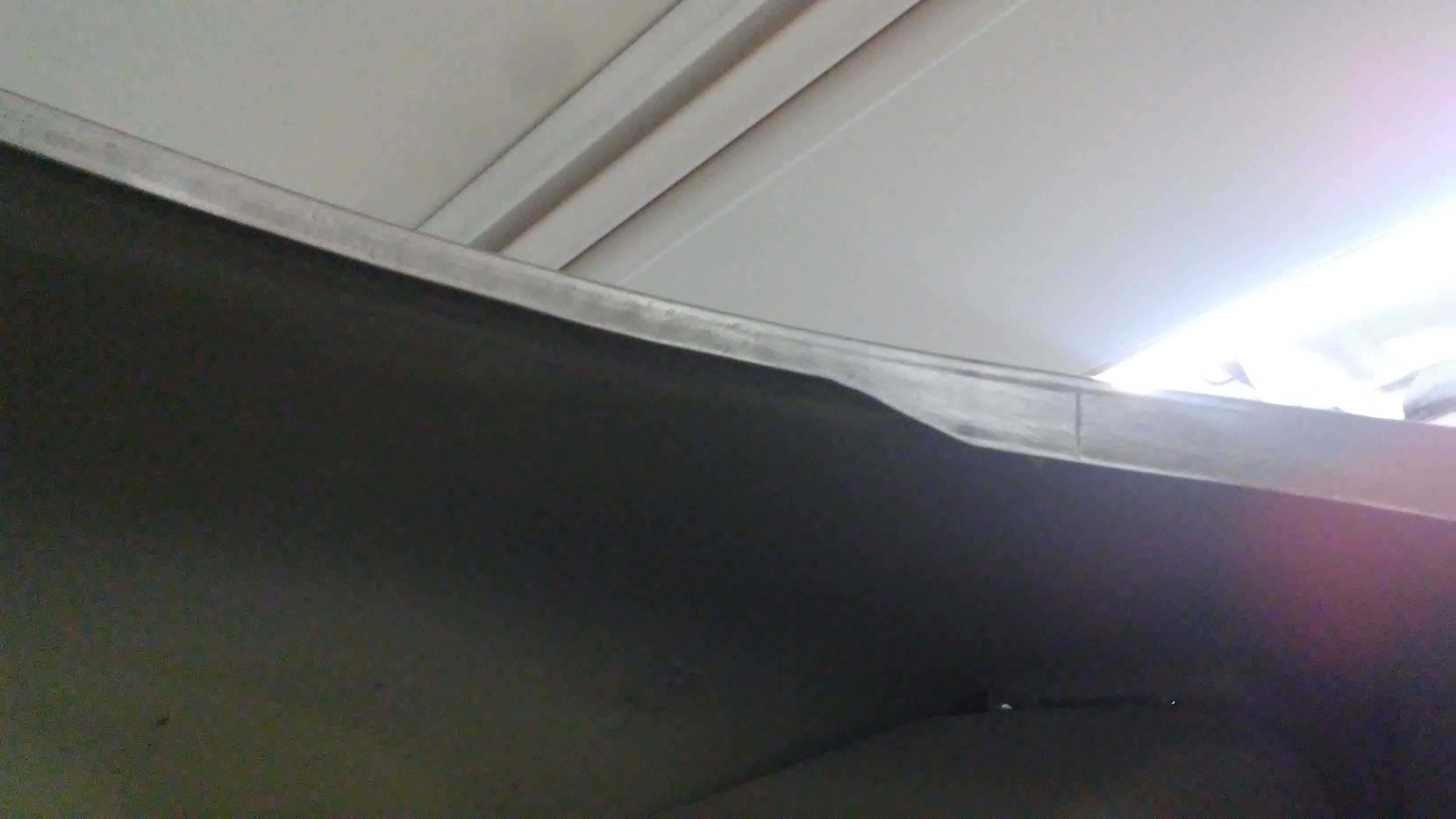

Q.P. was replaced and lip was rolled by a P.O.
914350
post Oct 18 2017, 09:43 PM
Post #198
Posts: 548
Joined: 21-April 14
From: Torrance Ca.
Member No.: 17,275

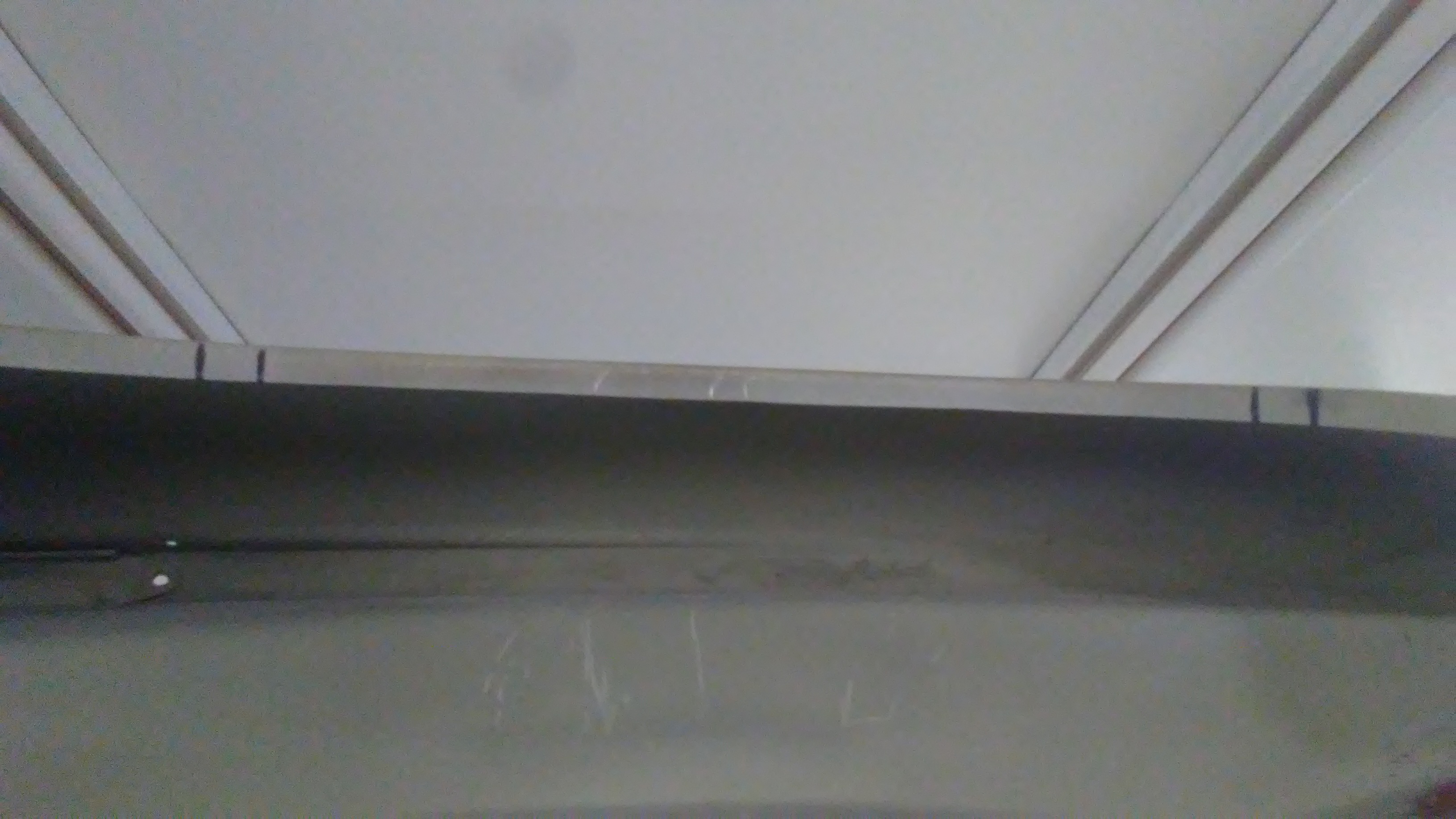

Straightened it and cut it as a 71 should be.
914350
post Oct 18 2017, 09:44 PM
Post #199
Posts: 548
Joined: 21-April 14
From: Torrance Ca.
Member No.: 17,275
Pic.

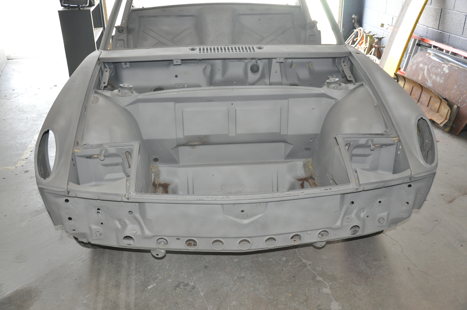

here's mine arriving at Kent's shop in Nov. 2011 after media blasting
