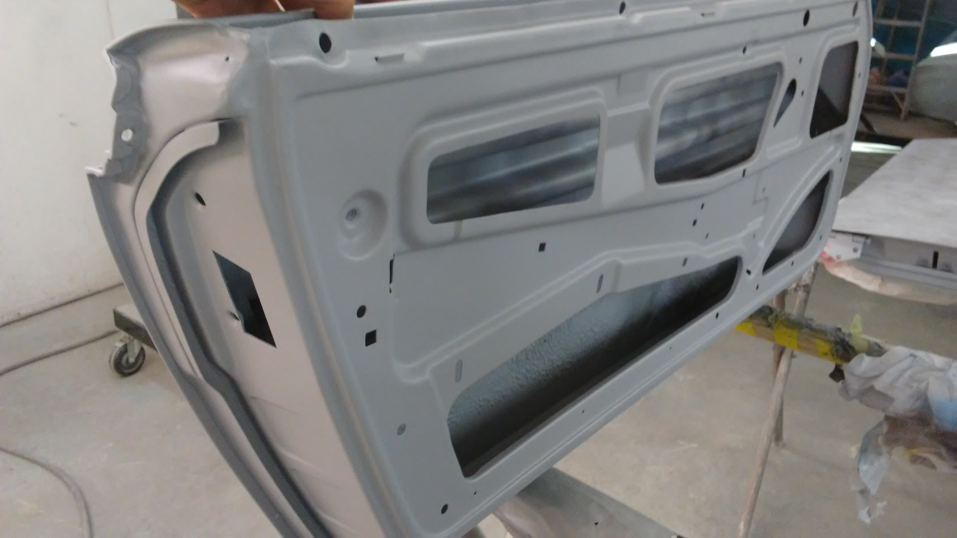

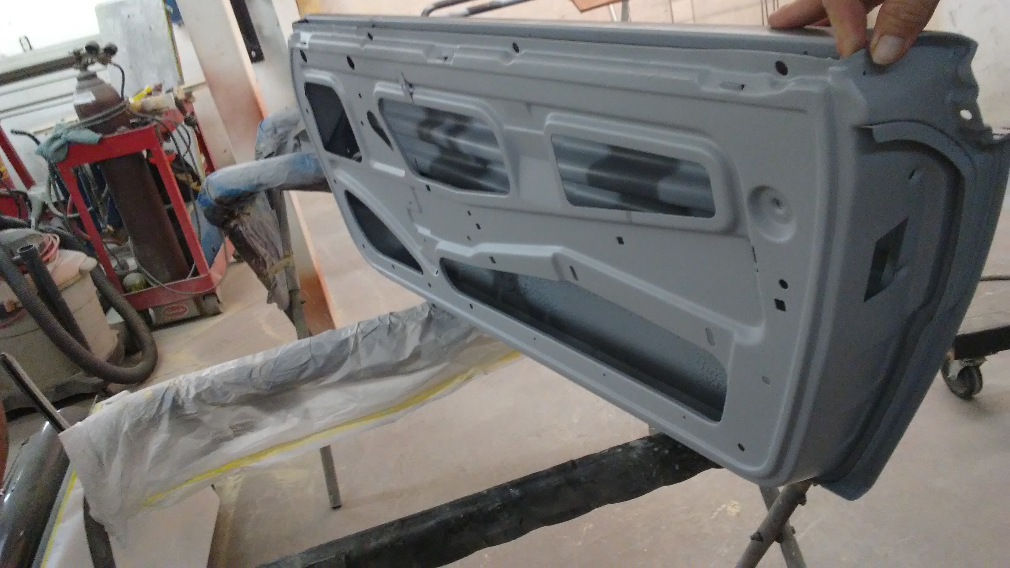

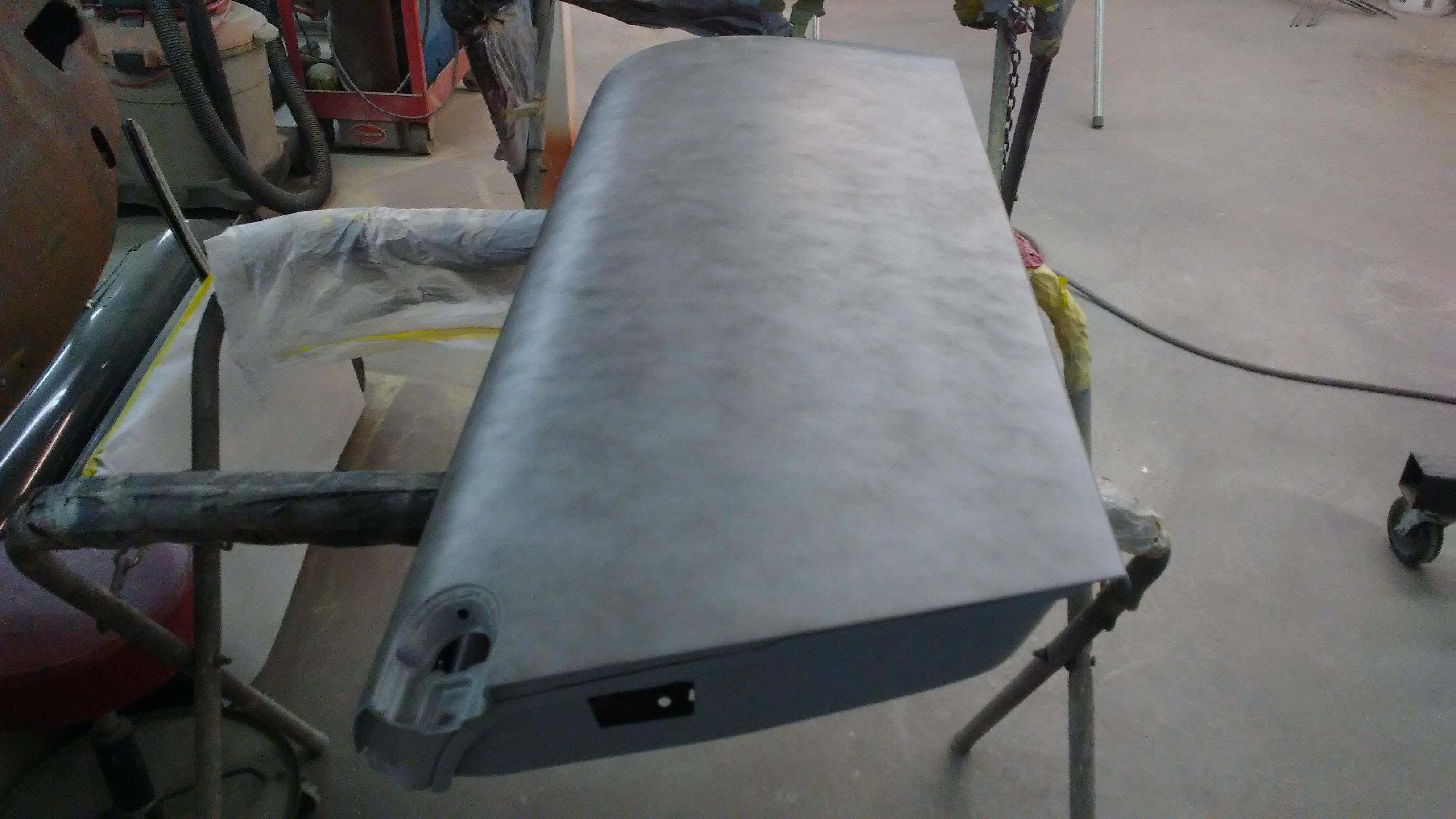

More progress pics.
914350
post Oct 21 2017, 09:07 PM
Post #206
Posts: 548
Joined: 21-April 14
From: Torrance Ca.
Member No.: 17,275

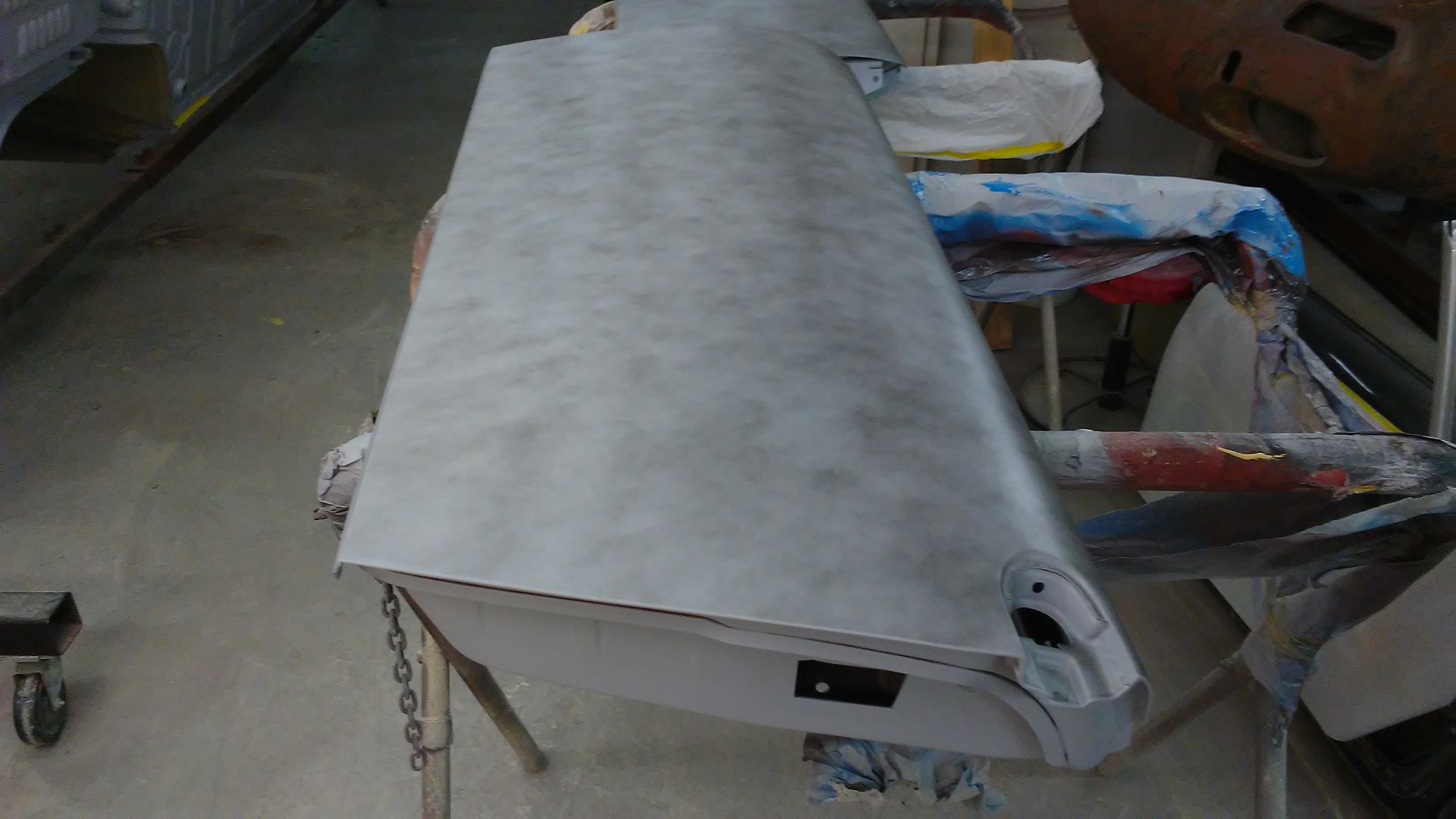

More pics.

Oh wow! Those doors look perfect. Very nice work. Thanks for posting the pics. (IMG:style_emoticons/default/beerchug.gif)

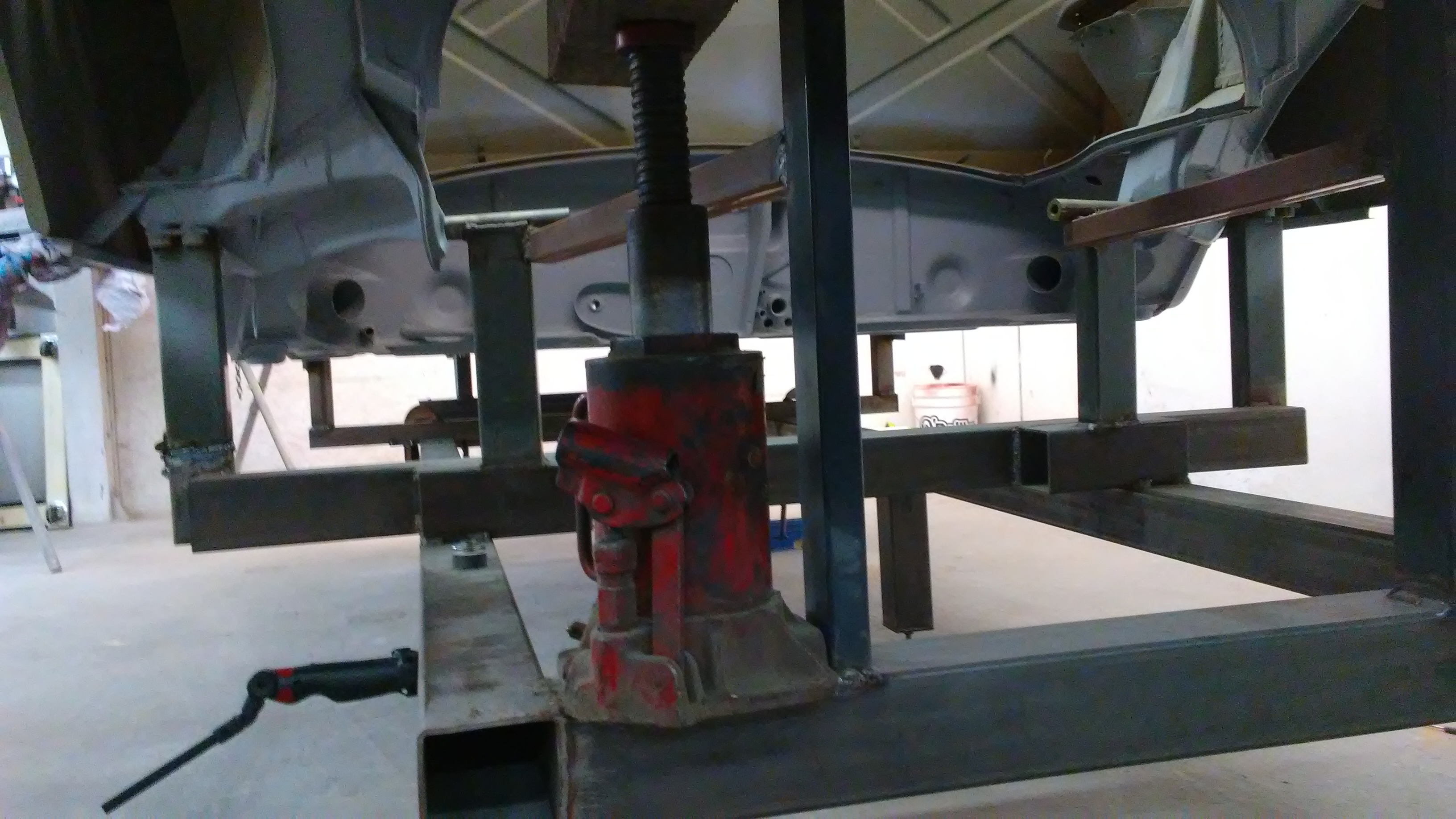

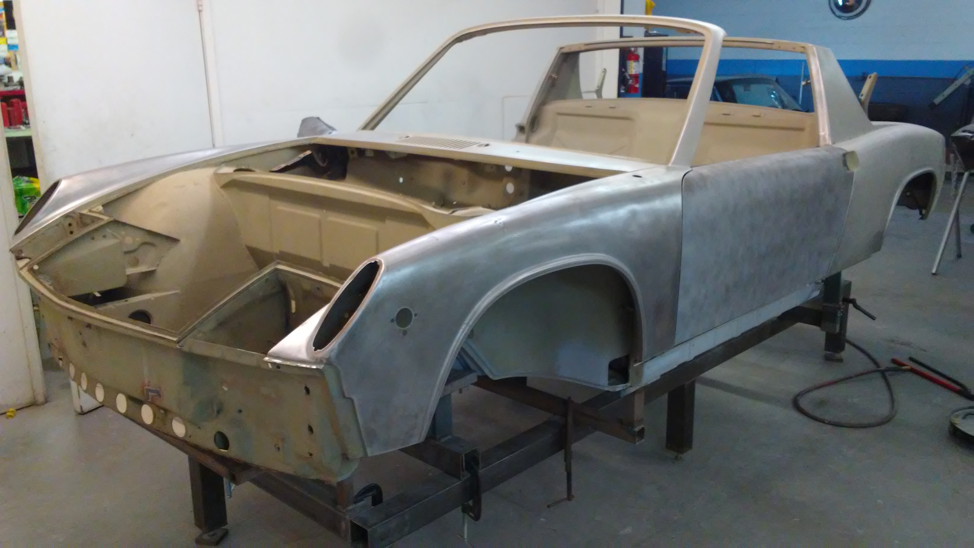

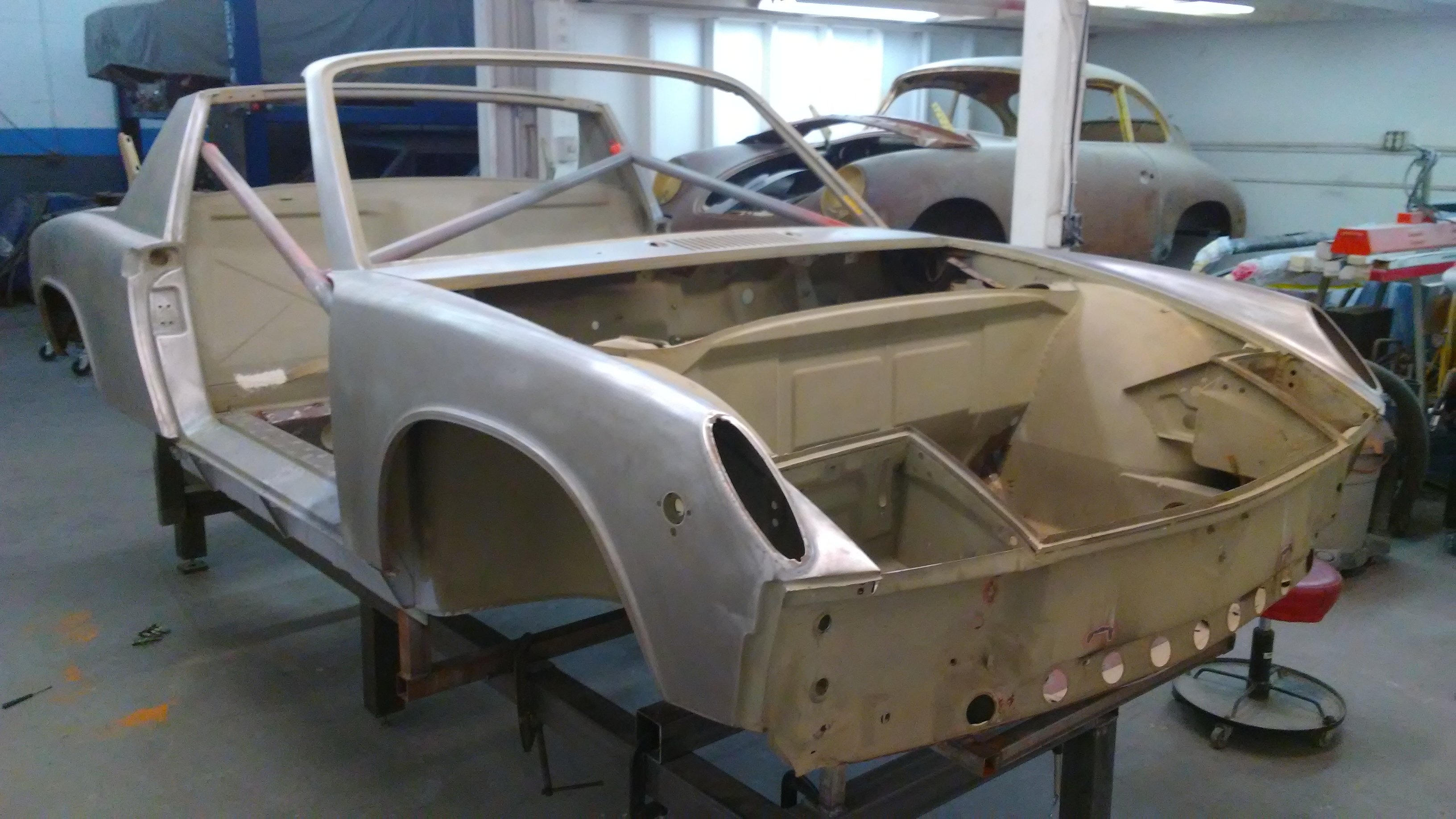

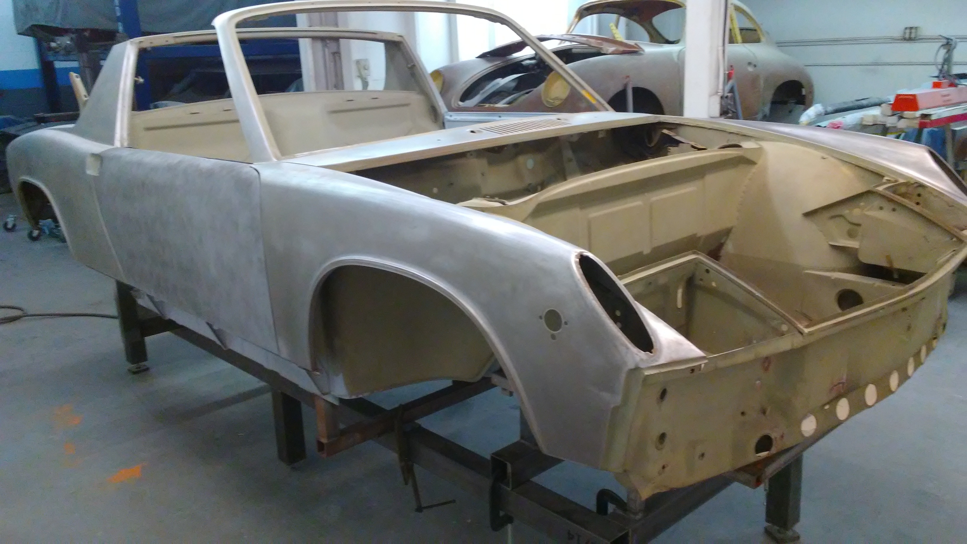

Got the car back on the fixture today.
914350
post Oct 29 2017, 03:53 PM
Post #209
Posts: 548
Joined: 21-April 14
From: Torrance Ca.
Member No.: 17,275
When setting the car on the fixture previously, I could see that all the measurements were in spec although the back of the car was tucked down from a previous hit/accident slightly. I could see this in the suspension console alignment to the fixture. Although being off by 2mm is within spec, I brought the back up to get it to zero.

Doors.

Just amazing work. It is so calming to me to see the quality of work being done and that my Six is moving right along. Being back on the fixture means we are going to see some reconstructive surgery....... (IMG:style_emoticons/default/sawzall-smiley.gif) (IMG:style_emoticons/default/welder.gif) (IMG:style_emoticons/default/smash.gif) can't wait. Thanks Kent. (IMG:style_emoticons/default/beerchug.gif)

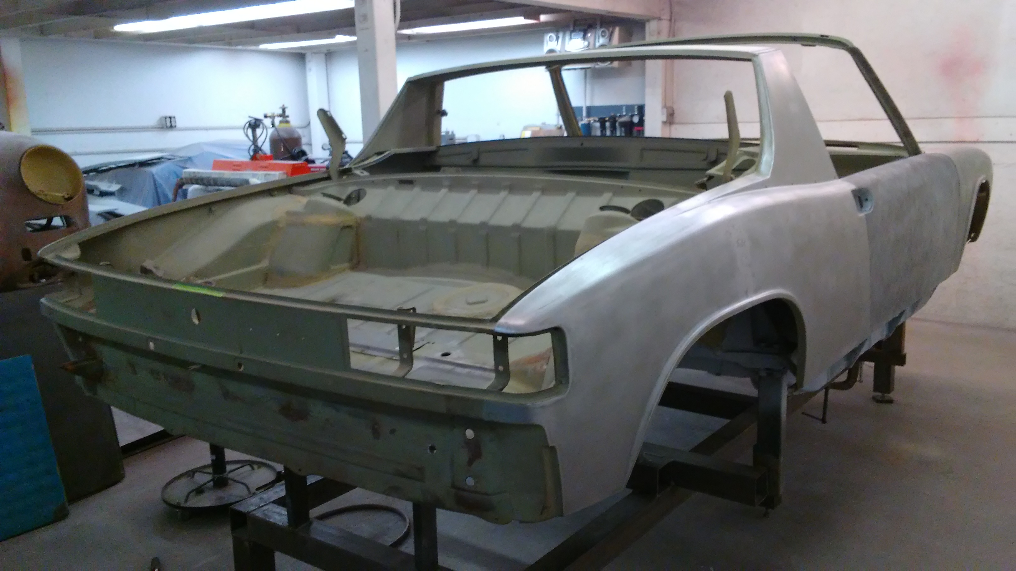

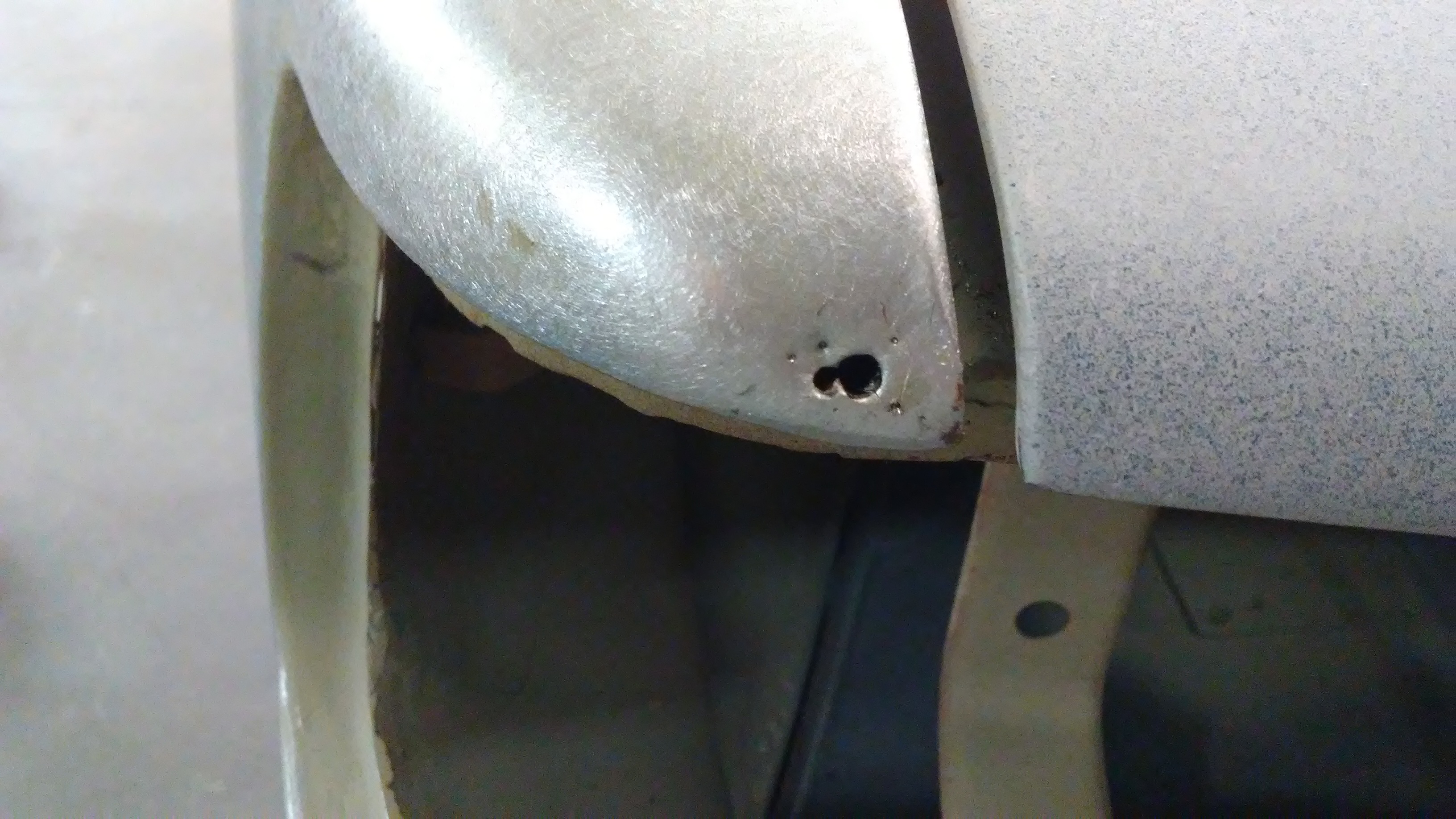

Drivers side quarter panel is rotted out from the backside. This full Q.P. was replaced at some point.

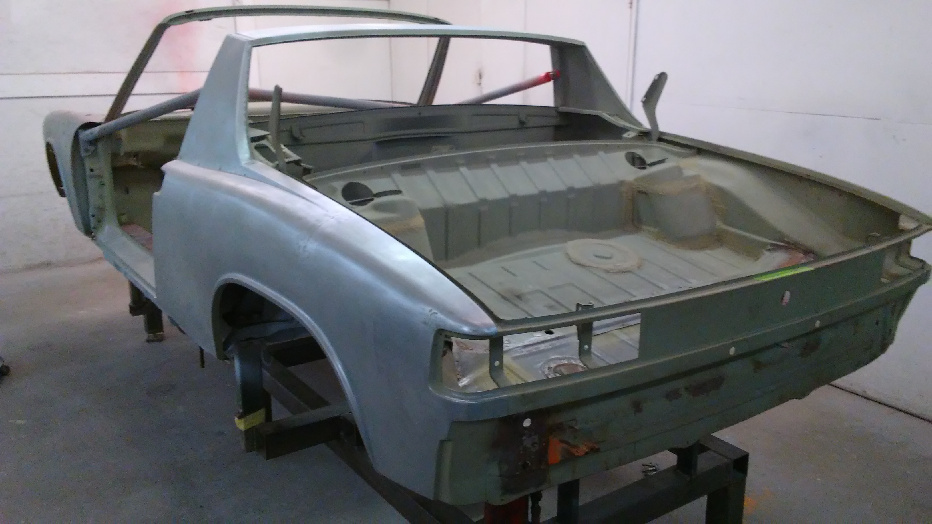

A section of the passenger side Q.P. was replaced at some point and was not put on straight and measures out 4mm to long.

QUOTE(914350 @ Oct 30 2017, 08:57 AM) *
Going to plug weld and grind/sand to finish?
914350
post Oct 30 2017, 12:02 PM
Post #218
Posts: 548
Joined: 21-April 14
From: Torrance Ca.
Member No.: 17,275
QUOTE(mb911 @ Oct 30 2017, 10:53 AM) *
I want to make sure I get it all so I'll cut it open, clean inside then rebuild the corner. I'm thinking it will be a very small repair area.

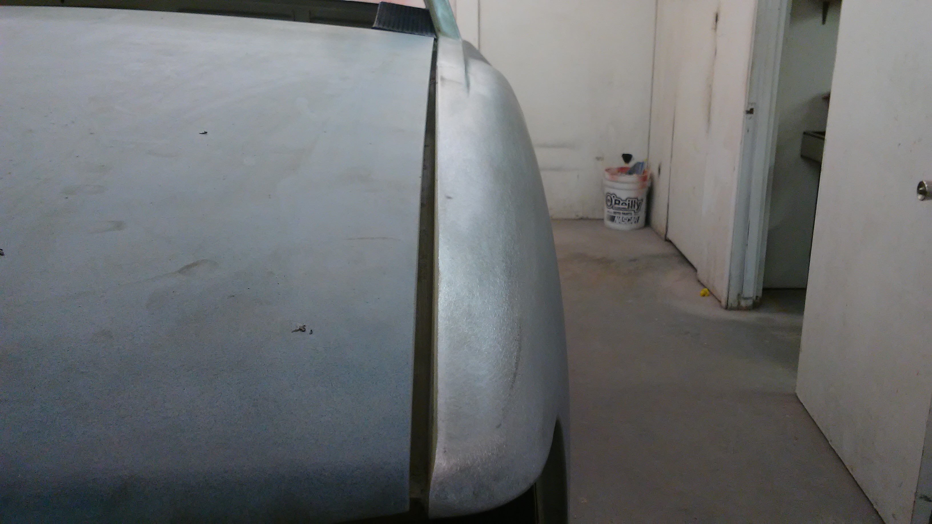

(IMG:style_emoticons/default/sad.gif) So it looks like more bad news coming my way regarding the previous work. The passenger front fender has to come off because it was welded on over a bent wheel well that is high and the hood strikes that when being closed. The passenger side fender is also out of alignment a little, but the driver's side is off a bunch. These were both replaced in VA.
Also, as if that was not enough, the passenger's quarter panel is off, welded on the wrong way, and the taillight housing will not even fit in the opening. This was done in VA. The driver's side fits OK but needs some work too.
Looks like Kent is going to have to remove a lot of sheetmetal and then redo a lot of work I already paid to have fixed once. That really hurts.
I am not bad-mouthing Scott. His work is history as it relates to my Six (see Part 1 of my build thread) and I am not going backwards. However, I can't post pictures showing the work Kent is having to correct to make my car straight, true and right and take the chance someone might associate that previously done work with Kent's shop or the work Kent is now doing to correct all of this stuff. So I am trying to be clear about what was done in the past and what Kent is now doing.
