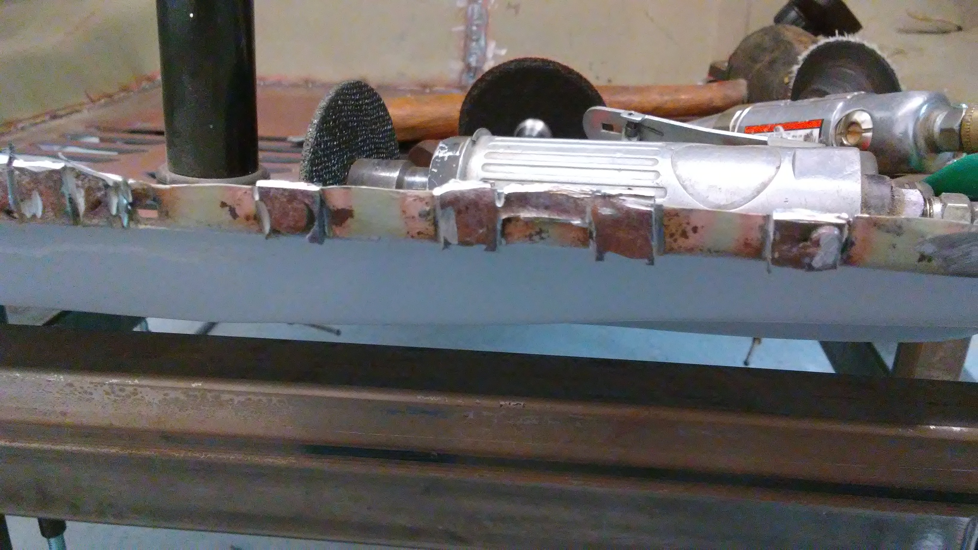

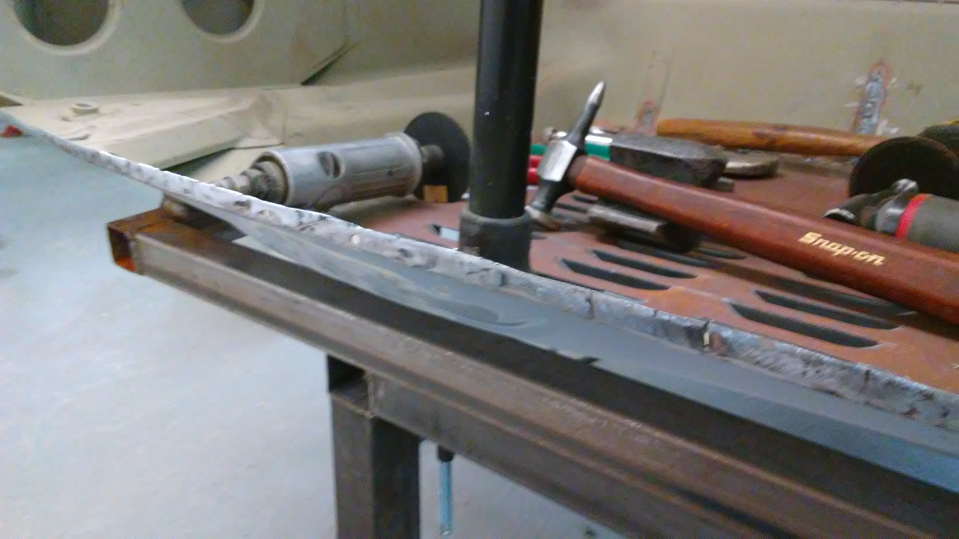

			 ...again, plug welds are not as easy to seperate as spot welds.

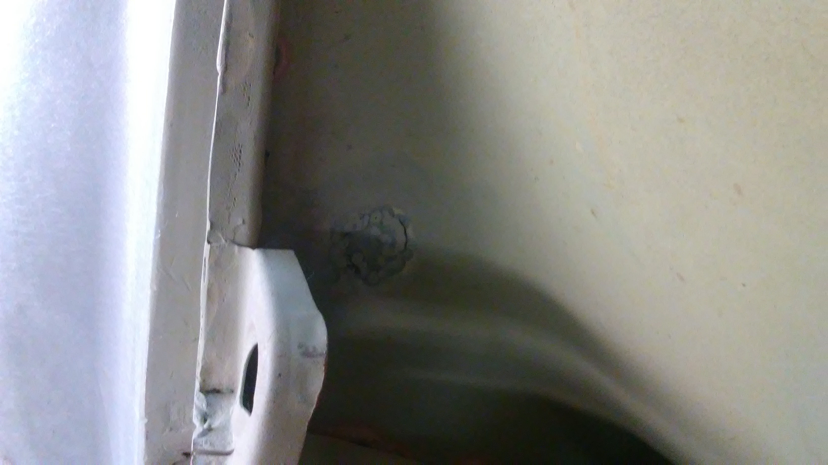

			 At some point the holes for the side lights and turn signals were welded up on both sides. I'll drill/bore the hole..

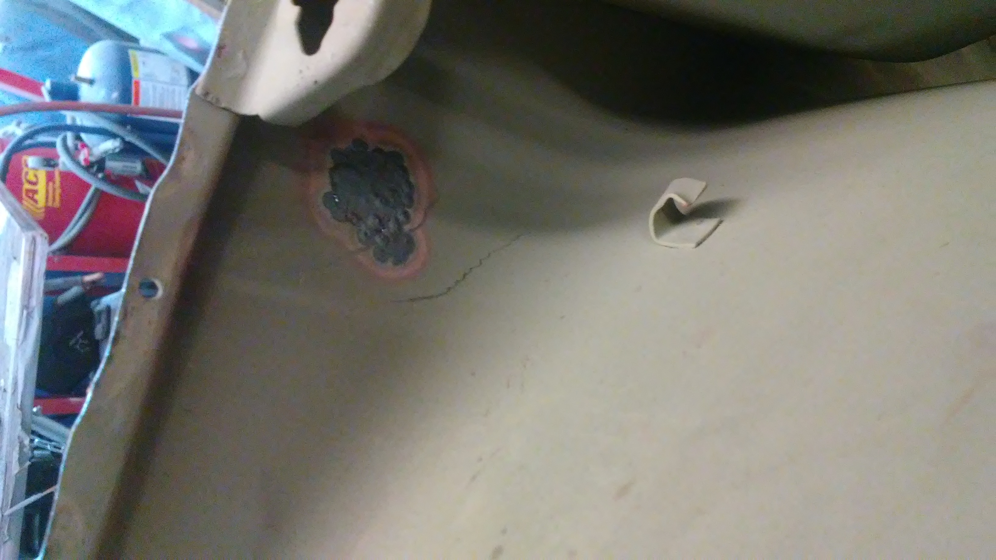

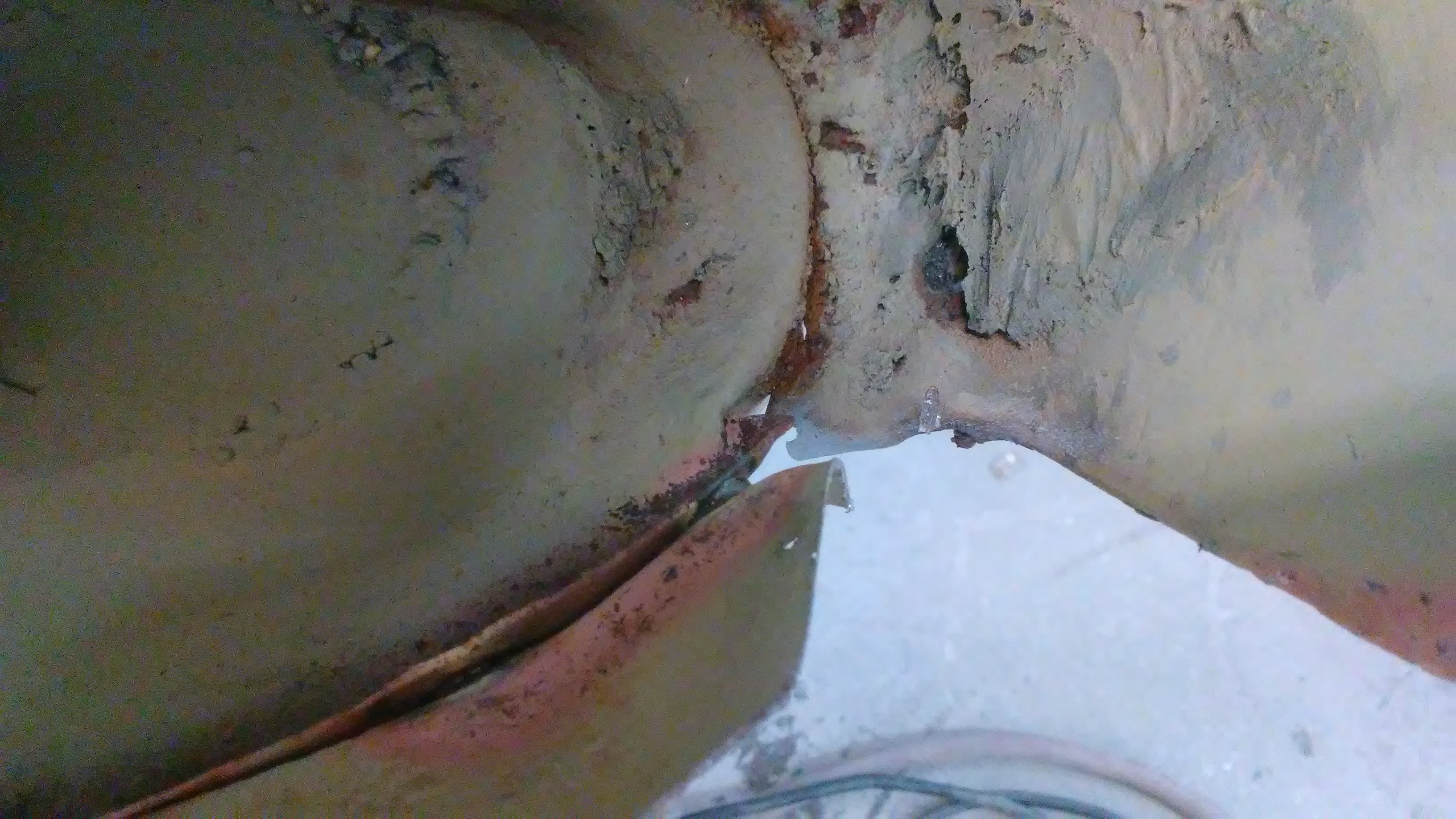

			 If you look, you can see in this pic how the bottom of the bucket is pushed over/inward. Look at the angle of the drain tube and the angle of the bumper bracket.
			The second pic shows damage from a previous accident. Attached thumbnail(s)  |

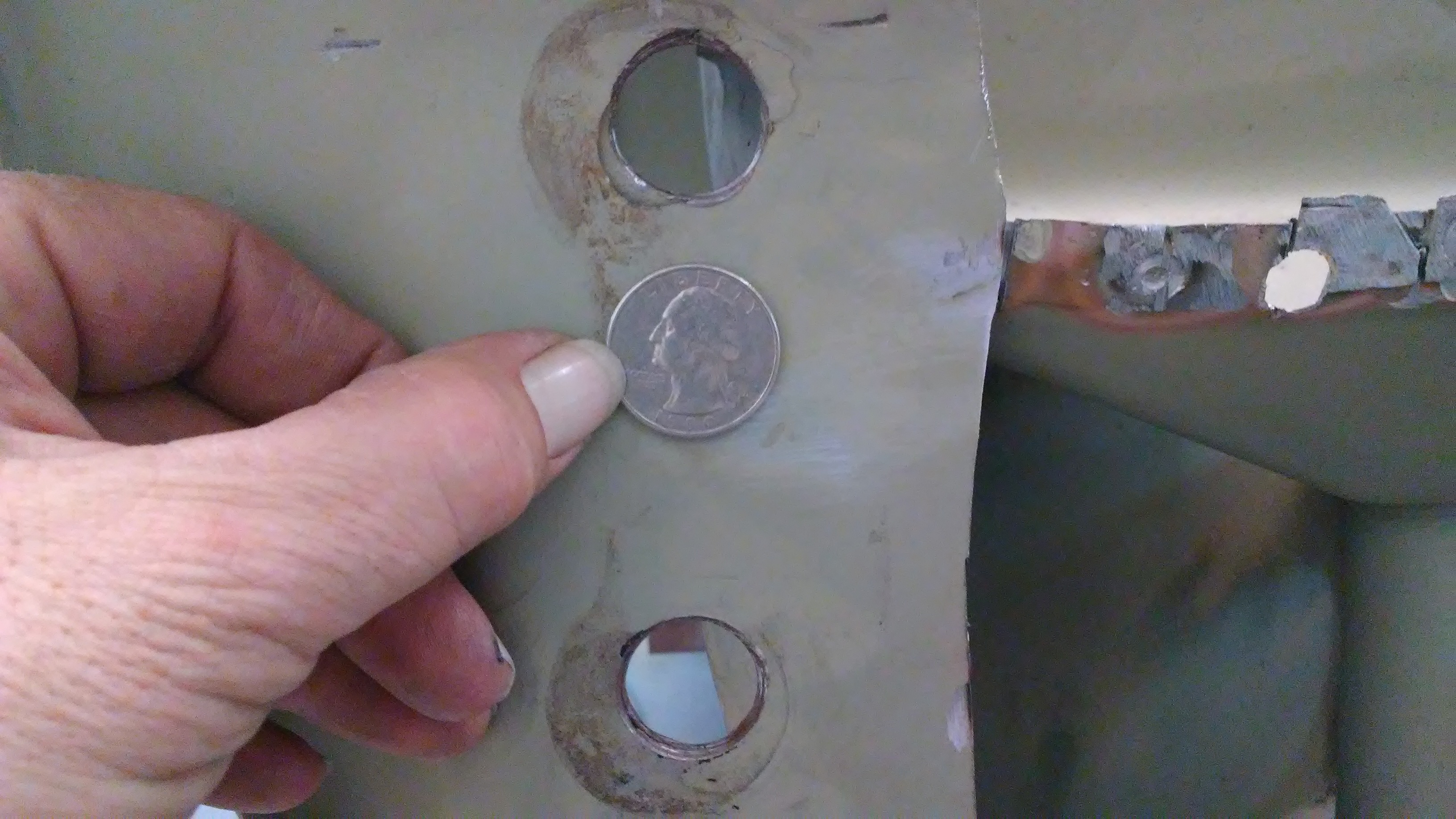

			 Because the inner structure was bad, the fender gap was gone on that side and someone had drilled the bumper bolt holes out to about the size of a quarter. So the bumper would align.

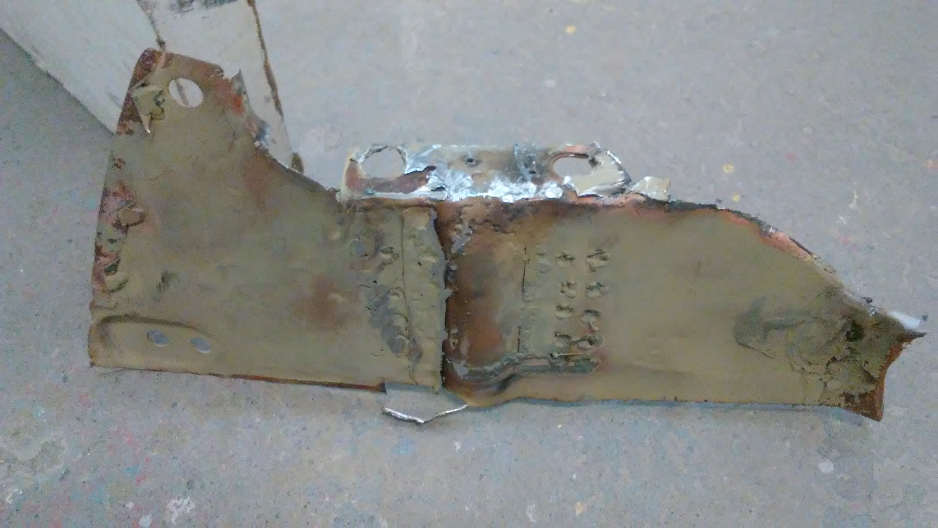

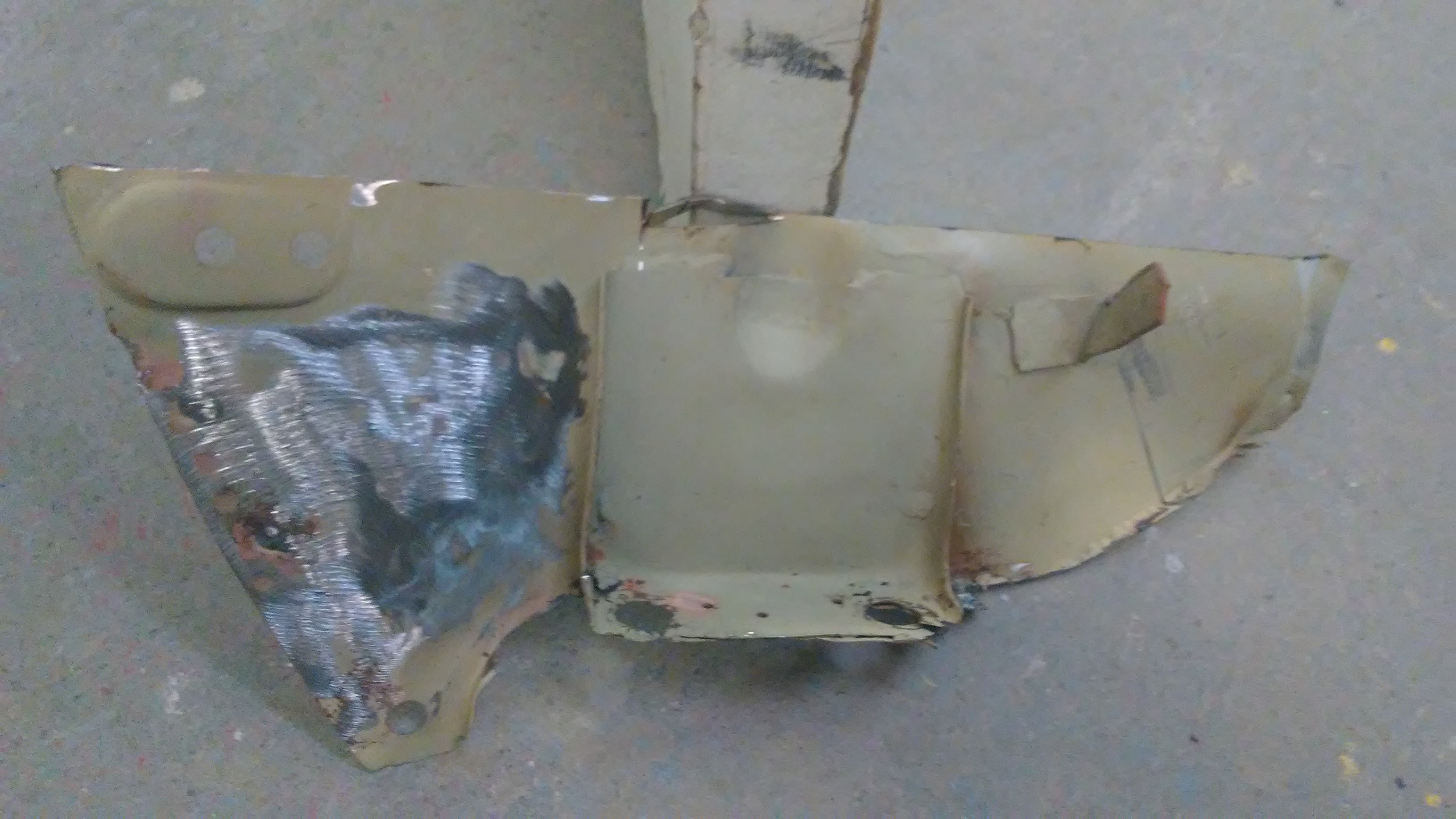

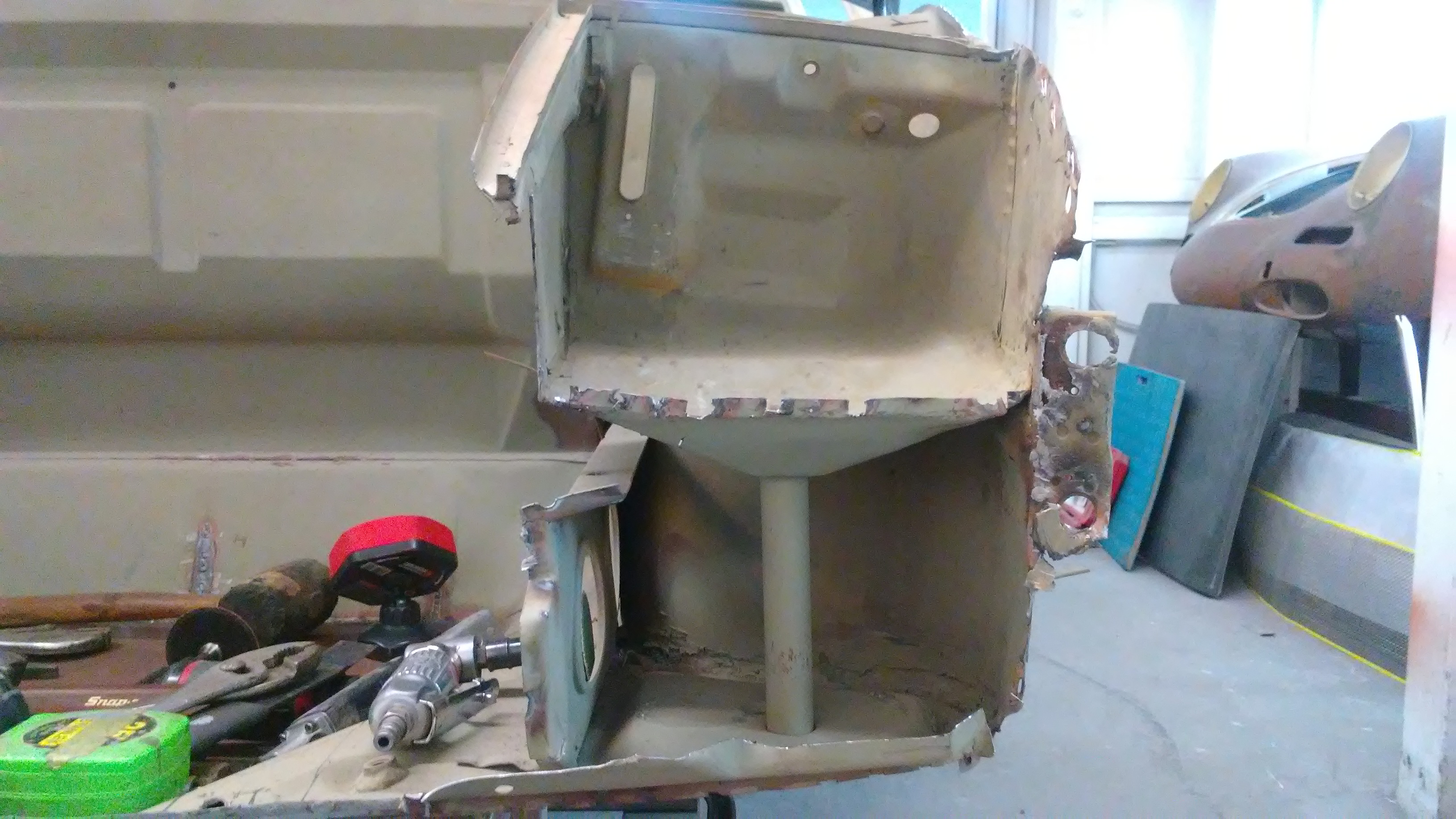

			 This section had to go. Pounded on welded on and damaged.
