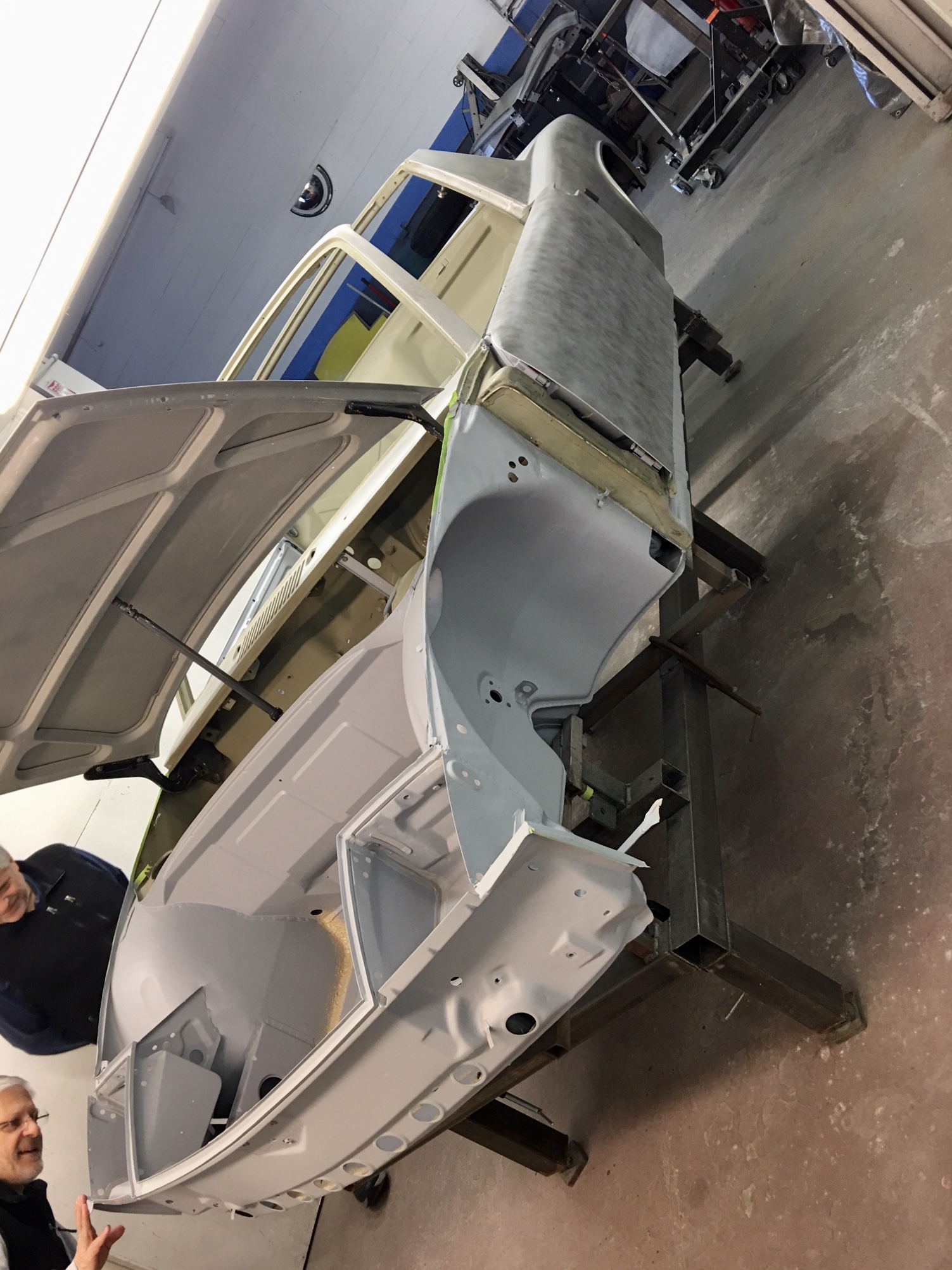

So I went down to visit with Kent, and Jim and got to meet Dave (BlueSix) and Bob while down there looking at my Six. First off, the work Kent has done left me speechless - my car has jumped forward lightyears in progress. I feel for Kent as he has been undoing a lot of bad work, correcting the chassis and building from there. Everywhere we look we see things that were not right.
Soon enough Kent will be moving on to the body work phase as the metal work will be concluded. Again, the front end is now all straight, true, correct and beautiful. I was so excited looking at the car and talking with them all that I took no pictures. However I believe my brother Bob took some as did my friend Richard. Richard, who is a die hard VW guy was completely blown away by Kent's work and never did stop talking about it on the 6-hour ride home.
As soon as I get some photos I will post them to catch the thread up. I believe we will be returning to L.A. in March for the big swap meet. At least, that's the plan. Stay tuned.
Just a side note, these guys are just top-notch people. Dave, BlueSix, is a great guy. Another serious 914 owner who knows these cars inside-out too. Hope to see him the next time we go down to L.A.

Hi Mike, I really enjoyed the visit though I ate way to much but I guess that could be a good thing. (IMG:style_emoticons/default/biggrin.gif) Thanks again for dinner 'twas excellent. It was great to see you brother and to meet Richard. I'll keep pluggin away and there will be more to see when you come down in March.

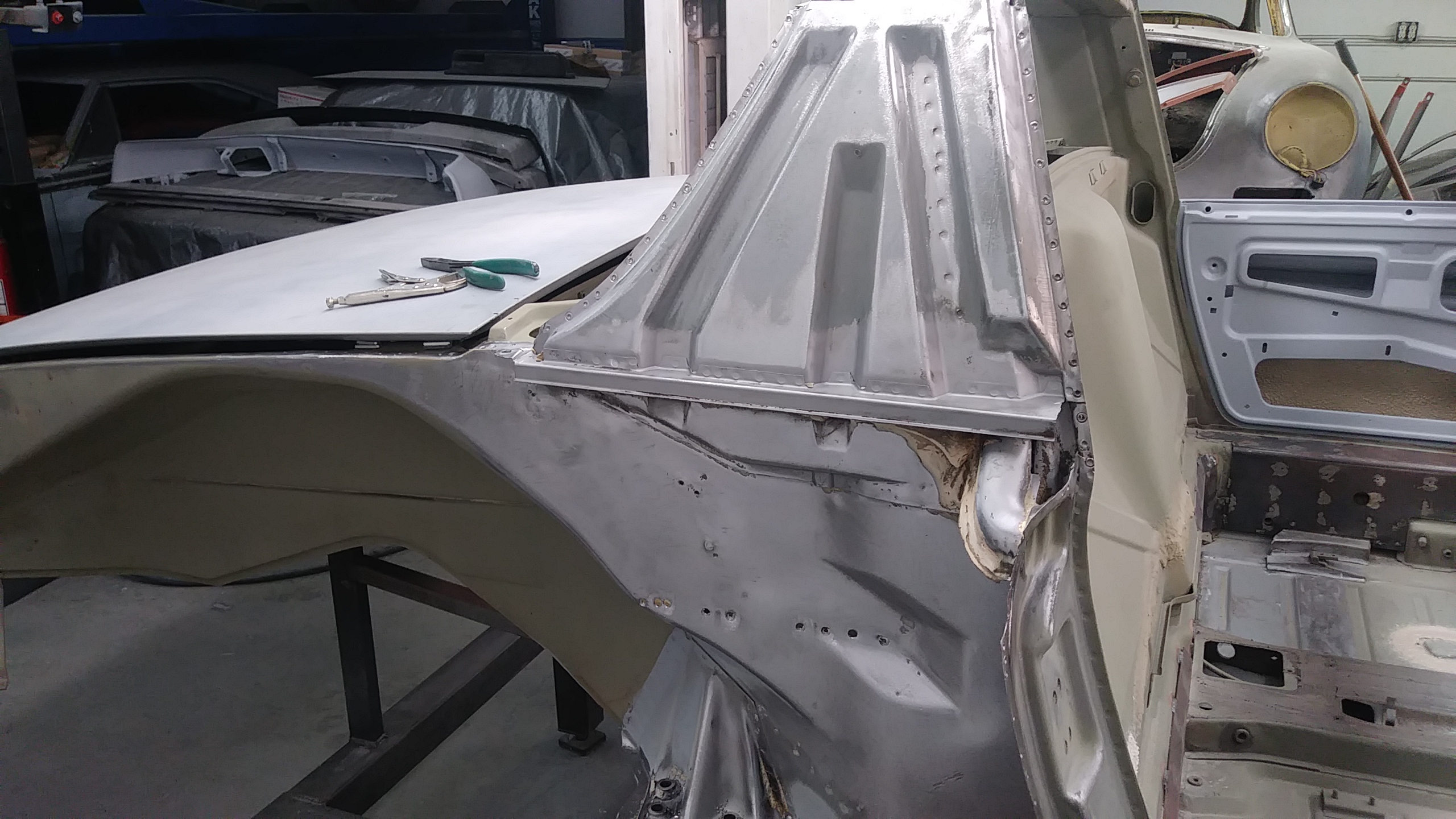

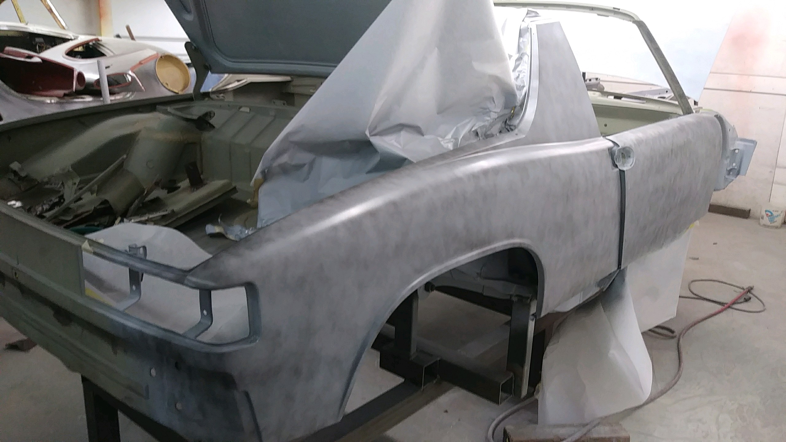

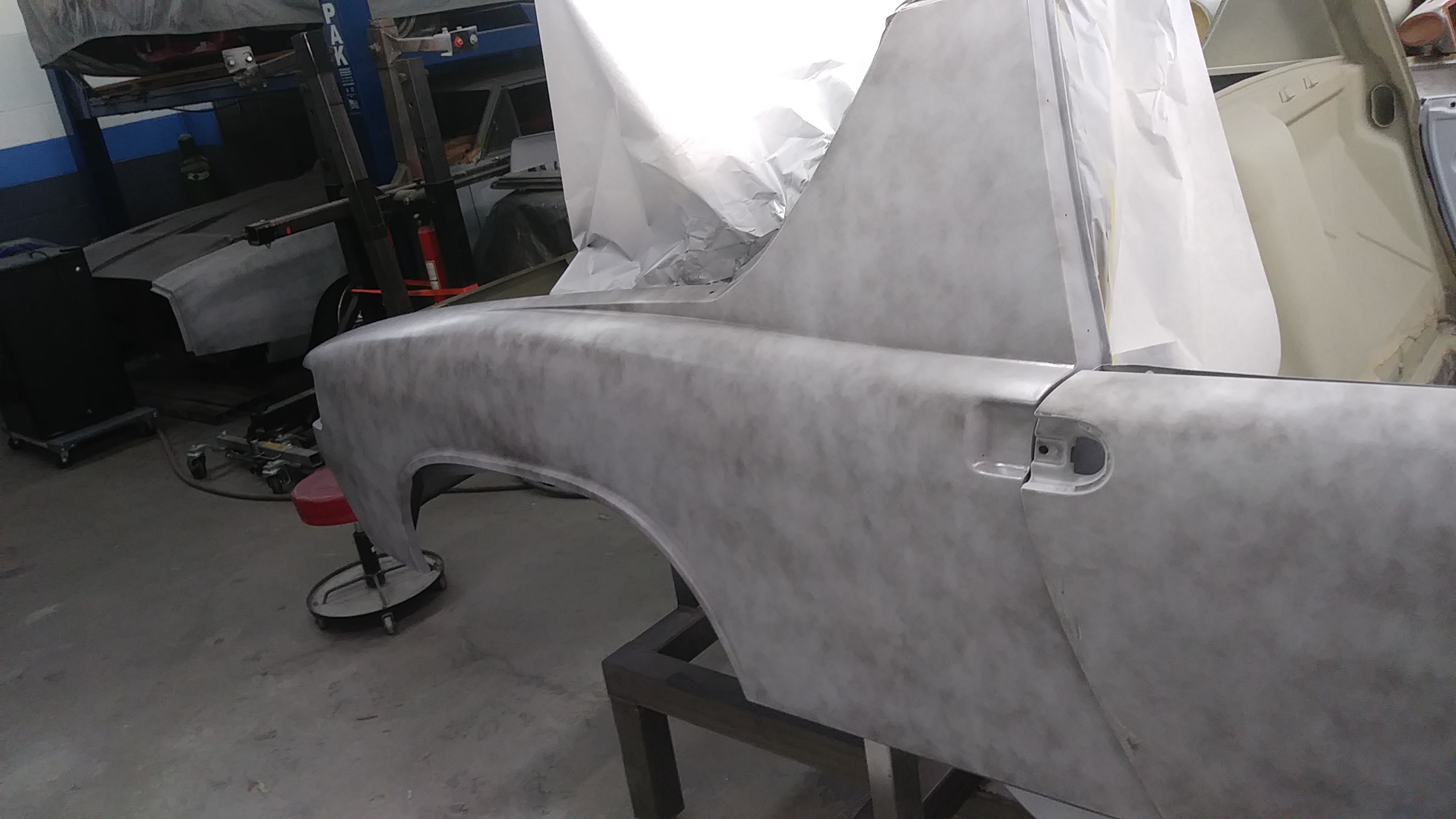

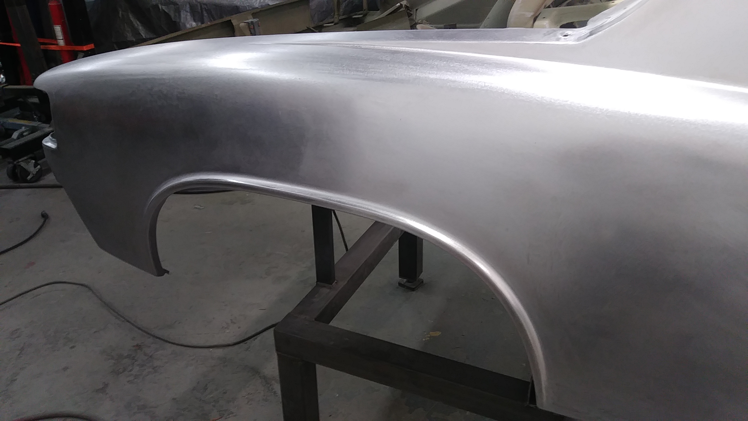

Pics of rear fender.

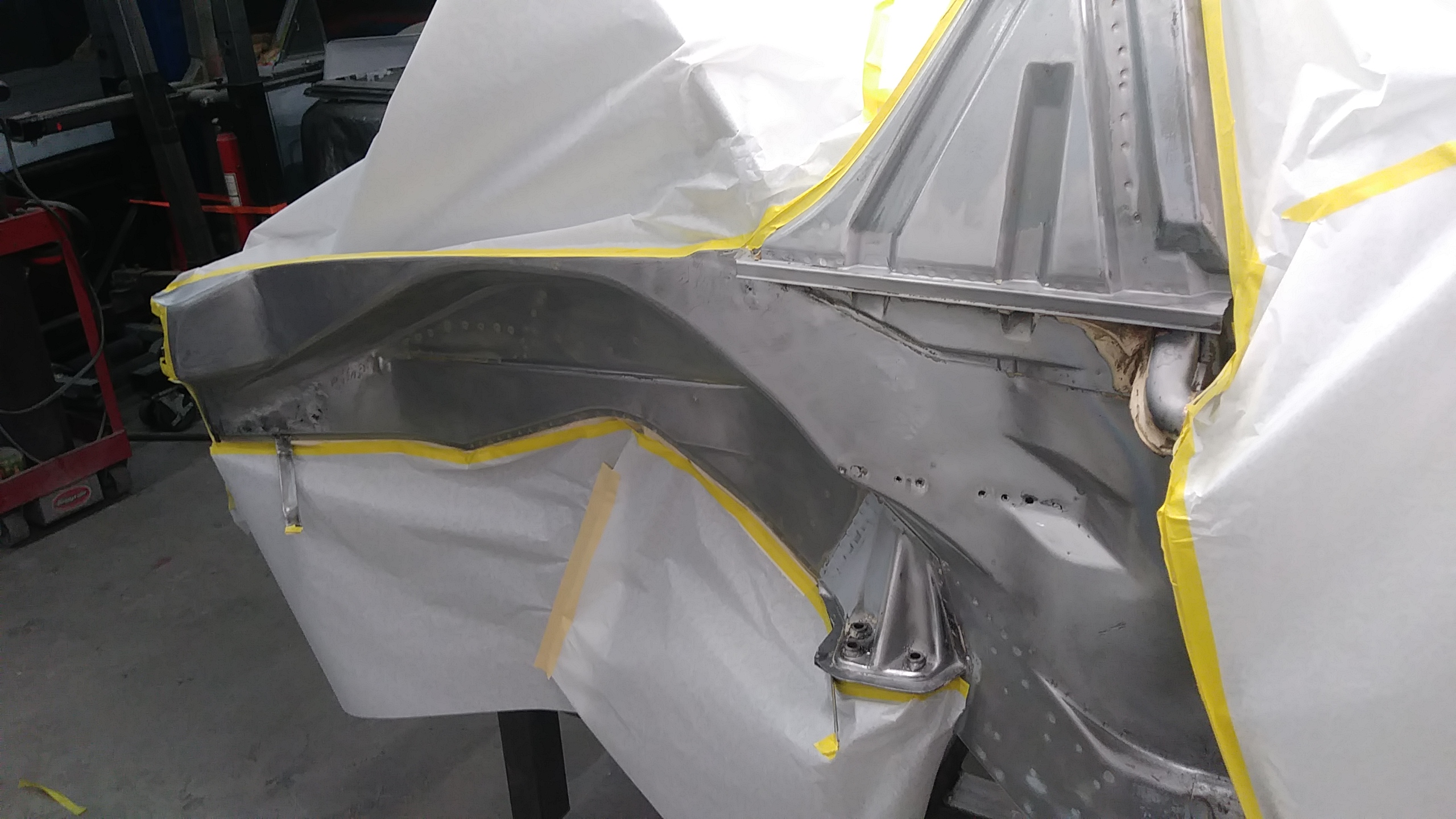

From: Torrance Ca.
Member No.: 17,275

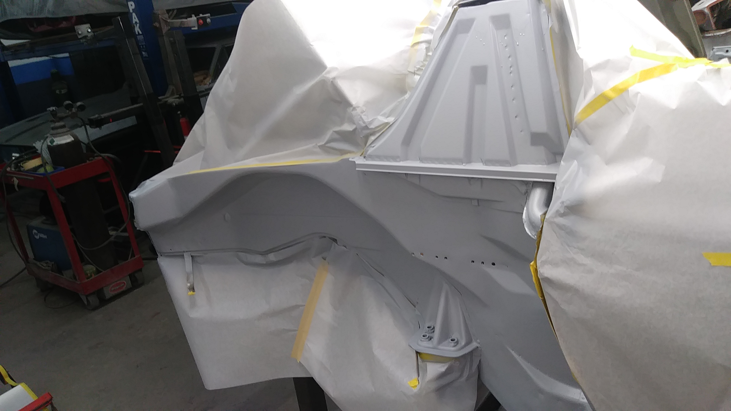

More pics.

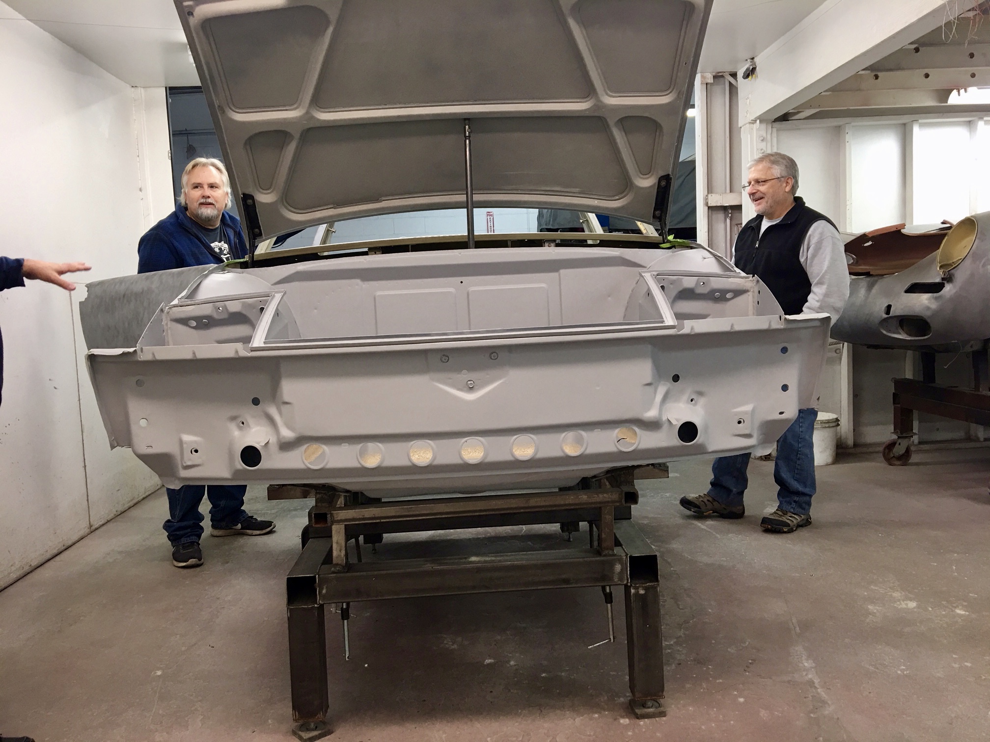

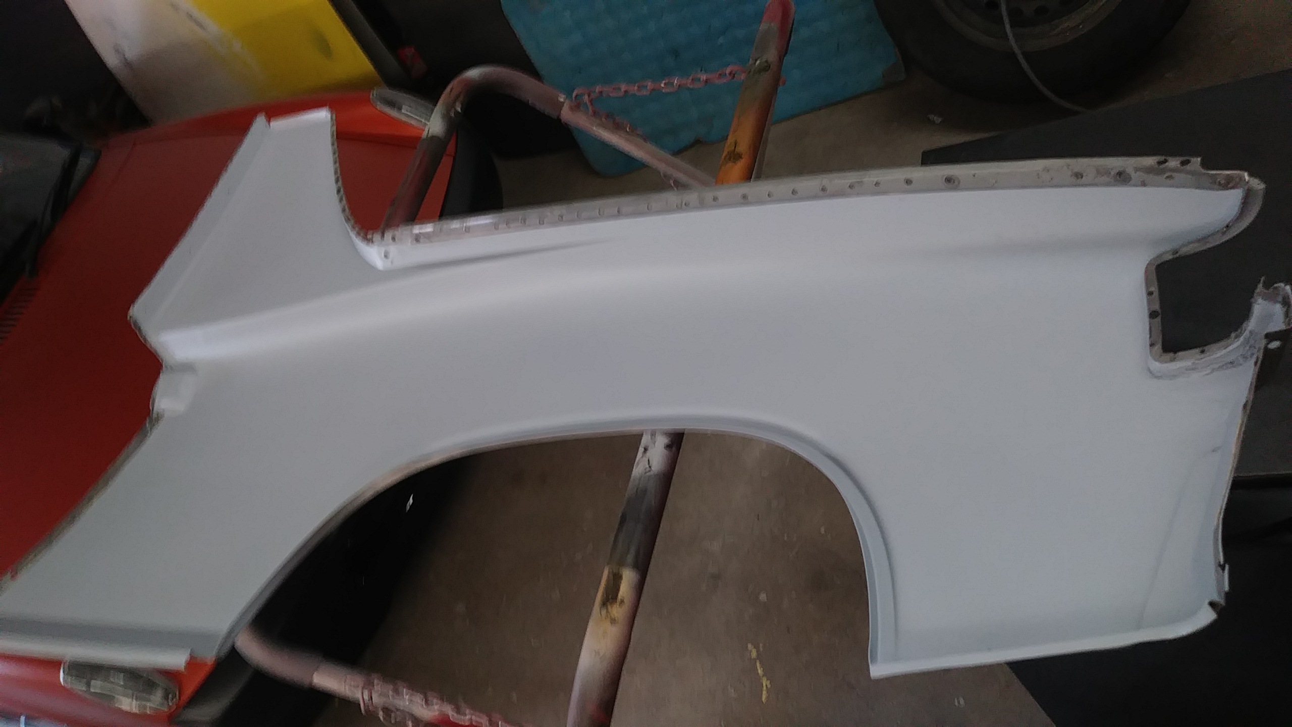

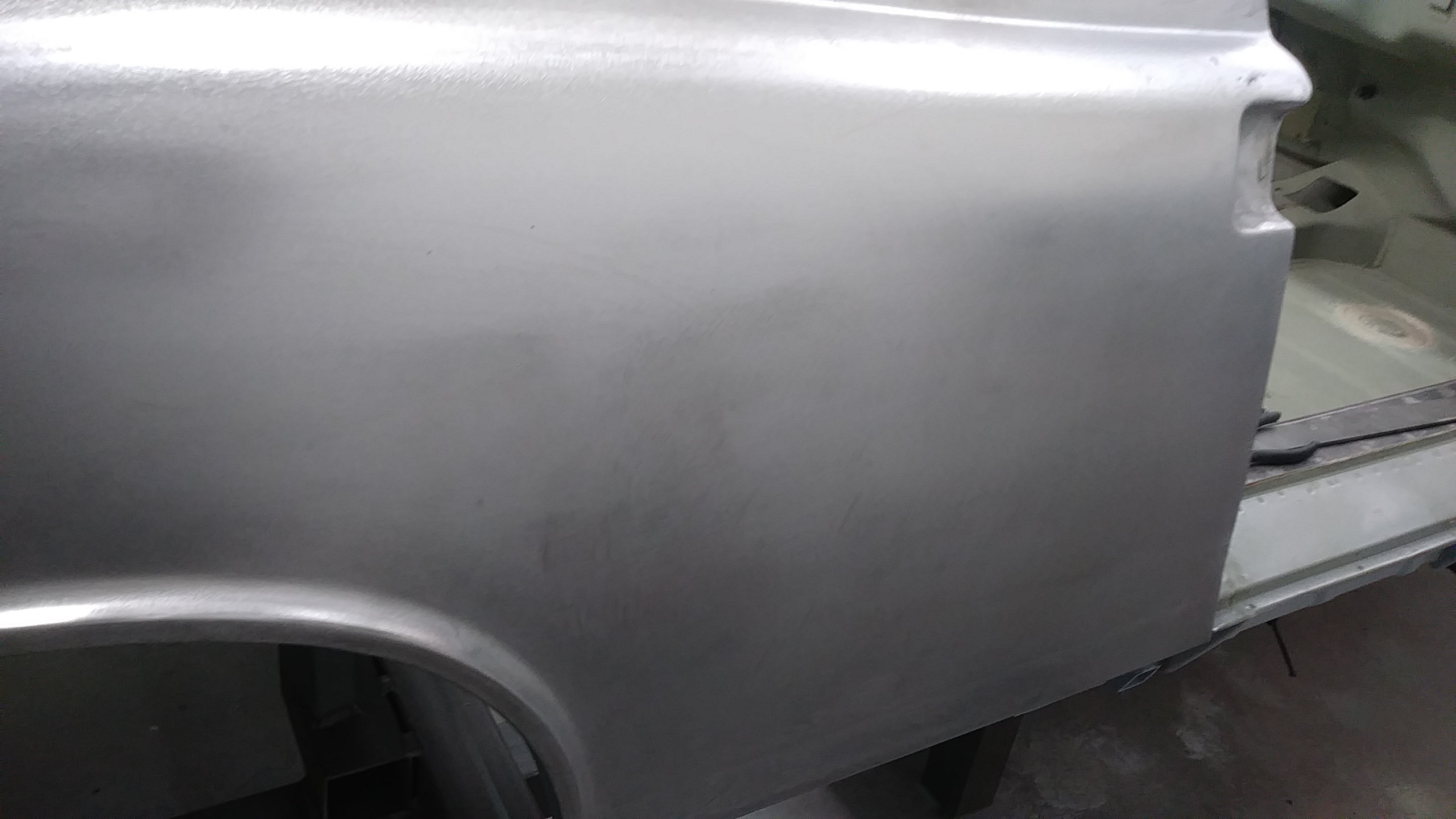

Pics.

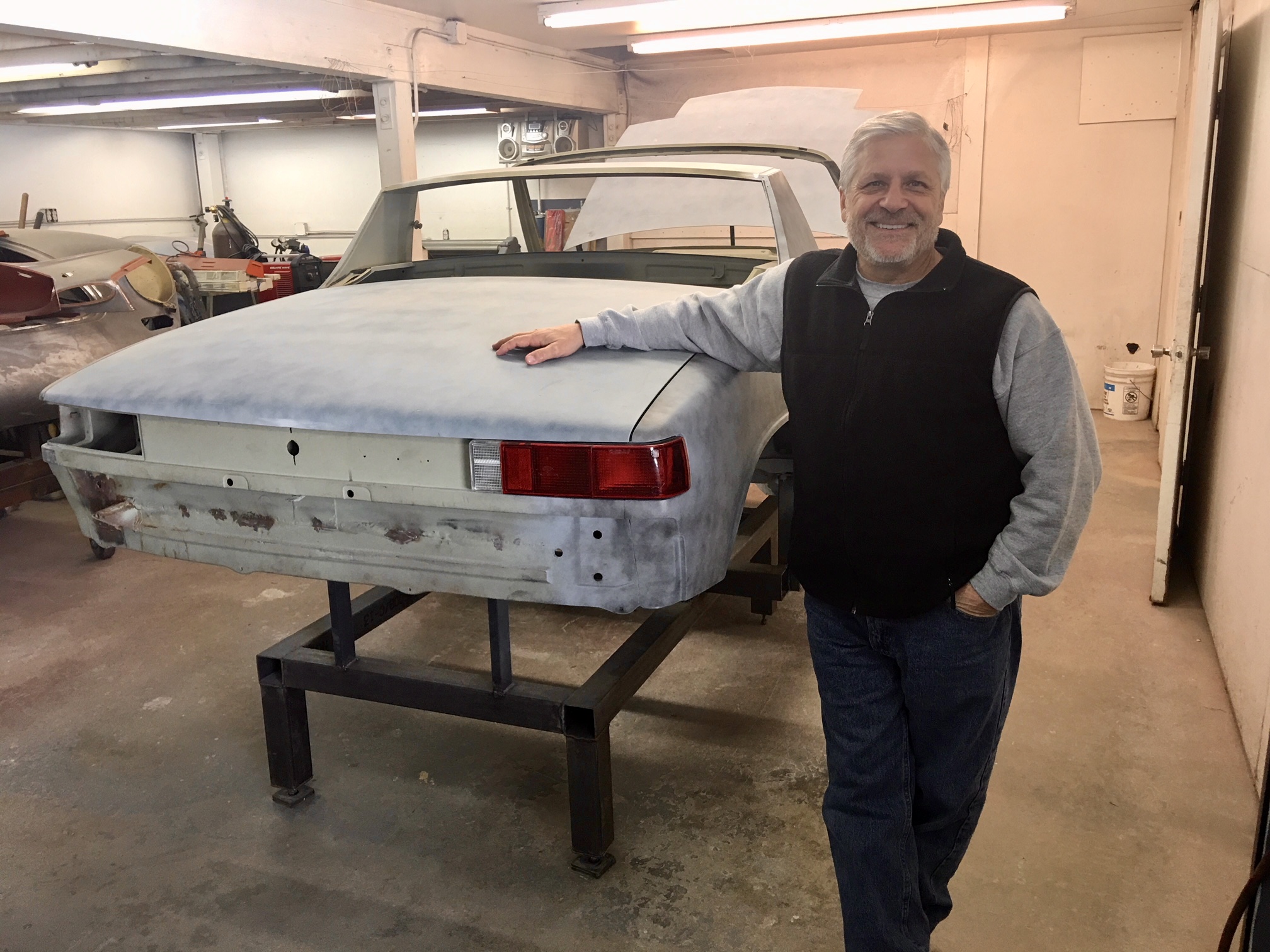

Not sure you can tell, but that is my extremely happy face. The rear tail light did not fit into the rear quarter panel when I got my car back. The panel was over 1/4" out of alignment. That may not seem like a lot, but believe me it is. As you can now see with the new/old "Green Hornet" quarter panel (thanks Dave (Blue Six) and Kent) the taillight now fits perfectly. The pictures of the quarter panel replacement should give you an idea of the level of detail Kent goes to to make sure the car is perfectly straight and tight, thus earning him forever a position on the Justice League.
I don't know if there is truly such a thing as a "rust free 914" but this Six is going to be as close to that as will exist in this century. Kent's work should not really be described as work- it is true craftsmanship. I know that because I have seen it with my own eyeballs. Pictures are nice, but they still can't really tell the whole story.
My friend Richard summed it up by saying, when looking at Jim's 914-6, "I was never able to go to a Porsche dealership in 1970 to see a brand new 914-6 in the showroom, but now I know what that would have been like".
I can't wait for my next trip to L.A.

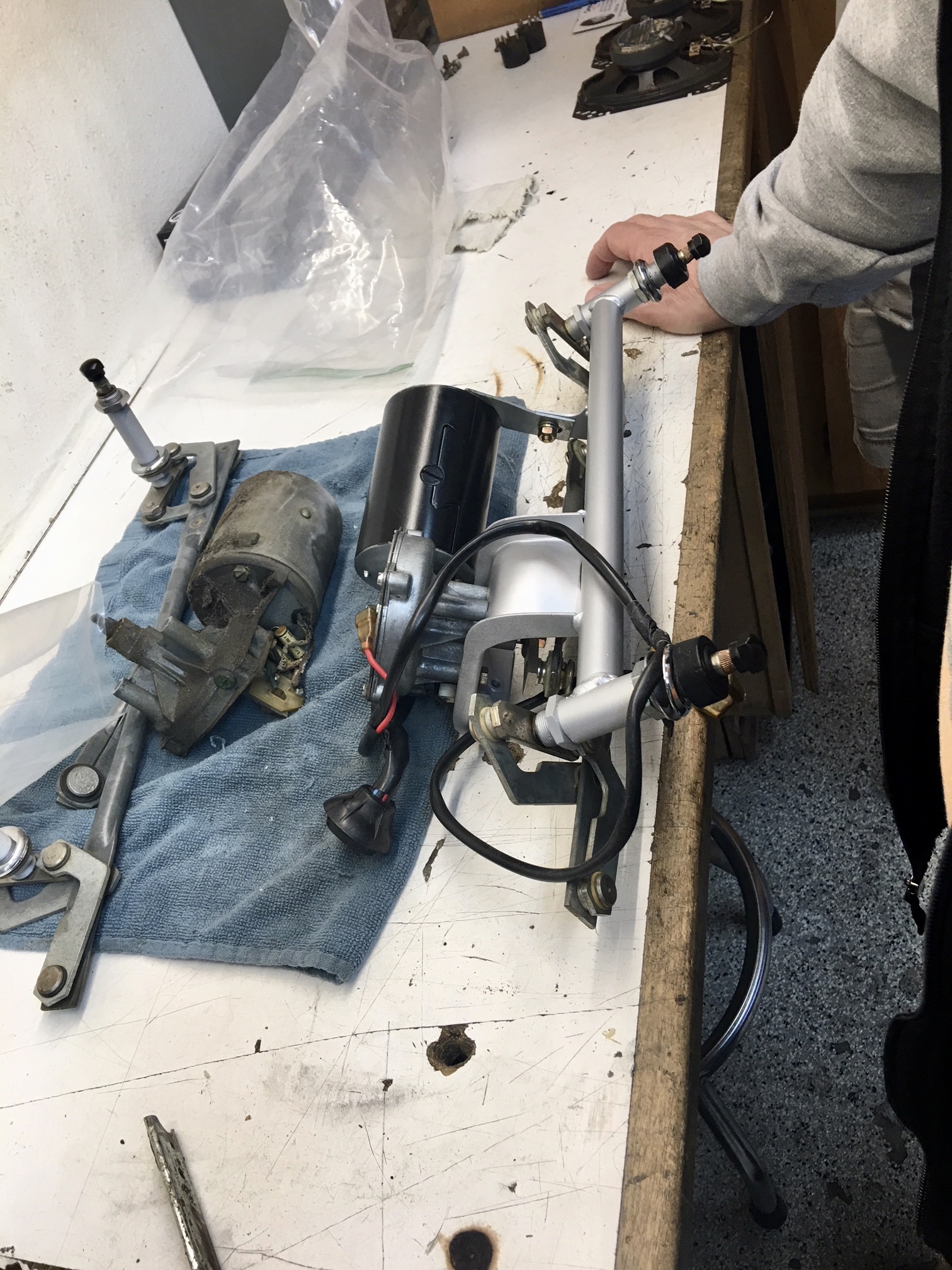

And, here is the windshield wiper assembly for my Six. It was checked out by master electrician Bob (he has a perfect Boxster Spyder) and refinished by Jim- no further introduction needed.
Here is mine in the foreground with a 4 wiper assembly behind it. Aside from the visible distinctions, a 6 has a three-speed wipers and park. A 4 has two-speed wipers and park.

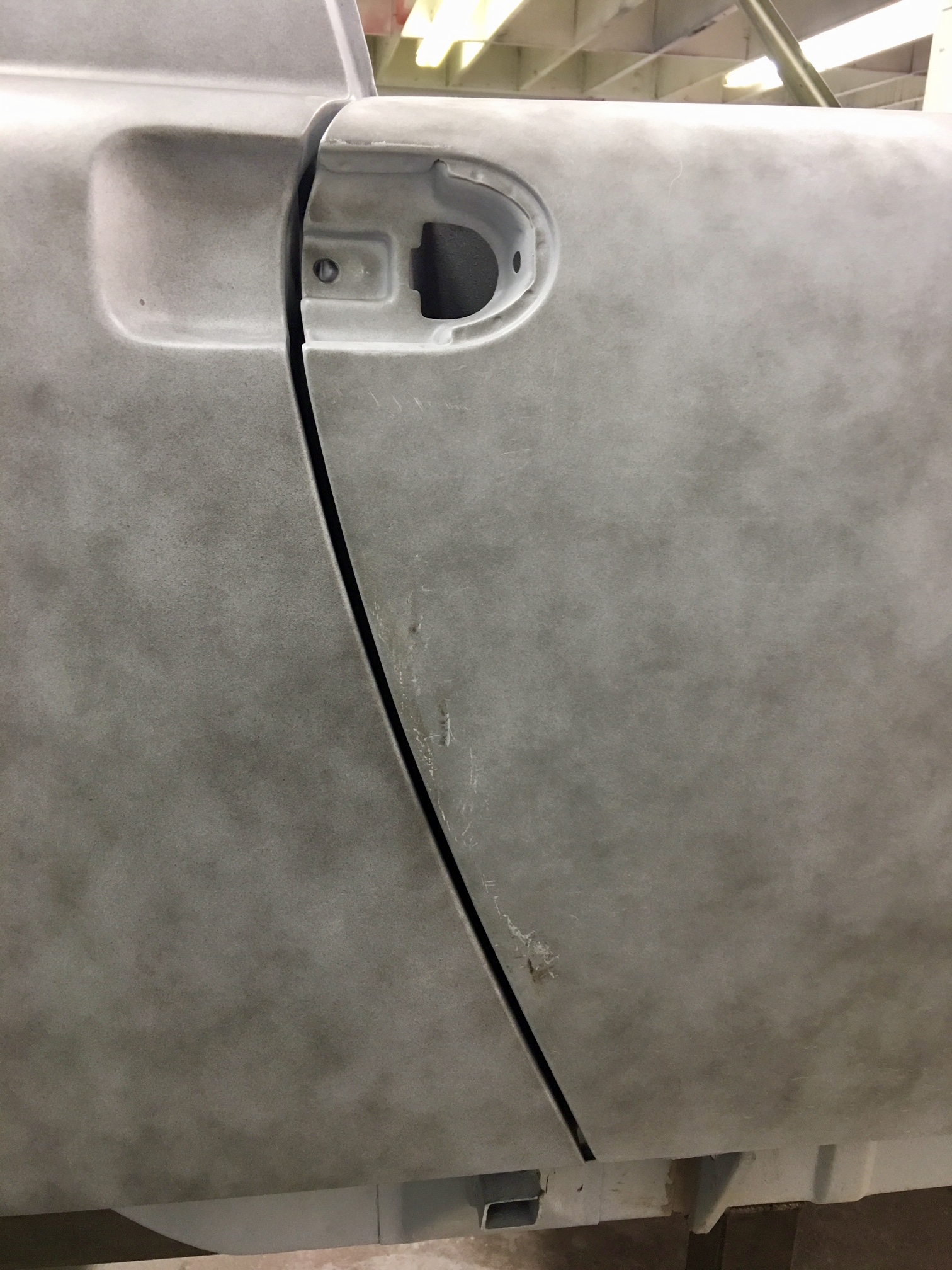

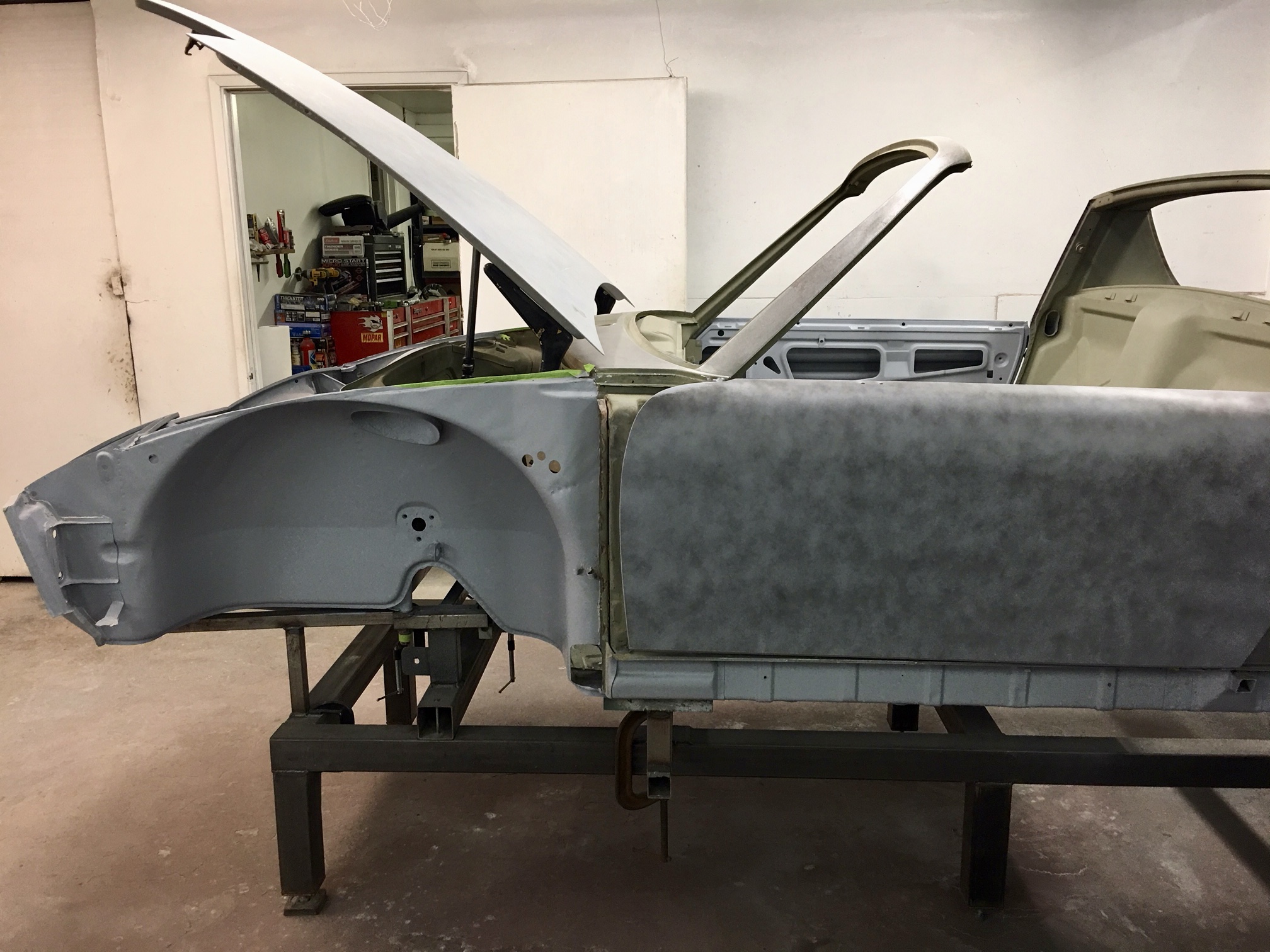

Is this what the door gap should look like with the shell unloaded with weight? If so, I'll set mine the same way when welding my stiffening kits in.
Cairo94507
post Jan 22 2018, 04:26 PM
Post #499
Michael
Posts: 10,485
Joined: 1-November 08
From: Auburn, CA
Member No.: 9,712
I do not believe that is a finish gap as Kent has not begun finish body work yet. That is probably pretty close though. Kent may jump in here with a comment.
