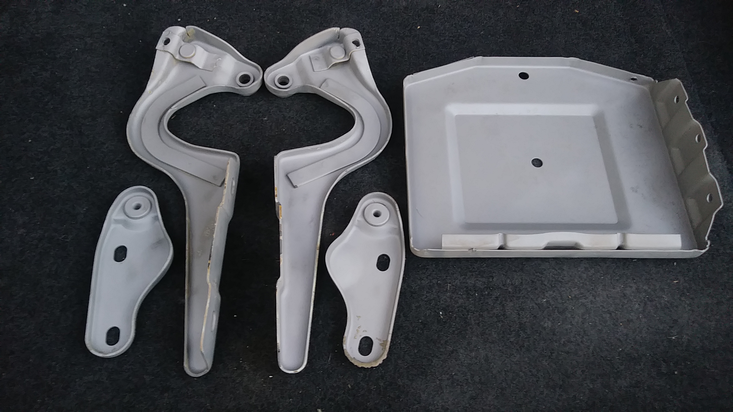

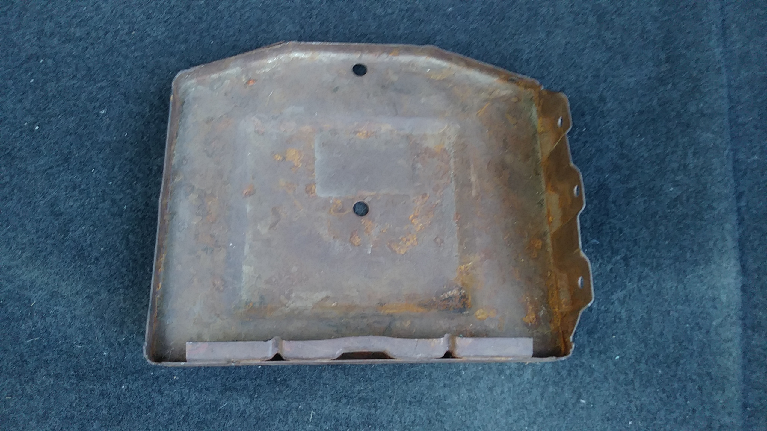

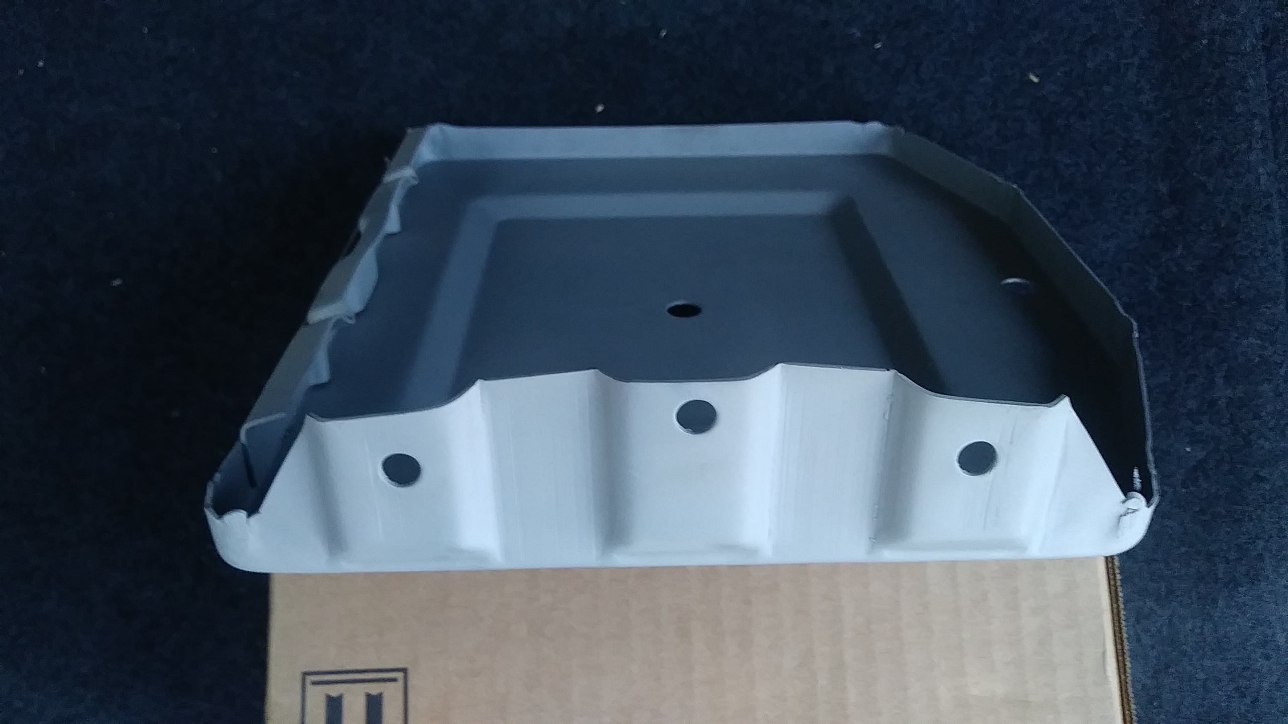

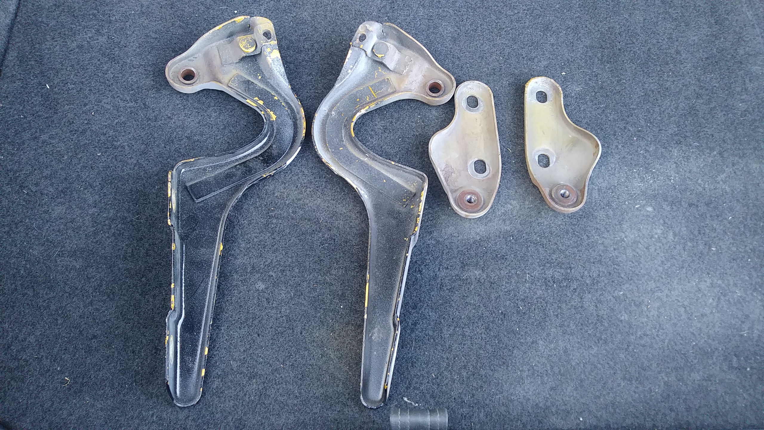

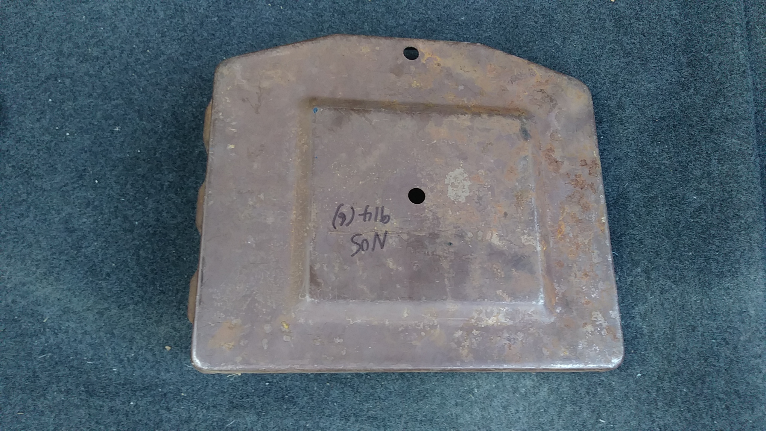

NOS battery tray. Blasted hood hinges.

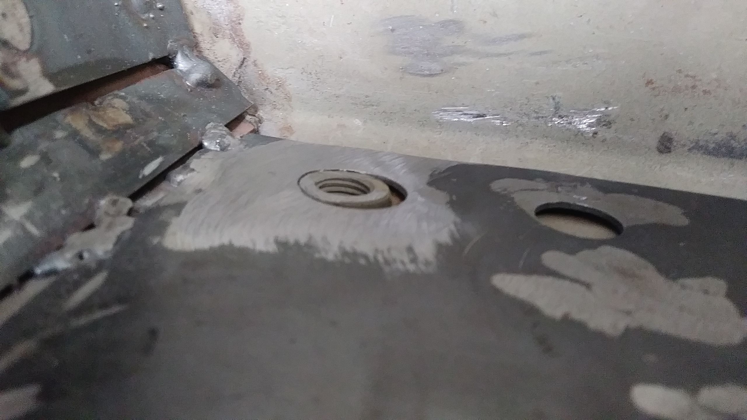

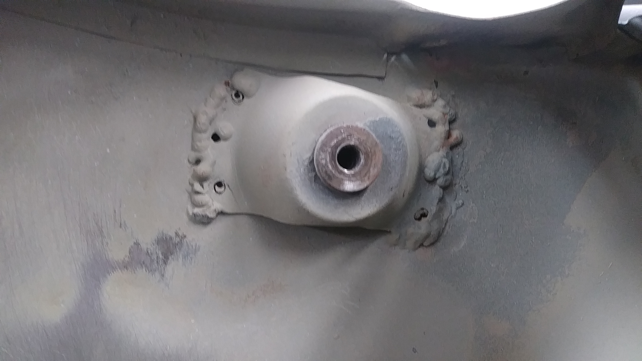

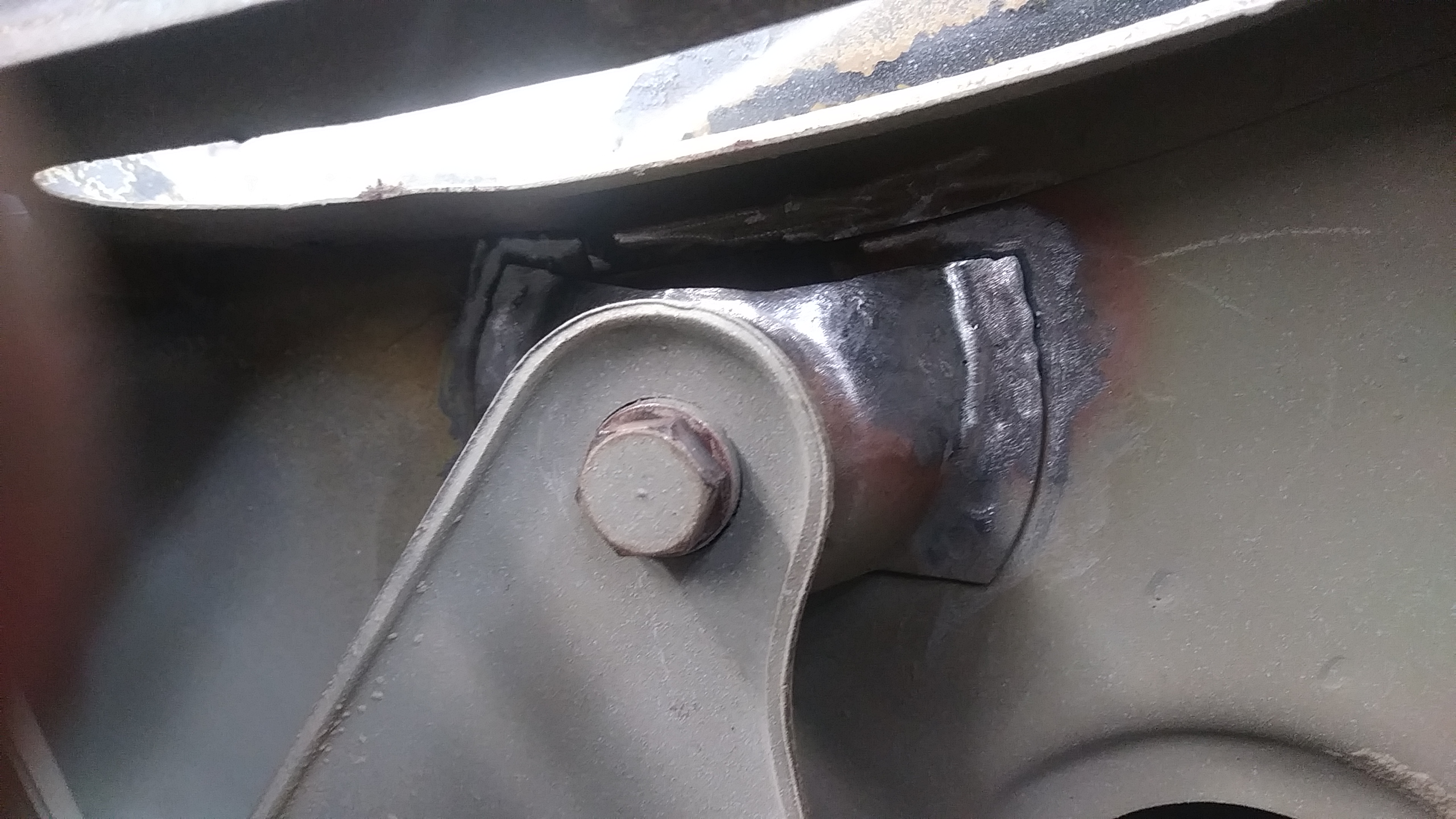

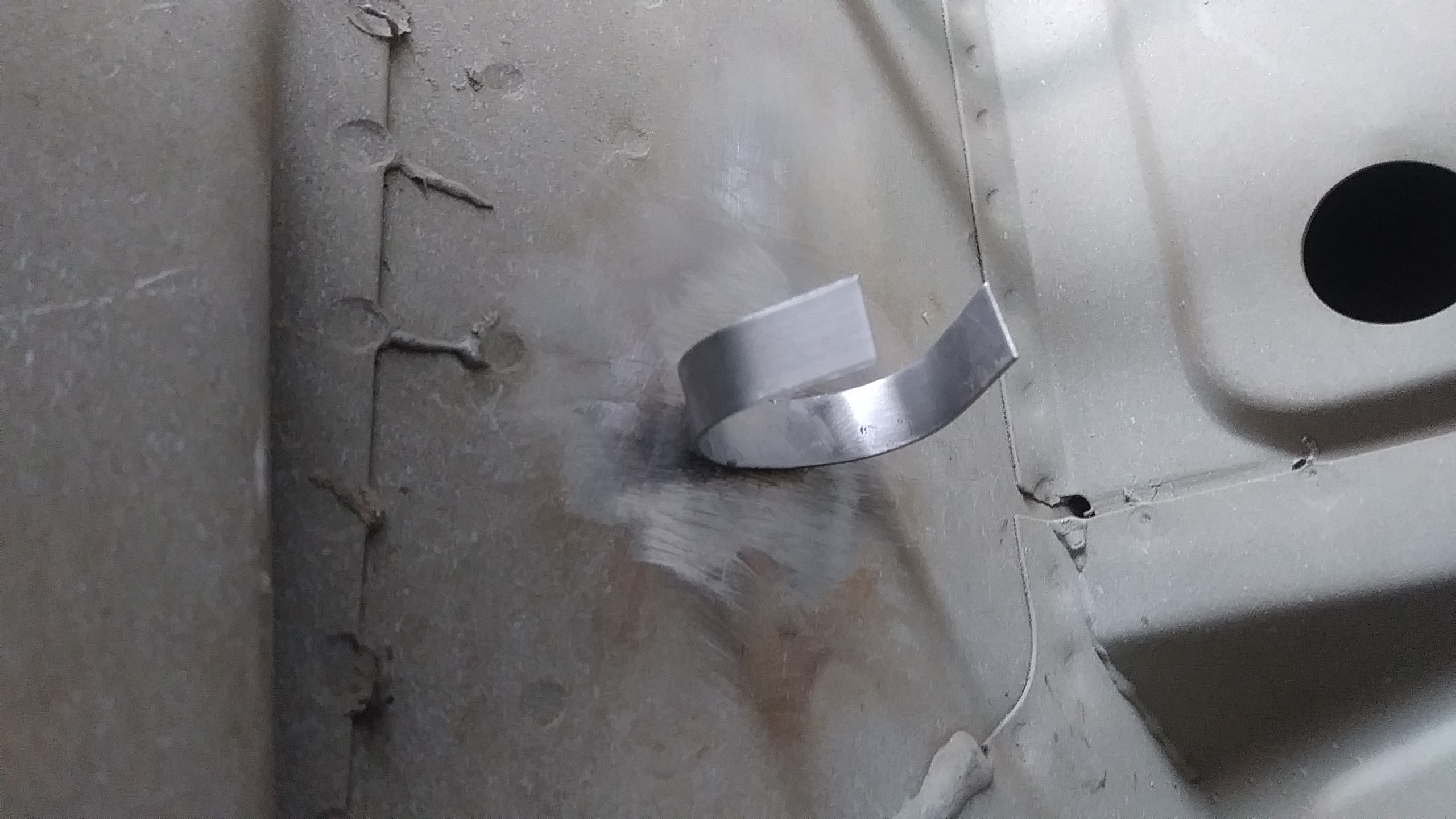

At some point someone welded in a long stiffening kit and welded over the seatbelt hole on the passenger side. I located it and drilled a hole then flushed the metal so that the belt can float/rotate as it should.

Thanks for correcting that work -

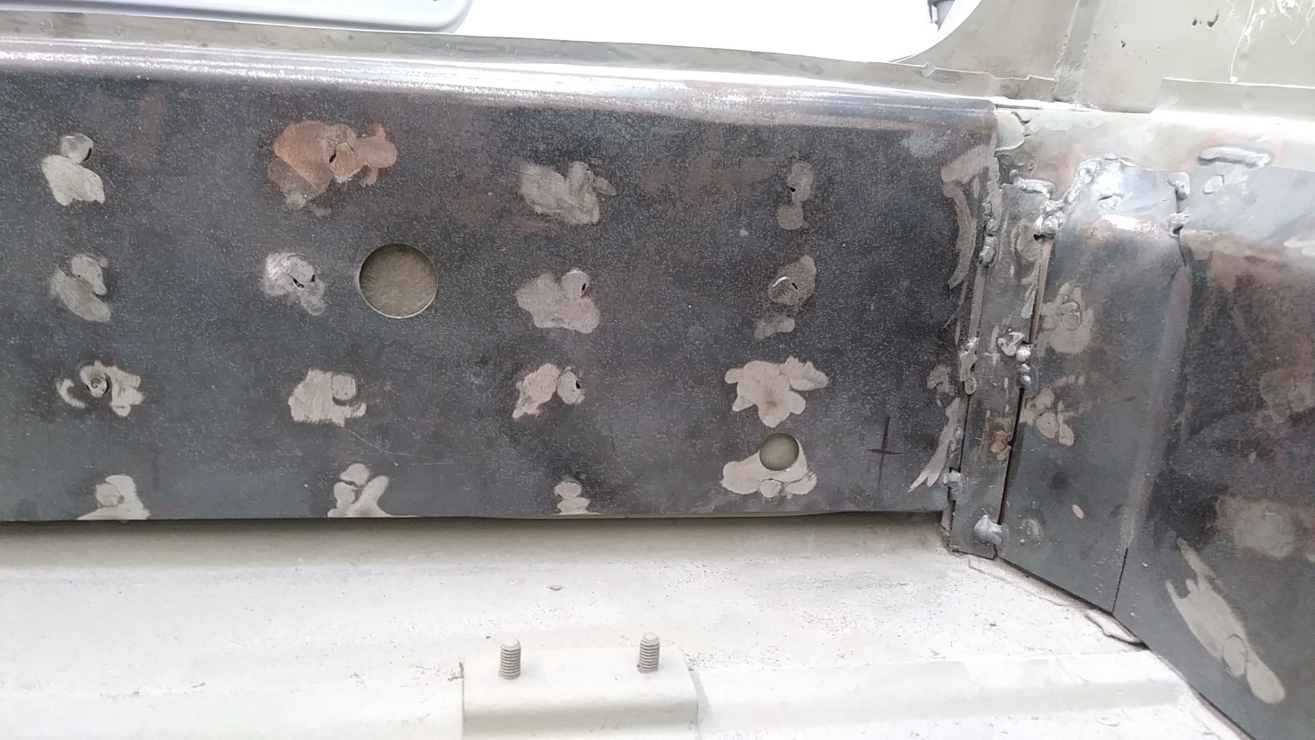

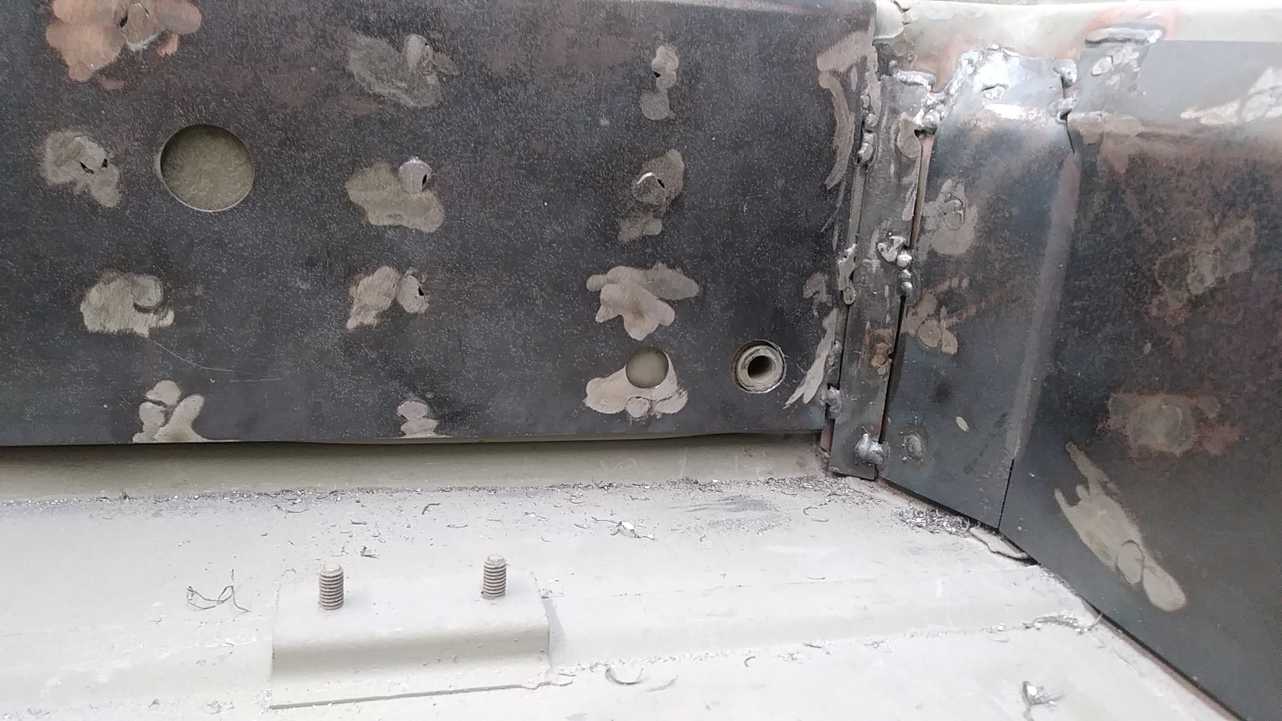

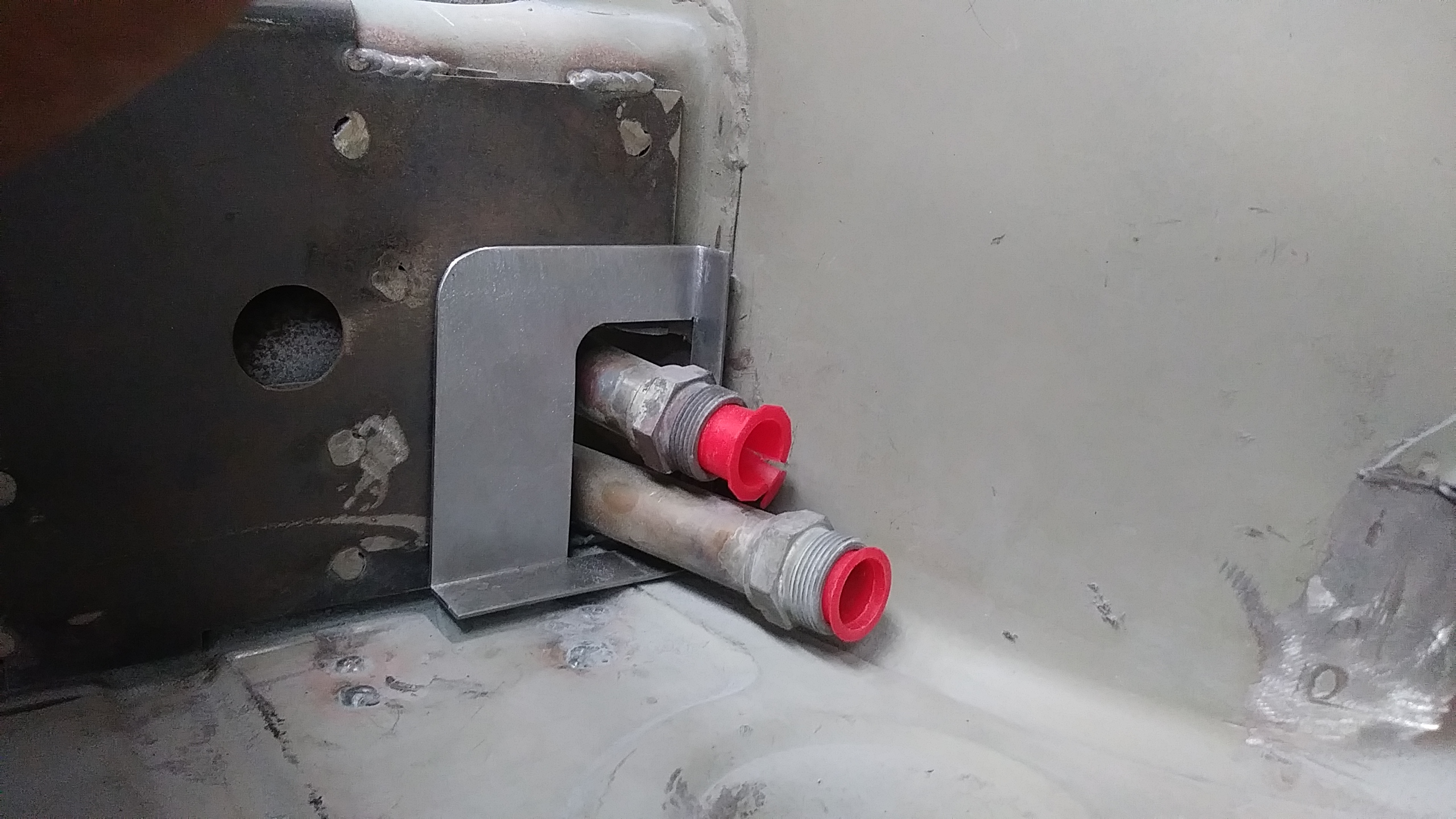

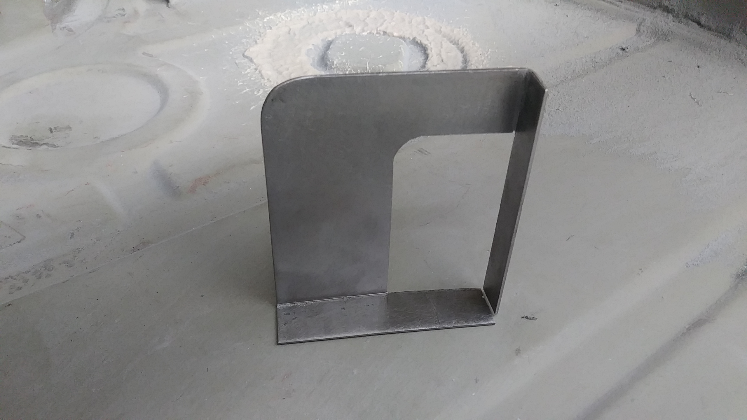

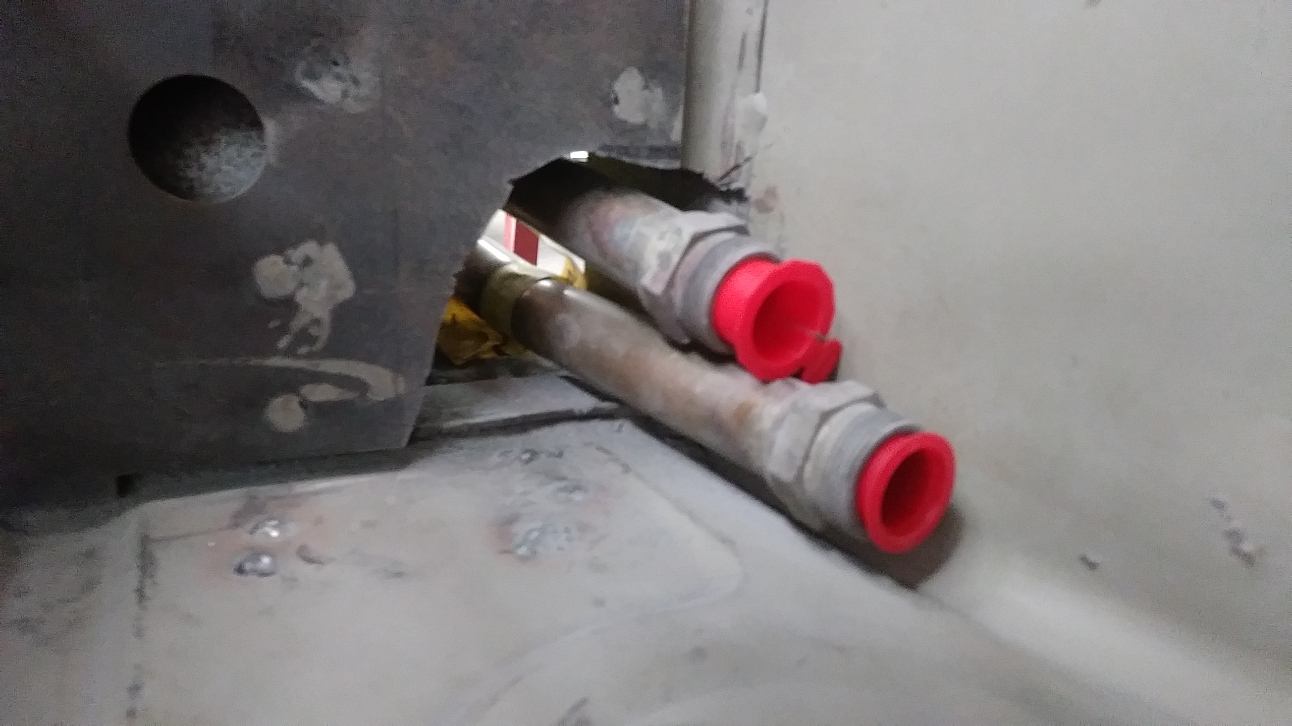

Working on cleaning up some of the holes that were previously cut in the long for the oil lines and to add some strength back to this area.

Kent that looks like it is going to be perfect. Thanks. (IMG:style_emoticons/default/beerchug.gif)

QUOTE(914350 @ Apr 13 2018, 07:27 PM) *
Worthing on cleaning up some of the holes that were previously cut in the long for the oil lines and to add some strength back to this area.
Looks great. I think Scott Amerson would call the opening an attack from an angry beaver.
Mueller
post Apr 13 2018, 07:36 PM
Post #693
914 Freak!
Posts: 17,155
Joined: 4-January 03
From: Antioch, CA
Member No.: 87
QUOTE(mepstein @ Apr 13 2018, 05:38 PM) *
Not even my car and that cut angered me!
Nice cover plate.

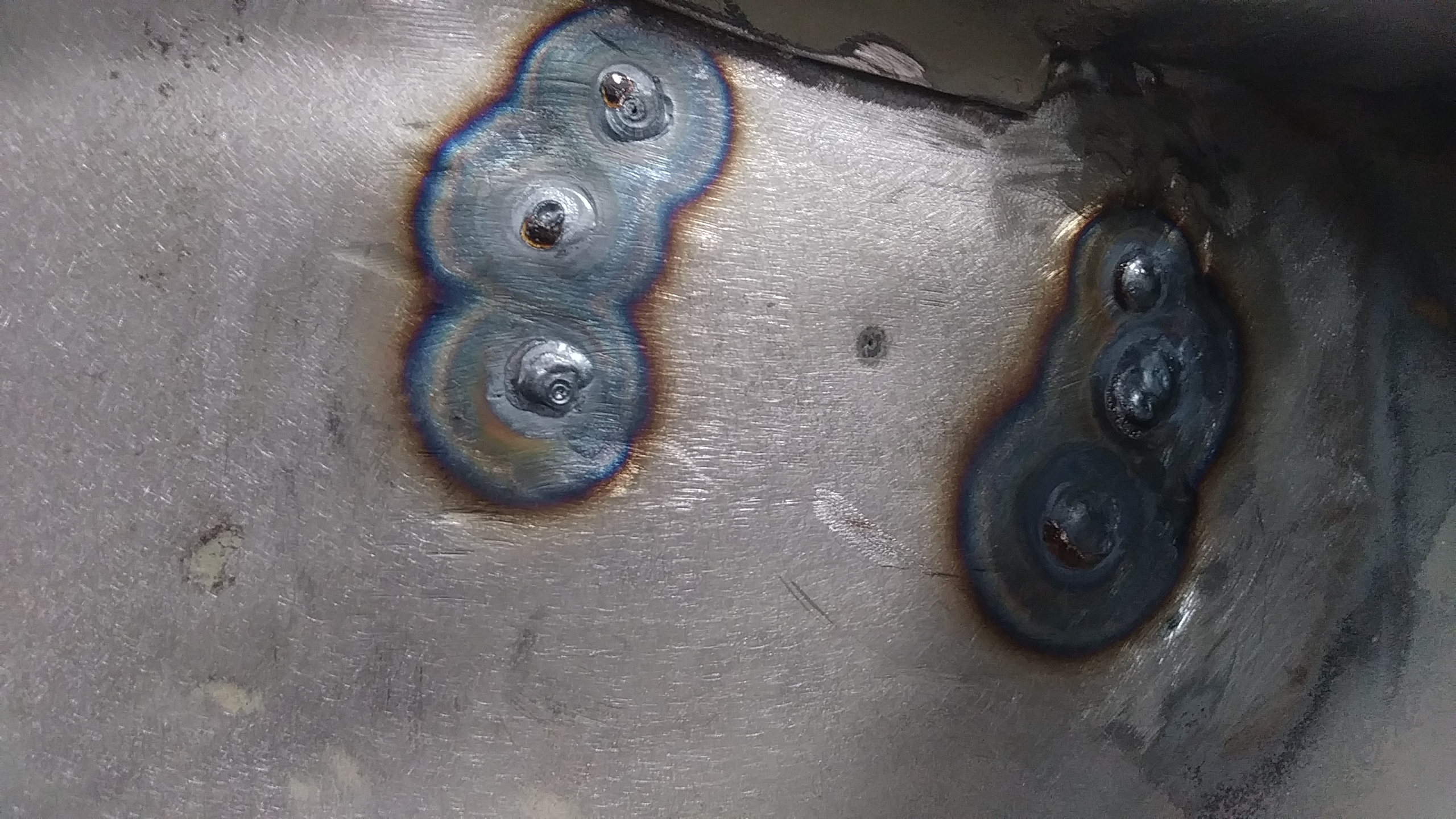

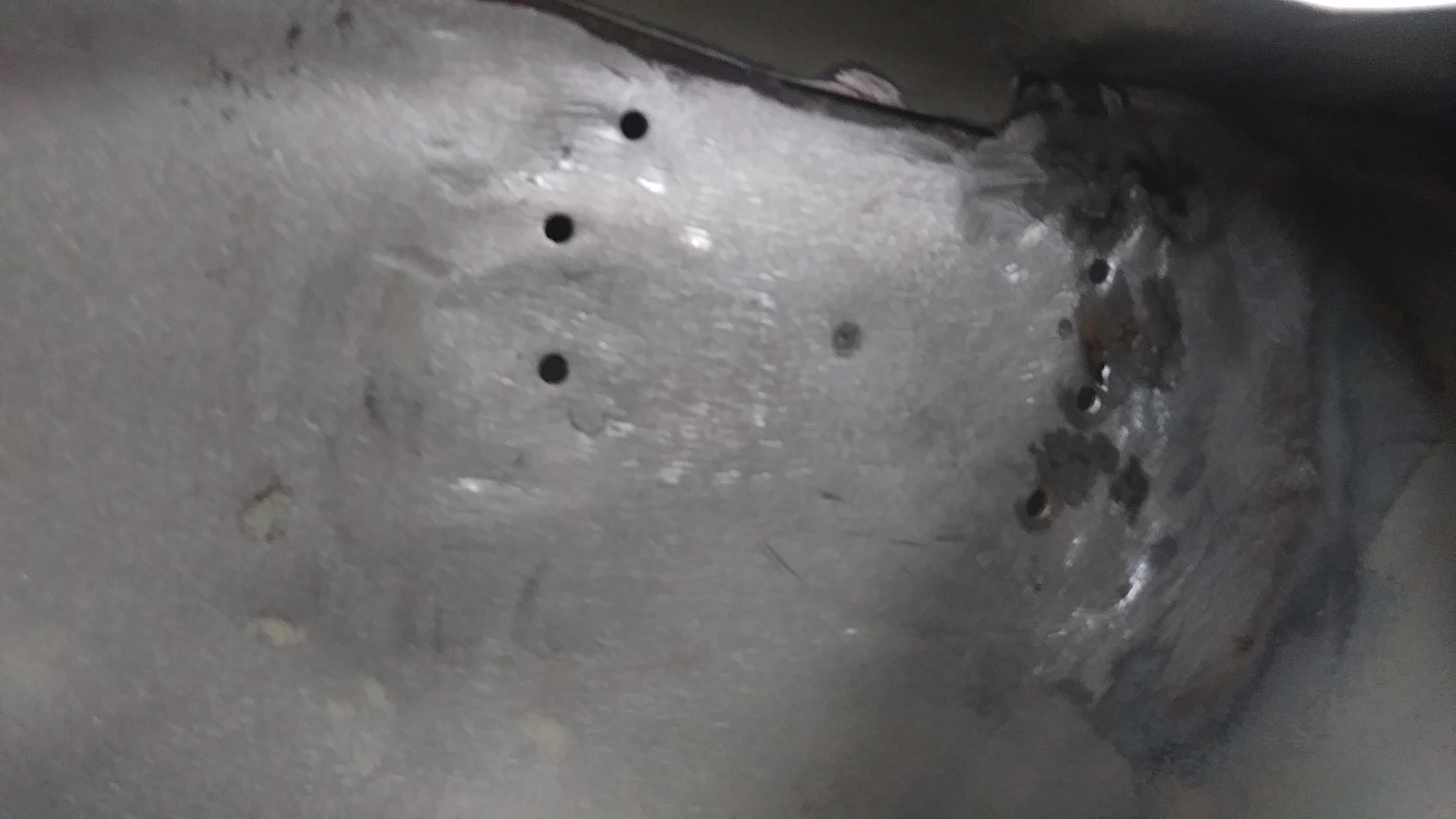

Pics.

All the way down to the last detail...
Kent, I'm changing the name of your shop to "Relentless Restorations"
The attention to the smallest detail is beyond impressive.
