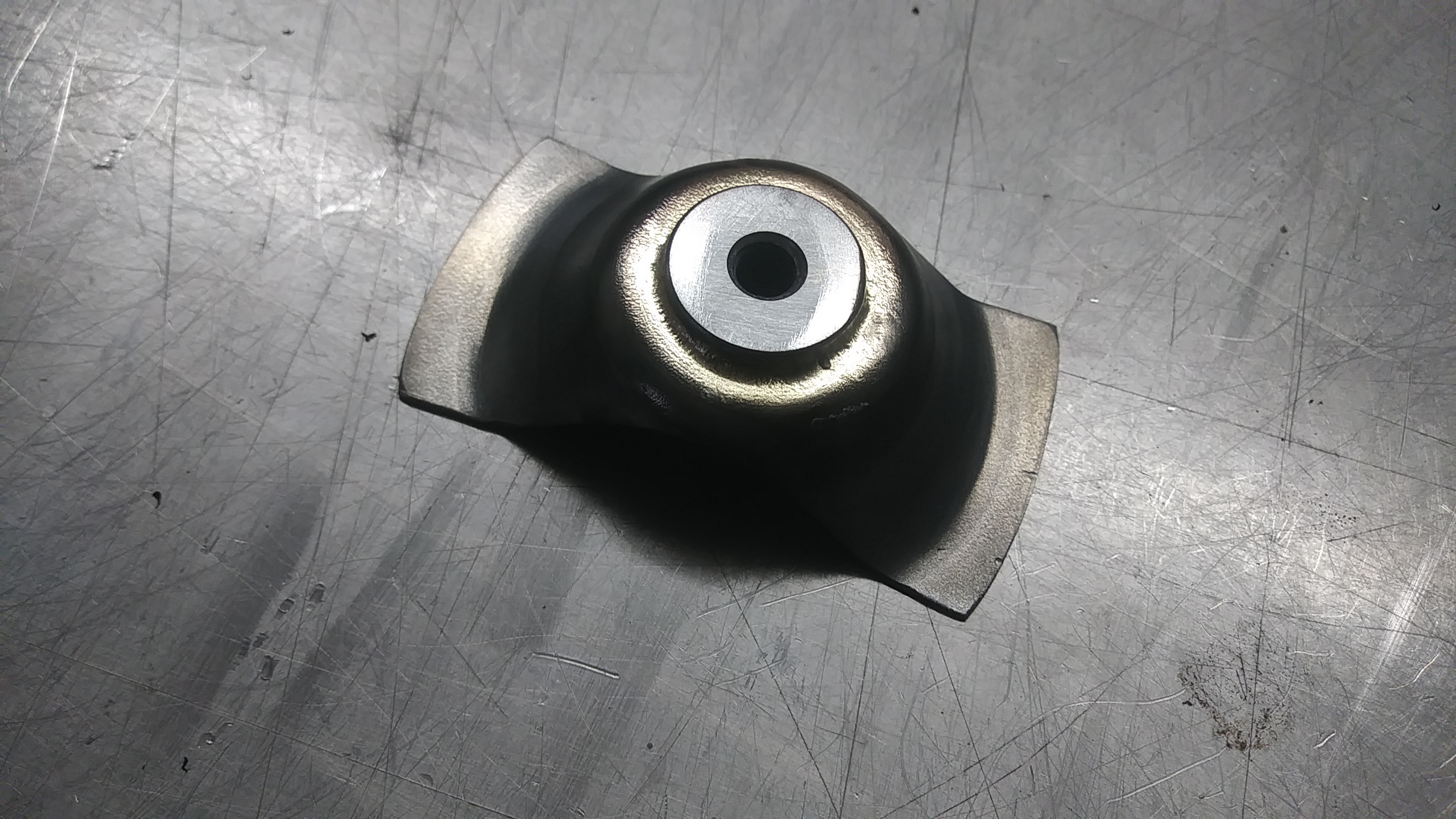

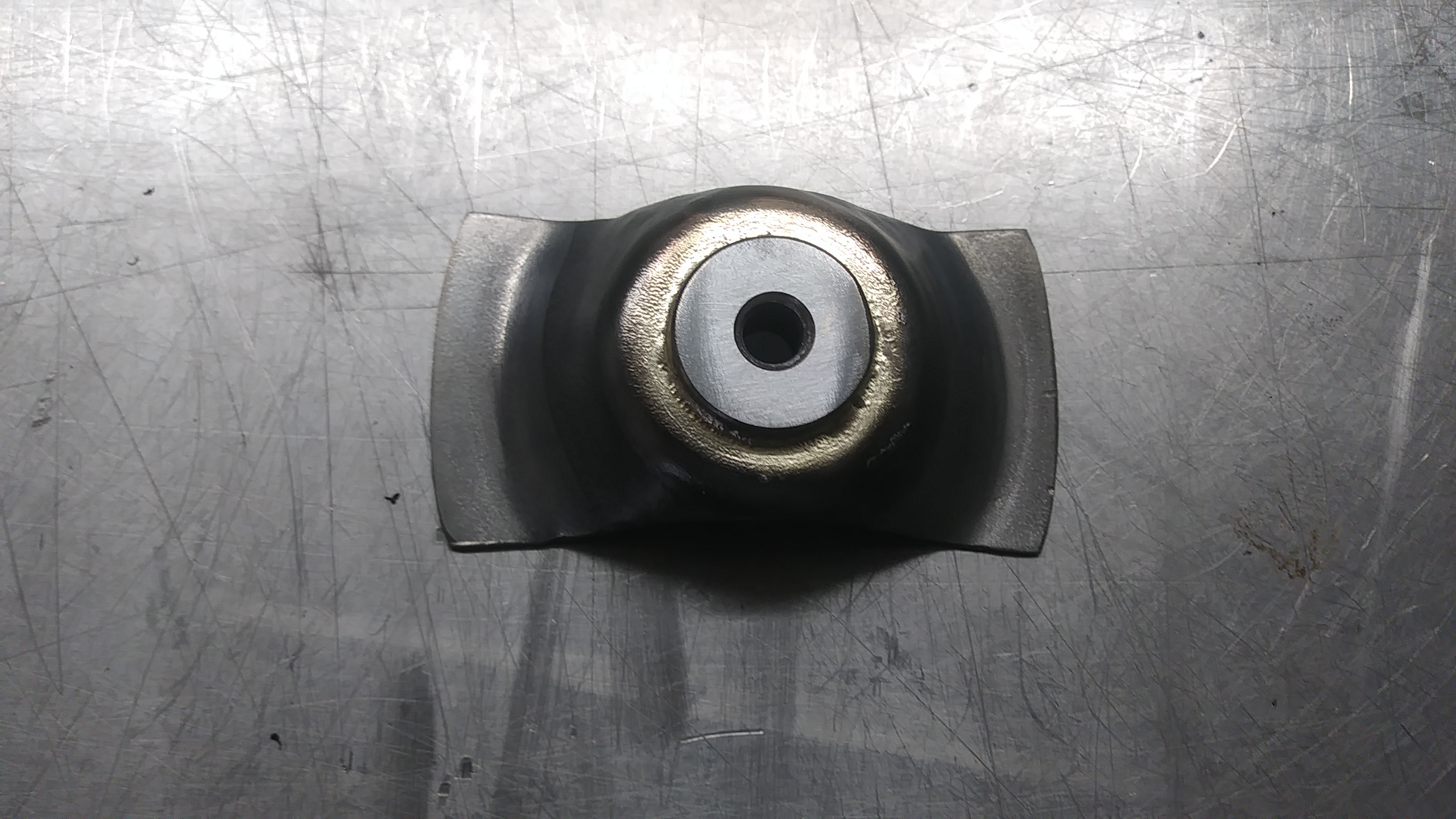

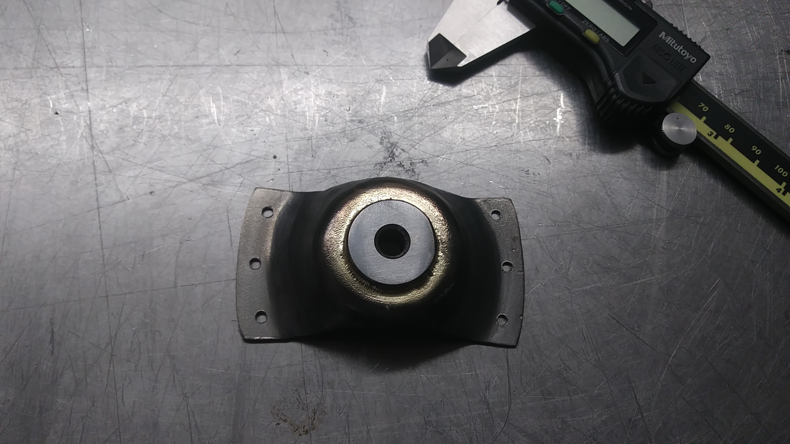

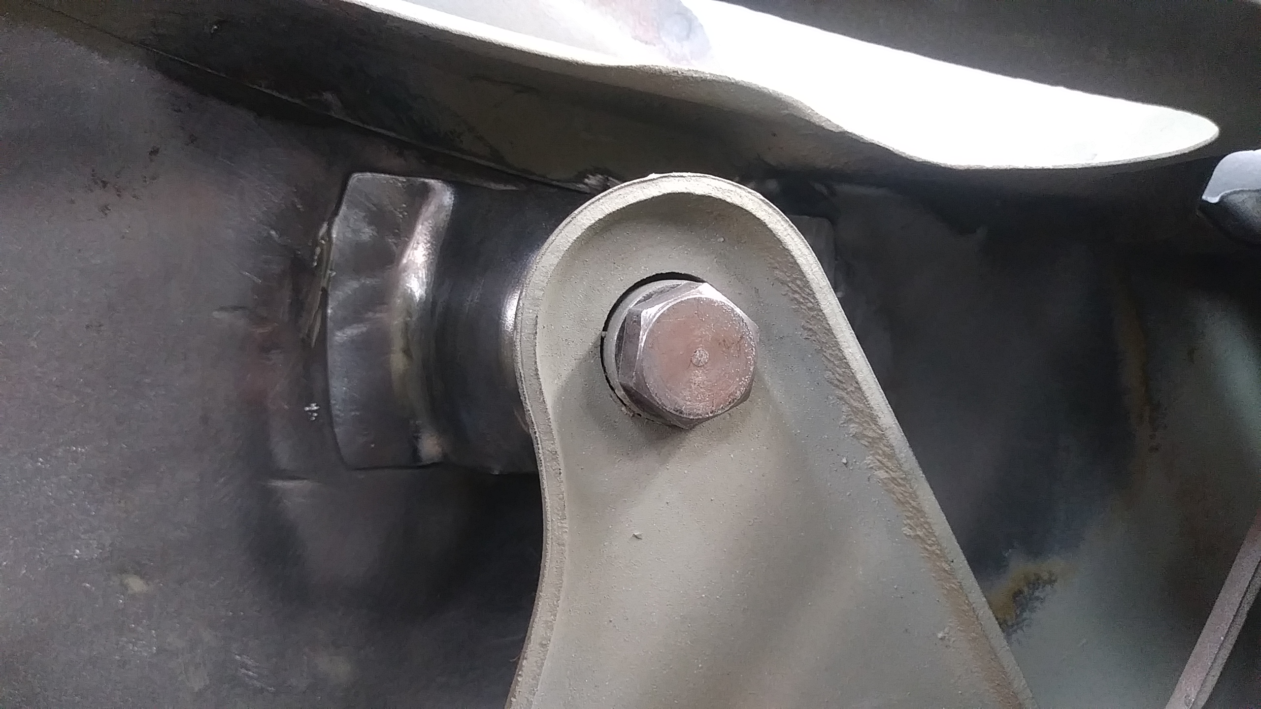

A lot of work went into the hinge mount. Stripped off all the plating, tapped out the body of the hinge (round) removing the waves left from the stamping process and plannished the foot on each side to make a flat solid foot and rounded the foot slightly like the originals. I brazed in the bung and lapped the mating surface. A great piece to start with for sure but just dialed it in.

Next World level work. Most times when I look into an engine bay and see the trunk hinges I cringe as the welds holding the hinge mount look so bad. I know this will look very nice- the hinge mount looks beautiful. (IMG:style_emoticons/default/beerchug.gif)

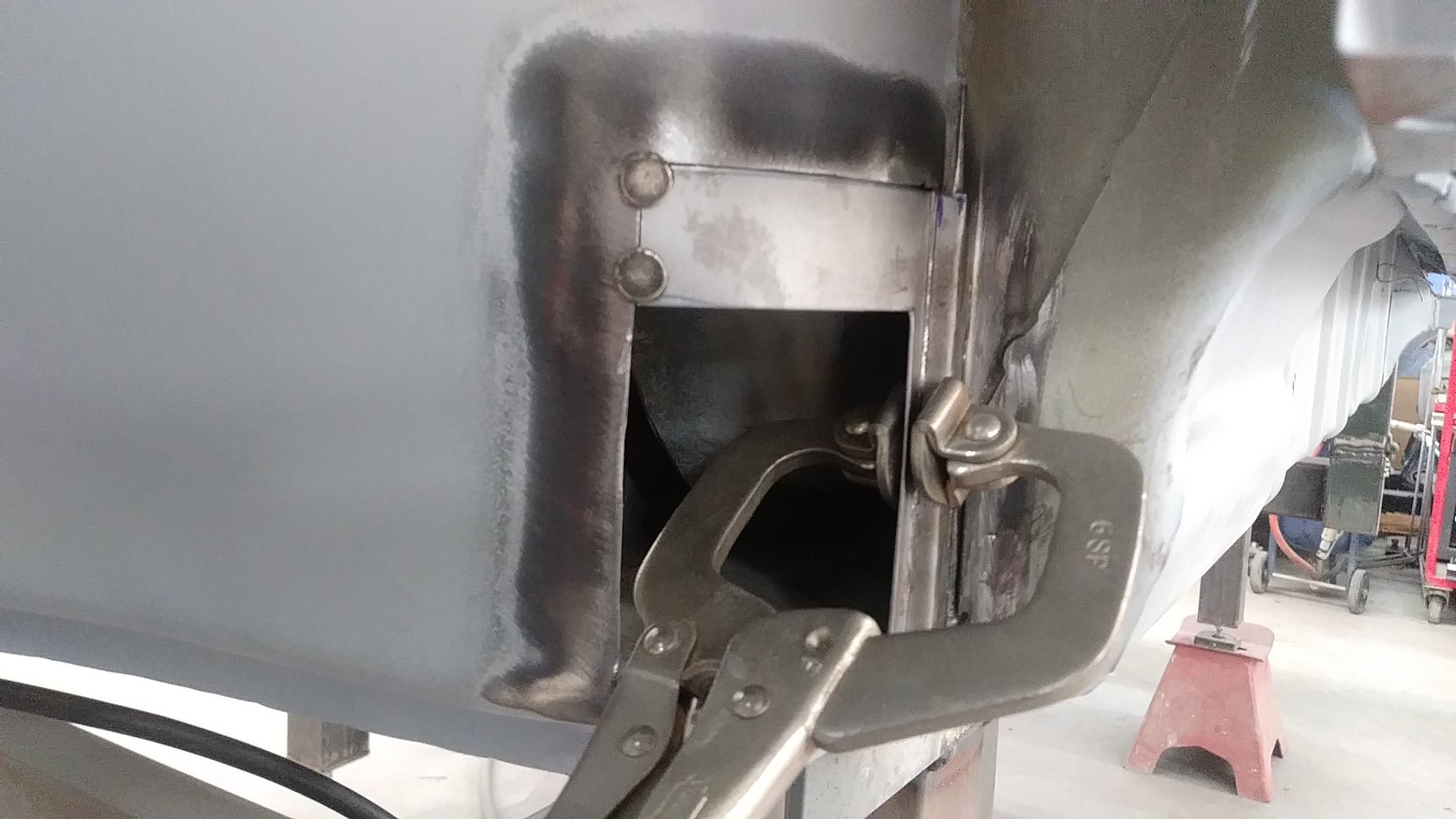

Progress.

Oh this is going to really make me mad. I've done this same repair and I know I'm about to be shamed. (IMG:style_emoticons/default/smile.gif) (IMG:style_emoticons/default/popcorn[1].gif)

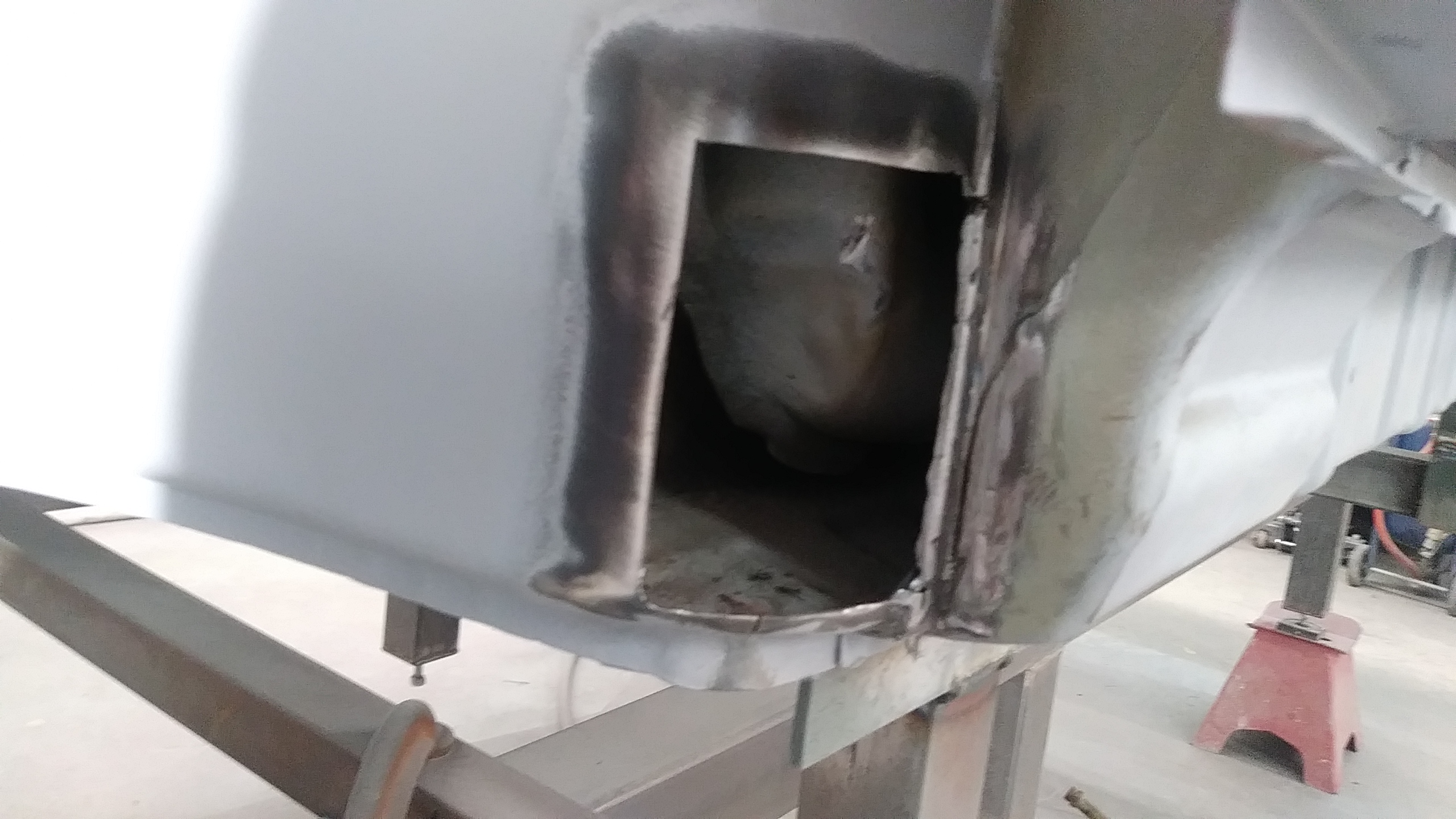

Blocking panels.

As usual, Kent's fix is excellent and perfect.
Does he walk on water too? (IMG:style_emoticons/default/confused24.gif)

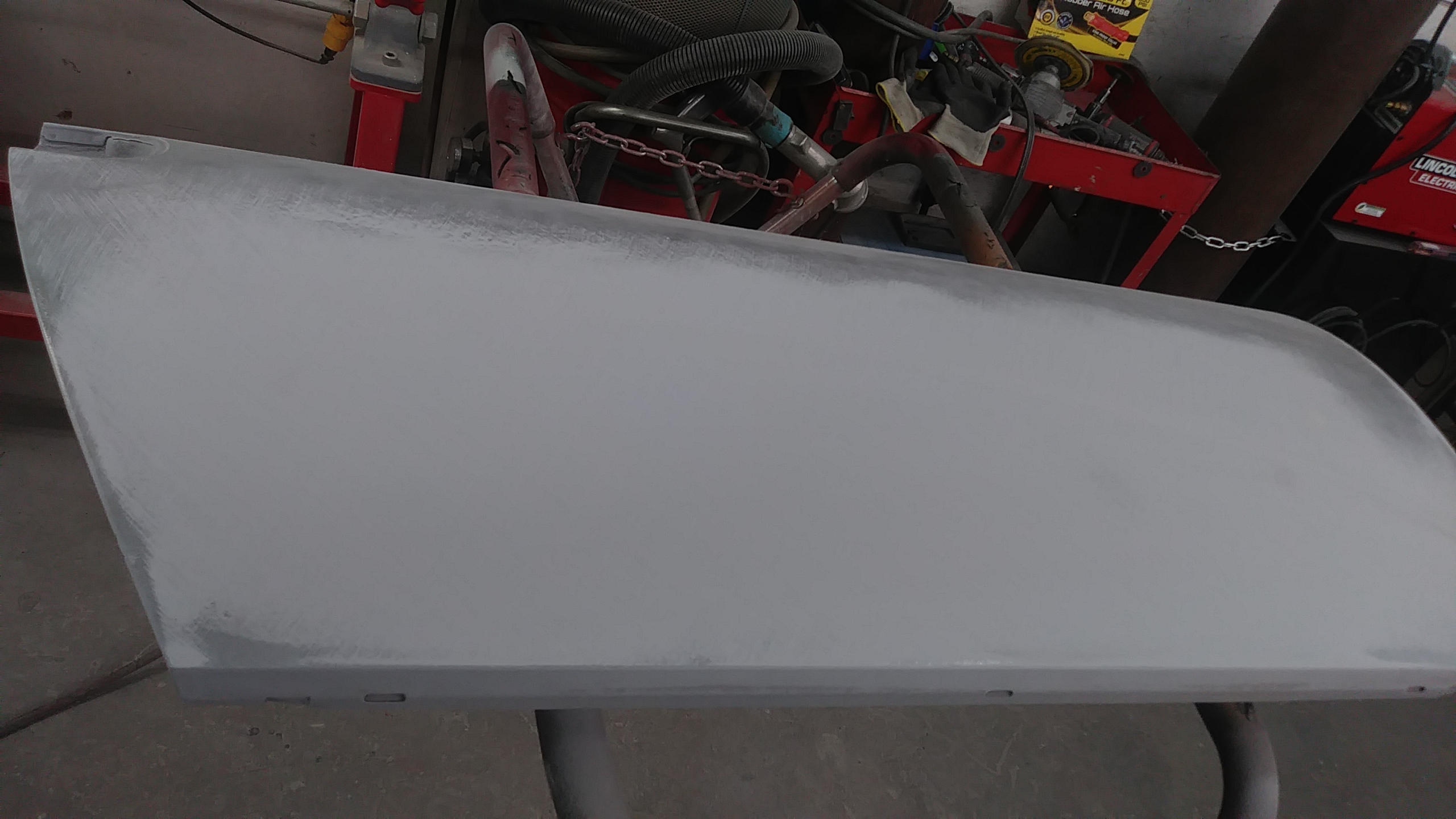

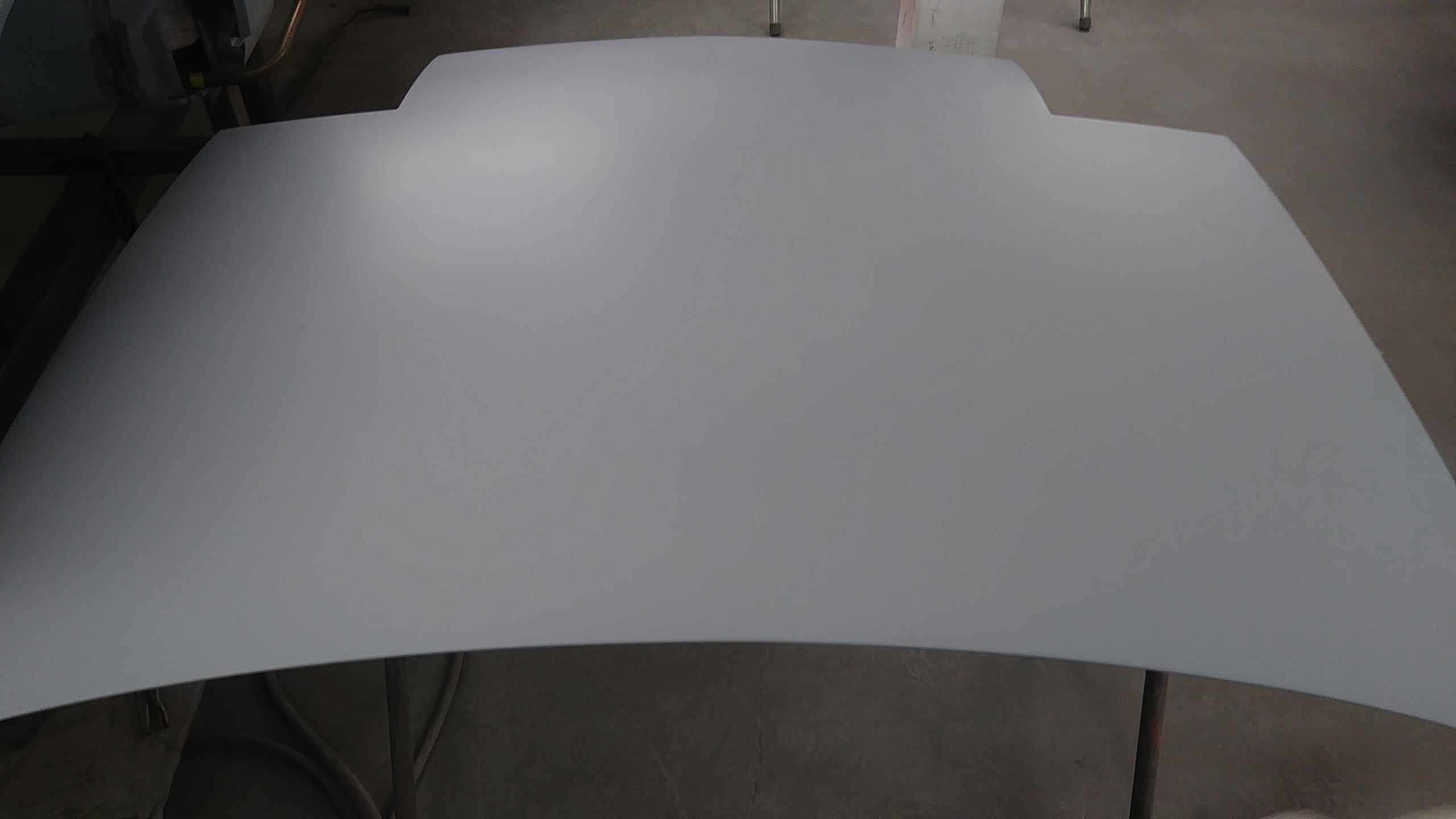

Blocked and primered.

That thing is going to look great in gold... (IMG:style_emoticons/default/beerchug.gif)
