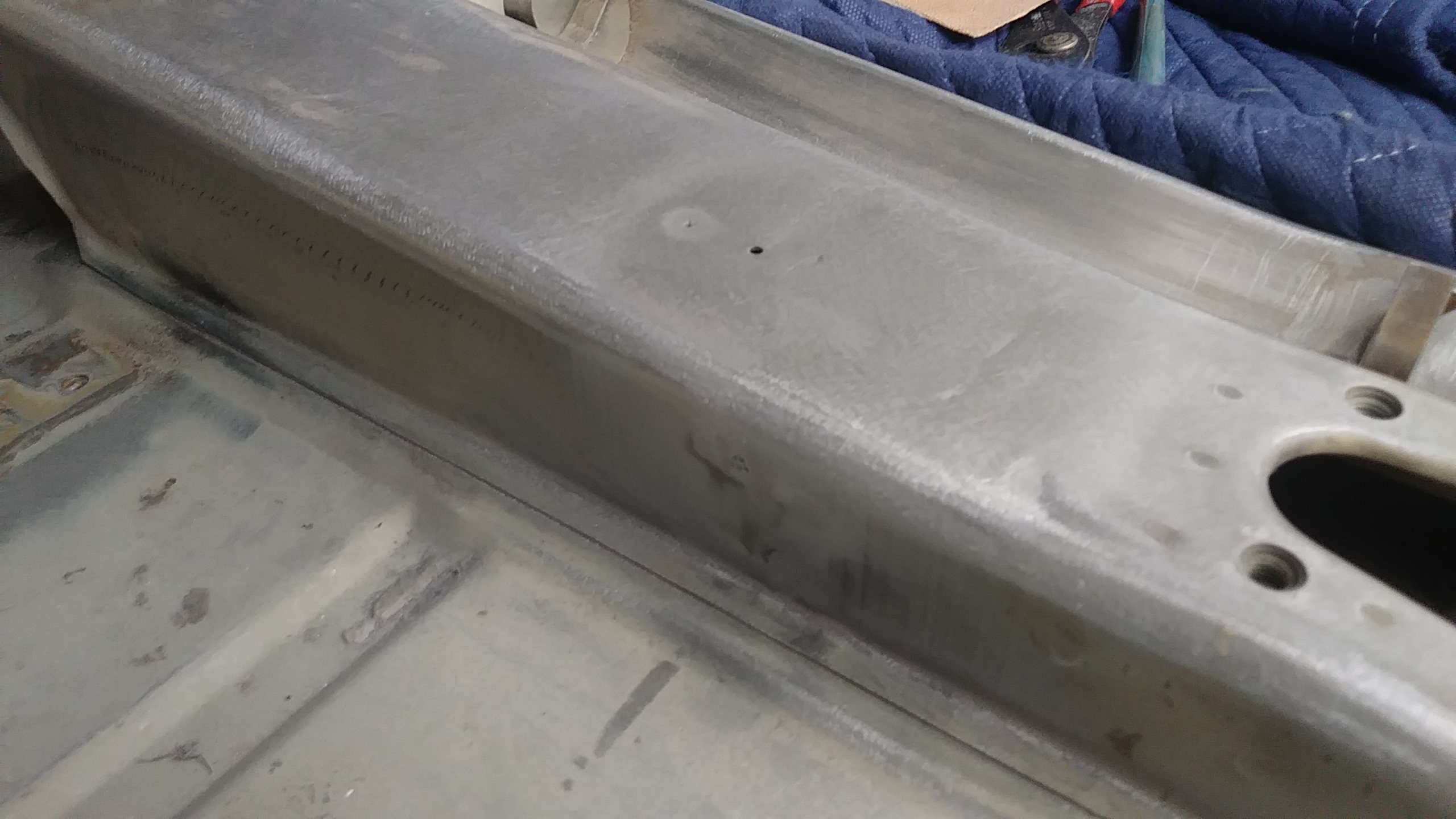

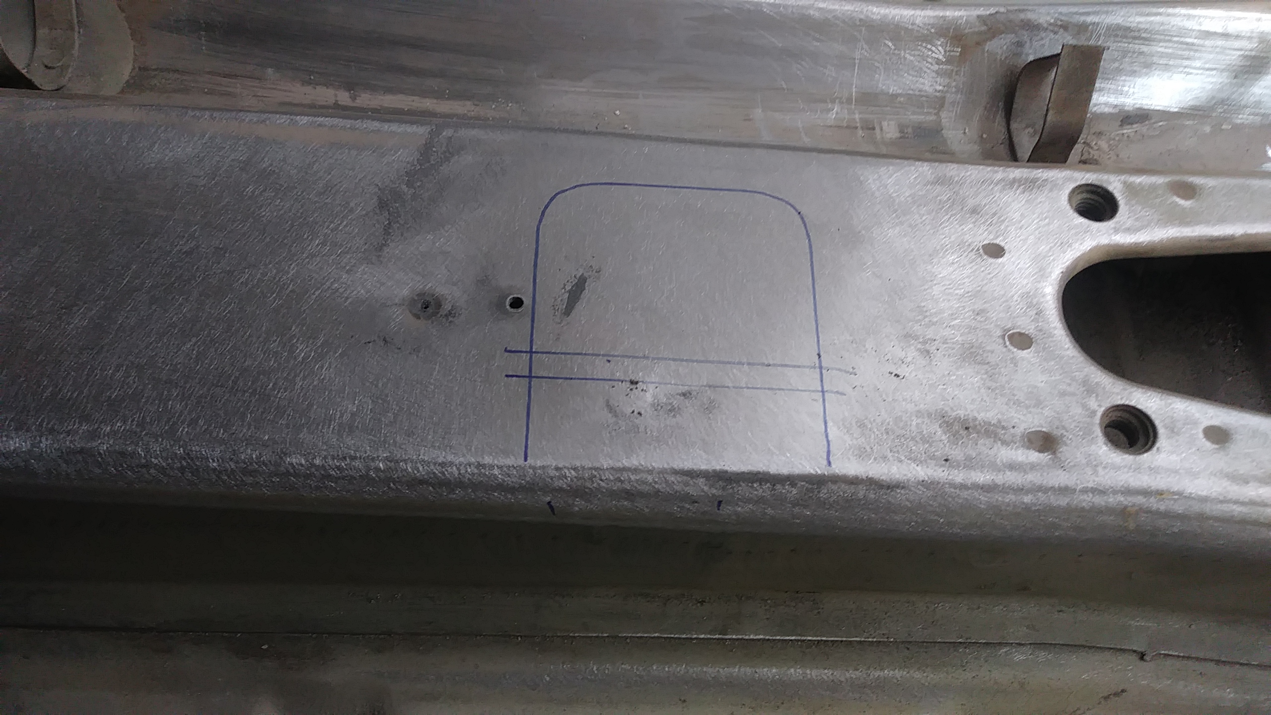

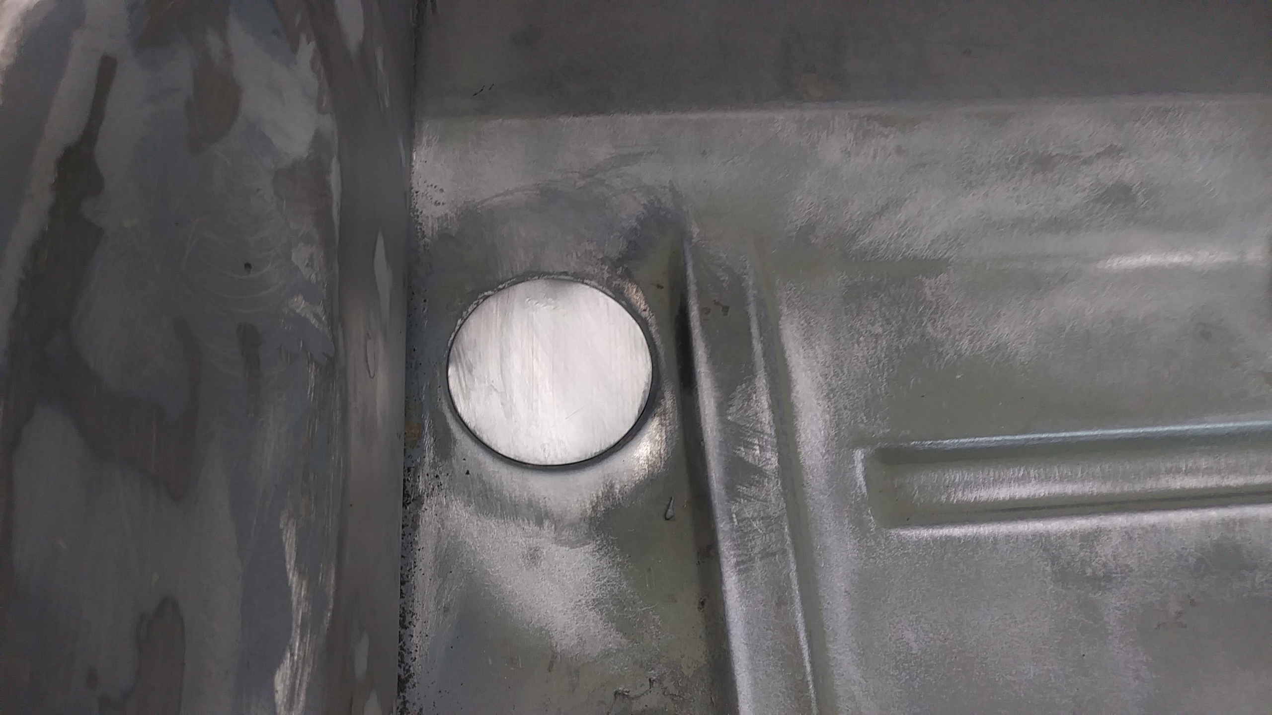

Progress. Someone had cut a large hole for running oil cooler lines.

Beautiful, simply beautiful. (IMG:style_emoticons/default/smilie_pokal.gif)
bbrock
post May 1 2018, 12:15 PM
Post #724
Posts: 5,269
Joined: 17-February 17
From: Montana
Member No.: 20,845
I suspect sorcery is at play here. Anyone who has attempted this kind of repair knows how freakin' hard that is. Simply amazing! (IMG:style_emoticons/default/pray.gif)

I can absolutely, positively tell everyone, when my car left CA it had no such hole. When it arrived at Kent's shop 5 years 1 month later, that hole was there. So......
That repair is stunningly beautiful. (IMG:style_emoticons/default/smilie_pokal.gif) (IMG:style_emoticons/default/beerchug.gif)

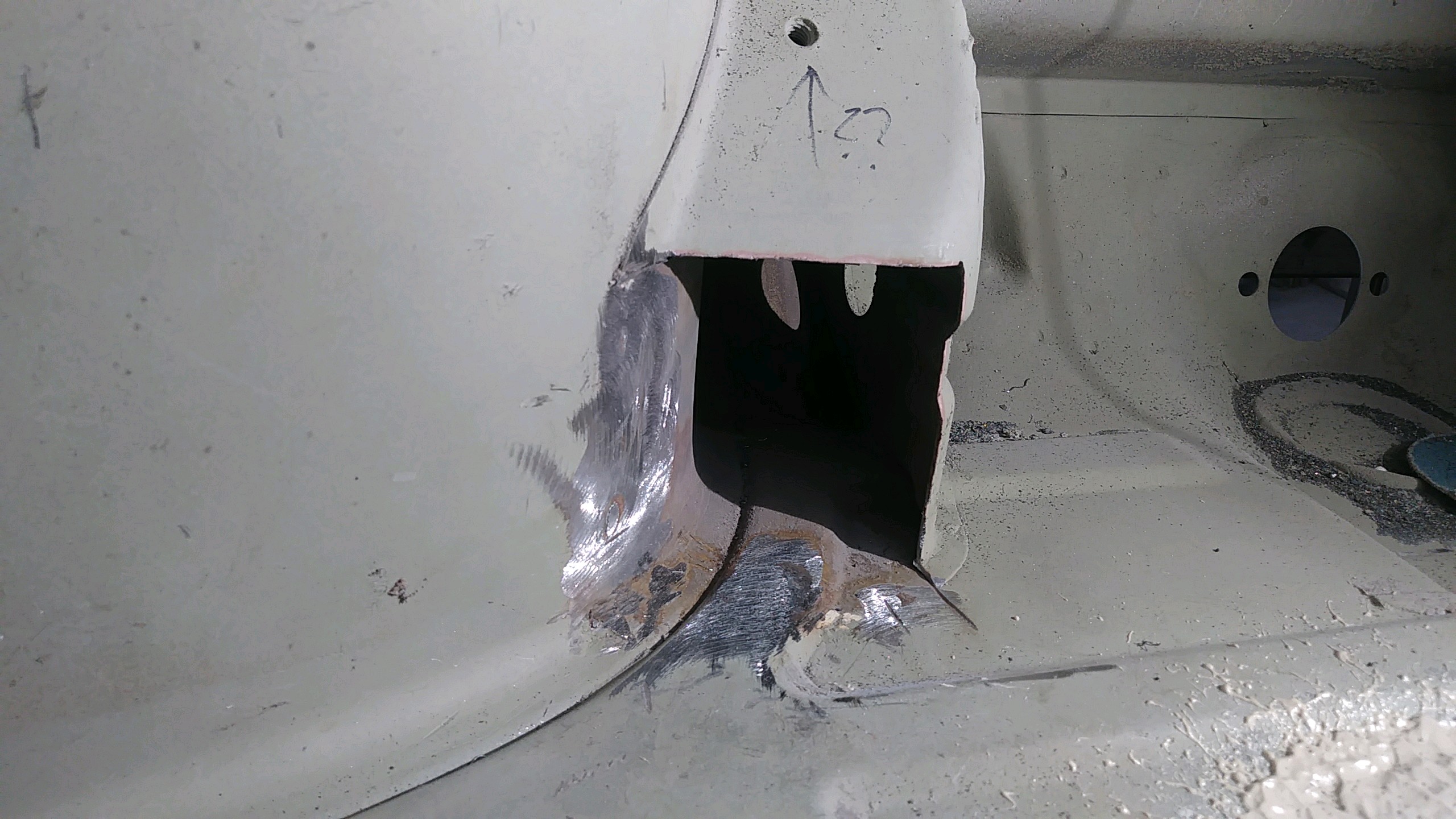

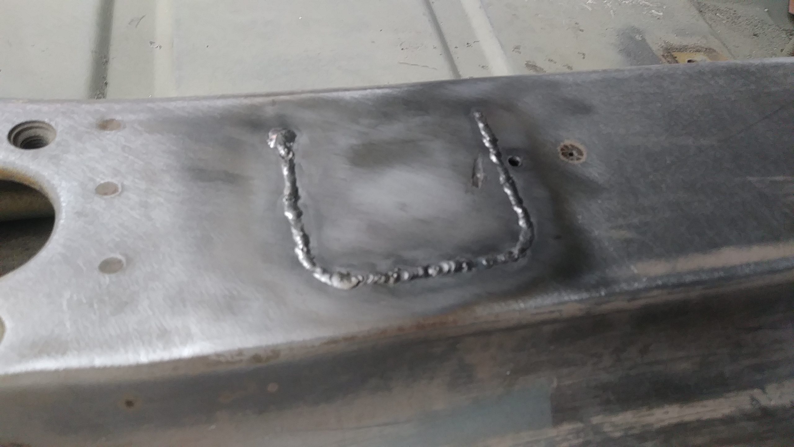

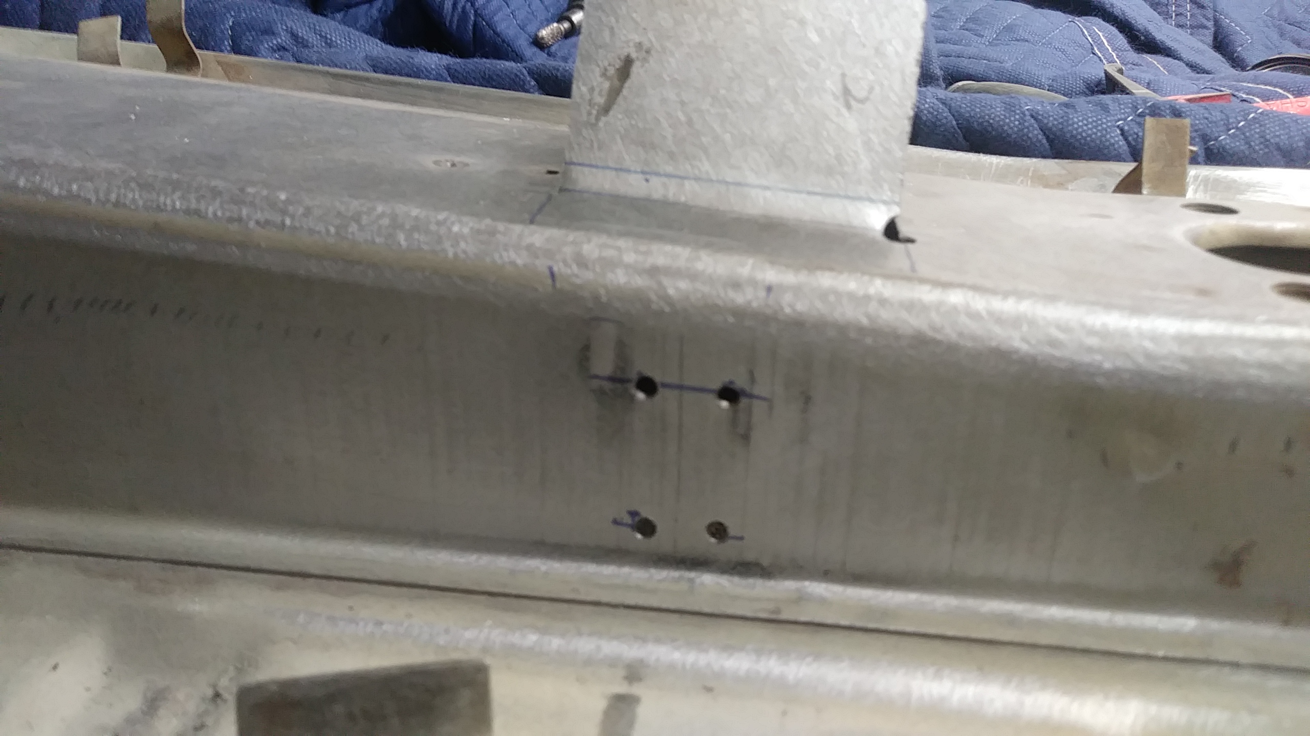

Fixing where clutch cable housing/tube had broken loose.

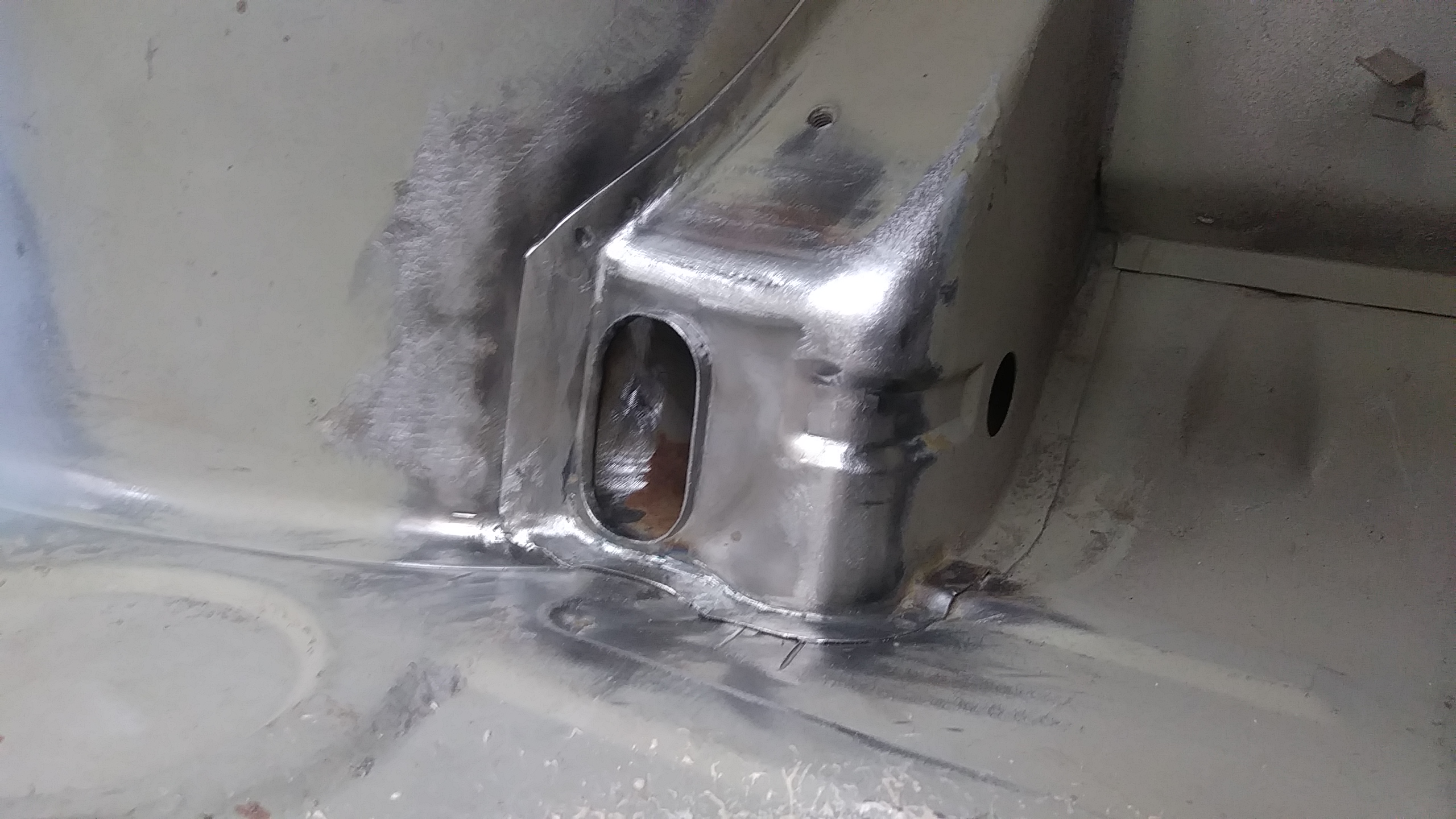

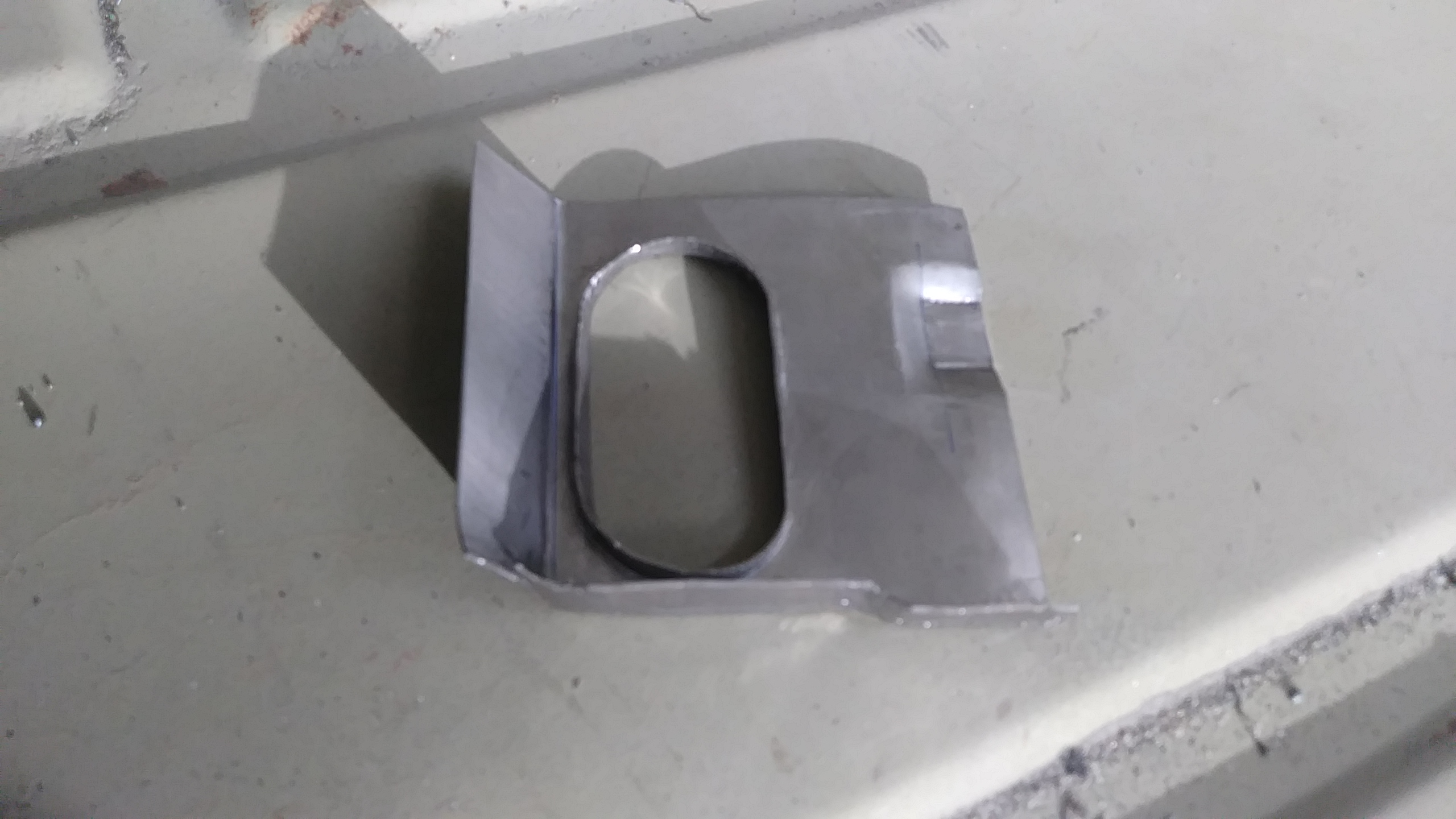

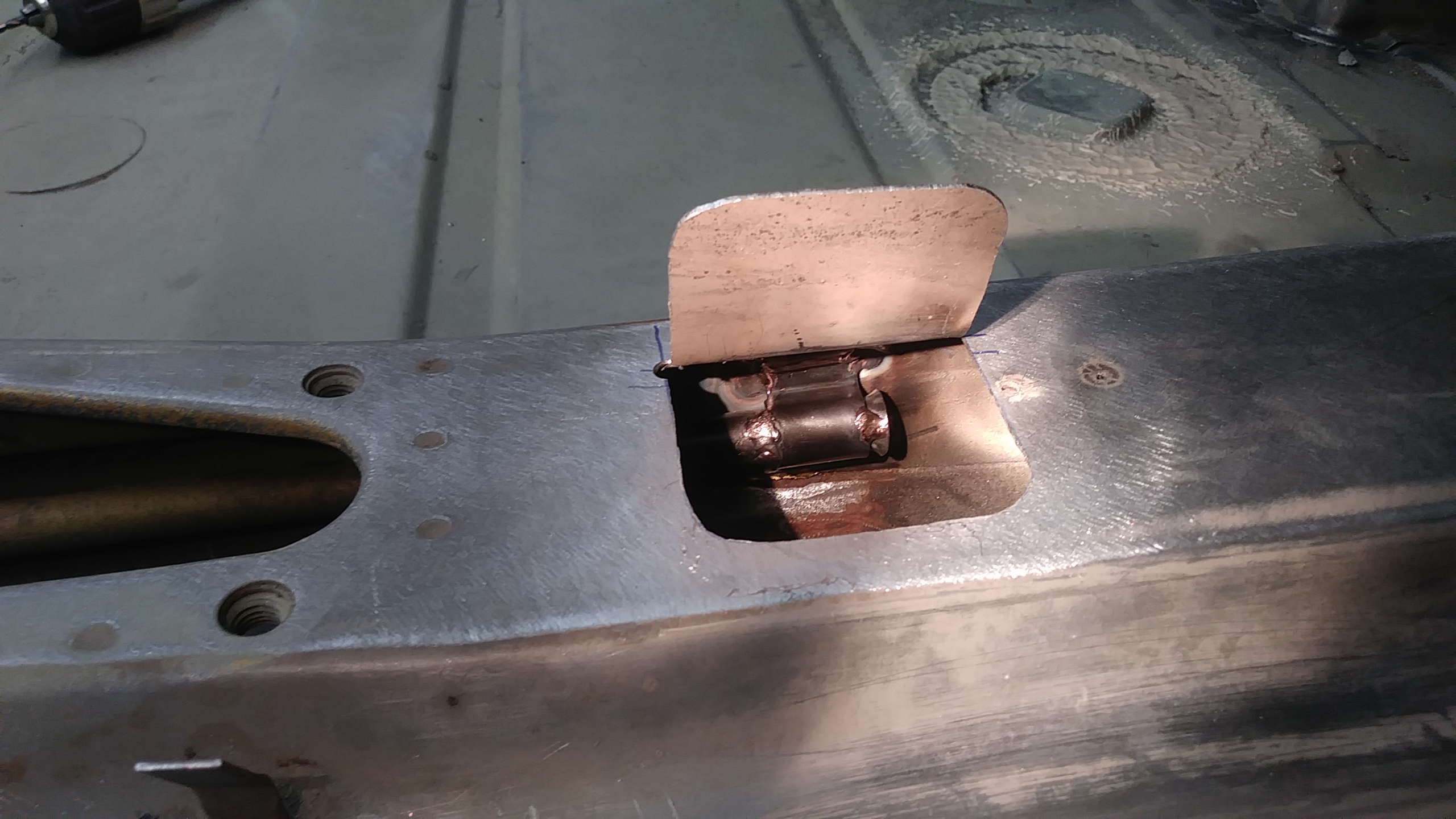

More.

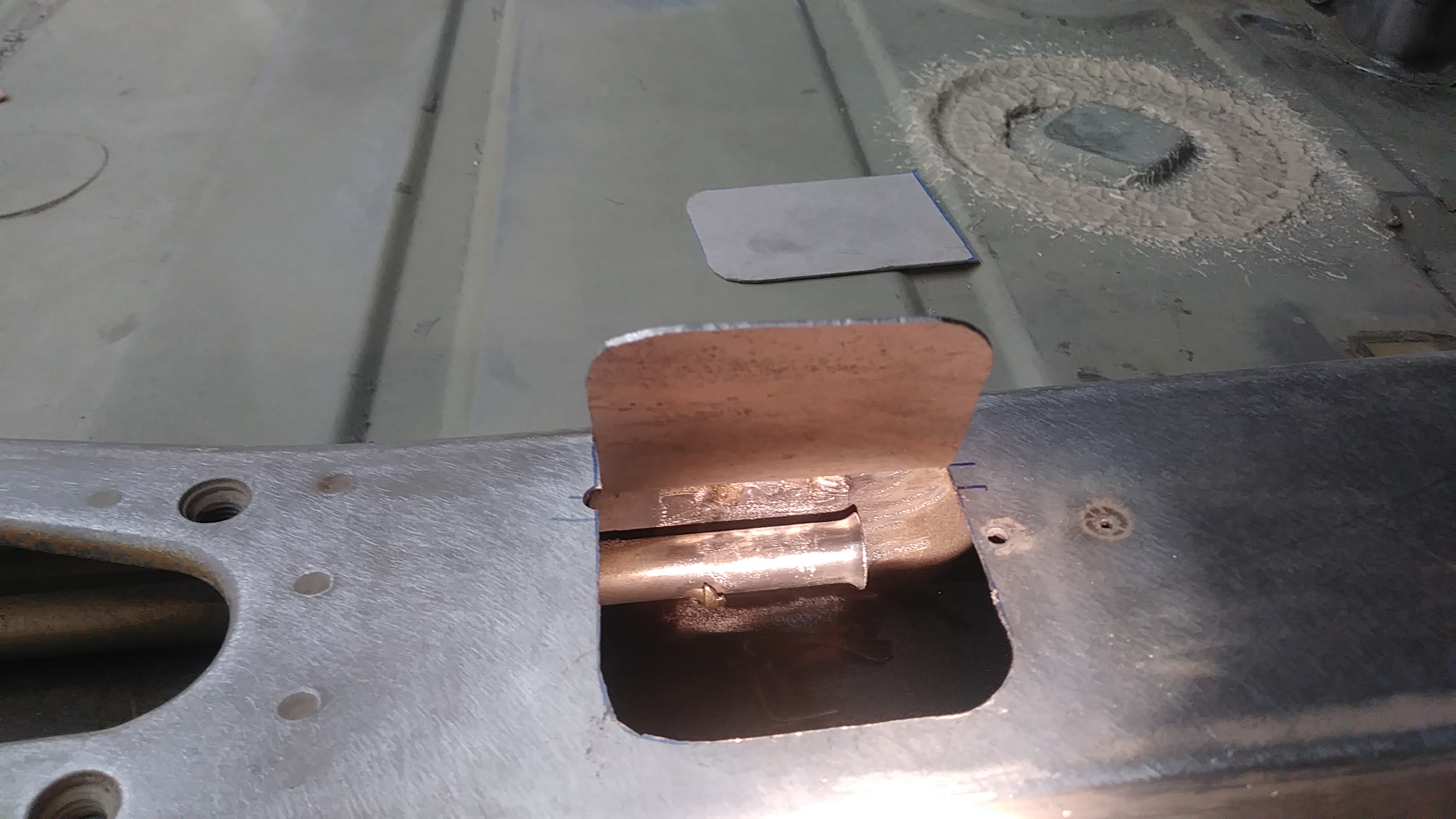

Drilled holes and plug welded in from the back, also bracket is welded in the front and tube is silicon bronzed to the bracket.

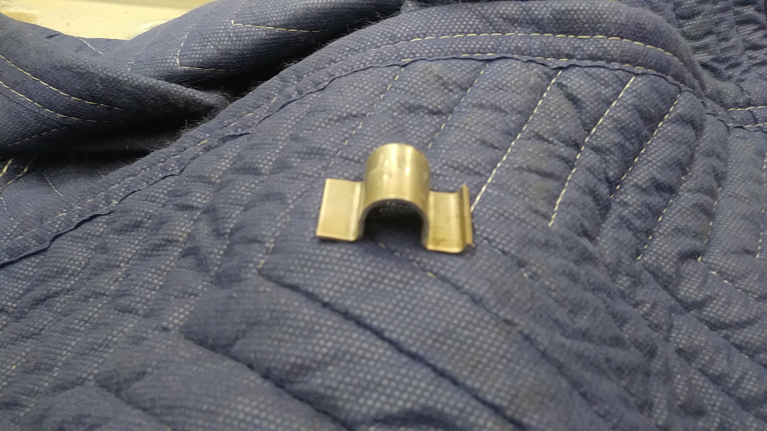

Was missing one so I made one and gooped it in.

QUOTE(914350 @ May 3 2018, 11:34 AM) *
Hey Kent, I need to make one of those too. Did you punch that out or ????
914350
post May 3 2018, 12:59 PM
Post #738
Posts: 548
Joined: 21-April 14
From: Torrance Ca.
Member No.: 17,275
QUOTE(bbrock @ May 3 2018, 10:37 AM) *
No I don't have a punch that large so I cut it with shears and finished the edges on the sander.
mb911
post May 3 2018, 01:01 PM
Post #739
Posts: 7,667
Joined: 2-January 09
From: Burlington wi
Member No.: 9,892
Could also use a hole saw in a drill press if needed..
