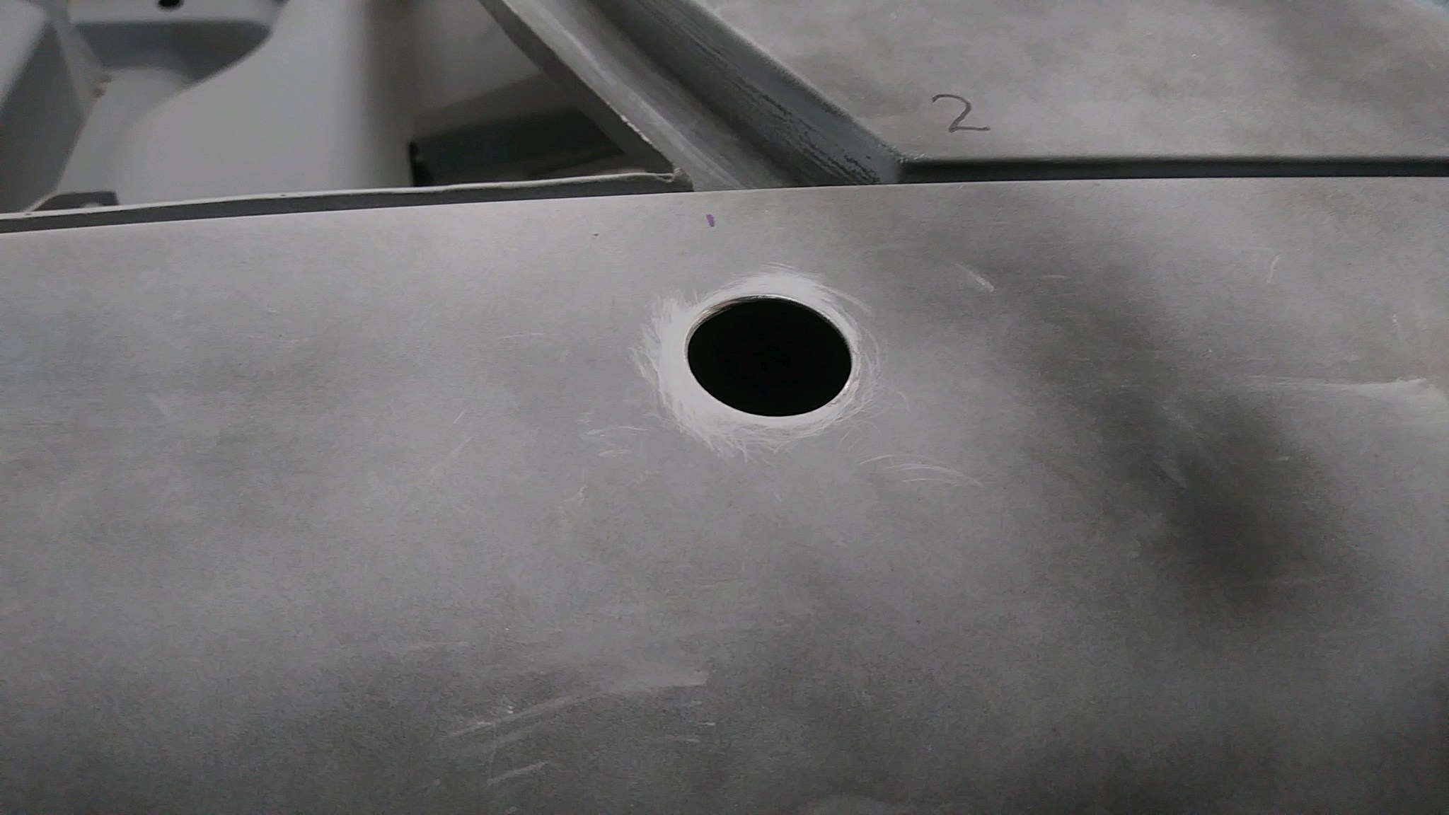

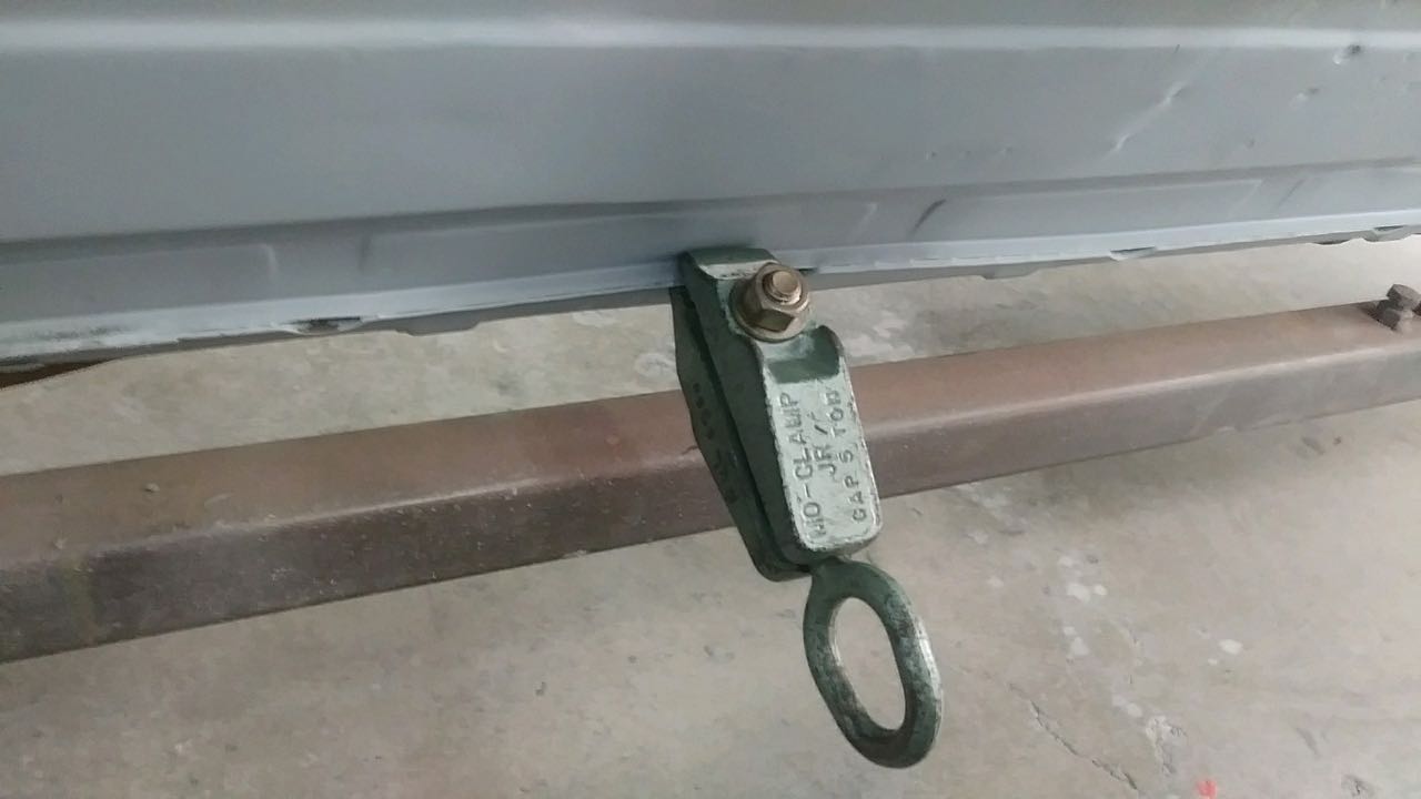

A little more work being done now that the car is back on the rotisserie. Kent made a pull on the bottom of the long to straighten it out where it was apparently jacked up at one point, possibly decades ago. Also he bored a hole in the end of the long to stick a borescope in their to see if there was any lingering sand in there and then blew it clean and it is ready for frame coating to be sprayed in there to keep it all nice.
Then on the bottom he welded on one of two reinforcement straps.

From: soCal
Member No.: 21,666
Pretty sure this has been covered, but, what are yu using for cavity wax or rust prevention?
Thanks for the updates!
Cairo94507
post Oct 2 2018, 04:03 PM
Post #974
Michael
Posts: 10,486
Joined: 1-November 08
From: Auburn, CA
Member No.: 9,712
You see a hole and then you don't!
