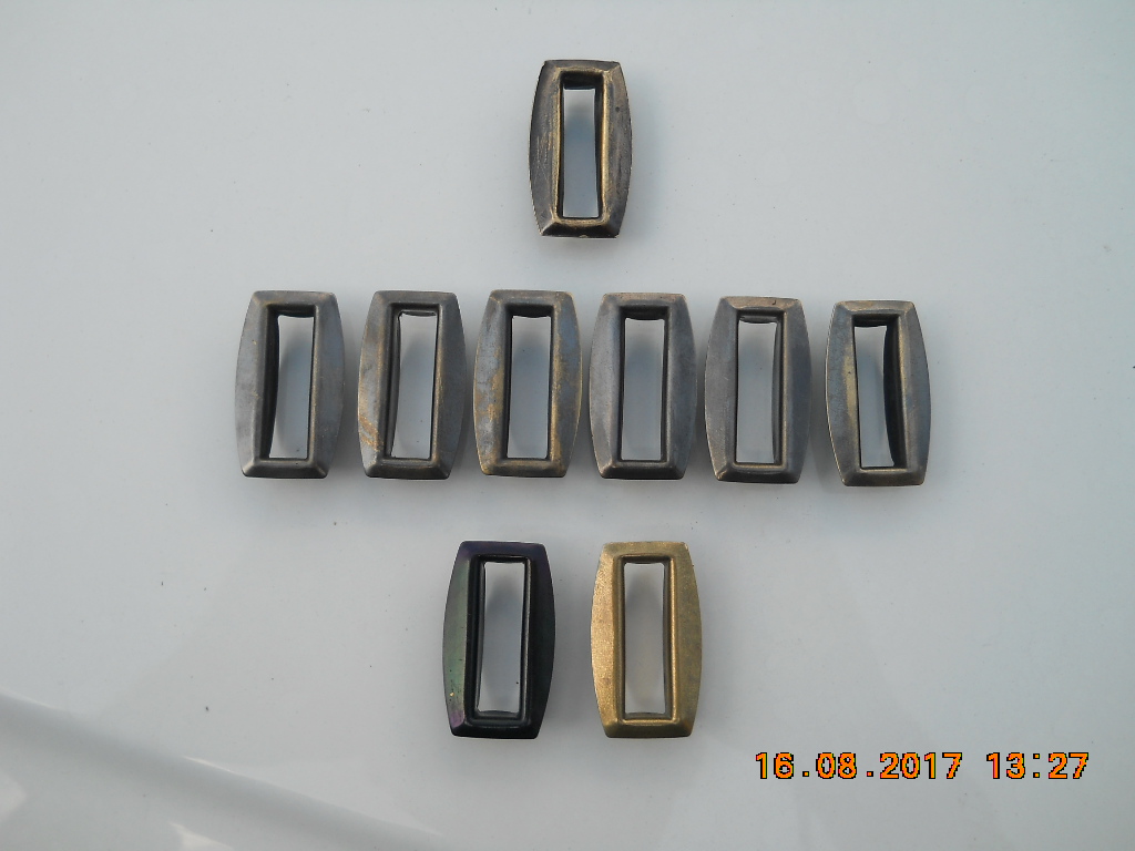

The door panel have a brass Bezel for the leather strap
I have recreated this bezel to org. specs its made out of brass
on the 2nd picture ( no idea why the pix got mixed up :-)
On the top you can see a org bezel
the row of 6 bezel“s are mine reproduction , they are acid dipped to get the Patina look as original.
on the 3rd row on the left, I have tried to zinc one in black but it got some purple /black gasolin colors that the zinc method leaves
on right side is the raw brass one
My question is ,in what finish do I make these
I have search for a way to get these black
paint is not a option
you cant anodize brass
Or are the Patina ones good enough !
this is the finish I have seen on org cars

I love the patina look. Can you powdercoat in black?

Patina it is now, it absolut got the most correct look
powder coat was not a option due to the paint cracked very easy
