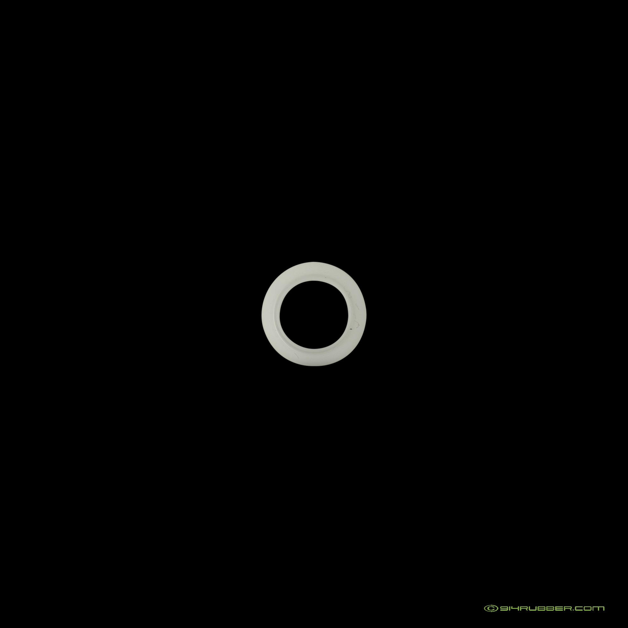

They take washers so the belt can orator

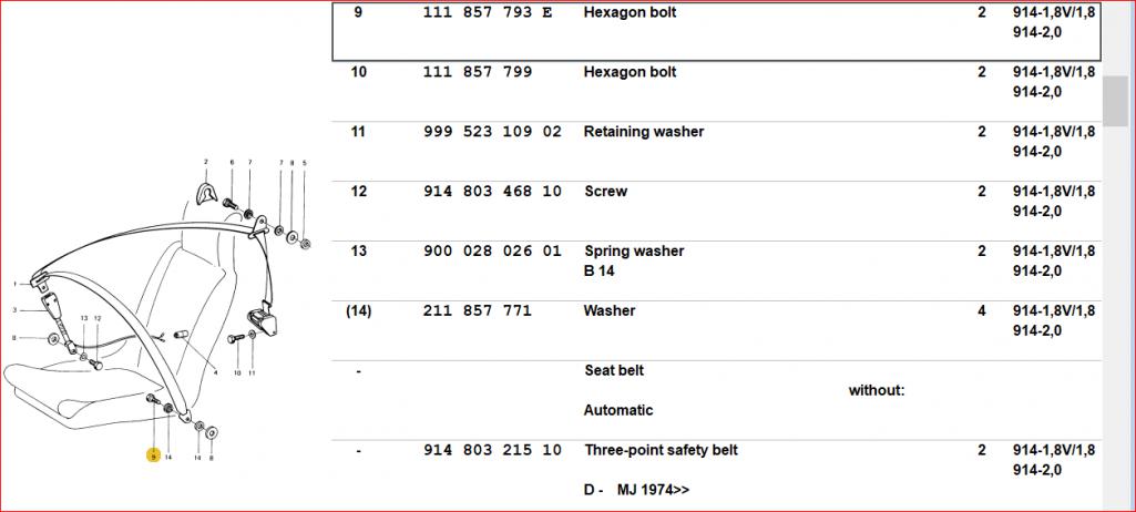

https://900designs-container.zoeysite.com/seat-belt-washer-1
They are inexpensive
bdstone914
post May 12 2019, 10:47 PM
bdstone914
Posts: 5,264
Joined: 8-November 03
From: Riverside CA
Member No.: 1,319
QUOTE(Ross @ Aug 17 2017, 12:45 PM) *
Hi,
Does anyone know where I can find the fastener bolt that holds the seat belt at the rocker panel area?
Thank you, Ross
914 1972 1.7

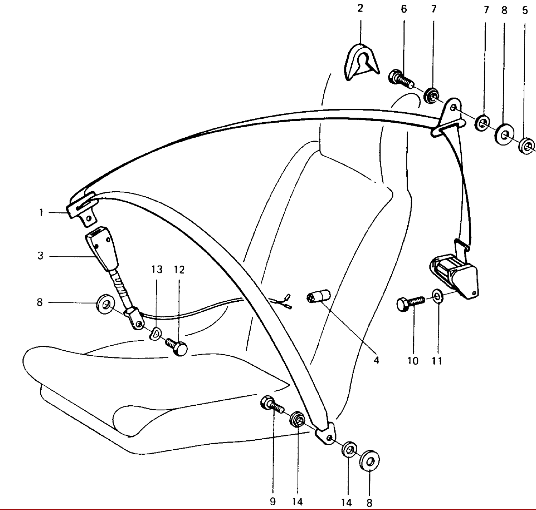

Special bolt with SAE thread and Metric head. Some are shoulder bolts. Also use metal and/or plastic spacers.
Also used on VW Beetle from the 111 part number.
Get the right hardware.
