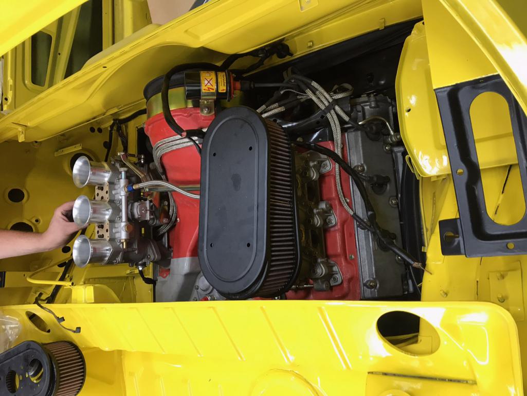

The engine I have for my six conversion is a 3.0 and was rebuilt and used as a spare for a guy who had an original RS. The engine was used whilst the RS engine was rebuilt. Once thing led to another and he only covered 1,000 miles with the 3.0 before the RS was complete.
The 3.0 had PMOs and I bought them with the engine. When I collected the engine all of the ancillaries were boxed separately and only today, almost a year later, when trying out the carbs for size I thought to myself - "Those look tall!" Amongst the paper work I can see the 'Tall' manifolds were ordered and a quick google has revealed that these are going to be too tall for a 914, they measure 100mm. To big? I'd speak to PMO themselves but I'm not sure how they'd be as I'm not the original owner. That and I don't know how to send a fax in 2017! |

brant honestly don't know if they will be too tall

gms On an original 914/6 I had to run the short air cl... Aug 29 2017, 11:54 AM

On an original 914/6 I had to run the short air c... Aug 29 2017, 12:43 PM

defianty Thanks burton, I think that confirms it. Mine are ... Aug 29 2017, 01:36 PM
gms I did not know those shorter PMO intakes even exis... Aug 29 2017, 02:03 PM
porschetub Pretty sure there will be clearance issues,when I ... Aug 29 2017, 02:27 PM
Mark Henry You will likely have rain hat clearance issues on ... Aug 29 2017, 02:35 PM
