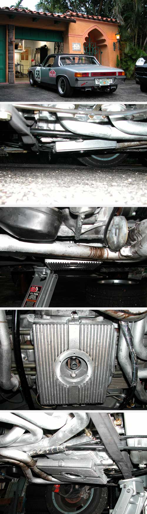

synthesisdv   after about two hours of track time, I have roughl...   May 19 2005, 11:15 AM

lapuwali   synth, are those two head pics low and high rpm, o...   May 19 2005, 11:34 AM

redshift   James, I see that as being a running motor, then a...   May 19 2005, 01:12 PM

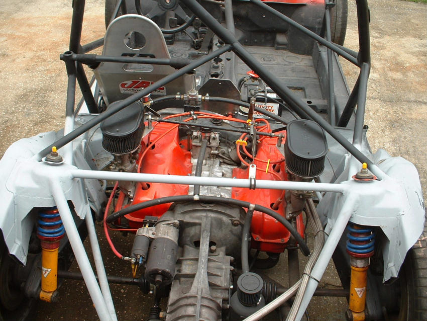

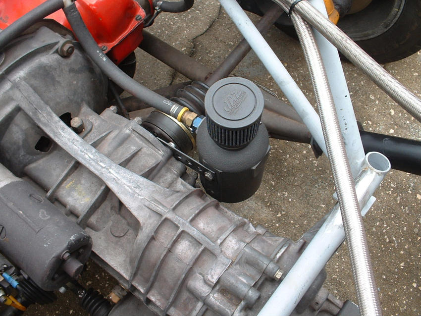

URY914   Here's the can...   May 19 2005, 03:31 PM
URY914   Update: My line on the left v/c is connected at t...   May 19 2005, 04:27 PM
