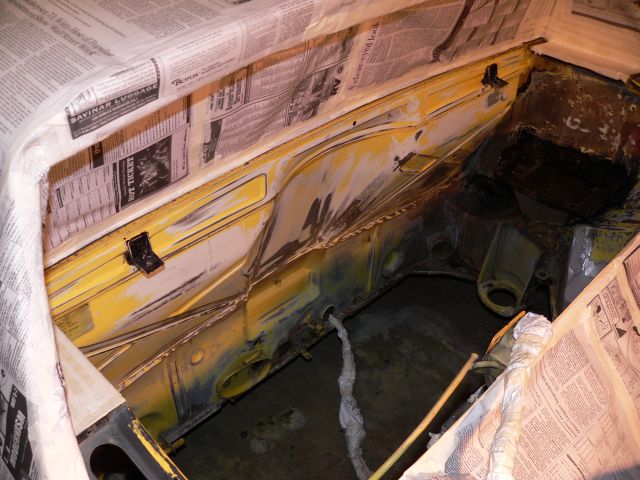

TonyAKAVW   First job I decided to tackle was taking the inter...   May 19 2005, 11:13 AM

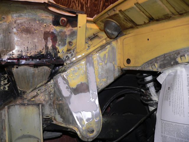

TonyAKAVW   Some more ugliness on the front fender.   May 19 2005, 11:14 AM
TonyAKAVW   Well, the fender was junk, so I removed it.   May 19 2005, 11:15 AM

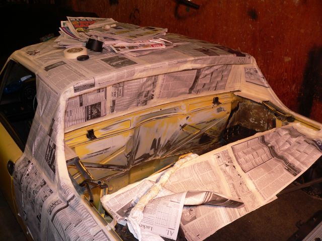

TonyAKAVW   Heres the floor, stripped to metal.   May 19 2005, 11:23 AM
TonyAKAVW   Another messed up fender. I have since found and ...   May 19 2005, 11:24 AM
TonyAKAVW   The whole interior got treated with metal etch and...   May 19 2005, 11:27 AM

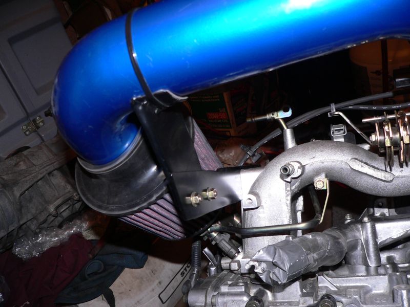

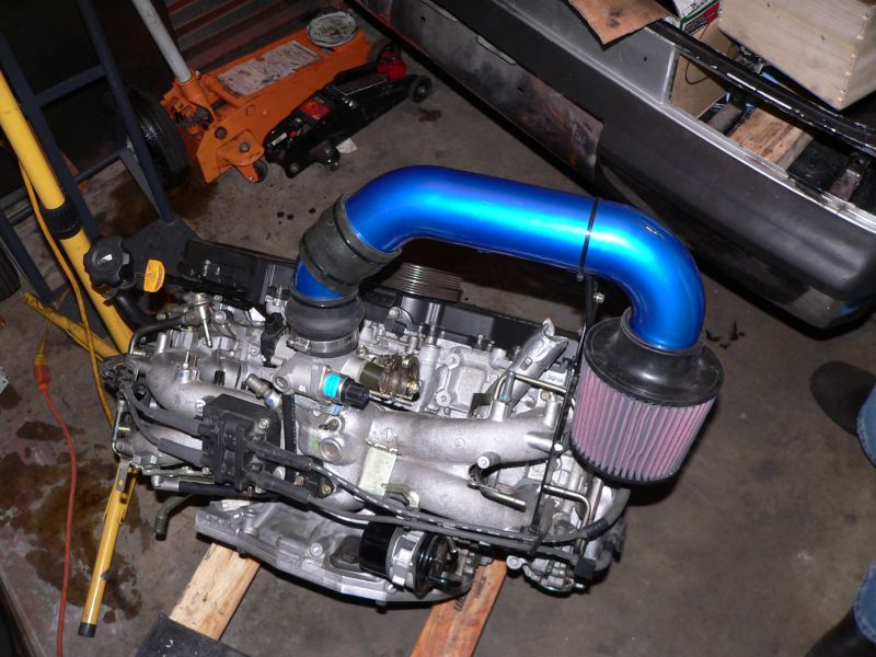

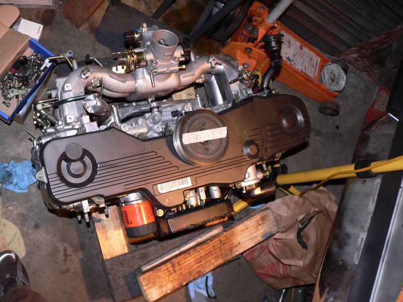

TonyAKAVW   Here's the engine that is going into the car:   May 19 2005, 11:31 AM
Dr Evil   In the first pic your cord is lying in some fluid ...   May 19 2005, 11:33 AM
TonyAKAVW   The motor came with the ECU, wiring harness, and a...   May 19 2005, 11:36 AM

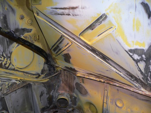

TonyAKAVW   Spent a few hours today cleaning out the unnecessa...   May 21 2005, 09:13 PM
TonyAKAVW   ll   May 21 2005, 09:14 PM
TonyAKAVW   Some of the metal coming out from the firewall is ...   May 21 2005, 09:14 PM
TonyAKAVW   Next step is to paint over the bare metal with POR...   May 21 2005, 09:15 PM
