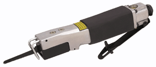

Nice work on the radiator. Just curious : what did you use to cut the openings in the body ? Seems like the standard tool is the sawzall, but I still have a hard time imagining getting results that smooth.

I used an air body saw from Harbor Freight. $19.99 on sale currently

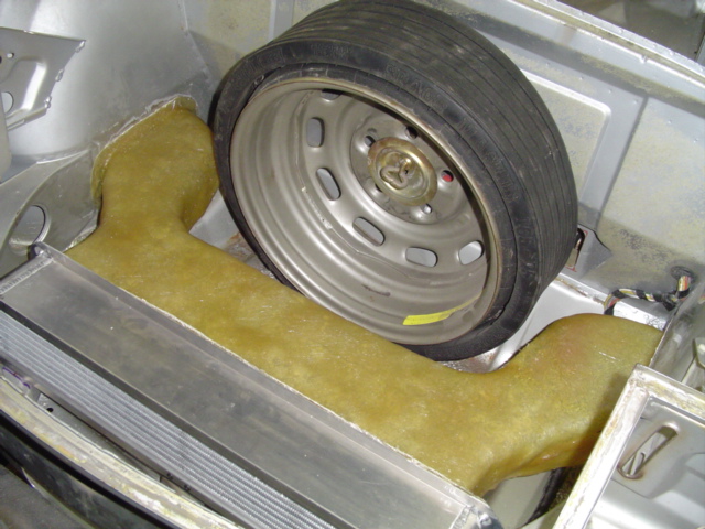

It looks like everyone is routing the air out of the fender wells. Is there a reason not to vent it out of the bottom of the trunk, under the car?

I have seen pictures of one car who went out the floor of the front trunk.
Several have gone out the hood. Out the hood seems to be the best method in my mind, from the perspective of aerodynamics at least. The wheel well method is usually chosen because it is proven and requires the least work. A hood vent requires a lot more fabrication...

In general you want to take air from an area with high pressure and vent it to an area with low pressure. Right in front of the bumper is very high, and the front of the wheel well is very low. So these places make good sense. Below the car is generally somewhat high, but it can be reduced by adding a front air dam. Generally, that's a BAD idea for a 914, 'cause you want high pressure under the car to help with cooling. For a watercooled car it should work okay.
I've toyed with the idea of a trunk floor exit, since my trunk floor is mostly gone (car used to have A/C). But right now I'm leaning towards copying what Tony did.

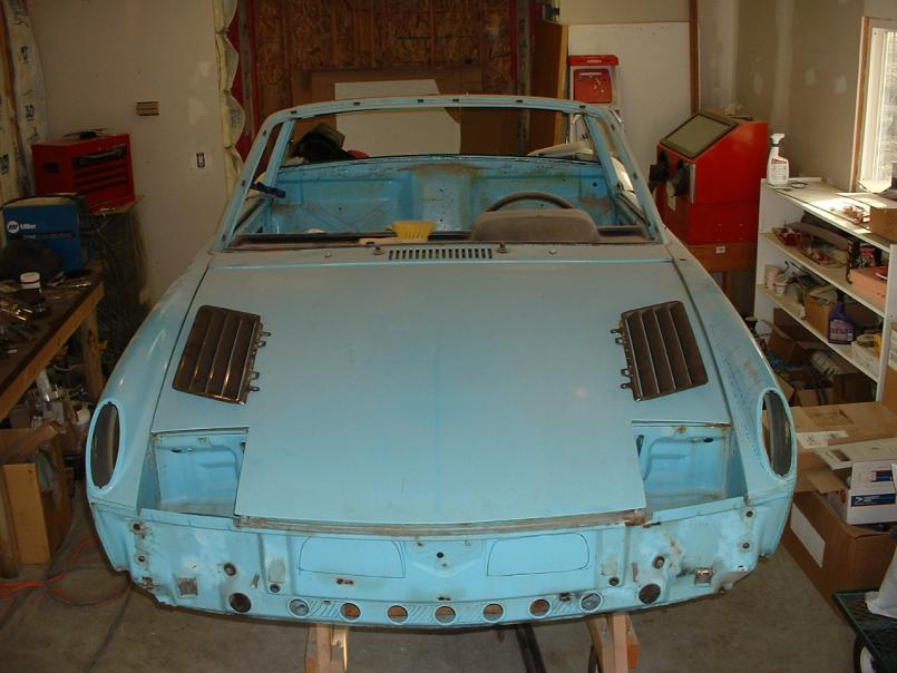

Ed, I'm with you on the hood idea. Not sure if you remember me but I got a quick ride with you at SEMA this past year when we all met at Renegade before dinner one night. Anyway.... my plan is still a combination of hood and inner fender vents to release air from the radiator.
(first pic) Example of my hood vents... they will require about a 1" lip that raises up around the leading edge to create a better low pressure zone.

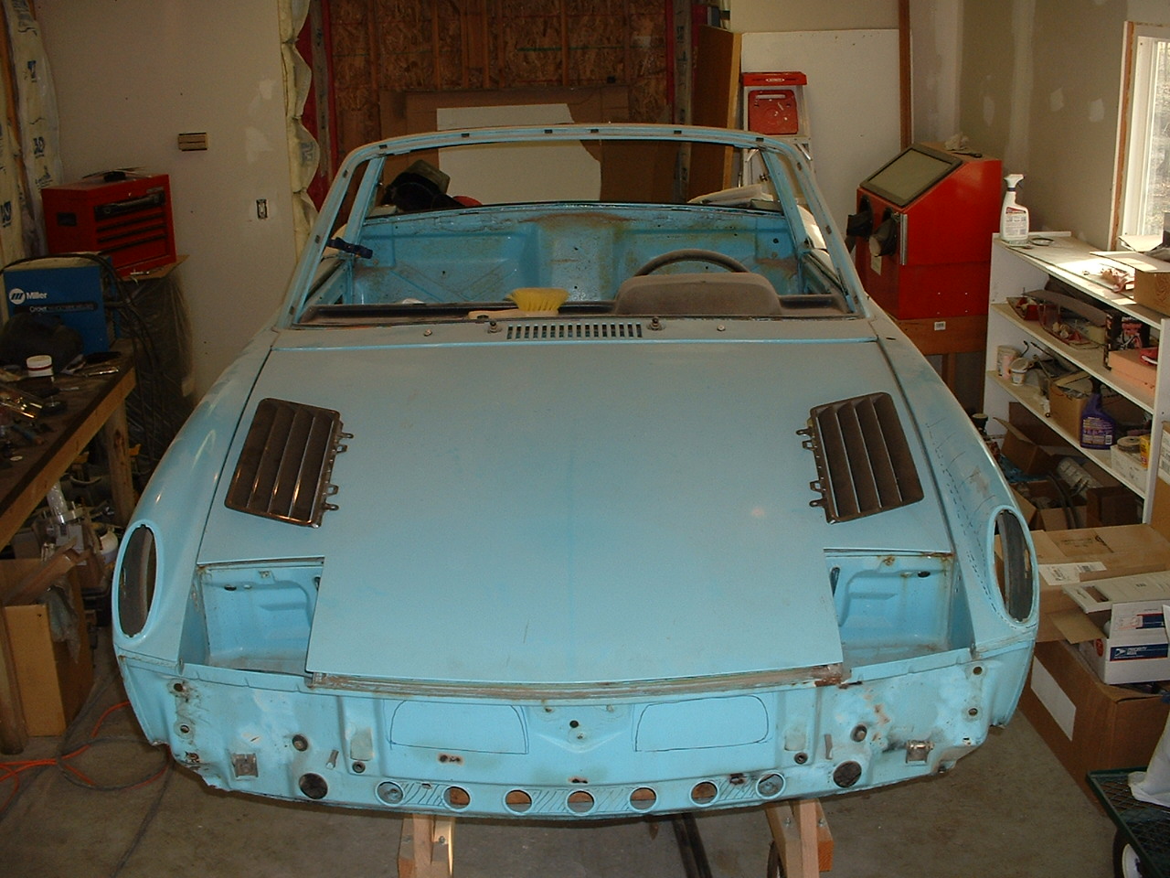

(second pic) Instead of an open trunk to use as a big plenum for all that hot air, the plan is to create ducting that moves the air directly to the vent openings both top and bottom.
