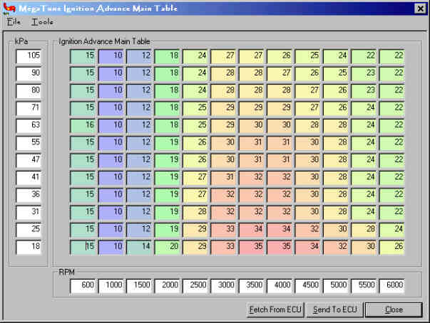

Here's the timing map off of my MS injection. It is also wasted spark. I'm not sure what plug and gap you are using but I tried a bunch and ended up with the old standby Bosch W7CC and .028. The Ford EDIS system suggested platinum and a hugh gap but, that didn't work for me. I've read that there can be a problem with spark actually arcing allong the outside of the insulator if the gap is to big so check your boots for burn marks.
If it's too rich I would think your wideband O2 sensor would pick it up. Will it rev past 4G's with no load. If it doesn't, lean out that part of the table and see if it will. If that doesn't help I bet it's spark. Check to make sure the MAP sensor is working, I've left the vacuum line off before and it just won't rev. Either of the temp sensors not working and reading cold would give a rich mix but, you would see that throughout the whole fuel map.
