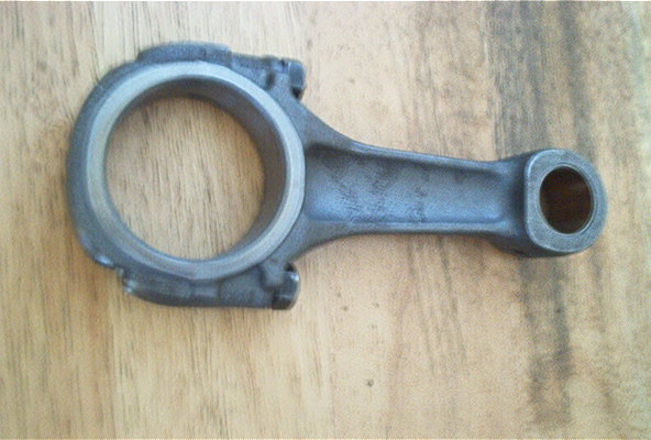

LouisCypher
post May 21 2005, 10:35 AM
Posts: 35
Joined: 12-February 05
From: Germany
Member No.: 3,591
Stock rod weight = approx. 800 gr.
Lightening = approx. 200 gr.
Result = approx. 600 gr.
(IMG:http://www.jabotana.mynetcologne.de/pleuel.jpg)

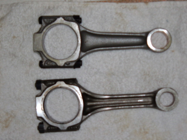

QUOTE ("Z" @ May 21 2005, 08:43 AM)
Been over 10 years....but I remember doing a stroker crank, Rabbit rods and Chevy pistons....great fun. (IMG:http://www.914world.com/bbs2/html/emoticons/cool_shades.gif)
Here, is a pic of a rabbit rod, bushed for a chevy .927 pin, the bolts have been turned around, and the bolts are 3/8 big block chevy ARP Wave loc Bolts, in it's present form, the rod weights 662 grams, it can be lightened at least 100g, the length is 5.355. These are going in my motor next week.
The other rod, is out of a Jetta or Gulf, it is 5.670" long, and the piston pin, is oiled from the rod bearing through the beam of the rod.
My current engine is 105.7 x 75, I was going to have my 75mm stroke crank, offset ground from 2.0 ltr journal size of 1.967 to rabbit journal size of 1.805, taking my 75mm stroke to 78.4mm, but I just got a line on a 80mm crank with rabbit journals, I may go that route instead.
Stroke and rod combinations are limited, only by the imagination

Type 4 Unleashed
post May 22 2005, 11:55 AM
CREATIVE TYPE lV ENGINEERING
Group: Retired Members
Posts: 787
Joined: 20-June 04
From: Aliso Viejo, ca
Member No.: 2,231
QUOTE (Mark Henry @ May 22 2005, 04:18 AM)
Jakes cranks and rods cost a couple of bucks more, but all the work is done. Why would you skimp on your bottom end?
Hey I build engines, I know some of Jakes basic crank/rod combos and I still get my crank/rods off of Jake.
Why piss around with unproven crap. (IMG:http://www.914world.com/bbs2/html/emoticons/confused24.gif)
What skimping?
With the Rabbit Rod, I don't have to weaken the Cam by having it ground to a 1' Base Circle, for clearance for a stroker.
I, don't have to weaken the rod bolts, by clearancing for a stroker.
I, don't have weaken the case, by clearancing, for a stroker.
The Rabbit Rod, has a better Rod to Stroke Ratio, than the 2.0 ltr rod, and in stock form there 150g lighter each than the 2.0 Rod (1.34 pds total savings).
And as "Z" said this was done years ago, and this rod is still being used in Europe, in off road, there cheap, and plenty around.
The ouside dia. of the rods is directly proportional to the dia. of the rod journal.
A type 1 journal is about 2.160, chevy small jrl 2.00, 2.0 ltr 1.967 honda BMW 1.888 & 1.850, rabbit 1.805. with smaller outside dia of the rods, more clearance, and less clearancing you need in other areas, such as the cam, rods, and case.
