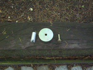

Going through all of my boxes earlier this week and found parts for a tuna can. Is this complete? 3 pieces no o-rings.

There should be a o ring inside the tube pickup. Also a gasket for the Cup, and a drain plug gasket for the bolt.
Follow tourque specs, if it leaks you have case issuse that need to be addressed.
