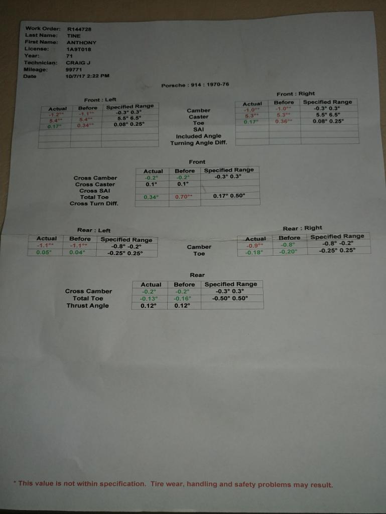

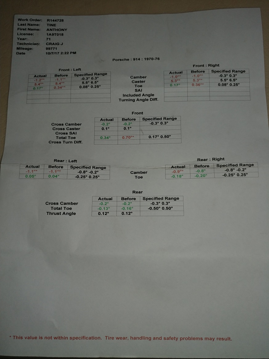

Update... I replaced the super thick spacers with spacers of around 3/8 inch thickness. Much better with no binding and most of the bump steer also went away.
I took the car over to our local Les Schwab Tire store on Saturday and had them do an alignment on the car. After explaining all of the 'nuances' of working with a V8 914 including discussion of bump steer and asking that perhaps the front ride height could be adjusted a bit to allow even less bump steer; I had him go at.
It took him almost an hour to finish and I asked him how it went. As he explained things; I automatically wondered if he even adjusted the camber or caster. I asked him if he opened the front hood (I forgot to explain to him where the release was located); he said he did not open the hood at all! I said well... how do you adjust the camber or caster without getting to the top of the strut? After a while of discussing this with him; I started thinking this tech had no idea how to adjust the caster/camber on my car. He adjusted the front toe... all for 'only' $80.00.
Check out the read out sheet. Should I go back or go else where?

post Oct 8 2017, 09:26 PM
Posts: 713
Joined: 23-July 15
From: Oklahoma
Member No.: 18,986
if it was me personally, I'd leave it as is. The toe is the most critical to tire wear and yours is within spec. The camber is a bit more negative than spec but that's probably from lowering the car. Unless you have adjustable front camber plates you may not be able to get the F camber in spec.
R camber you can fix with shims. But it's still not too bad
