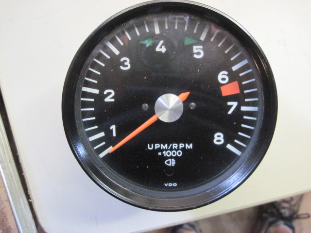

I know there is lots of talent on this sight. Anyone set up to recalibrate a 911 tach?
I am doing a /6 conversion for my customer and this tach reads low, p/n 911.641.301.01. Both Hollywood and Palo Alto are quoting a long turnaround time.
Thanks Brad

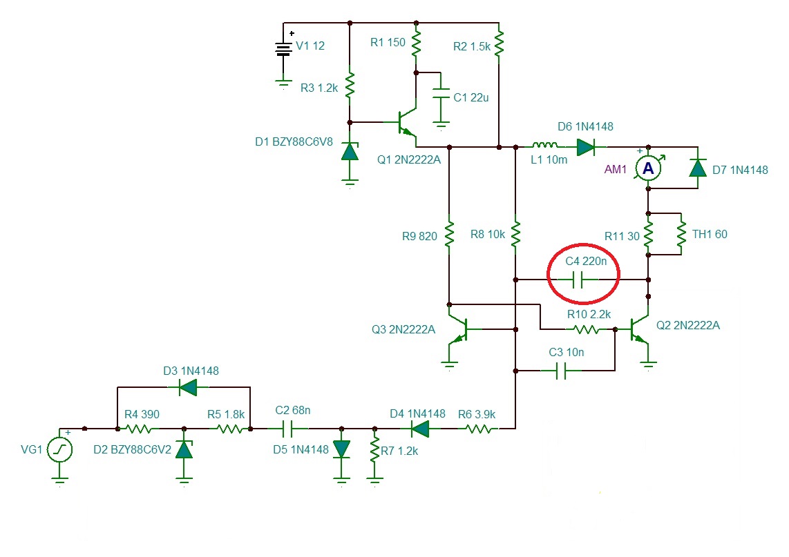

For those recommending a Tach-adapt is simply asinine. It is like adding Sea-Foam to an engine with a dropped valve seat. I'm sure Bob's module does condition the signal but I'm also pretty sure that Brad (being the 914 god that he is) has already got this ignition system well tuned. No module will fix a broken tachometer.
It was stated that the RPM readout was low. These tachometers are pushing 50 years in age, which well exceeds the life of a electrolytic capacitor. After reverse engineering the 911 tachometer and updating some obsolete parts, it is very likely that C4 which is part of the timing circuit of the tachometer has degraded with age and causing the tachometer not to read correctly

This is a 911 (6 cylinder) tach and the tach itself is defective. I have decided to send this tach to Tim to convert.
I did learn a lot from the answers to this thread and it is great information that the Tach Adapt is available as well as the contacts for other gauge technicians I was unaware of.
Thank you all! Brad

The old heathkit circuit boards are very similar to this era tachometer. Yes,you can obtain replacement parts from Mouser or Digikey type stores. Some components are no longer available, so I have found proven suitable replacement parts and updated the schematic in an attempt to help others resuscitate their own broken tachometers. Values for each component is listed in the above schematic, just keep in mind that this schematic is strictly for 911 tachometers only.
