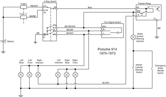

Below is the circuit for the turnsignal/brake warning flasher system for your car. On the right side, notice the brake warning bulb. It connects to the brake master cylinder switch and the e-brake switch.
Try disconnecting the wires to one of the switches then the other to see which one is providing the current path to ground for the warning bulb.

QUOTE(Spoke @ Oct 7 2017, 11:09 AM) *
Yep.
If the wires are reversed on the MC switch it will do what yours are doing.
Also check all the ground wires.
Good luck, I had this same problem.
