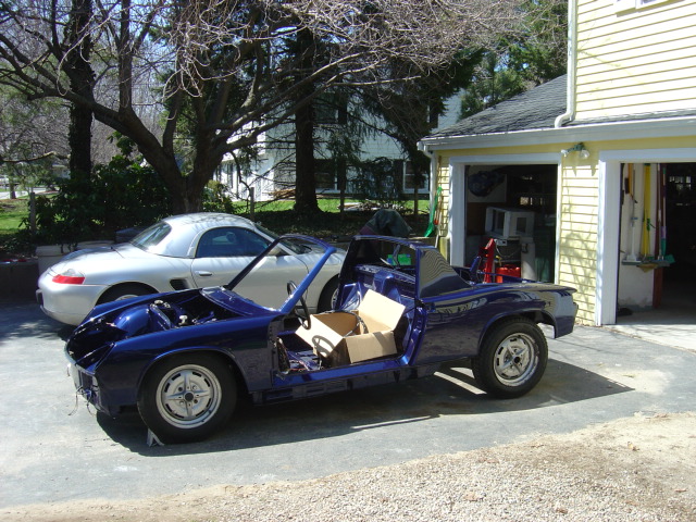

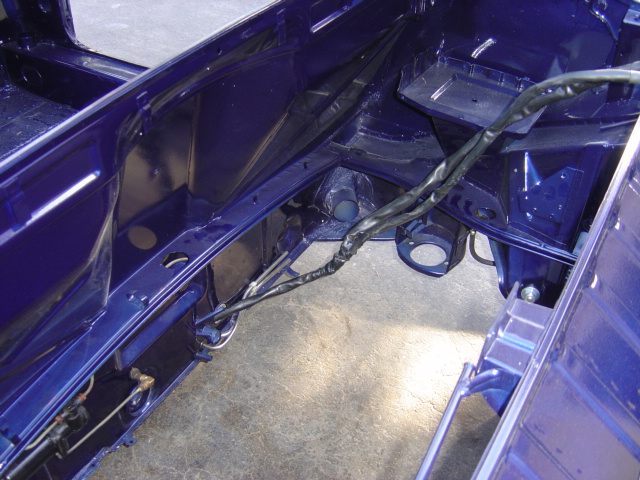

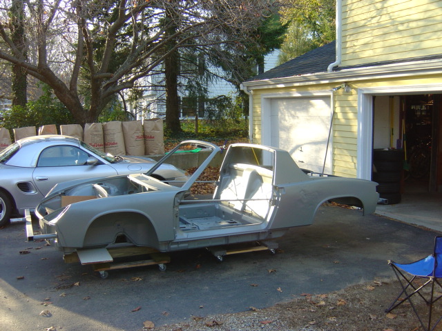

I had no problem scaping the bottom of my car and wheels wells with a paint scraper. In a few spots I used a wire wheel on a drill where the crap was real, real thick. Of course, my tub was on a rotissiere, and this makes the work easy. However, it really isn't necessary. My media blaster used baking soda most every where, but they can use "black beauty" to remove almost anything. The media blasting took three days and cost $1,000. IMHO media blasting is the only way to go. I recommend using a facility that can shot a vinc rich primer (Dupont Viraprime) to prime immediately after blasting - otherwise the bare metal will flash rust in days. (IMG:http://www.914world.com/bbs2/html/emoticons/ar15.gif)

I suppose you could do it with the harness in place, but I strongly recommend against it. I know it is a pain in the ass, but I removed mine. Pull everything from the engine compartment forward into the car. After you have it inside, and remove the harness from the logic relay panel under the passenger seat, you then pull everything from the front into the interior. Disconnect the fuse box and then pull the rear harness under the last piece of the transmission tunnel and the whole harness is out of the car. I labeled every branch and connection as I disconnected, took over 700 digital pictures and just take it slow and easy. It is real easy to scrap wires if you get in a hurry. Use lots and lots of silcone spray to pull the harness into the car from the engine compartment. I had removed everything (and I do mean everything - shift rod, fuel lines, etc.) from the car and removed the wiring harness last. This frees up some room in the tight quarters and remove a branch at a time thru the rear firewall. This may not make much sense now, but when you are doing it you will see what I mean. Look at the pictures in my most recent restoration thread and you will see me putting the wiring harness back into the car. (IMG:http://www.914world.com/bbs2/html/emoticons/smash.gif) Took about a week to have everything pulled in and wired up.

william harris
post May 22 2005, 09:24 PM
914 Restorer
Posts: 1,459
Joined: 9-January 04
From: Hamilton, MA
Member No.: 1,539
This is Lapis Blue Metallic as found on 2003 and up Boxsters and 997s.
