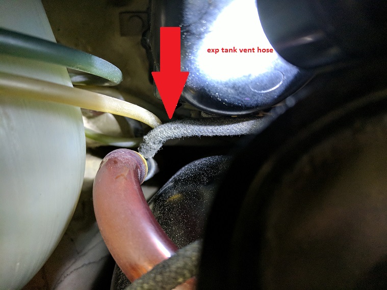

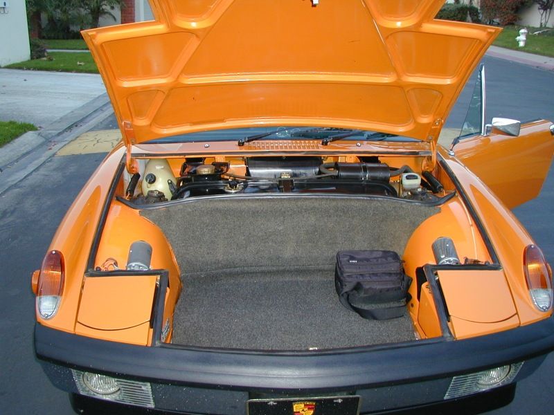

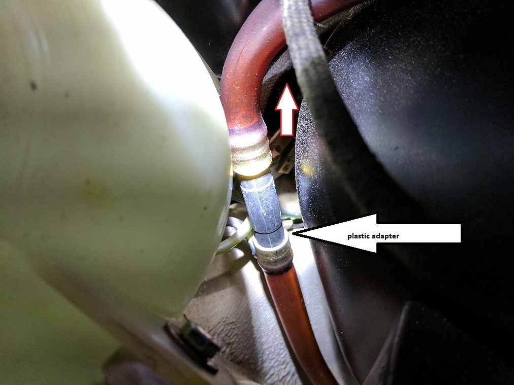

Mike..
Yes the hose from the expansion tank vents/goes to the over flow hose and attaches via a plastic adapter. 1970 914-6 expansion tank no charcoal canister
1..side view
2..top view
John

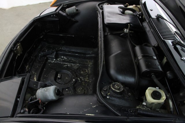

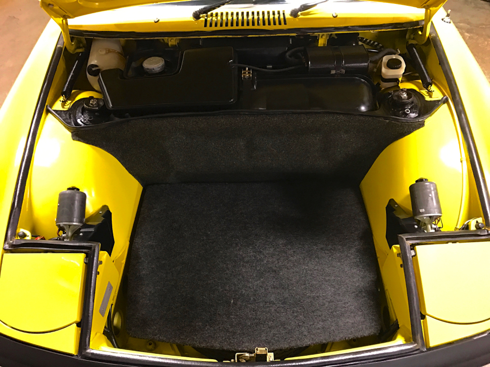

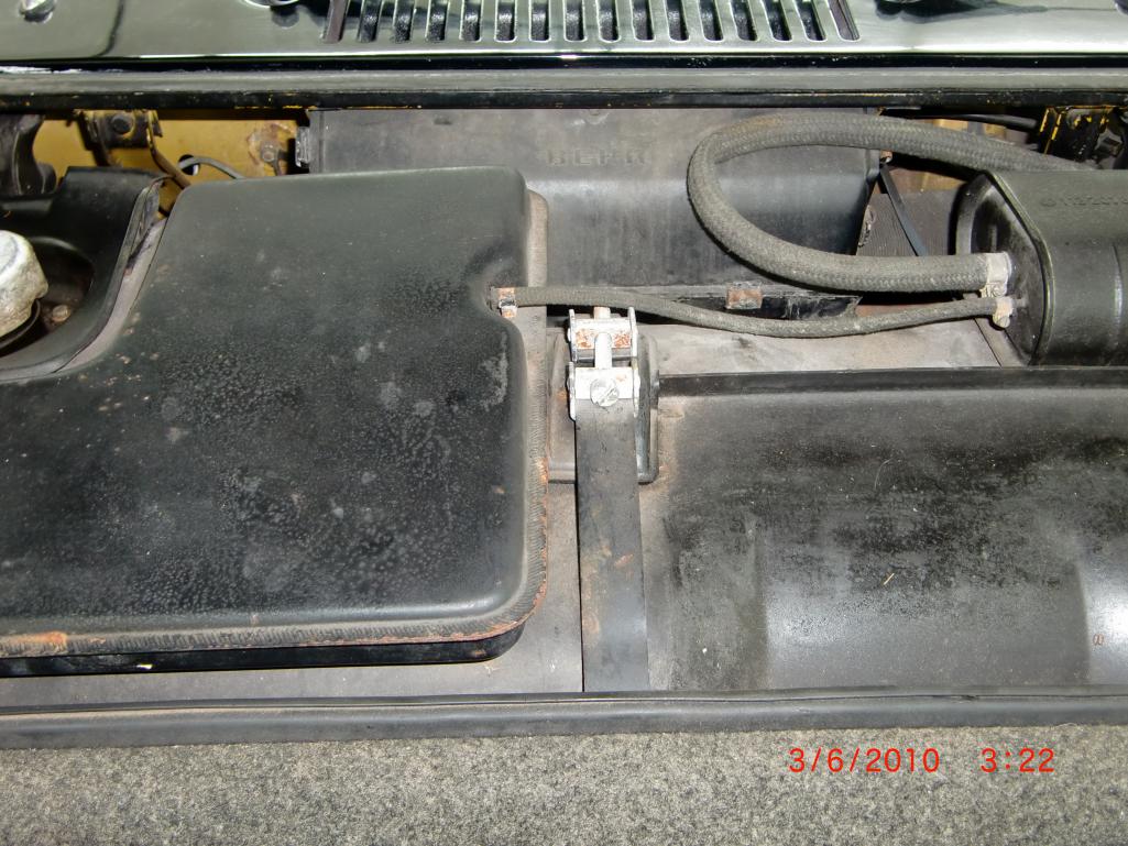

My '71 had both and will have both again when reassembled. Sorry about the pictures size. I am a photo-sizing idiot. I just can't figure out how to reduce the size of the pictures.....why does Apple have to make it so hard? Or in the alternative, why is it that I am so stupid when it comes to this stuff?

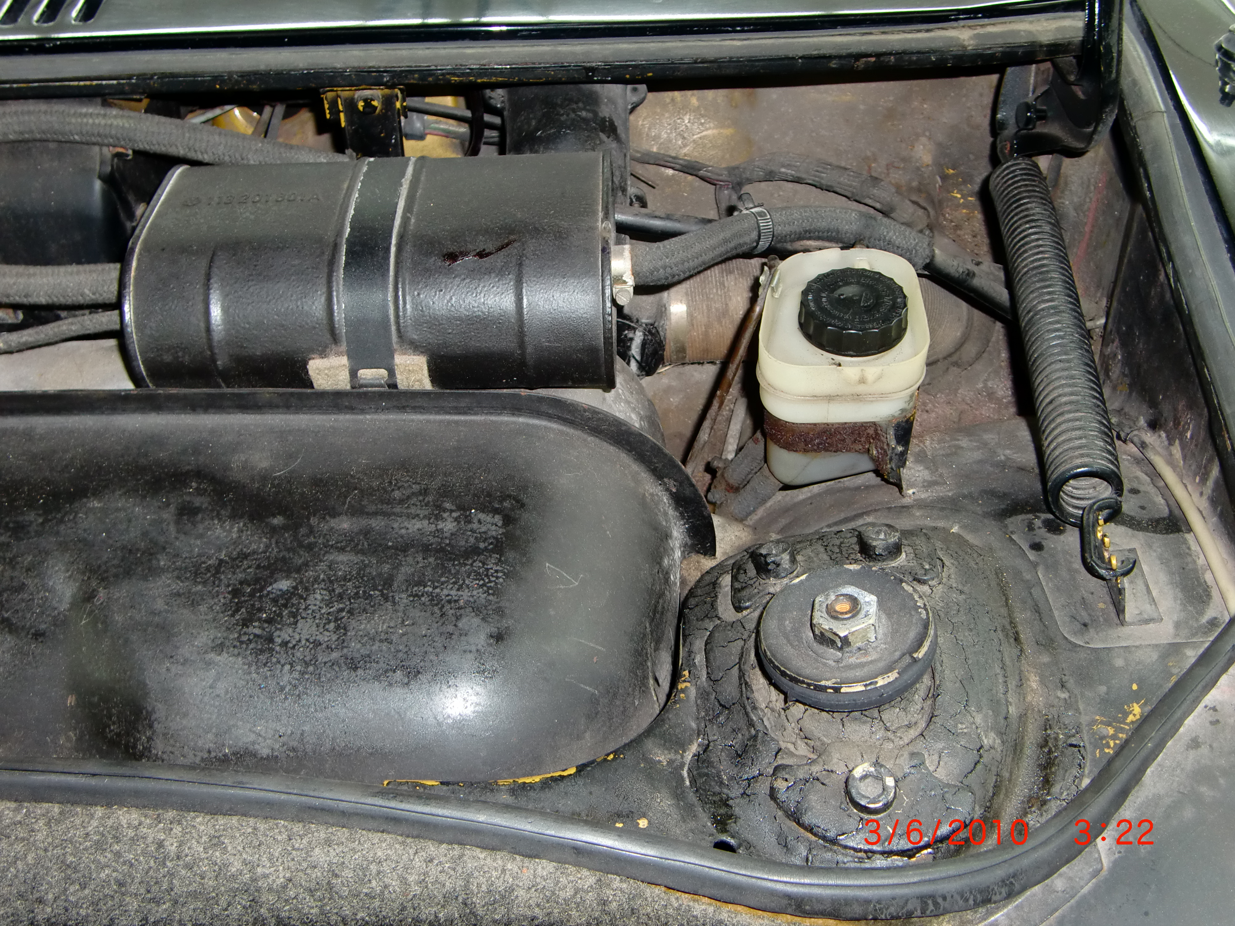

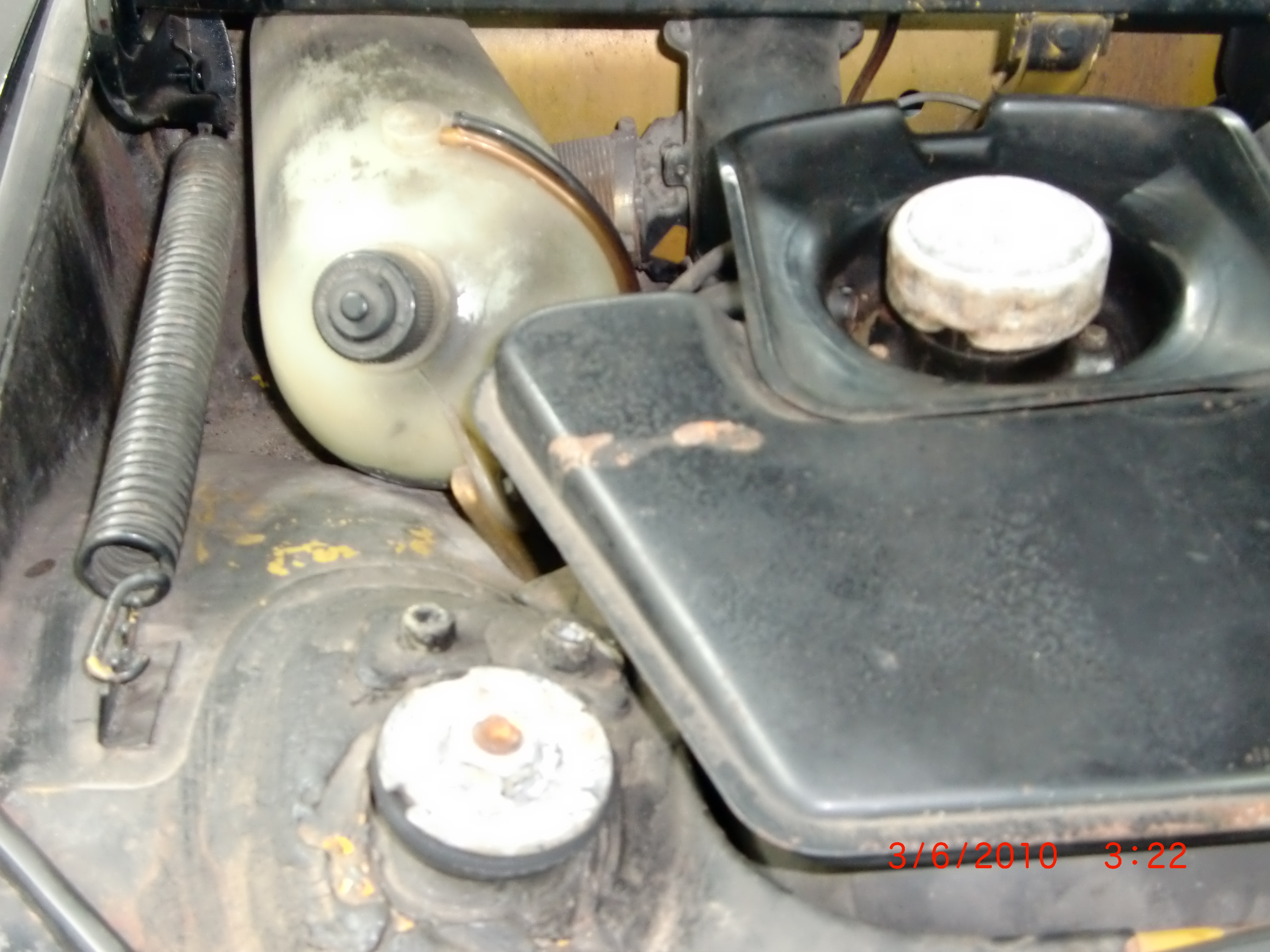

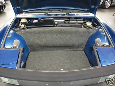

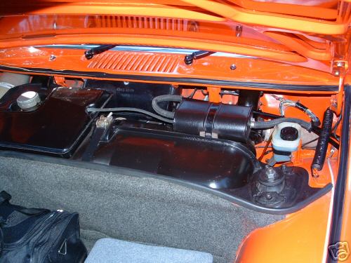

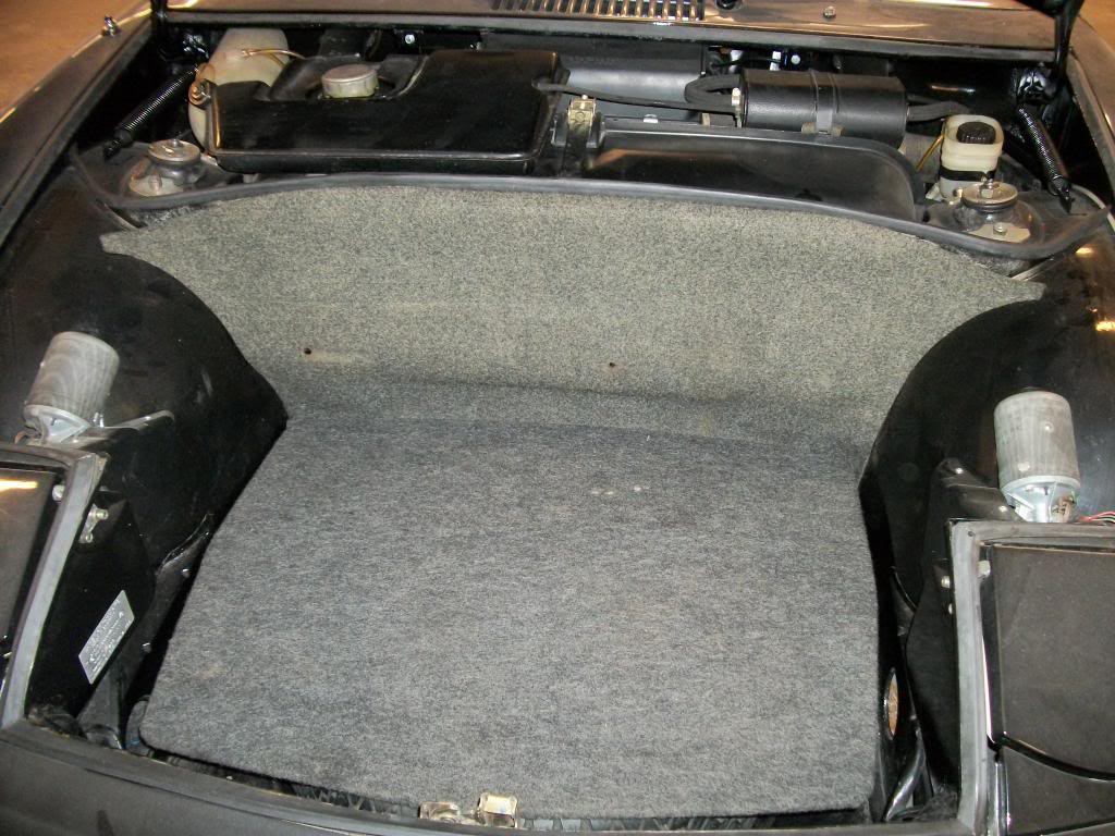

I cannot say for sure one way or another but I can give you examples of canisters installed on later 1970 914/6. I cannot tell you if they were installed by the factory.
I think looking at the overflow down tube and looking for the holes for hoses to the back will give you and idea about what was there.
914 043 2312
914 043 2317
914 043 2357
914 043 2567
914 043 2591
914 043 2664

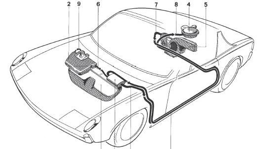

Doing a little research and thinking about the system the answer is simple, if you have the hoses that go back to the air cleaner in the engine compartment it was probably installed
An installation requires holes in the front trunk and under the relay board in the engine compartment.
Here is an illustration from the shop manuals, air is circulated from the fan to the canister then it pushes fumes to the air cleaner on the engine. I know this is a diagram of a 4 cylinder car but the concept is the same for a six.
