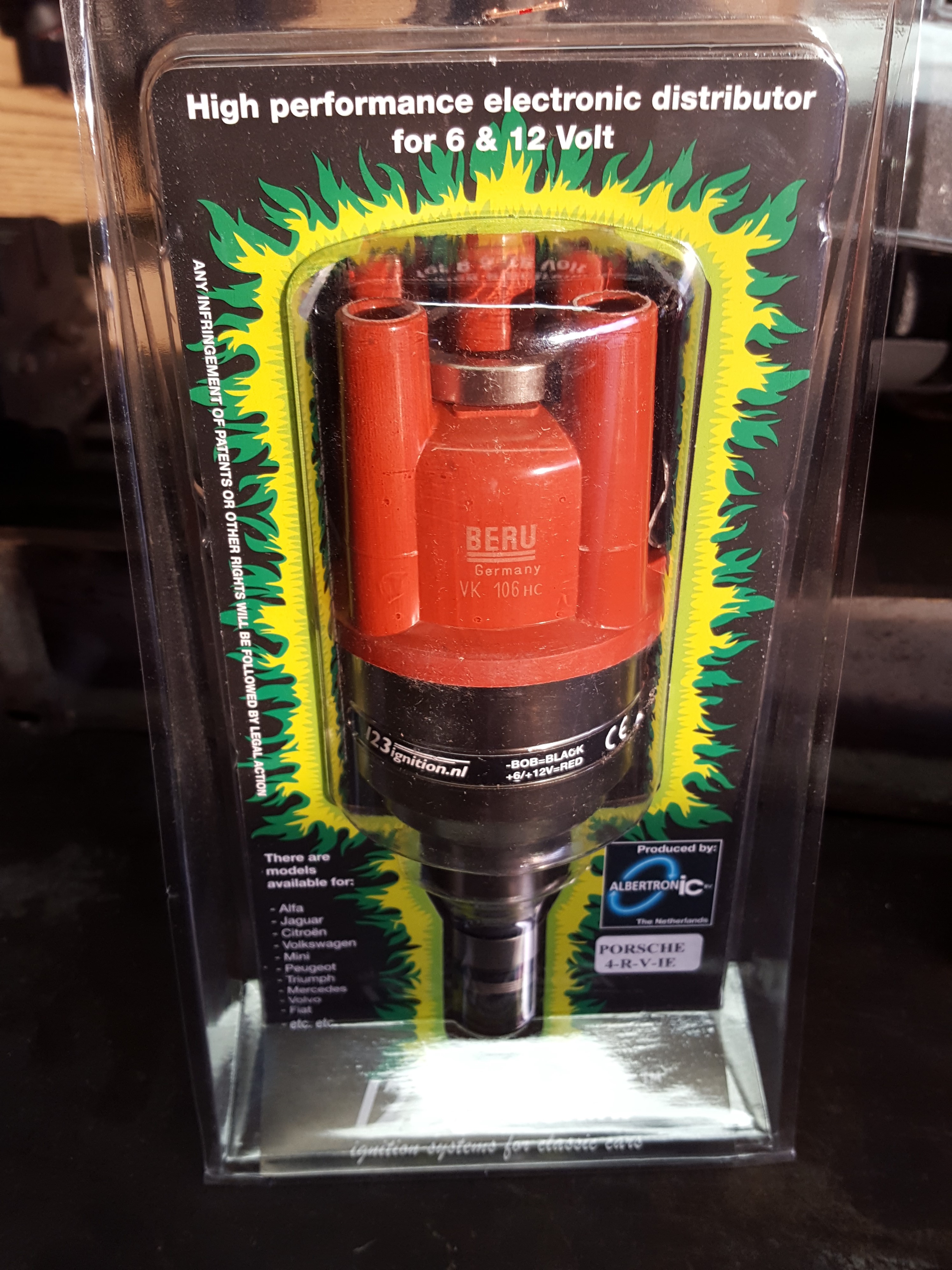

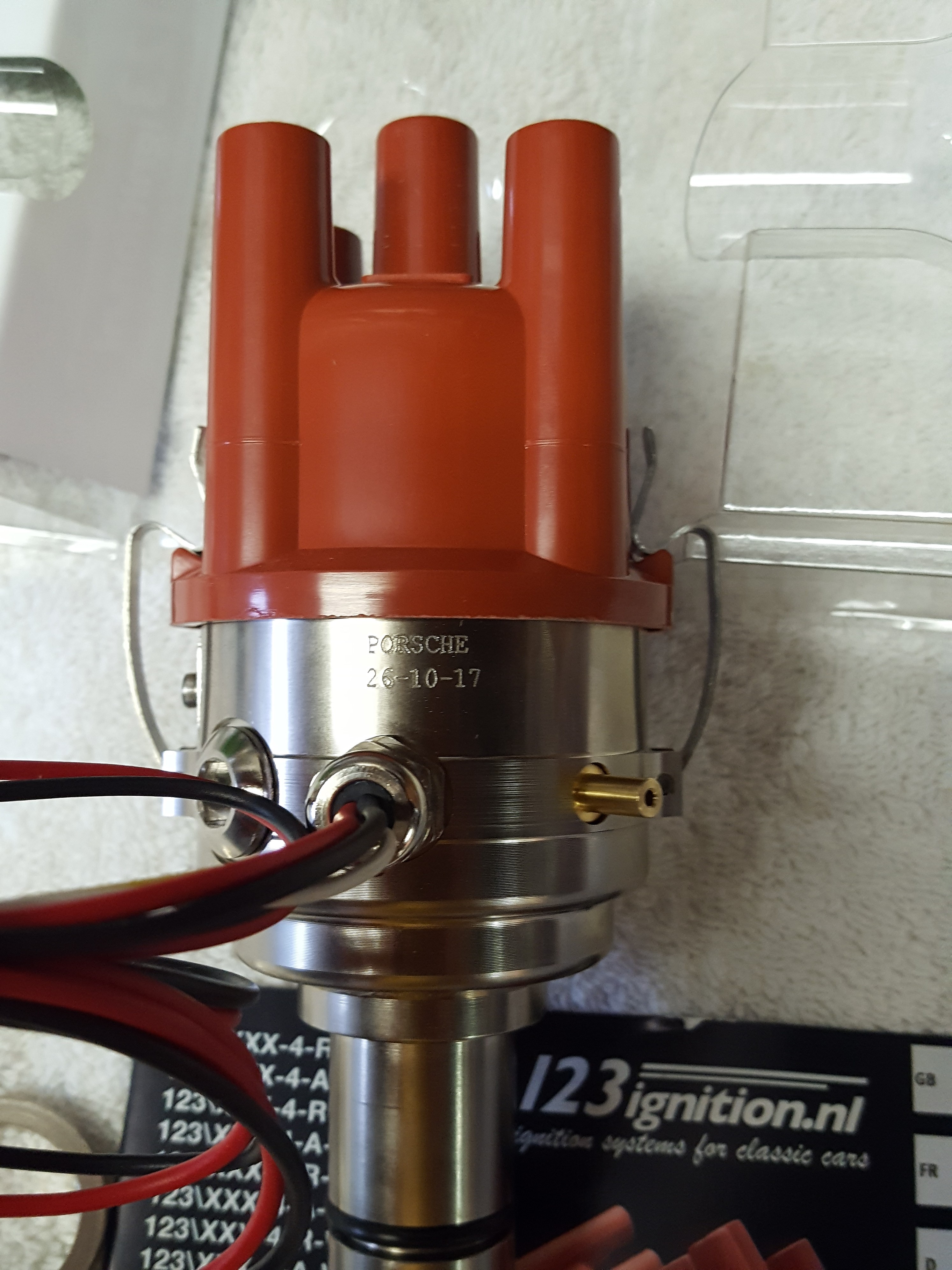

It just rolled in.
Backed the car up so I can install it tomorrow. Got a new compressor as well. The HF one gave up the ghost.
The build quality is impressive. I think for sure though I am going to put some shrink wrap on the wires a a little strain reliefAttached Image
