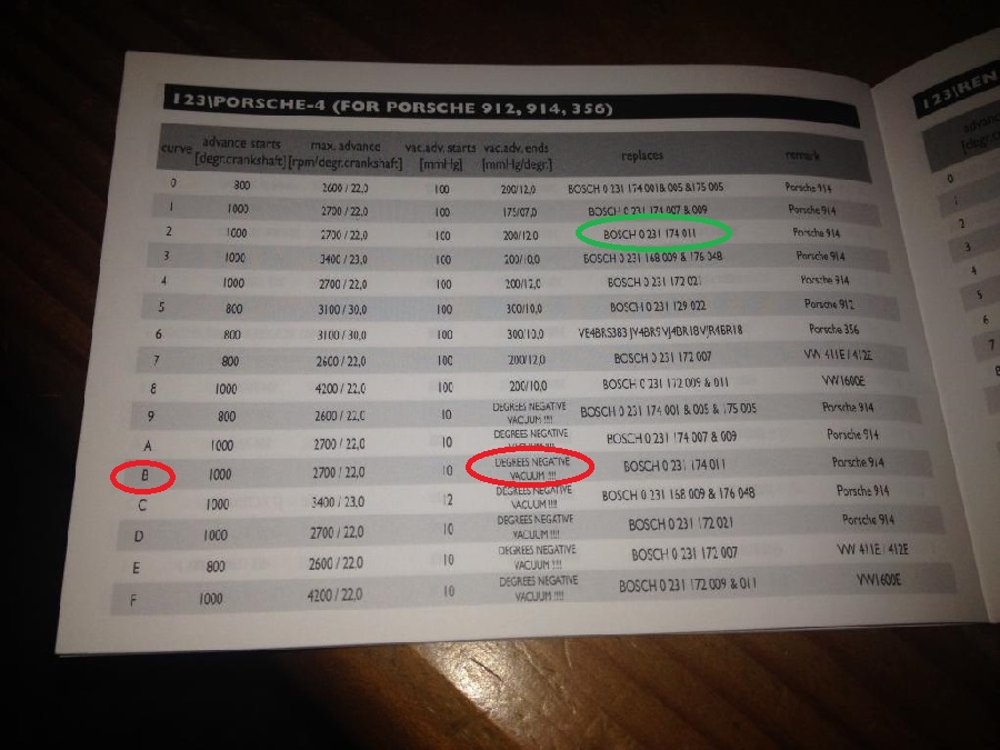

On my engine the correct dizzy is a 009 so I will try #1 setting but also would try #2 and maybe #4

I see what you're saying. And it makes sense. Since my dizzy wasn't stock, I wasn't sure what to select, but I think this is worth a try to see what happens.
It's actually running pretty strong right now except for the high idle and significant difficulty starting...
EDIT: Going to have to wait until daylight, and probably after work, before I can try this. It's going to require pulling the dizzy to reset the curve. Also, my throttle body is probably not stock to the engine, but it has both advance and retard.

QUOTE(Olympic 914 @ Nov 5 2017, 04:14 PM) *
If you are referring to me, I selected setting No. 1 as that corresponded to the Bosch part No. I had in the car. The engine I have now in the car is a 1.7 completely bone stock with a well sorted D.jet FI system.
If I were you I.d PM McMark to make siure per what motor, cam, induction, dizzy you now have and if it is running well.
I.d make sure of all of that first.
Rob

QUOTE(BeatNavy @ Nov 5 2017, 04:21 PM) *
Rob, a leaking d.cel valve will give you high idle. Plug it fornnow and see what happens.

QUOTE(BeatNavy @ Nov 5 2017, 07:21 PM) *
My set-up is also kind of Frankensteined together, Running the 007 dizzy that came originally with my 1.7 engine. its now a 2056 with 2.0 FI system and the throttle body that has the two ports. I also have the two port can on the distributor and have both hoses connected. for Advance and Retard.
the plan on installing the new 123 dizzy will be to only connect the advance hose and plug the retard port on the throttle body. ( You did plug that, didn't you?) then play with the settings.
Isn't there a way to turn the switch with the dizzy installed?

Success! (I think). I was going to try resetting the curve based on your suggestion tomorrow after work, but after the frustration this weekend, I said "screw it" and went out with a flashlight and managed to pull the dizzy and reset the curve to "2" in about 5 minutes (you get pretty good pulling and reinstalling after about the 4th time). Started much easier, ran strong, and idled steady around 1000 RPM. I probably still need to verify timing, but if I'm not yet at raped ape like Rob, I think I am at least at molested monkey (IMG:style_emoticons/default/smile.gif) .
Yes, do plug the retard port. I did do that as well. Based on the orientation of my dizzy I really can't access the program port without pulling the dizzy. You may want to keep that in mind when you set the orientation on yours.

I'm getting the Bluetooth model. Can anyone post or send me a good starting point with both curves? I have a mild 2270 with Weber 44's. I need to program the unit to get it started and running. Thanks in advance pun intended Dave
McMark
post Nov 6 2017, 03:32 PM
Post #190
914 Freak!
Posts: 20,180
Joined: 13-March 03
From: Grand Rapids, MI
Member No.: 419
0-1000 rpm = 12 degrees
3500-10000rpm = 28 degrees
The 'curve' is a straight line between 1000-3500rpm.

Thanks Mark, and the vacuum advance curve?
McMark
post Nov 6 2017, 05:09 PM
Post #192
914 Freak!
Posts: 20,180
Joined: 13-March 03
Member No.: 419
Zero. (IMG:style_emoticons/default/wink.gif)

Hum, there seems to be 2 different thoughts here, vacuum or no vacuum. I thought people were now going to svda dirtributors to get better idle and gas mileage. Did I miss something?

I'd like to be able to program the curve more specific to my engine...
