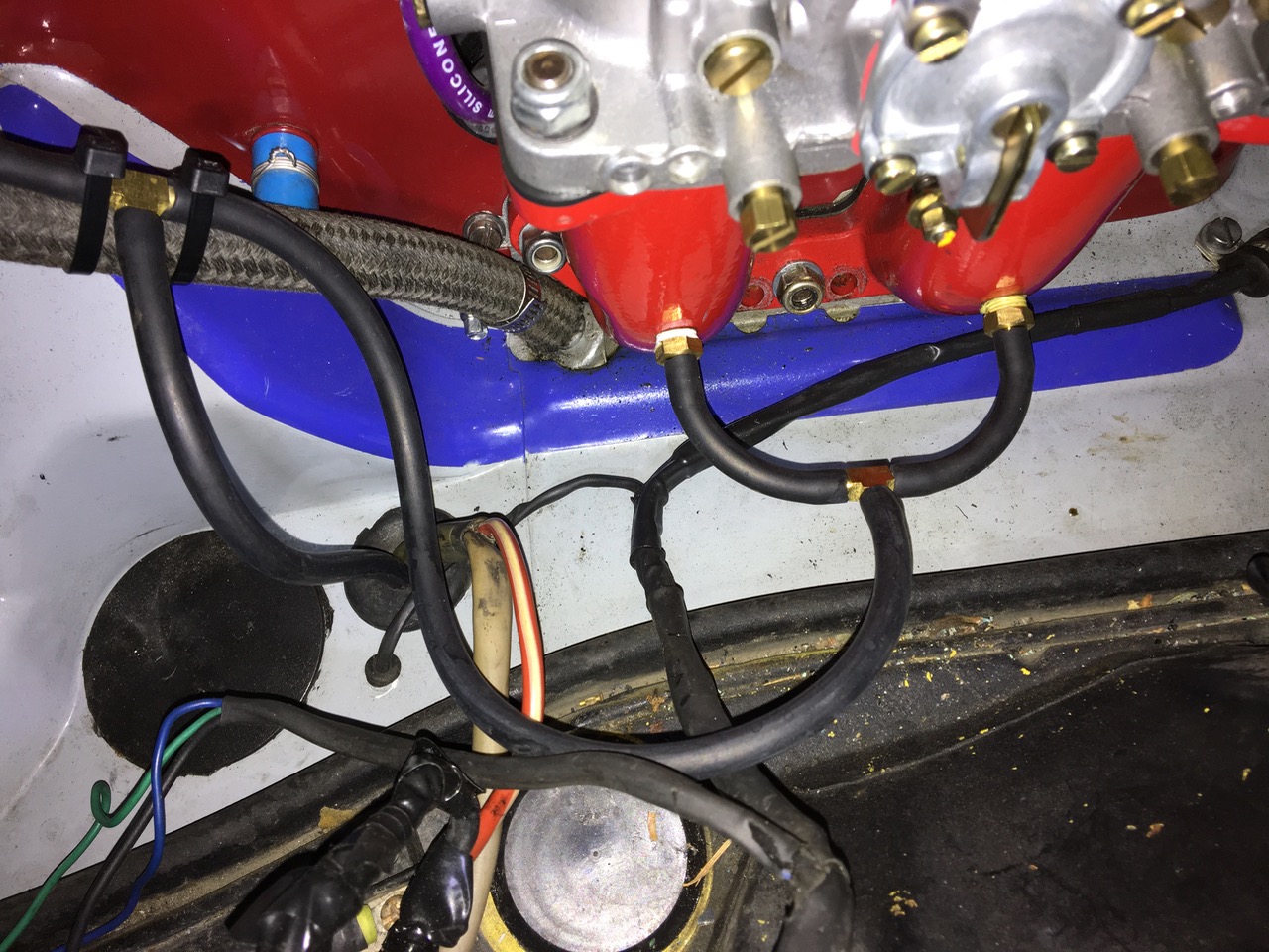

In case anyone's curious, here's how we got a manifold vacuum signal to the 123. The T on the left going down through the tin leads to my mechanical vacuum gauge on the dash (which came with the car). On the mechanical vacuum gauge the reading was a bit bumpy (even using two cylinders), but the 123 software seems to know how to dampen this (e.g. a low-pass filter), as it showed a steady signal in the 123 Tune app.
I'll probably add an inline fuel filter to smooth out the signal on my vacuum gauge.
Out of curiosity we also tried plugging into the Dellorto's vacuum port. It did indeed act like port vacuum, so not as useful for my purposes as manifold vacuum.
Doing family stuff today, so haven't yet configured a MAP curve.
Since manifold vacuum should go to zero at WOT, vacuum advance should have no impact on WOT performance (such as a dyno run). Vacuum advance should improve part-throttle performance, including drivability and fuel economy (since with the proper advance you need less pedal to cruise at a given speed).

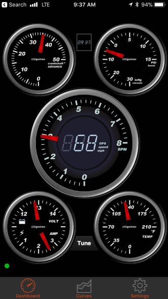

I'm curious whether there is any pattern to the temperature reading in the 123\Tune app when the problem occurs.

I haven’t noticed a difference in the temp, I’ll have to do a test run and see.
I didn’t notice any voltage drops when this was happening on the app.

What is the role of the vacuum line that runs down thru the engine tin?
The car came with a mechanical vacuum gauge in the dash, so I was curious to hook it up.

I don't know, but today I guess my dizzy was somewhere below 140ºF while engine was up to operating temperature on a cold day. Oil temp was 175ºF and cylinder head #3 was somewhere under 350ºF. Haven't had any distributor problems yet, and motor running much better with new DRLA 45s. Wish I had heat exchangers though.
