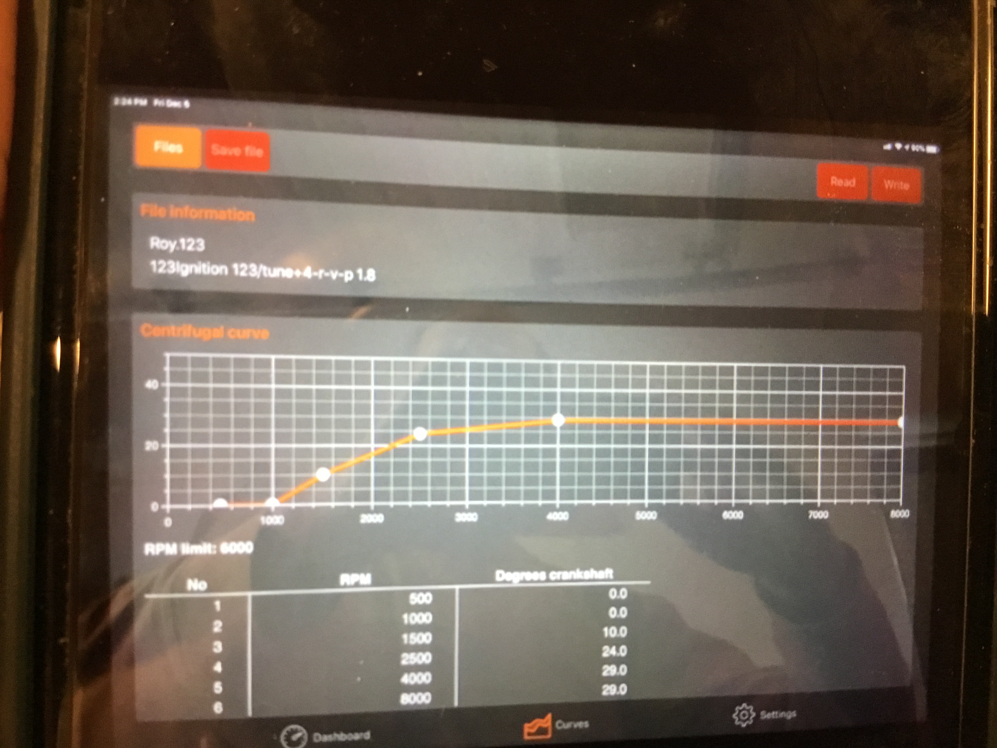

FYI I followed your directions and After programming my advance curve, fired right up! I need to fine tune it later after driving a few times and reading up more on fine tuning the curve. I took it for a short drive, very responsive and not pinging etc. Thanks again for all your help (IMG:style_emoticons/default/driving.gif)

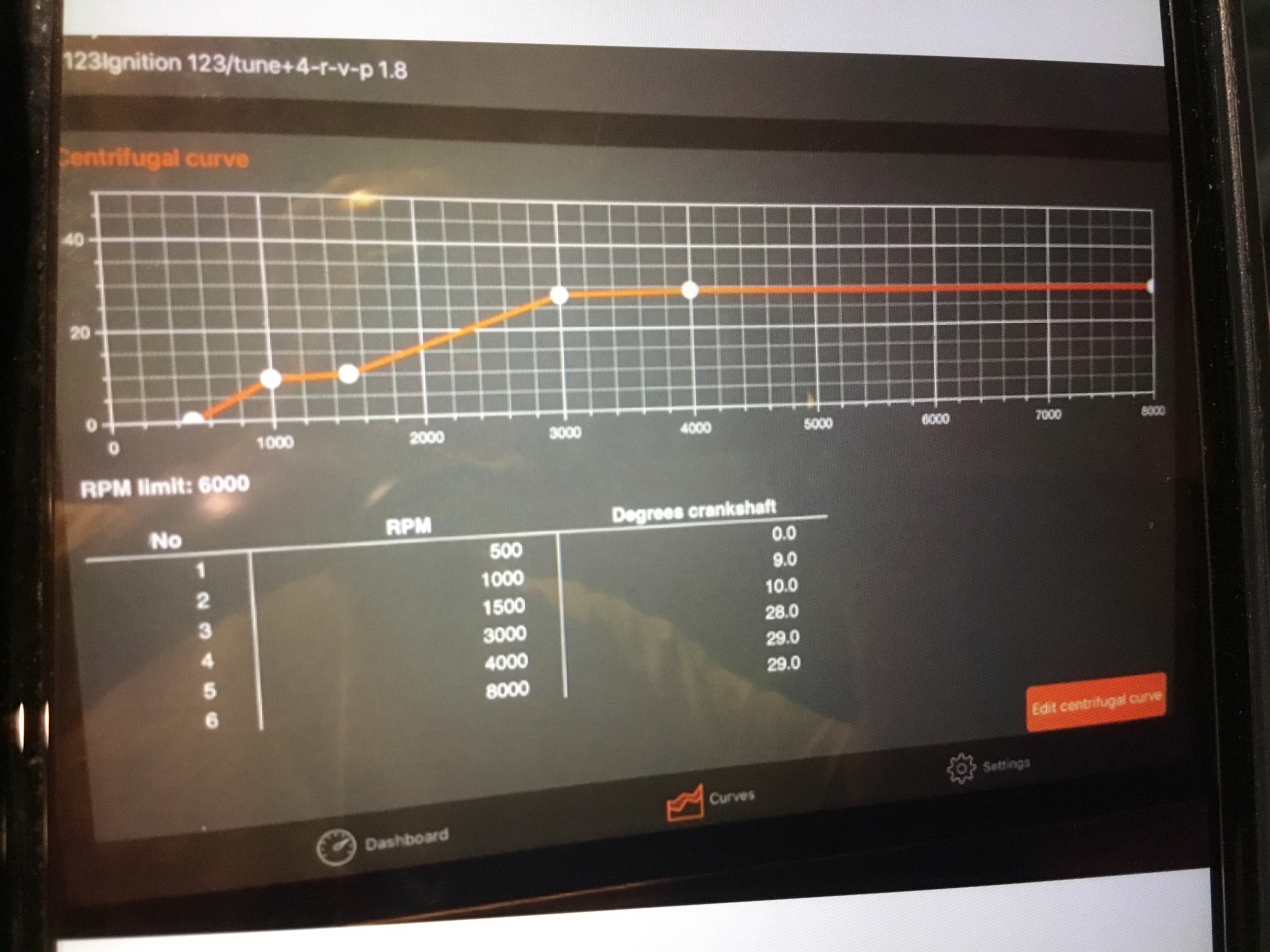

QUOTE(9144me2enjoy @ Dec 6 2019, 05:09 PM) *
Curious what you are running for total advance. 29 degrees of distributor advance seems like a lot unless your timing before the advance starts is close to zero. And if that’s the case your idle timing is only a couple degrees BTDC whereas my 1911cc doesn’t idle well at less than 8 degrees BTDC.
9144me2enjoy
post Dec 6 2019, 10:16 PM
Post #358
Posts: 310
Joined: 19-June 18
From: Oregon
Member No.: 22,240

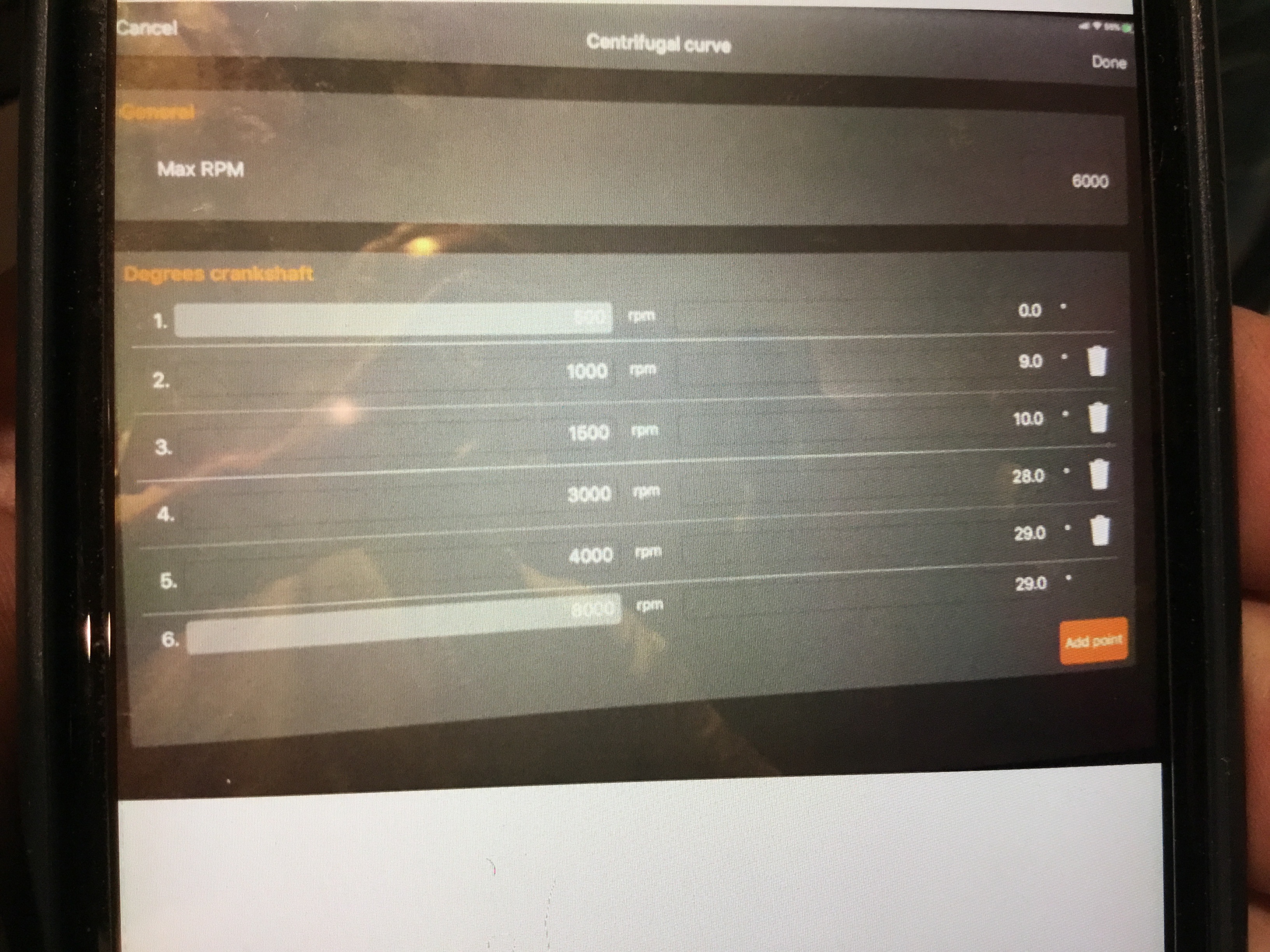

Raby is a stickler not to mess with or change his factory timing settings: From my Raby 2270 build book he shows the engine was set at Initial Advance at 9 degrees and at 3000 rpm at 28 degrees. So I went into the Centrifugal Curve settings and set them at those settings. So far so good.

When you set the curve using the 123 app are you setting total advance, or advance from initial? If the latter, then I would agree that 29 is too much. If the former, probably good. Raby shoots for total advance in his engines between 27 to 31, IIRC.
