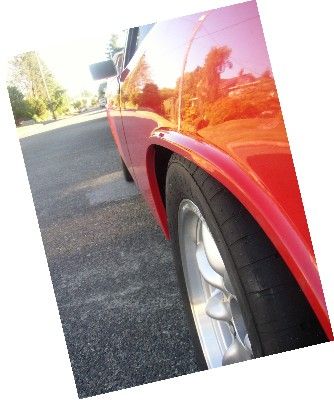

My Panasports have a 4 and 7/8" backspacing I think... Had to massage the fender lip a bit, but not by much
ChrisReale
post May 25 2005, 09:06 PM
Sleazy
Posts: 2,665
Joined: 20-January 03
From: San Francisco
Member No.: 176
here's a pic. The rear has since been lowered
