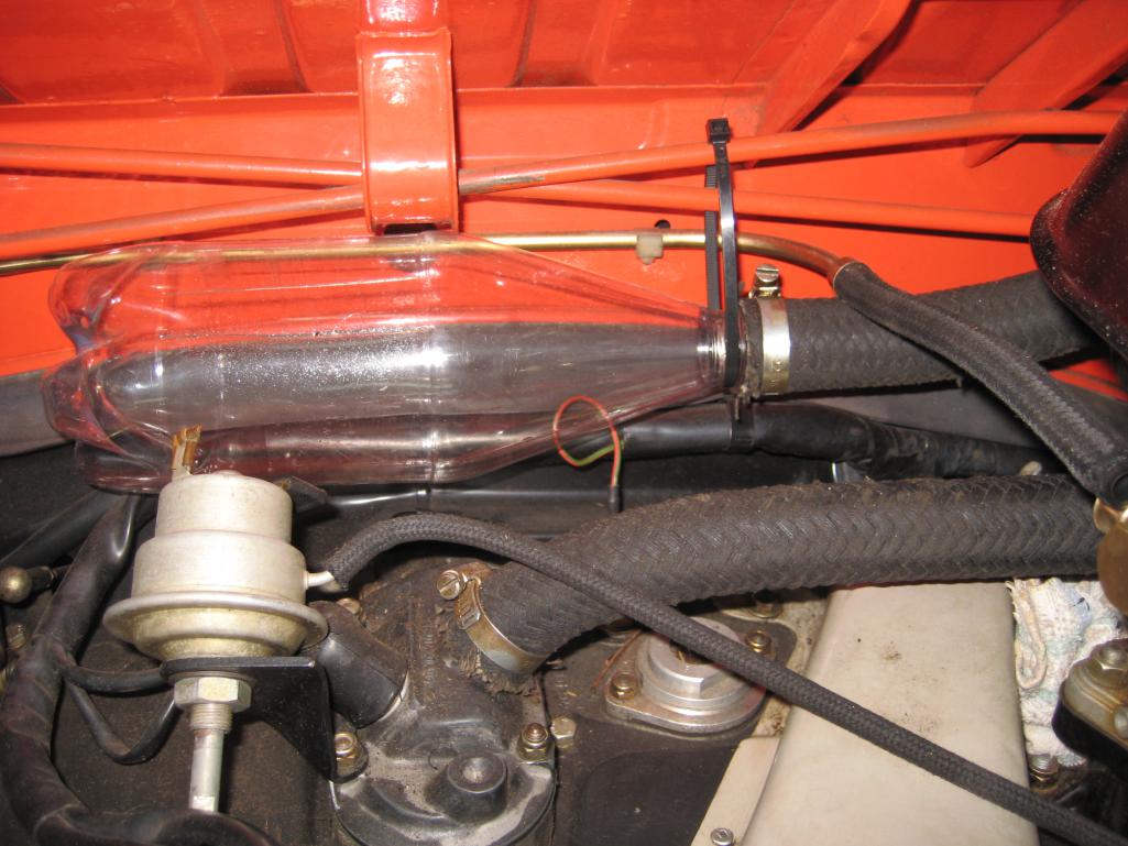

Plastic pop bottle.
Weighs nothing, no cutting, no drilling, easily reversed, practically invisible, nice fit into stock breather hose.
Plus you can actually see residue if blow-by is increasing.
Not visible in the photo are slits along the top to allow breathing.
Yes, I've fixed the fuel line snap and removed the rag.

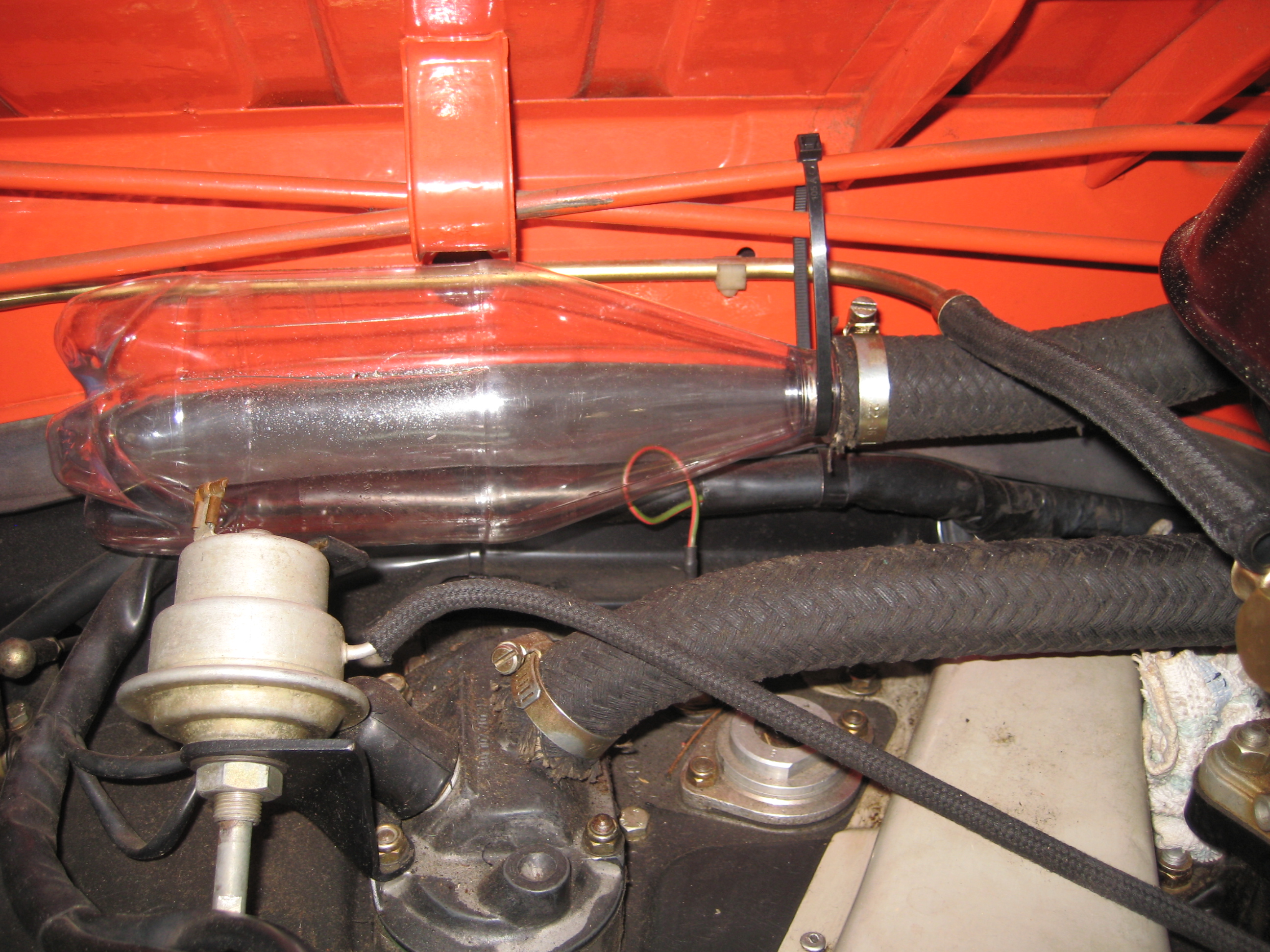

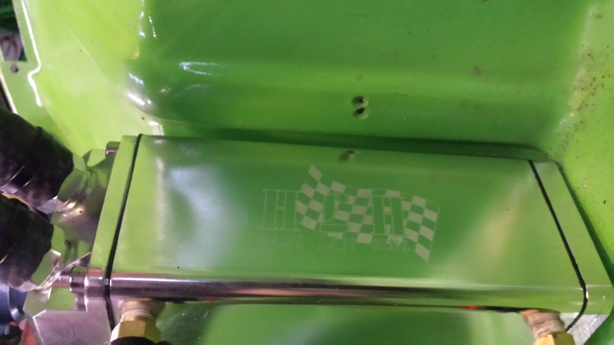

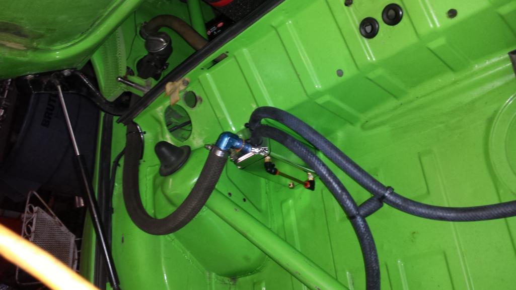

Here ya go...Attached Image Attached Image

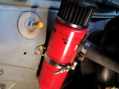

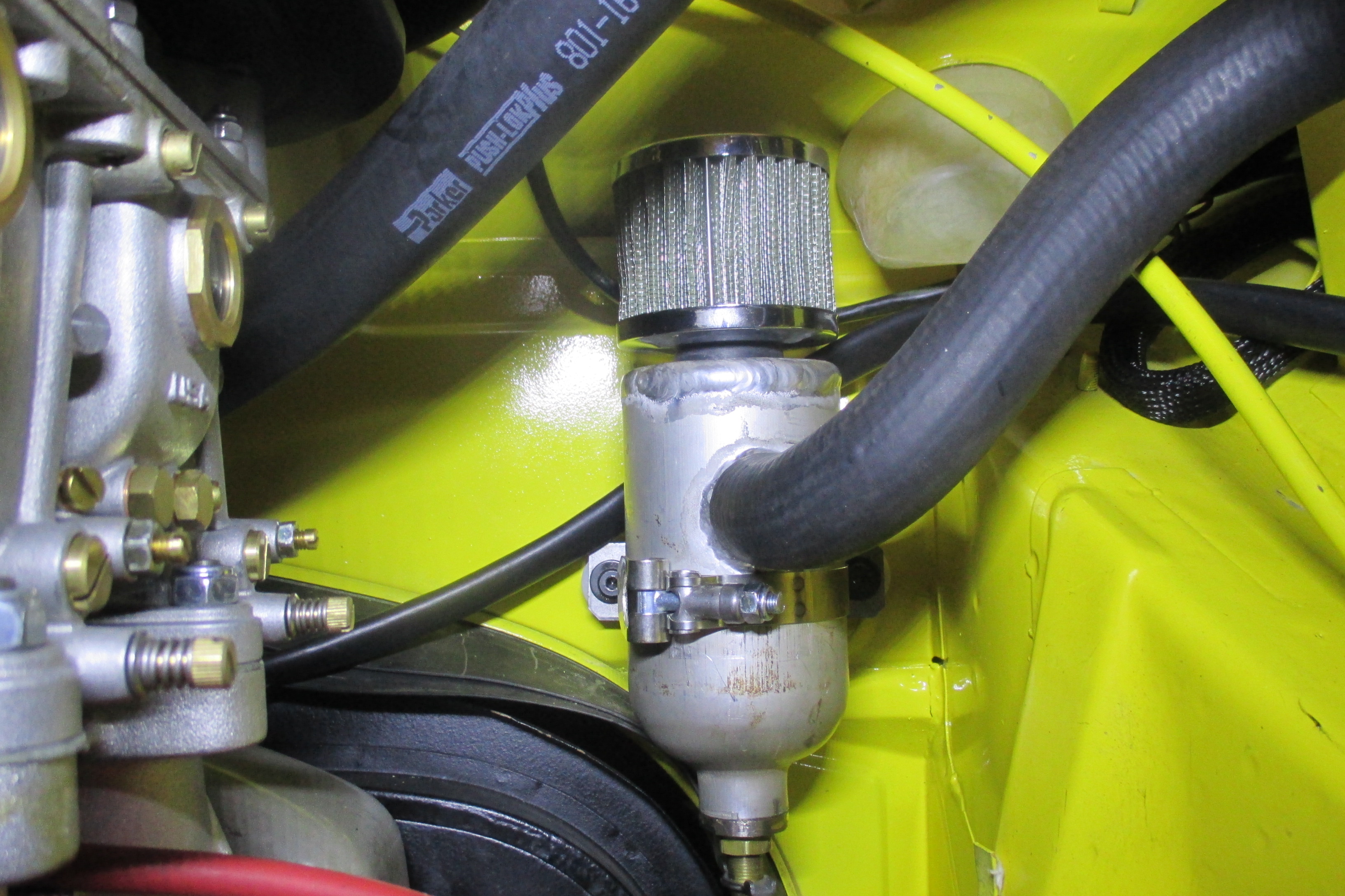

Here's mine in the 6 on the firewall right behind the driver's seat. It's a modified hiking water bottle in powder-coated aluminum... for the budget conscious builder. Hardly ever gets any oil in it. K&N breather filter.
Ron

Love the simplicity thanks for the idea. It was great to look in this morning and find 3 responses with yours being the first!

QUOTE(wndsrfr @ Nov 9 2017, 04:57 AM) *
QUOTE(Lucky9146 @ Nov 8 2017, 11:11 PM) *
Pictures much appreciated!
Thanks
(IMG:style_emoticons/default/white914.jpg)
Looks really professional and thanks for your idea and pictures. What looks to be a sight gage is pretty cool looking. Can you please tell me where the two hoses trail off to in the trunk?
Thanks again

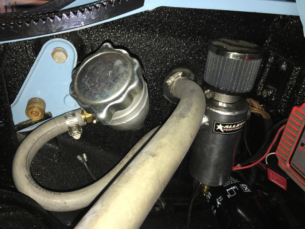

Here's mine. Bought it from Amazon.

QUOTE(pcar916 @ Nov 9 2017, 07:29 AM) *
Ron
Very creative and nice looking, the German clamp is a great touch!
Like "for the budget conscious builder" because at this point it would be cool not to spend much on this tid bit.
Great ideas so far!
Thanks

Looks really good! Does it come complete just like that with filter and drain? I'll check it out.
Thanks for the idea and the picture!

QUOTE(Lucky9146 @ Nov 9 2017, 08:30 AM) *
Thanks
Thanks again
They just poke out the bottom to apply a bit of rust preventive to the underside of the hot trunk floor..... (IMG:style_emoticons/default/biggrin.gif)

QUOTE(Lucky9146 @ Nov 9 2017, 09:28 AM) *
QUOTE(PanelBilly @ Nov 9 2017, 08:38 AM) *
I don’t remember if it was a set or a “buy this too” deal. Came with a valve for draining

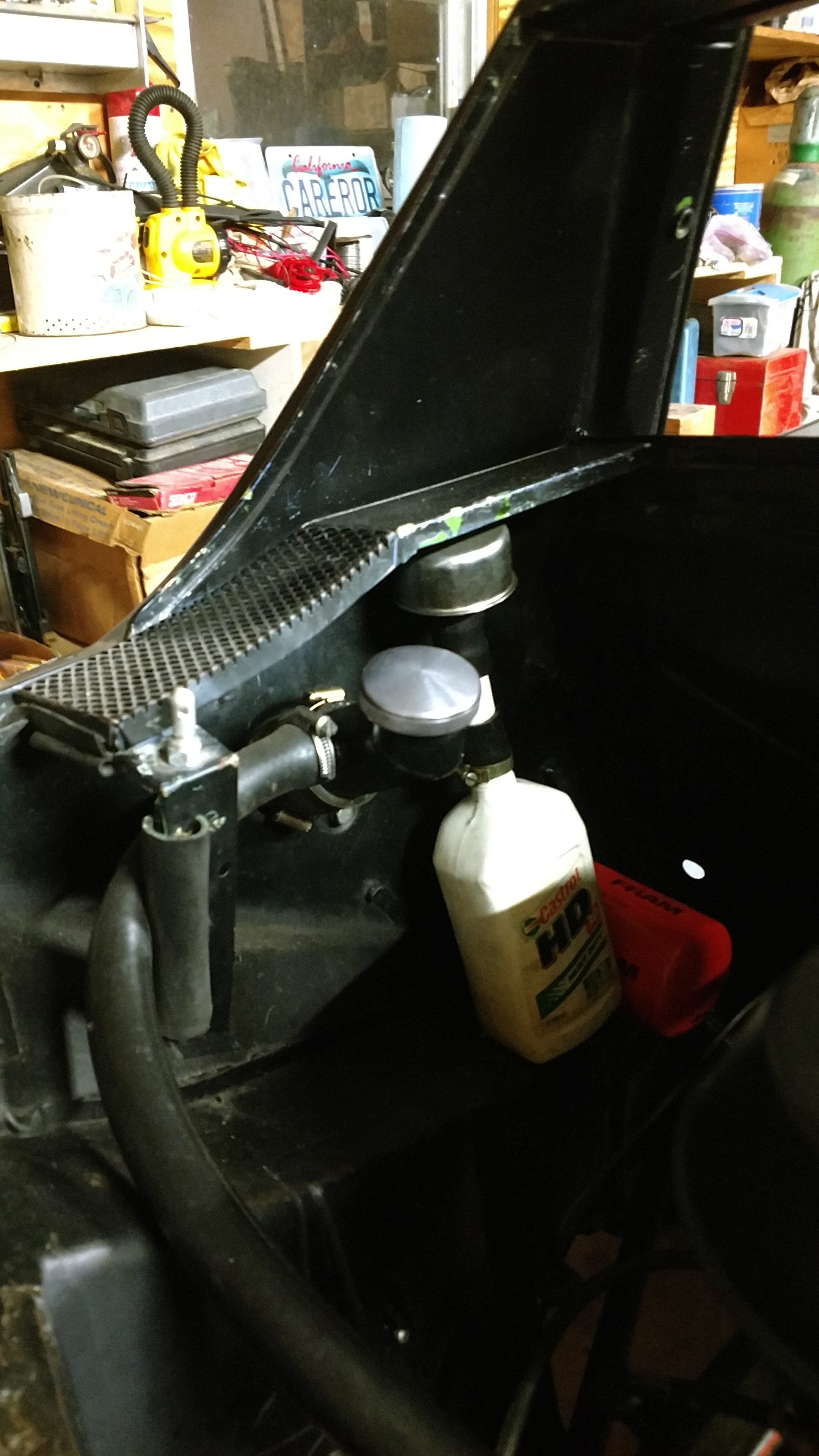

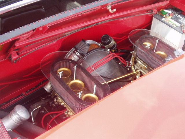

Here is what I made for my last six..

QUOTE(mb911 @ Nov 11 2017, 02:45 PM) *
Thanks and I really like the plexiglass over the carbs! (IMG:style_emoticons/default/first.gif)
