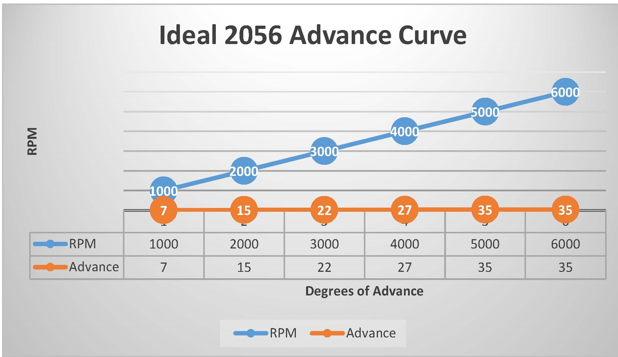

I have converted my 2.0 to a 2056 and added Micro Squirt fuel injection.
Ever since I did the 2056 conversion I have seen higher than norm cylinder head temperatures. In fact I cracked a set of heads from getting them too hot.
I played around with the timing with in the suggested 2.0 limits of around 27 degrees. but was really never able to influence the CHTs that much with changes in the timing. Adding more fuel at the right times with the Micro Squirt certainly allowed me to control the CHT much better but I always felt it was still getting too high.
Then I ran across this.
This is certainly a lot more advance than I ever added to the engine. So based on that I revised my timing table to:
Just love how easy it is to make changes with Micro Squirt.
So I am looking to see what the thoughts are on 35 degrees of advance and what impacts it may have on CHT. I am going to load this and test tomorrow.

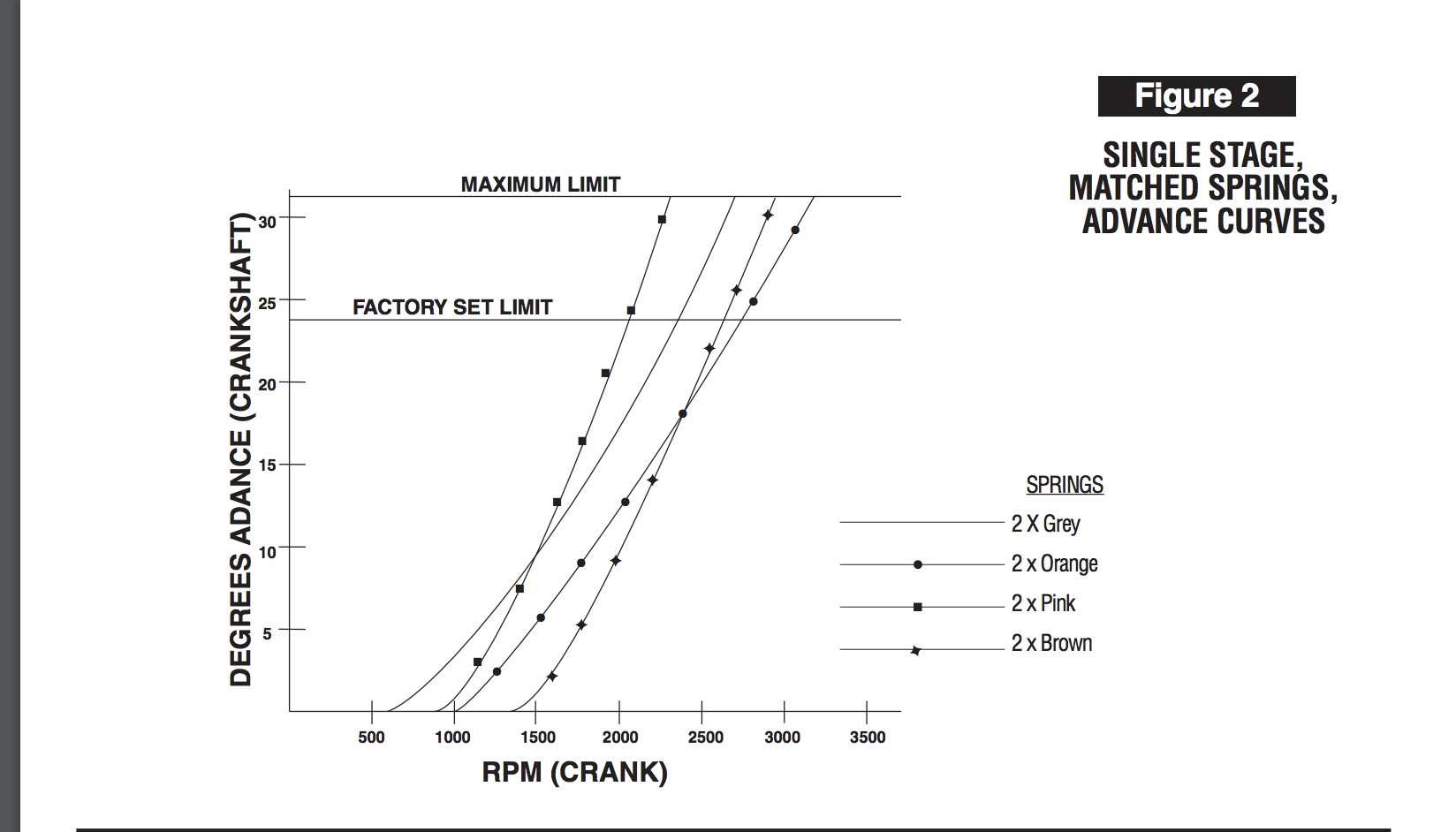

I run a Mallory with the recommended "grey/grey" springs. 16 degrees total advance (12 idles, 27-28 max). Here is the advance curve:

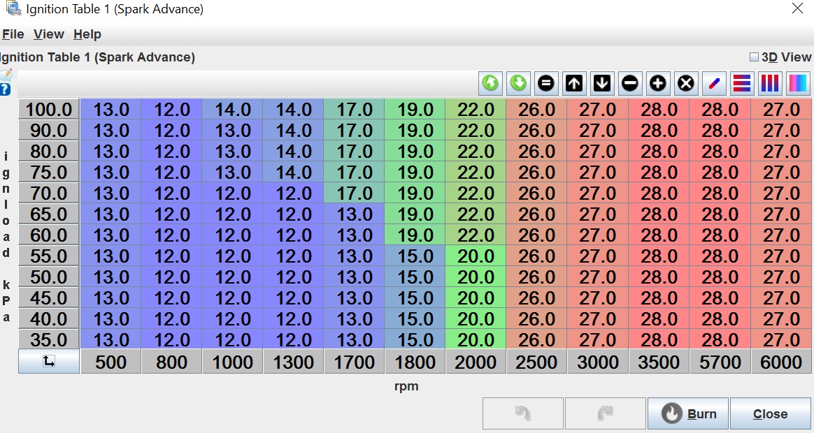

This is the table I run on my 2056. It gives very snappy response and even on a hot Utah day the heads are usually under 350 deg. I setup a similar table with a slightly less aggressive ramp up before 3000 rpm (as its not my motor to blow up) on my buddies monster 2270 and it runs just as cool at the heads. Bottom line the majority of your driving time is going to be spent between 3000 and 5000 rpm and that range should always be 27-28 deg advance and somewhere in the 13s afr on cruise and 12 on load. If you are hitting those numbers and still running hot you probably need to look elsewhere to run cooler.

QUOTE(JamesM @ Nov 17 2017, 12:56 PM) *
Mike,
Is there specific RPM/Load point on your map where you notice the overheating the most? If so what what is the range (RPM and load) and what do your advance and AFR numbers currently look like there? What RPM range are you normally cruising at?
Curious where that recommended advance cure you posted came from as I have not seen number like that suggested before for a type 4 (though i have for a type 1). The timing table I use was based on a compilation of previously shared data (most of it dyno testing from Jake Raby) that shows you want full advance to come in by 3000 RPM and that max advance is best right around 28deg. Based on what I run the table you posted is slightly retarded from idle pretty much all the way to 4k RPM which i suspect may cause you to run slightly hotter.
Also, what sort of head temps are we talking here? As I recall you mentioned you are running a stock cam and those are known to just run hot. I have a perfectly tuned (passes emissions every time) stock cam 2.0L car that usually runs in the 350-380 range but under extended periods of load can get near the low 400s where as my warmed over 2056 megasquirt car with modified cam rarely even sees 350. I would expect a stock cam 2056 would be pushing near 400 pretty often even when dialed in. Not sure there is much you will be able to do about it other than change the cam.
Ill go grab the timing map off my laptop and post it here in a bit.

I found this is a couple of different locations that I will track down the sources. But this is another one of them that specifically references the Type 4.
I got no attachment to this table and like you it was something well outside of what I knew about the Type 4.
I was previously running your table. At highway speeds 70+ the engine always ran at 350 or higher unless the AFR was set in the 12s. Under load going up a hill temps could reach 400.
Pretty sure the cooler winter temps have a huge impact on the temps that have nothing to do with the timing change. But with the new table they seem to stay in the 360 range on the hill climbs on my standard route to work. Change it to summer temps and I am betting I see similar temps or higher with the new table.
I am like you moving toward the cam as the issue.

Source of suggested advanced curve.
http://www.volksbolts.com/faq/combustion.htm

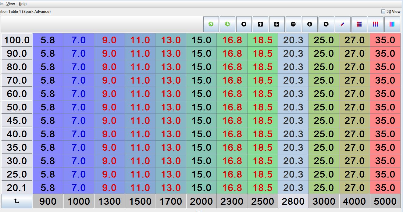

Heres my ign table, 2256cc, web 86b/c 10:1 compression.

I got to admit looking at those tables is so confusing, the main reason I've never embraced MS or other data overload systems.
It's a fricken timing curve, not rocket science!
My SDS has one value per 250 rpm, that's it. Same could be said about a mechanical dizzy, sure springs but it's a simple curve.
I agree with Jake and Mark, idle too low I run 10* and 30*+ is too much advance on a T4, I run 28*. If anything I'd consider retarding the timing a bit as I approached 6000 rpm.
One of my tricks when tuning is I have a highway close by that has a long (10km) steady uphill grade and it's divided by a concrete barrier. When in the passing lane you are about 24" from the barrier and the sound bounces so you can really hear the engine mechanicly. I've tested 1.8, 2.0, 2056, 2270, and my 2600 T4's any time I push it to 30* I can hear the ping. I can also see head temps going up.
Ping is about the equivalent of hitting your piston top with a ball-peen hammer. Sooner or later it will kill your engine.
The chart above "Ideal 2056 Adavance Curve" that might work on a WC engine but I'd never consider it on an aircooled T4.
Watching a three dimensional system operate in real time helps a lot in understanding how it works and in reality it is not much more than a simple timing curve once you know how to read the table. Its really just 10 simple timing curves stacked on top of each other.
Take a single horizontal line of the table and that is basically what you have with SDS, a timing setting where the only variable is RPM ( X RPM = Z degrees advance) Like a distributor that only has centrifugal advance. Setting all the horizontal lines up the same produces a table that works exactly like SDS works.
The Y axis of the table represents engine load. Depending on how you have the system configured this is usually determined from manifold vacuum but could also be throttle position.
So basically every horizontal line is its own independent timing curve and which one is in use at any given time depends on how much load the engine is currently under (or at what position the throttle is). So the top line is basically the ignition curve that is used at wide open throttle, and the bottom line is the timing curve used when the engine is closed throttle under deceleration and everything in between is everything in between, timing curve for 60% throttle, 70% throttle etc. Its sort of like adding vacuum advance and retard cans to a distributor, but magic ones that are able to defy the laws of physics that apply to a vacuum canister in order to provide exactly what you want at all time.
Obviously having load dependent timing curves is not necessary for an engine but it does allow you to optimize for all running conditions and do some cool stuff, tricks that you couldn't otherwise do. It can be used to improve drive ability, gas mileage, emissions etc without impacting your WOT power. Fully optimizing a tune to this extent though would require tools not readily available to a home mechanic which is why i question a lot of peoples tables that look like they have been.
The table I posted is pretty simple as it is basically the same curve across all loads, the only change i made from there was to not have the timing advance as quickly in the low load/idle area of the map in order to help stabilize the idle but still immediately ramp up the advance as soon as you get on the gas.
Will sometimes it does seem like data over load it is clear that a system that is responsive to loss has advantages. Using a straight rpm based timing chart was certainty less responsive than the one you provided.
