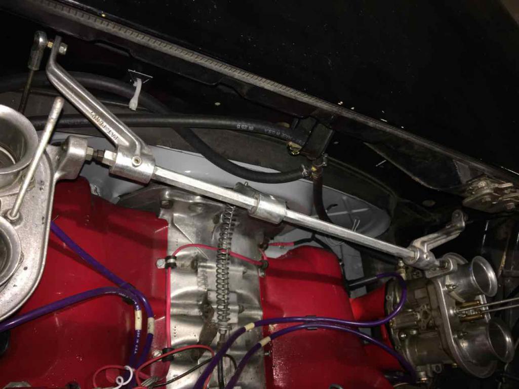

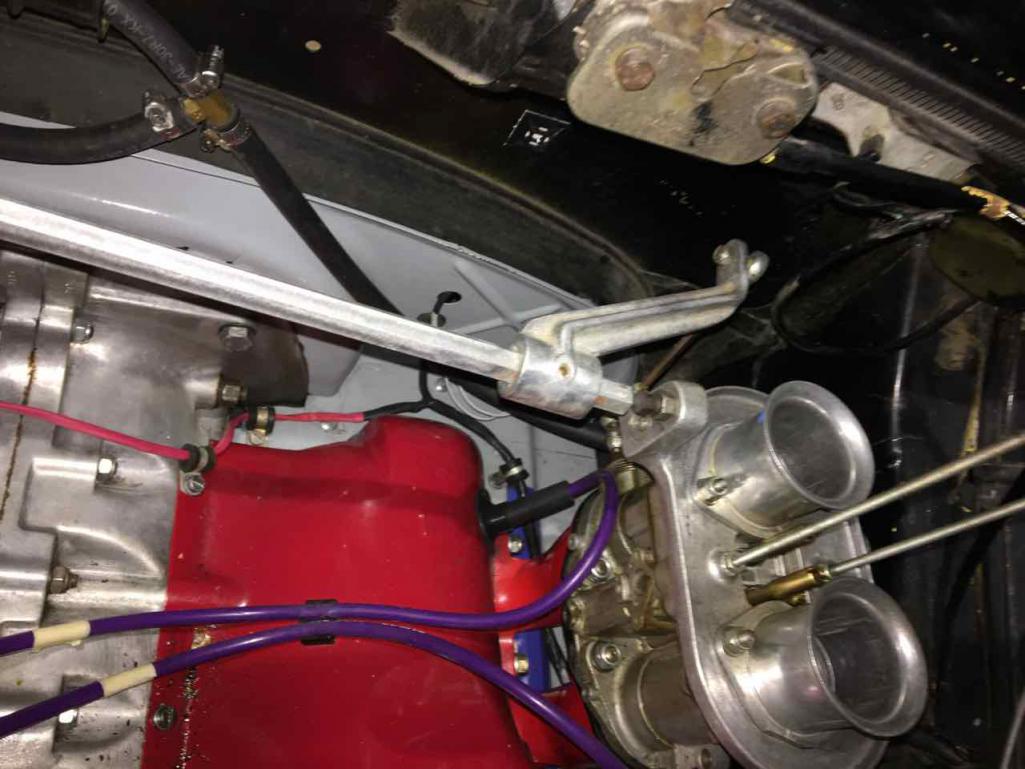

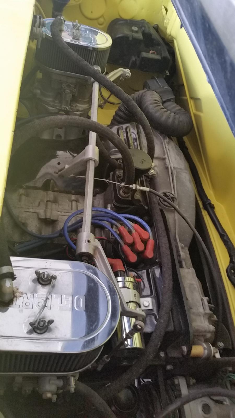

I suddenly find myself owning 1970 4-cylinder 2.4 with Web hot street Cam idles nicely and pulls hard at WOT. Part throttle response is not great, often with carbs coughing and even backfiring on trailing throttle. My use is mostly street, so I'd like to get this part throttle stuff sorted.
Here's pictures of the stuff that's in there now. I guess that's the infamous Bosch 009 with no vacuum advance and a PerTronix 1847A. The carbs are Dellorto DRLA 45s with short velocity stacks and these tall foam things that don't seal against the air cleaner housings. I'm willing to learn about the carbs but I don't have much confidence in the 009 for running nicely on the street. Please correct me if I'm wrong about any of this stuff.
Also from other threads I gather that switching to EFI such as MicroSquirt would cost $5K or so ... though I'm not ruling this out completely. Correct me if I'm wrong about that.
Is this kind of linkage OK?

I don’t think a micro squirt conversion runs that much, but I’d look for ignition control if you were switching over. The Bosch 009 doesn’t work that well from what I’ve heard, but perhaps others can chime in what has worked for them.

Cheapest would be to ditch the hex bar and get a CSP linkage, then find a redtop Mallory dizzy. You could ditch the points and add a pertronix, plus get grey/grey springs from aircooled.net

Buy the CBPerformance Dellorto book and your carb problems will go away as to spitting and coughing or other carb issues

Invest in the CB dell manual and a synchronizing tool. Pelican (among others) has them, #PEL-TOL-STESK. Or be prepared spend $100+an hour to have someone sort the carbs out. You could buy a 123 dist for a carbed engine and have money leftover just to discover what might be amiss if subbing out the work. While the 009 will fuction, your ingnition will not be optimized.
Do those tall air filters interfere with the rain tray?
PS replace the fuel line clamps with the shouldered variety as opposed to the slotted type.

I found what might be the linkage Mark's recommending?
http://www.mamotorworks.com/VW/product/car...engine-325064-4
It says for IDFs... also suitable for DRLAs?
But I'm guessing that there's not much point in tinkering with the carbs until a more appropriate distributor is installed -- is that correct?

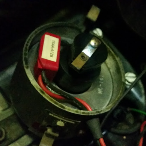

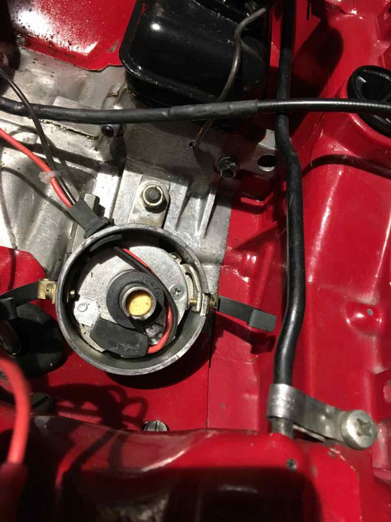

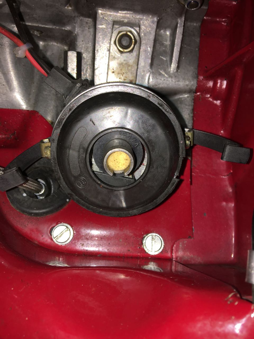

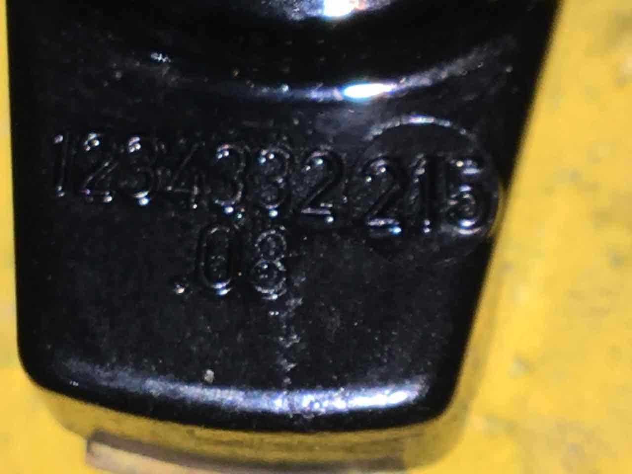

Sorry for a possibly dumb question: I'm actually not 100.0% sure that's a Bosch 009. I assumed that it was because I googled the number on the rotor "1234332215 .08" and it was associated with the 009. Do I definitely have a 009 now?
Another view showing the PerTronix 1847A position sensor. I guess I'd need to move that oil pressure sender if I installed a Mallory?
I'm reading about the Mallory distributor now. I found some old posts where Jake Raby is recommending the non-vacuum advance models because those mechanisms are hard to tune and unreliable. So that's interesting.
A previous owner installed the PerTronix Flame Thrower coil in 2010 along with the breakerless ignition.
The previous owner provided Bob Tomlinson's 1995 "The Dellorto Superformance" book.
The foam things don't look like they're sealing well. I haven't found air filters that would fit online yet. I'm curious why the current air cleaners are so much taller than the velocity stacks... maybe someone was thinking about top end only?

QUOTE(rhodyguy @ Nov 25 2017, 11:36 AM) *
In progress -- thank you!
I wasn't aware of this option. Thank you.
John Walker said he *might* look at my car if he's available mid-December. My theory now is that the 009 (and the hex linkage?) by themselves may be sufficient to explain the poor street behavior.
Yes, they would interfere with a rain tray. The car came from San Jose with boxes of parts I haven't even opened yet. I'm guessing a rain tray is not amongst them. I drove it in the rain once to get it the rest of the way home from Auburn. It wasn't an experience I'd like to have again.
Thank you! I will do that, or have it done so I don't screw it up. Any other changes you'd make, especially safety related?

The Mallory distributor body is rather large. Dimpling of the pass side engine tin is required. As I understand the situation, sourcing new modules for the mallorys is difficult.

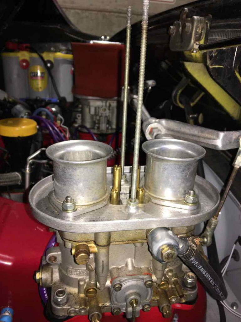

In your carb pic the vacuum advance port isn't capped off ??
If you are infact running a 09 it will need to capped off,check the other side carb also ,you may or may not have the same there.
Do you know the spec's of the carbs ?? ,been said many times but they are still large carbs for even a 2.4 if not setup right...that will leave a very soggy mid range if not right.
If your carbs are close to being dialed in you could try a vacuum advance dizzy such as the SVDA or 034 (?) Bosch type if you have vacuum ports on both carbs ,larger carbs and a hot street cam will most like see the 09 being even less desirable.
Are you running the right fuel pressure ?,is your fuel from a regulated source or direct from a LP pump ?.
Someone like John Walker will most likely need to see the engine fully tuned (plugs ,leads,timing and valve clearances ) before he will attempt tuning the carbs ,that's the order its done in.
Whoa, in the photo it sure looks like it’s not sealed! I’ll check both of those. Now I’m confused how it could idle so smoothly. I guess I should check for vacuum leaks in general.
