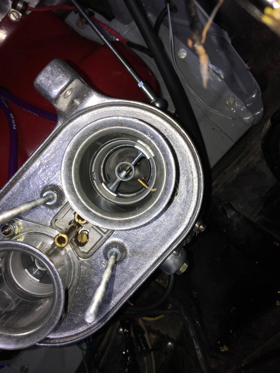

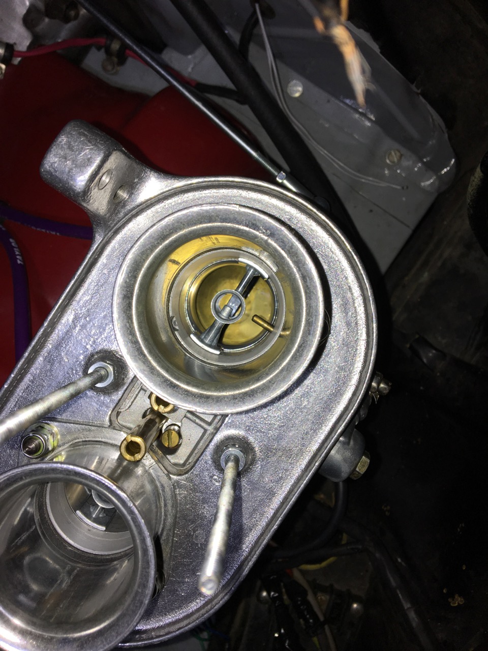

Did the throttle plates fully open during the test? Also, ensure the pedal stop isn't restricting travel.

Hmm, well her pedal press took up all the slack in the line, and I couldn't rotate the linkage any further than that from the engine bay.
I just took off the air cleaners and doublechecked that rotating the linkage until it stops opens the throttle plates completely. Result was the same on the other side.
Evidence that the mild camshaft is the limiting element (or part of it), I found a Original Customs ad for a 2056 build using the same FC442 cam that I have. The ad includes a dyno run that peaks just short of 125HP around 5400RPM. I'm guessing that chart is crankshaft horsepower (BHP) rather than wheel horsepower (WHP).
Would you guys reopen a new engine just to change the camshaft? I'm more inclined to rebuild the transmission, fix the leaky rubber seals, track down the oil leaks, before worrying about being only slightly faster than stock.
