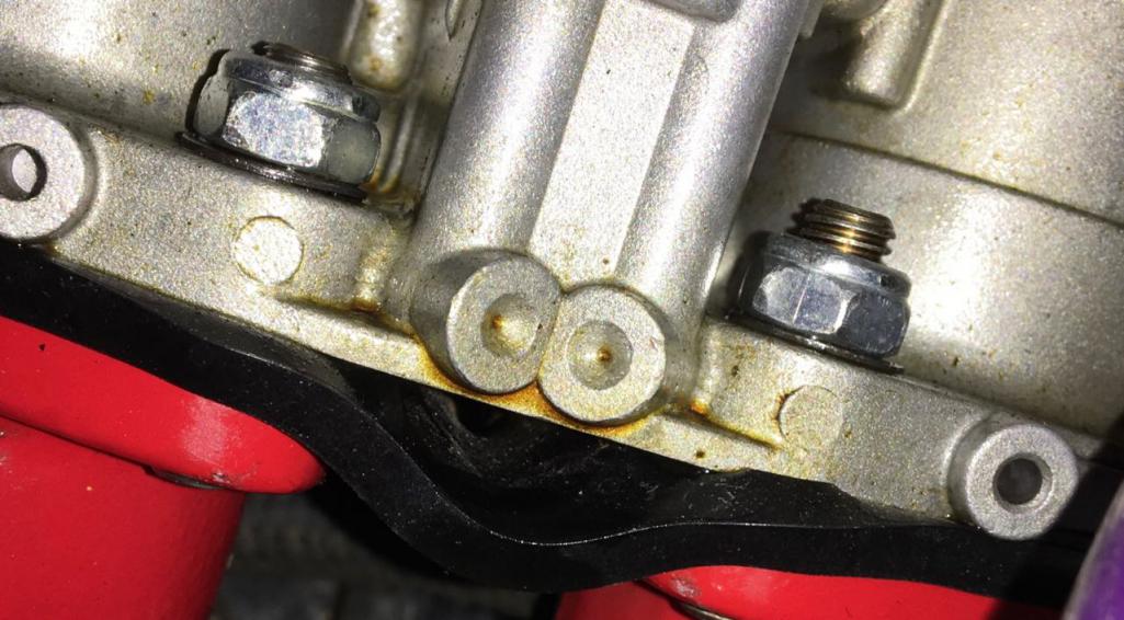

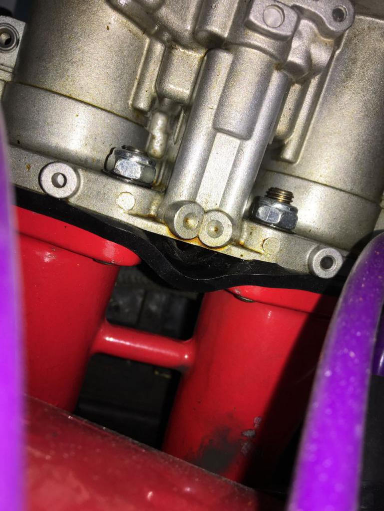

I hope another newbie question is appropriate. I noticed this intake manifold gasket is deformed. Is this caused by overtorquing? Will it leak?
I have not removed the carbs yet -- still afraid of messing something up.

I've never seen one like that. Neoprene? If you want to investigate just remove the 8 nuts, cable and fuel supply line. Then you can lift both carbs at the same time preserving the current settings. Nyloc nuts? That's a new one too.

Holy cr#p never seen base caskets like that,WAY too thick if they are overtightened you could bend the carb bases...seen it before ,thick cork gaskets can do the same.
The correct gaskets are only 1mm thick and usually high temp material,I have an Italian Dellorto kit in front of me now.
The OP needs to go right through this whole setup and start again from scratch,every problem or potential issue needs to be sorted before trying to tune them afterall.

IIRC those are CB performance gaskets, I think they called them "dellorto doctor".
Dellorto's have a weird notch cast in the throat that makes an annoying whistle, the gaskets have a molded part that stick up into the notch to stop the whistle. I believe they are a hard plastic.

My carbs had some thick gaskets somewhat similar to that. They have a built in raised portion that fills in a boss/void in the bottom of the body of the carb. I used them till I wore them out...I was never able to find a source for them. The raise portion keeps the carbs from whistling or chirping. If they aren't leaking I would leave them alone. In fact if you aren't planning to rebuild the carbs I wouldn't remove them.

I noticed that site says:
correct torque for the 4 mount nuts is 10-15 INCH lbs. We also suggest tightening in a criss-cross pattern and bring the nuts down slowly to torque. Lastly, we recommend running a spring style lock washer under your nuts
Maybe those instructions weren't followed in this case?

Nyloc nuts are probably not what I would use but no big deal. The problem with them is they may want to unscrew the stud from the manifold when you go to loosen them. I would just snug them evenly.

I don't get how it could bow down that much.

So the gaskets weren't leaking (at least at idle). It does seem that the right side of the engine is pulling harder than the left off of idle. So I think I need to adjust the linkage.

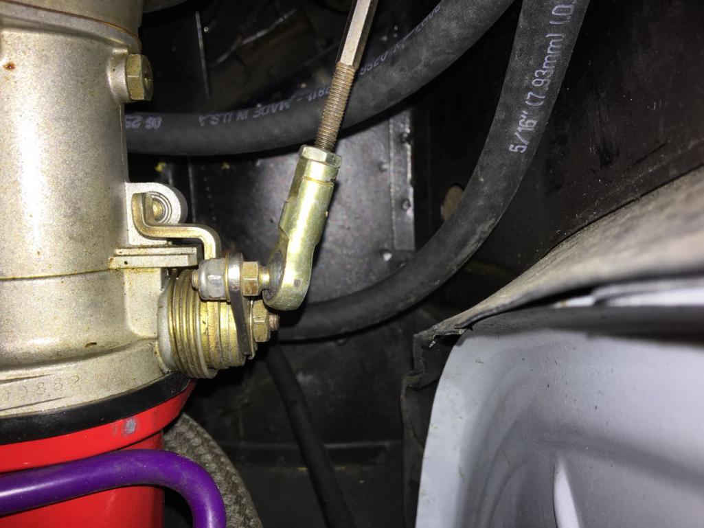

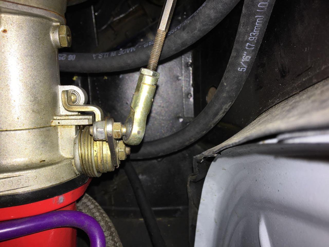

Does anyone happen to know the wrench sizes of those CB Performance linkage rod lock nuts? Are they metric? I don't own many tools yet and I'm afraid of cornering them with my crescent wrench.

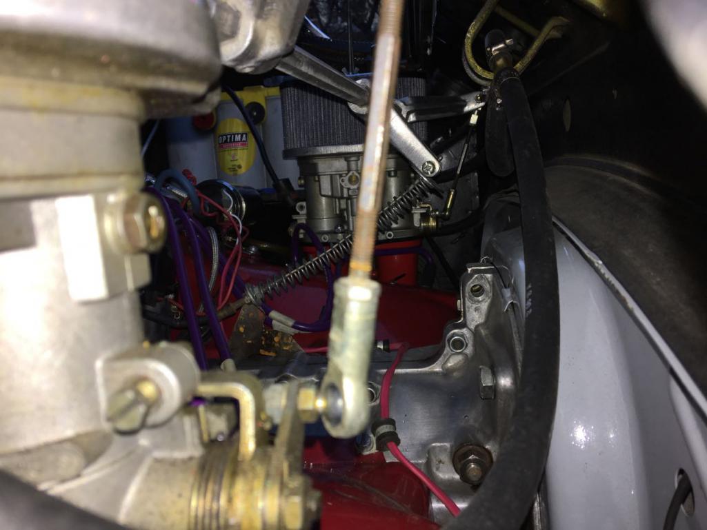

Also the linkage arm rods should have the same angle from the linkage to the carb base area, if not they will open at different rates.
Mine do not have the same angle, and I don't see how to adjust it. The angle on the right carb (the second photo) looks especially awkward to me.

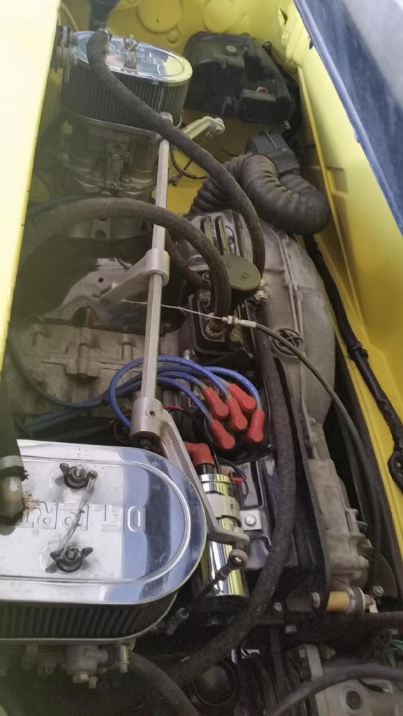

I does sound like it running on three cylinders. I would clean the idle jets. Those brass tubes that are sticking up with the slot head next to the carb throats are the idle jet holders. You unscrew them and pull the jet off the end of the holder and spray carb cleaner through them. You can hod the jet up to the light to see if it the orifice is clear. They are small so be careful not to lose one or drop it down the carb throat. I usually do it one at a time.
As for the angle of the linkage the actuator arm has a set screw that tightens into the hex bar. You can move the actuator from left to right so that they both have the same angle and are parallel. The swivel rod is also adjustable so that they both have the same slack. You want to make sure one of them isn't opening faster than the other.
The linkage is not metric. It set nut takes a 3/8" wrench but I use a small crescent wrench so that I can adjust it small enough to adjust the rod.
If you look at my photo you can see that my actuator arms are all the way at the end of the hex bar. Yours look like they are more inboard which doesn't really mater as long as they are both the same.
