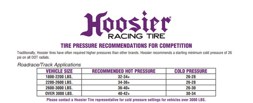

I'm trying to get the tire pressures right on the R7s on my 914/6/gt. Running 275x35x15 and 245x40x15. I initially started at 22 shooting for 27 hot but I think they like to be run a bit lower than that.
I'm nowhere near what Hoosier recommends though.
Any thoughts?
