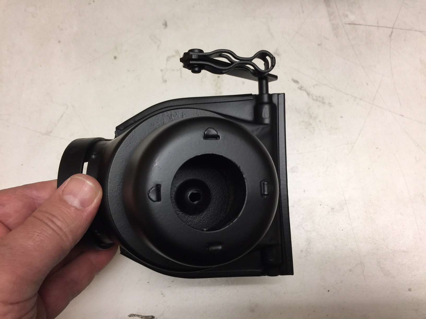

Homemade six flappper valve

Ben - I could be wrong but it sounds like the correct ducts are there but capped. I’m not sure If the OP realized there is not a “special” lower duct but you use the fan shroud ducts and run the hose through the side engine tin. Down to the he’s.
