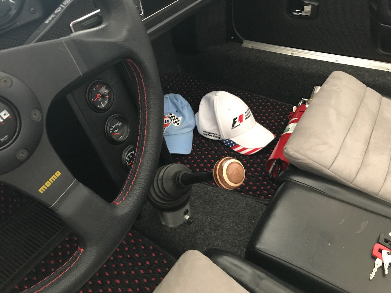

Recommend rennshift- have it on my '71 (with converted side shift) and my '73. Looks even better with Zach's knob too...Attached Image
Really improves the 1-2 shift...

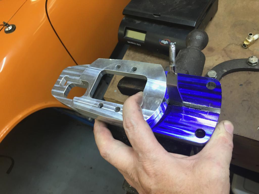

Here is a link to the thread showing 914forme's Rennshift modification for a hand throttle. See post #213. Here is the photo:
http://www.914world.com/bbs2/index.php?sho...9606&st=200
That is similar to what I was thinking. Have to look closely at how the space for the throttle handle baseplate is accommodated under the shifter base plate.
Also, possibility of mounting the hand throttle assembly say 2' in front of the shifter base plate on the tunnel by drilling holes for bolts and cutting slot for handle and shortening the rod the same amount (?)
