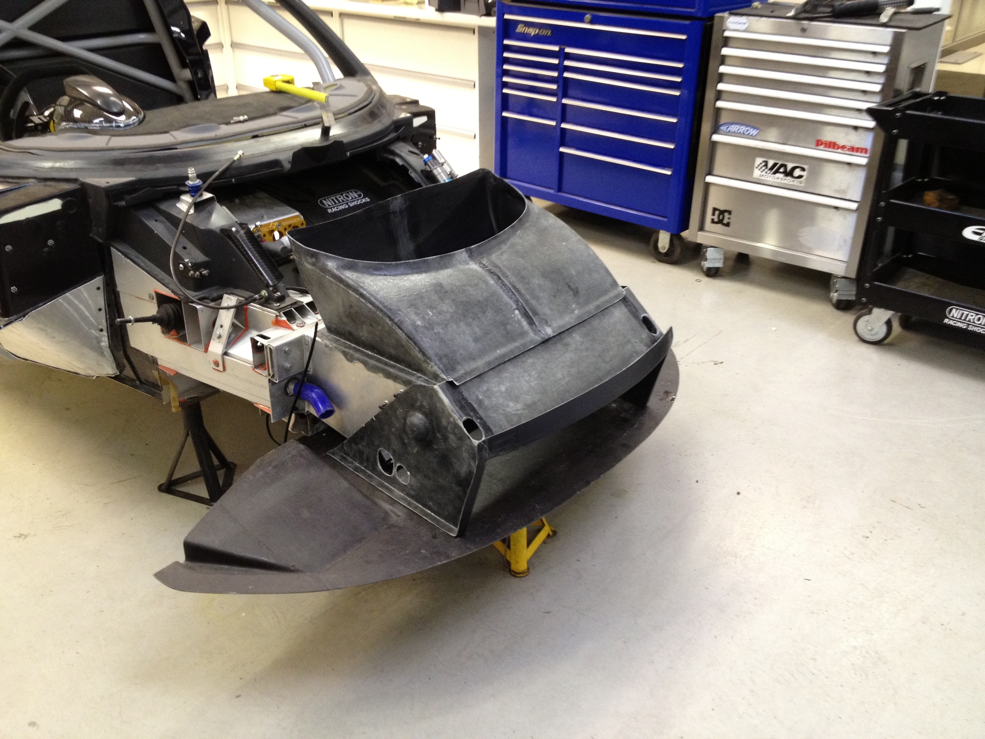

The idea of the radiator on the engine lid is interesting to say the least. There's the low pressure area right behind the rear window that will fill with air from underneath the car naturally and more so when the fans are on. And when you raise the radiator on the hinges, it should make it a snap to bleed the cooling system. The weight of the rad is up high which isn't the best but it's centrally located so it still helps the polar moment of inertia - not a bad thing at all. If you can move it up far enough you can still work on the engine but being a Subaru, you really won't have to work on it much at all.
I think I'm going to research this option a bit more.... (IMG:style_emoticons/default/idea.gif)

Add rubber skirting, a M1A1 Tank fan, and a snow mobile engine you will gain three things.
Power to draw the air through your mid engine radiator.
Power to create a sucker car, best handling 914 ever (IMG:style_emoticons/default/aktion035.gif)
And you now have a fun side business as a street sweeper.
All of this can happen just until some piece of derby gets pulled from the road surface and sucked through your radiator. (IMG:style_emoticons/default/av-943.gif)
