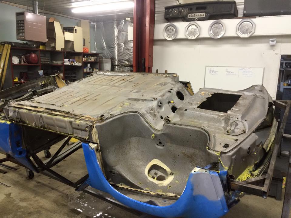

In 2013 I found a 73 racecar, with fiberglass flares, already had 5 lug suspension, it was a roller, but it had near zero rust. A near blank canvas to build myself a GT.

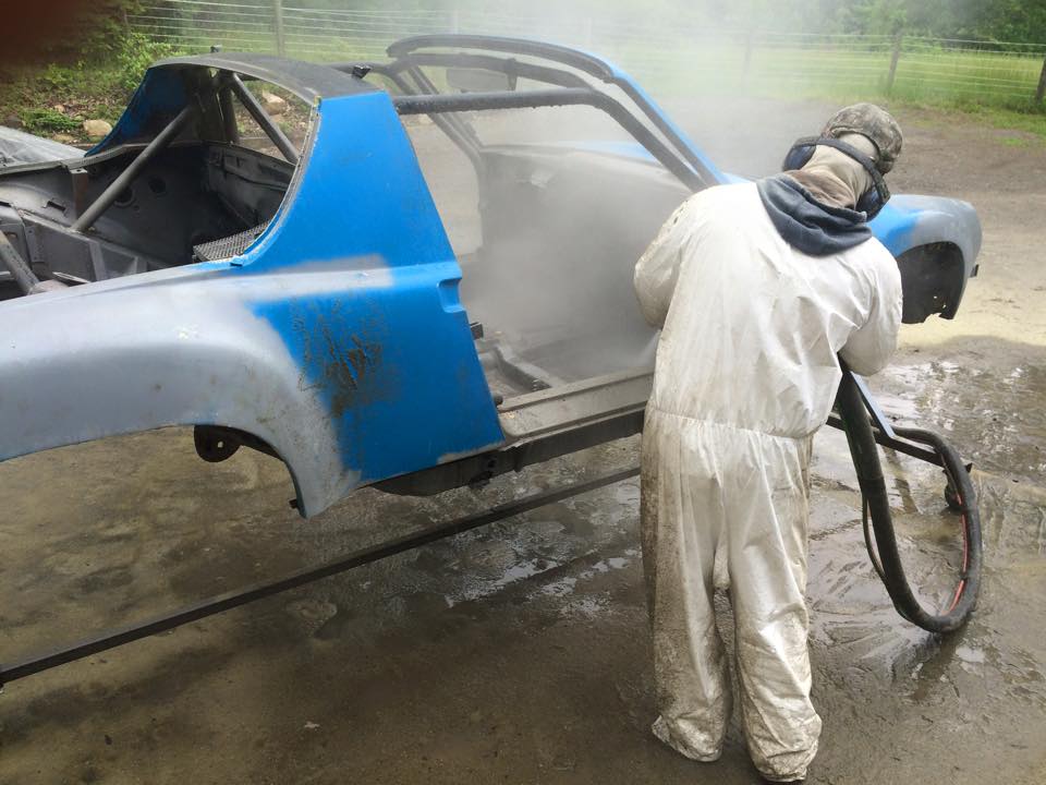

Here is one of the first pictures I took of the car after I flat towed it home;
A friend had just purchased a 'Dustless Blasting' system, and his first auto paint removal was my new car. I wanted to see the bare metal of the underside and the known rust trouble spots.
We found some rust, but very little. She would need some repairs and alterations, but now I could now see what was under all the darned black paint the P.O. had sprayed on the interior and both trunks and engine compartment.
Why do people think race cars need to look like a dark cave inside?
No bother all the black cave paint was GONE!!
