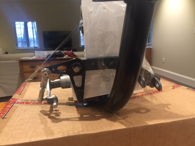

Does anybody have a copy of the directions or even a picture of the assembled parts. I just want to make sure I am putting together the linkage as intended. Thanks!

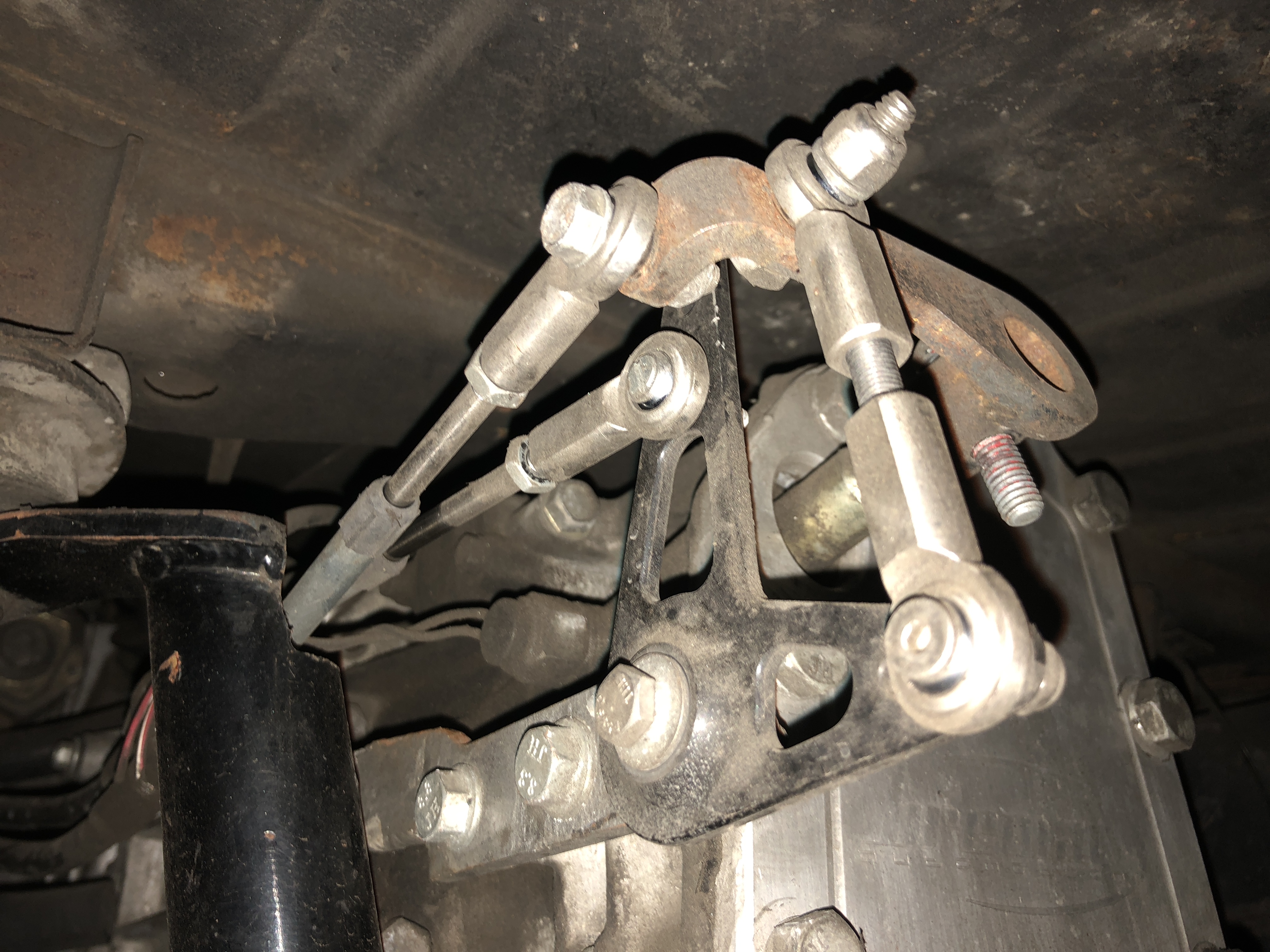

Ill post a pic when i get back home

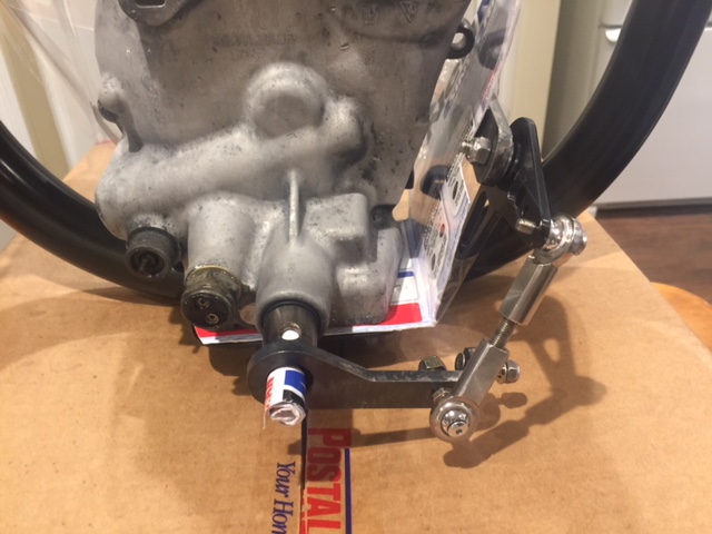

I think I got it. Pic on the net and trial and error. There were a couple different size bolts that could fit a couple places.
Mocking up the linkage to a 915 trans.

Wow never thought that was where this was going. Figured it was for your EG build. Hey that looks great. Presume you have one of these for the EG build also (IMG:style_emoticons/default/shades.gif)

This is the one for the suby build. I just wanted to see if it might work for the 915 before I start buying parts.

Alot of miles on this. (I do know im missing a nut, and I extended the cable mounting bracket to accommodate longer cables)
