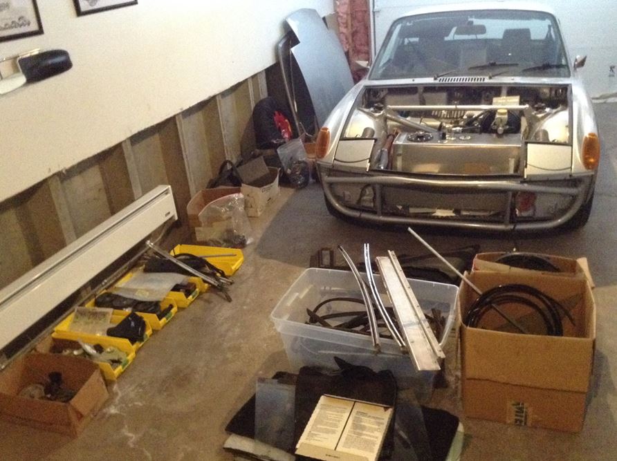

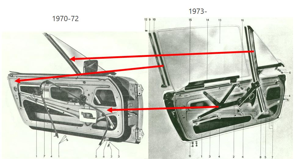

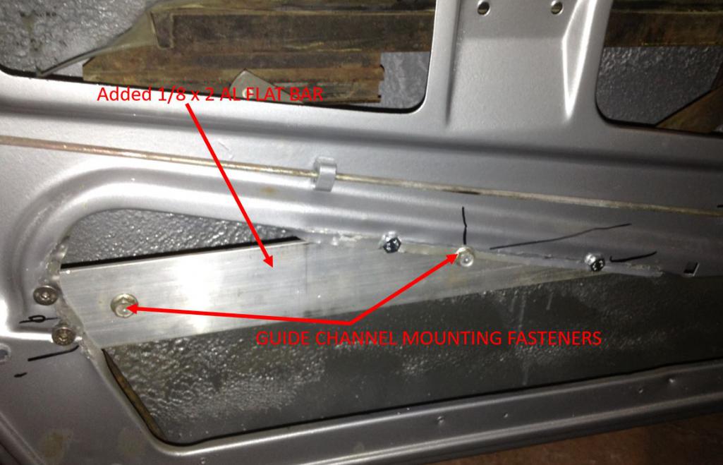

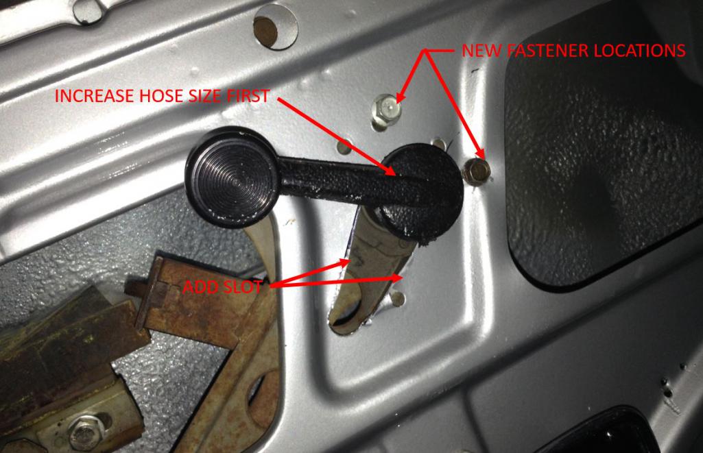

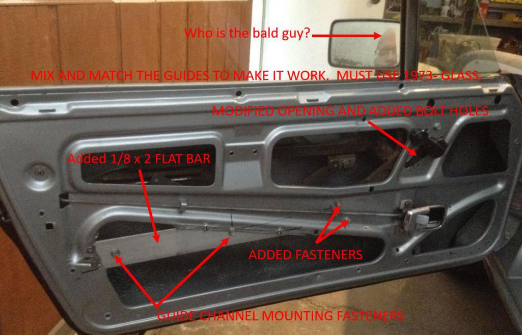

> Late model window regulator in an early door, I converted a 1972 door to use the scissor type window regulator.
914Subaru
post Jan 16 2018, 08:29 PM
Posts: 59
Joined: 19-October 08
From: Duluth, MN
Member No.: 9,667
Not pretty but it works. Definitely need a 73 or later donor door with a lot of trial and error to get it tol work.
1970-72 is a lighter door because it doesn’t have the side impact reinforcement.

The US requirement for adding the door beams began with cars built in '73 (maybe US only?)
So 1973 model year cars built from 9/72 thru 12/72 did not have the door beams but did have the later windows and regulators.
My car is a 9-72 build.
Its seems the only difference would be the inner panel that holds the window regulators.
It looks like the factory used the same outer door skins from the early doors and the late inner panels on the 9/72 - 12/72 then in 1/73 added the door beams to the outer skins.

I did a similar mod on my late 73. I used older doors and made 5 cut/slices to completely remove the old winding mechanisms structure and tigd in the new style structure.
