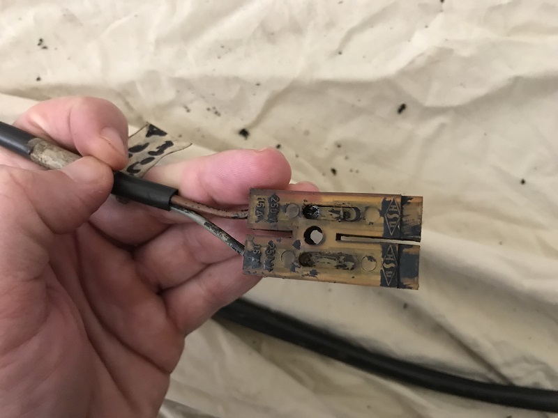

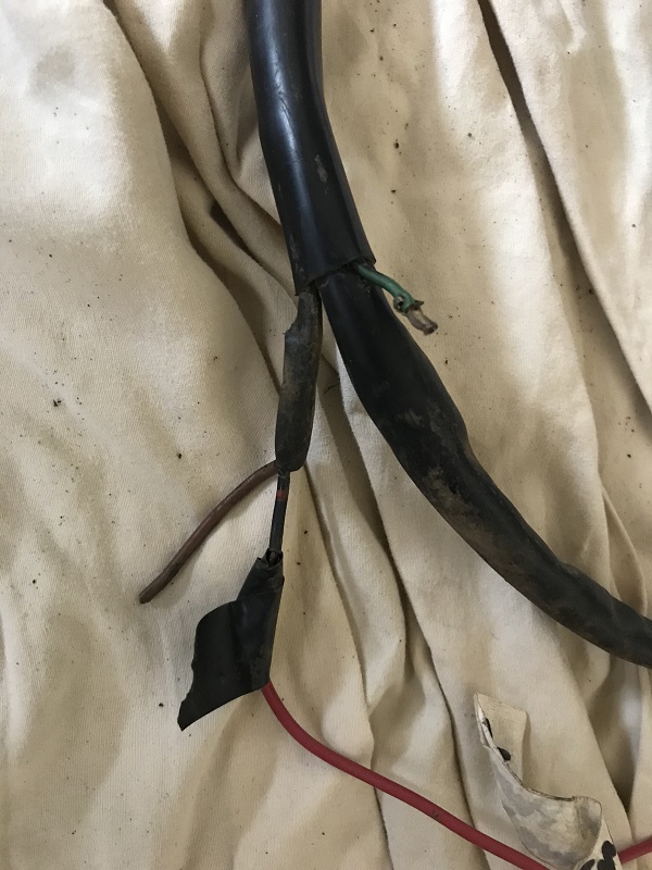

My main Winter project is to 'restore' the wiring harness on my 73. I admit that of all the jobs involved in restoring this car, this is the one that creates the most anxiety in me. I took it out of it's container last winter, spread it out on the floor, and promptly proceeded to put it back in the container. But, the time has come to conquer this thing. I have 4 rolls of wire tape that cost more to ship to me than the tape itself, and I think everything I need to do the job. I have pieces of a 74 harness (which I'm aware is not the same) and have already used one of the correct connectors from it for one of the license plate light connectors. Overall, I think the harness could be a lot worse, but there are some areas where POs have made some modifications/fixes and I'm not sure what they've done and why. I'll be asking for assistance from the wiring gurus in the thread as I work my way through. I have the wiring diagram from Jeff Bowlsby's website, a multimeter, PowerProbe3, and cleaning supplies. I'm removing all the tape, inspecting, cleaning, and then installing new tape. I'm just going to clean and inspect the rubber covered sheaths as they seem to be tight around the wires and it seems unlikely that there is anything wrong underneath them (on the upside, everything that ever worked on the car during my ownership, which wasn't everything that was supposed to, still did right before I removed the harness).
Okay, so with that introduction, my first questions. Starting at the back, I've worked my way through the license plate wires, to the trunk light wires, and I'm currently looking at the fuel pump wires. My car had vapor lock, so the fuel pump was relocated to the front of the car. The mechanic just cut the wires, left the ground wire dangling, and spliced in a positive wire which he ran through the firewall (poking a hole; no grommet), under the carpet and through a hole in the front firewall, where he then spliced in the connector and grounded to a screw he added to the front firewall. Here's a pic of the wires:
Because of the vapor lock issue, I'm thinking I should put my new pump in the front where the old one was (by the steering rack). I'm thinking of getting the NAPA Bosch fuel pump (N69133). From what I can tell looking at the wiring diagram, and I could be reading it wrong, the power wire goes to the 'regulator/relay plate). If it's source was at the fuse box under the dash I'd splice into the wire up there and put the original connector back on the wires in the engine bay (in case I ever wanted to put an original style in its original spot. If I'm correct about the wiring diagram, then, with my limited knowledge, I guess I have to run the power wire on the outside of the sheath (but at least it will be inside the new 914 rubber snorkel) and up to the fuel pump in the front? Is there any point in running the ground wire that way too, or would you just ground it to a screw on the car as it was before?
Also, in the pic above there is a green wire that looks like it had a connector on it at one time. Does anyone know what that was for? When I look at the 73 diagram it only shows the black with red dots and the ground for the fuel pump. On the diagram it shows the, IIRC, 'fan blower motor' having a green wire. However, if that's referring to the blower motor for the heater, I think the wires and connector below were for that (note no green wire).
So, to summarize, what's the best approach for the fuel pump wiring, and what is that green wire for?

cannot tell much from the pics but if it is a green wire with a black stripe and it is near the original fuel pump lead wires, it is for the optional oil temperature sensor. Original had a plastic housing around it and connected to another wire that was sheathed and led down to the bottom of the sump

Thanks George and Brent for identifying that green wire. So, based on what George said I should put a new spade connector with plastic housing on that and call it good.

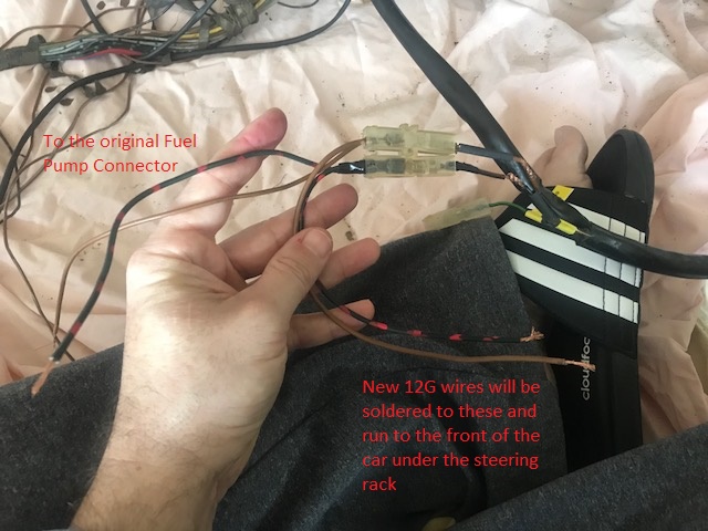

So, using my spare harness pieces, I found the matching wire and what I think would be the proper housing for the oil temp sensor and installed it (can be seen in the pic below, barely, sorry). I've also put together a plan for the fuel pump wiring. As you can see, I salvaged one of those double housings and the proper connectors. In the pic below everything is just mocked up. I'll solder the wires with the male spade connectors, then install the housing and use female spade connectors with double wires. The double is so I can bring the original fuel pump connector back from the farm and install it on one pair (in case I ever want to install a pump in the original location) and then the other pair will have 12G wires attached that will be run up to the front of the car. I'm doubtful about getting the pair of wires in the small sheath for these wires, but I think I can get them through the shorter piece of sheath that goes up the firewall and has the snorkel around it. Would the edges on a coat hanger be too sharp to push through the sheath for pulling the wires? Anyone see any problems with this plan?

A coat-hanger will poke through the snorkel. If you round the end carefully, it might not--not sure. The snorkel on my car has a couple of holes in it...
I wouldn't bother running the ground myself. A ground is a ground, so just running a wire to some fastener going solidly into the chassis should be fine. Or adding one of those Y connector things to an existing grounding lug.

(IMG:style_emoticons/default/agree.gif) Just route a brown wire from the new pump location whatever ground is easy and pleases you. Shorter is better anyway. On my car, there was a length of sheathing in the front trunk that was split and wrapped with ~1/2" wide vinyl electrical tape. I you want to run your wire through there and have trouble, you can just remove the tape, run the wire, then rewrap it and you'll never be able to tell you were in there. I bought some narrow tape on ebay, but I doubt you'd ever notice if you just used regular stuff.

The 1975-76 schematic indicates that the FP CIRCUIT runs from the 14 pin connector (pin 13) to the fuel pump and needs to be 12 gage, presumably due to the ampacity requirements for that condition. You are leaving half of that circuit as 16 gage, splicing on a 12 gage section. Seems to me that the 16 gage section will be subject to overload and is a fire hazard if it overheats.
Now I know we are going to hear the masses chime in and say they just ran 16 ga lamp cord to the front trunk with no problems. What would an EE's say if (s)he were to anlayze/engineer the loads/distance of that circuit?

Hmmm...So you're suggesting to pull the FP wire out of the 14 pin connector and add a 12G in it's place. Are those ends that fit in the 14 pin connector still available? I have a spare 14 pin connector with wires in it, is it possible to pull one of those ends off of a wire and crimp it onto my new wire?
Per Dave and Brent, I'll forego the ground and either connect directly to the chassis or find an existing ground close by.

You can reuse those pins. They are just soldered on. I unsoldered all of mine off the 14-pin connector just to make it easier to insall new sheathing. Just secure the pin somehow (I used a "helping hands" soldering station) and tug gently on the wire as you heat the pin with the soldering iron. When the solder melts, the wire will pop right out. Jut reverse to reinstall.
