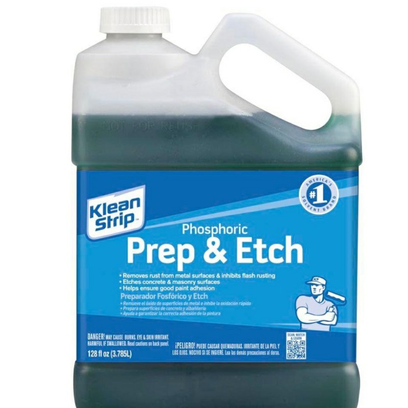

I agree. But instead of Ospho I am using this Home Depot stuff which is really affordable. Brush it on or spray bottle even. Several coats over a couple hours. Wire brush where you can reach. Goes black like rust converter. Rinse with water. Immediate compressed air to dry. Heat gun if you are concerned. Hit it with epoxy, acid etch prime, or Por 15 soon. Works for me anyways.

I'm using the Klean-Strip brand from home depot also. I wound up following this same procedure for the roll bar. Ospho equivalent, rinse, dry, Eastwood frame coating. I'll still follow up the Eastwood with cavity wax in any opening I can access after the welding is done. I agree it isn't necessary, but I've seen firsthand how well the wax works and the Eastwood stuff is still a bit of a question mark IMO. Belts and suspenders.
