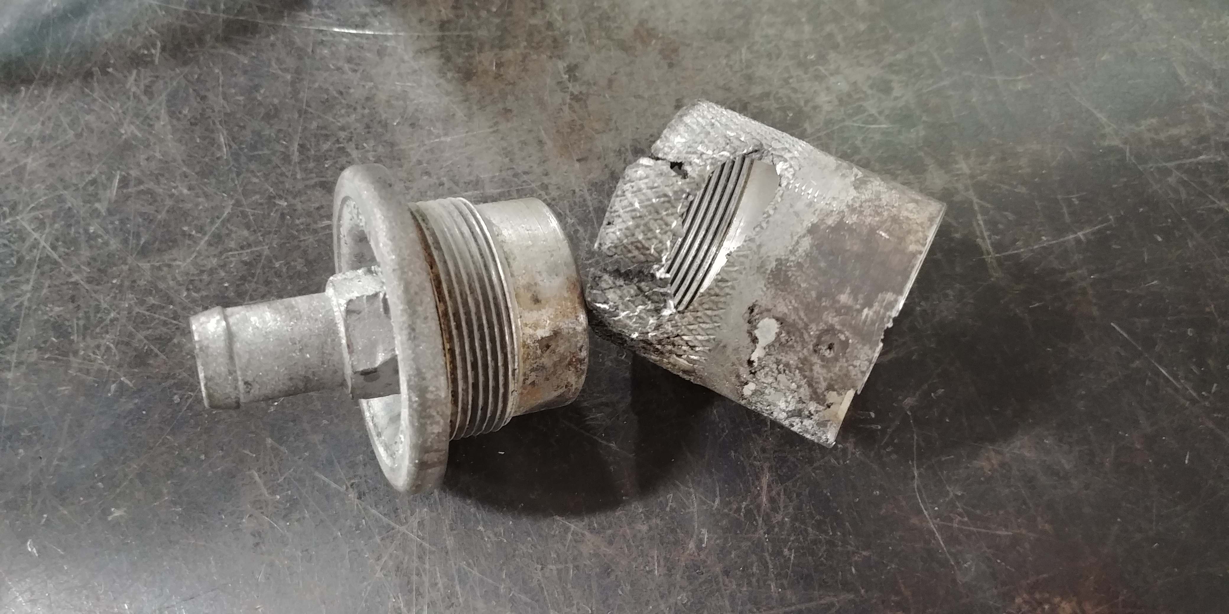

Unfortunately now a bit larger of a problem the ferrul that gets glued into the tank is trashed any ideas without replacing the whole tank?Attached Image

Not sure exactly what I'm looking at, but can you turn a threaded retainer with a wide bond surface and glue it to the tank exterior?
That may work the part to the right is /was bonded to the inside of the tank. May plans are to have a new part made if I can and glue it to the inside of the tank.. Or find someone whom has that fitting. At this point all options are on the table

As you have the later car with the plastic tank I would doubt you could bond a fitting back in there,a replacement tank would be a better option and shouldn't be expensive to buy used,I seem to remember they can be a bugger to change however never done that myself so don't really know.

'88 definitely has the plastic tank (all '85.5 and later). They are not crazy expensive, and not too hard to replace IIRC, especially if the trans is already out.

As far as fixing it your self. The only way I can think of doing it is building the section with the fitting, and plastic welding it into the existing tank. So build the panel and fitting first, then patch it into the tank or over the tank where the original came out. You could butt joint it, but why (IMG:style_emoticons/default/confused24.gif) your dealing with plastics here, as long as you have the clearance, just lap joint it, and be done. Like everything cleanliness makes or breaks the process.

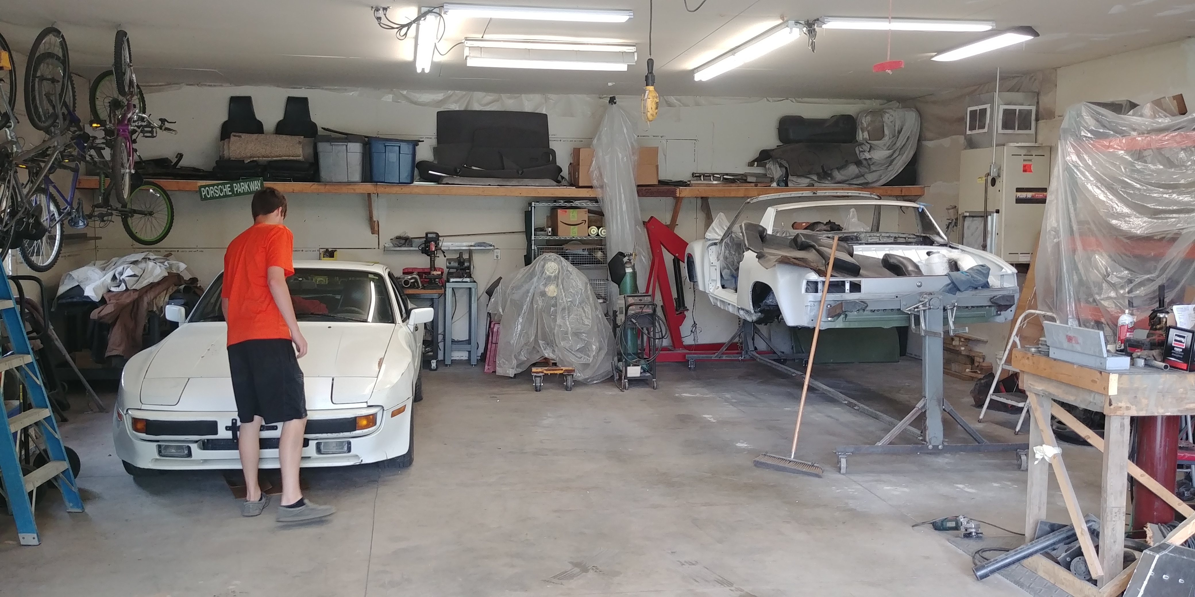

Transaxle back in after replacing the gas tank.
New reference, speed sensors, starter, brake pads, fuel hoses, and a score on an extra set of wheels though we still need 4 tires that actually hold air..
We took it for a short drive down the driveway.. Everything works. So 10 years of sitting it is now alive. Still need to change plugs and wires and bleed the entire brake system and timing belt..

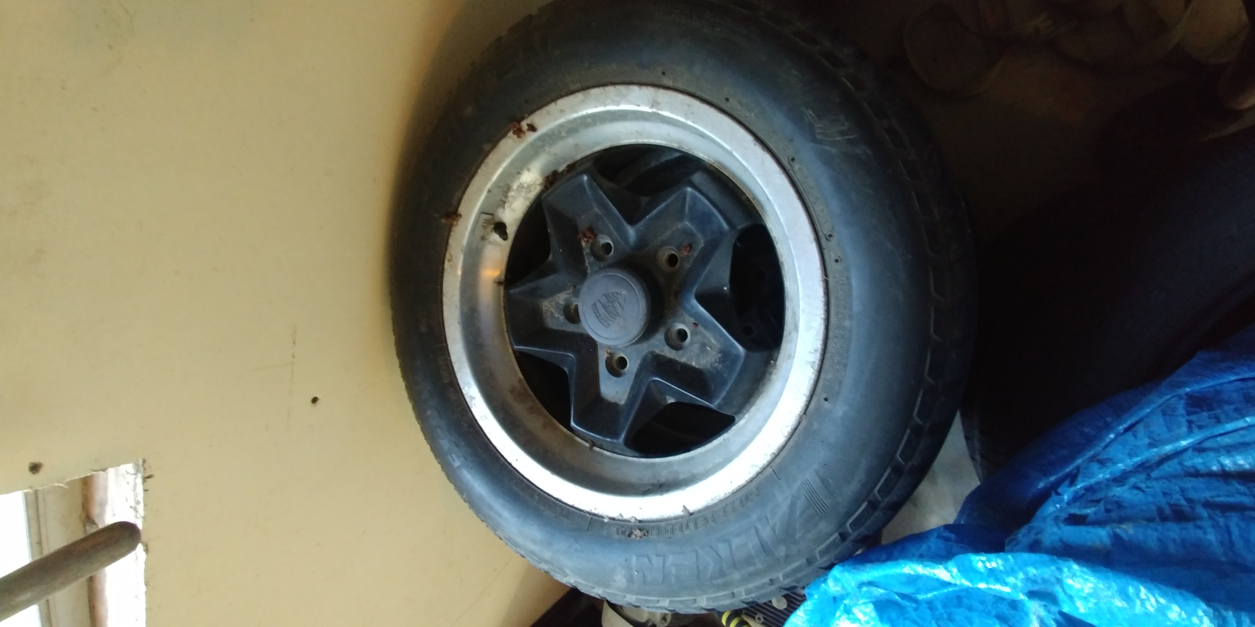

Sand blasted 2 of the wheels this week to prep for powdercoat. We are going to paint the wheels that came with the car black and see how they look..
