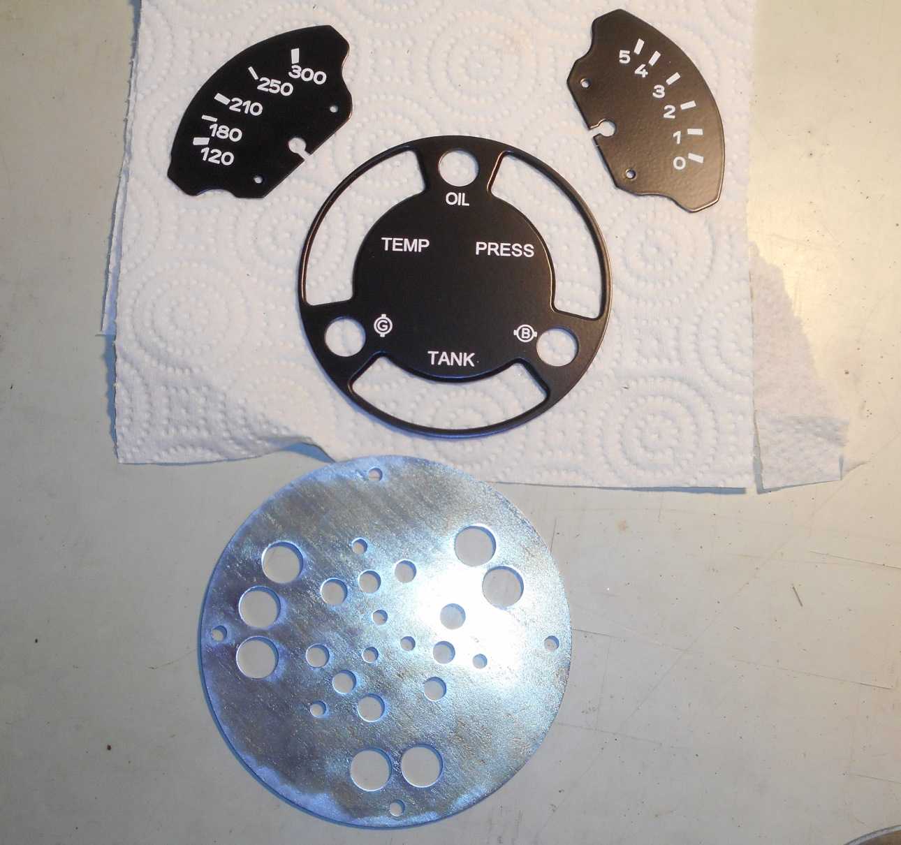

Anyway here is what we got:
Started with the dies from an earlier attempt. Smooth out the old and mill the new
I bought a rotating table and the mill for this project. Well and other things too
First step was making the clamps.
I also made a punch so the I can start with the holes for lights and maintain registration
That gives me this:
Ready to press. I spent a lot of time setting things up for a pin router to cut out the gauge windows, but that didn't work out. So I have the dies and the sheet ready to form.

worn   From there it is a matter of opening the window se...   Mar 28 2018, 10:59 AM
worn   So now it is a matter of assembly. I decided to ...   Mar 28 2018, 11:05 AM
worn   The light guides hold the face off the gauges, and...   Mar 28 2018, 11:40 AM

worn   Well, closing in on the first one that will go int...   Apr 3 2018, 10:02 AM
gereed75   Very well done! What did you ultimately use f...   Apr 3 2018, 10:14 AM
worn   Very well done! What did you ultimately use ...   Apr 3 2018, 06:29 PM

worn   More progress - I am feeling better. Still not a ...   Apr 13 2018, 10:02 AM
