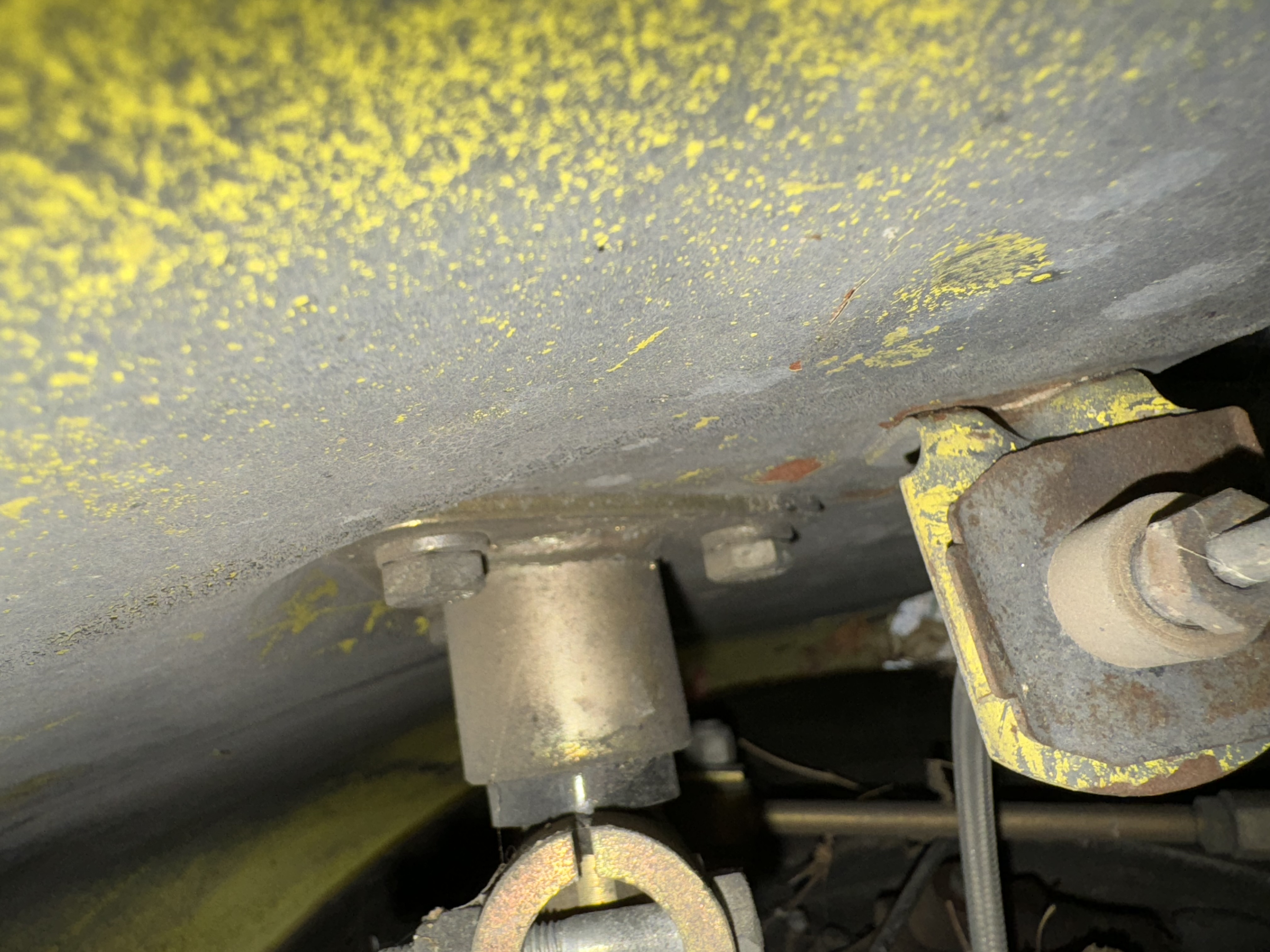

QUOTE(Lucky9146 @ Apr 20 2018, 08:52 PM) *
This sway bar here
My driver side looks like this
And my passenger side looks like this
Seems to be some room on either side of the bushing cup totaling abut 1.75 in. for the bar to wander off to one side as mine did. (IMG:style_emoticons/default/confused24.gif)
You can weigh in here on go to my thread page 31 http://www.914world.com/bbs2/index.php?showtopic=261197
Thanks!
(IMG:style_emoticons/default/white914.jpg)
It looks like you have the arms clamped too far out. I’ve seen some use a spacer and a washer between the cotter pin and the arms. But mine have not moved.
