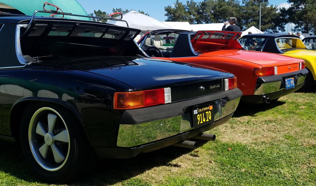

QUOTE(majkos1 @ May 24 2018, 09:43 AM) *
I Love my Traid!
I also modified a FG Rear Valance to "Hide' the muffler.
Also noticeable difference in performance .
Sounds Great too !! (IMG:style_emoticons/default/aktion035.gif)
I like what you did with that valance, I have something similar in mind.

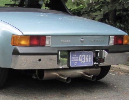

troth
post May 24 2018, 04:46 PM
Post #25
Posts: 160
Joined: 17-August 16
From: CT/WA
Member No.: 20,305
QUOTE(troth @ May 24 2018, 07:09 AM) *
I’ll post pics and dimensions after work today. Looks good, but more importantly sounds great. (IMG:style_emoticons/default/wub.gif)
Here's an old vid of this muffler Chris Foley did for me. With the valves properly adjusted, it sounds even better. I think those are 1.5" OD pipes spaced by 11 or 11.5" center to center (can't remember exactly).
Damn, video's not working. Trying to figure it out.
Maybe now it’s good? (IMG:style_emoticons/default/confused24.gif)

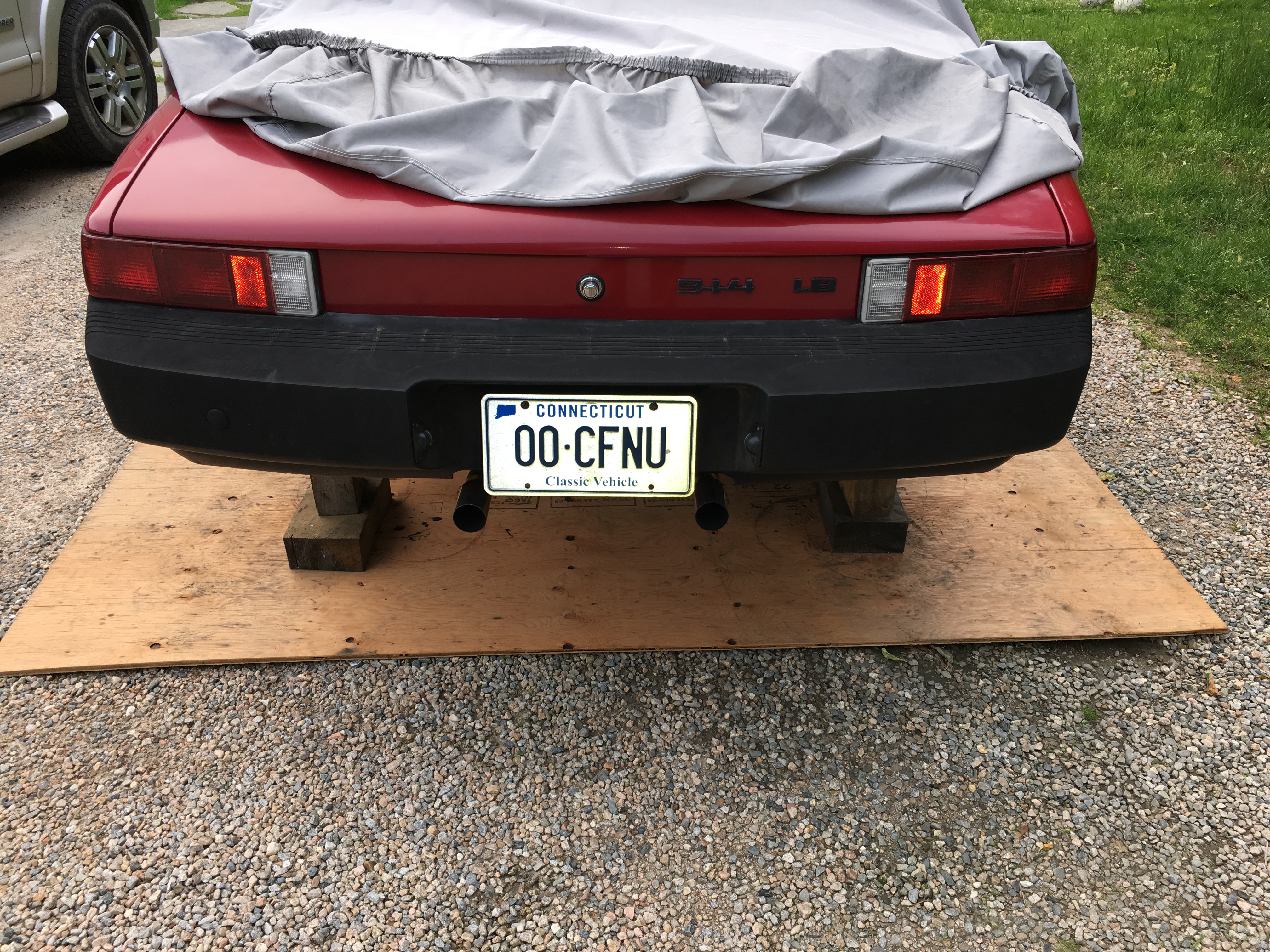

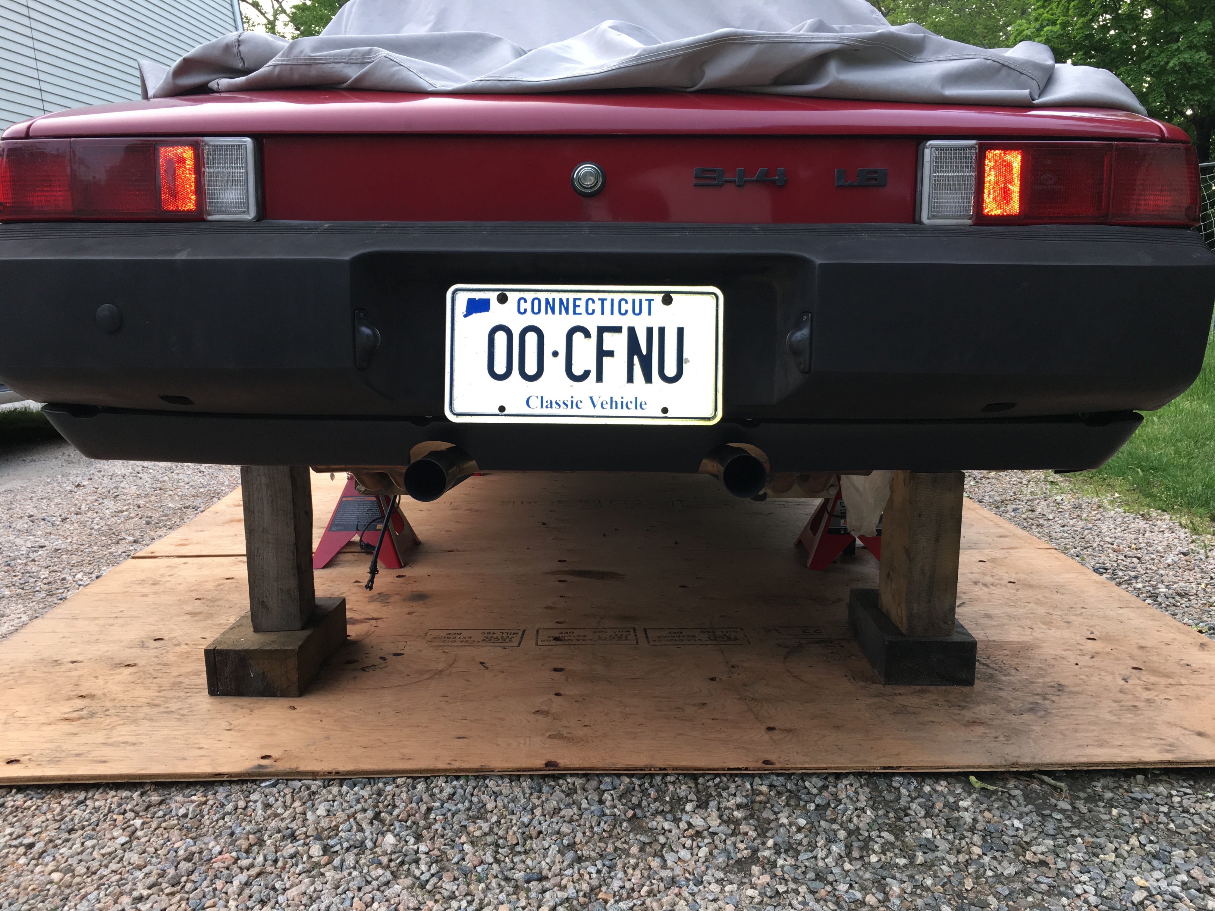

troth
post May 24 2018, 04:59 PM
Post #26
Posts: 160
From: CT/WA
Member No.: 20,305
And here’s a pic with the valence.
troth
post May 24 2018, 05:00 PM
Post #27
Posts: 160
From: CT/WA
Member No.: 20,305
One more.

majkos1
post May 25 2018, 07:32 AM
Post #37
Posts: 266
Joined: 11-August 17
From: Mile High 914
Member No.: 21,338
QUOTE(Dougster @ May 24 2018, 11:38 AM) *
I Love my Traid!
Thanks!
It was my first time working with FG.
It started out getting Hole sawed,
Notch out between two holes,
Put in screen for reinforcement....
Trim around exhaust .
