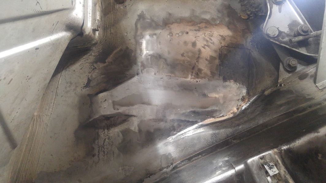

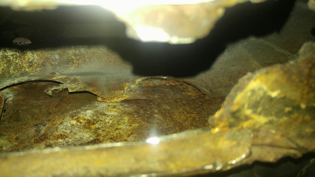

And a little view of the jack point repair. They cut through the backer part way up, which is kinda scary. However, they used plate steel for the repair and it was definitely strong.

Wow travis you are flying man. I've still got your spare sitting in my office at work. LOL! One of these days I'm going to stop tripping over it & put it in a box. That replacement panel looks great man. As does your patch for the hell hole. Keep it up man

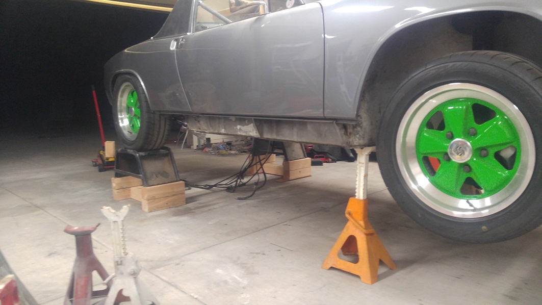

Been sidetracked for a few days. Battery tray patch in the sidewall. I took the car off the jackstands, I had to do some funky shimming of the jack stands to get the chassis level. Plus I need to figure out a plan to support the car while I start cutting into the longs.

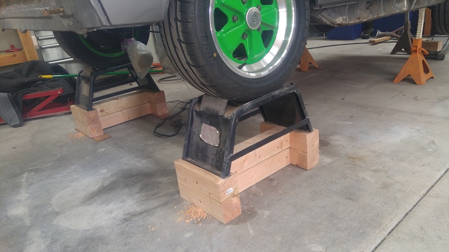

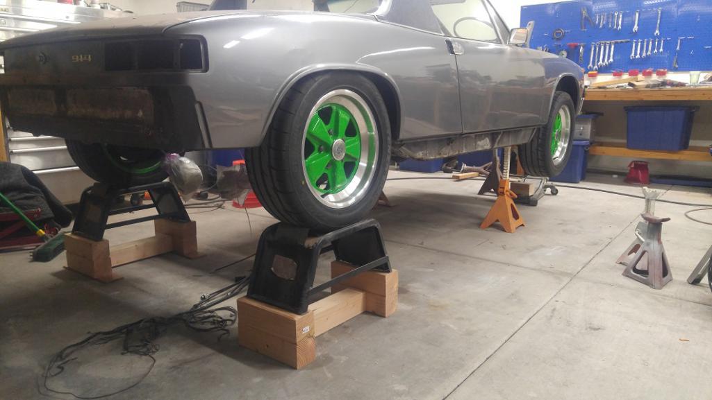

I found my floor has a slope side to side at about 3/8 of an inch. If I use some left over 3/8 bamboo flooring on the drivers side it gets me level side to side.
For the back I used a couple 4x4 screwed together and then screwed the ramp stands to it in the back. I dont have any more ramp stands for the front, so I used jack stands at the forward lift points and then a single jack stand at the front trunk floor.
Its mostly level, I need to drop the drivers side rear coilover a 1/4 of an inch or so. I will do that tomorrow.
What do you all think?

(IMG:style_emoticons/default/agree.gif) that should work (IMG:style_emoticons/default/welder.gif) (IMG:style_emoticons/default/sawzall-smiley.gif) (IMG:style_emoticons/default/smash.gif) (IMG:style_emoticons/default/welder.gif)

Nice looking car and all the work looks good. But those jack stands.... that looks dangerous to me. I would like to see something more secure or at least some redundant support if you are going to be getting under that thing. There are some horror stories about failed jack stands.
Go forward but be safe.

I’m a chicken shit. I would never work under a car set up like that. Be careful about putting torque on a fastener.

Travis I would screw a bunch of 2z4s in a stack to do it, then shim the bottoms with metal plate.
Easy and sturdy

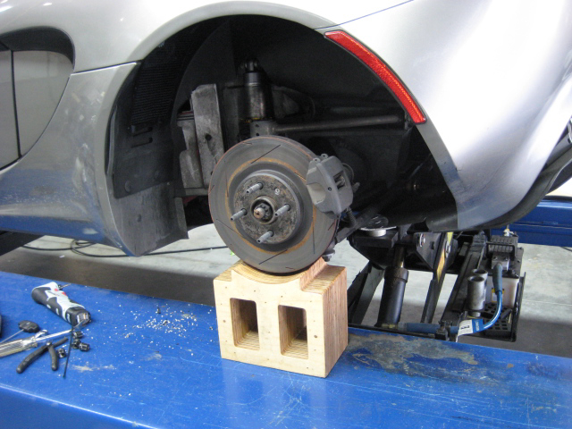

This seemed to work also, but not sure I would trust my rotor to hold the car up (IMG:style_emoticons/default/blink.gif)

I'll take a look at adding a 4x4 as a 2nd i-beam. Again they each rear is now one piece as the wood is screwed together and the ramp is screwed to the wood.

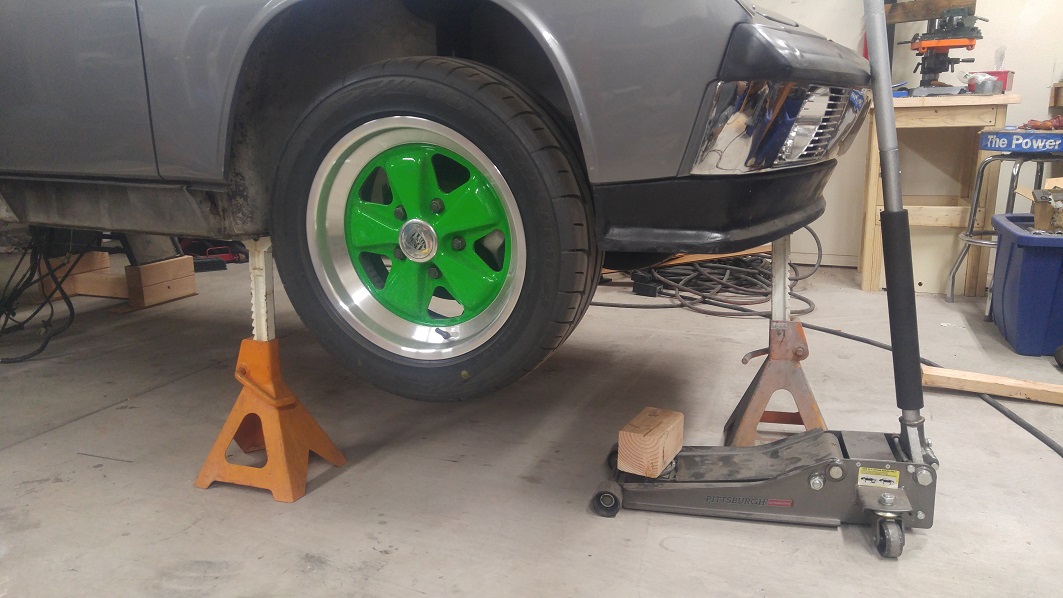

Yes the front is pretty far up there. I think I will take off the front wheels and stack them under the front for insurance. The 2x4 route looks good but I can't get the car much higher than it is. I would need to go up another 8 inches or a foot

Thanks for all the input so far, I appreciate the feedback. I added a 2nd 4x4 to the I-beam and went a little screw crazy on the new and existing wood. It's not going anywhere.
Still thinking about what to do for extra support/insurance for the front. I have the jack stands oriented 90 degrees from one another so it does not rock on the same plane.
