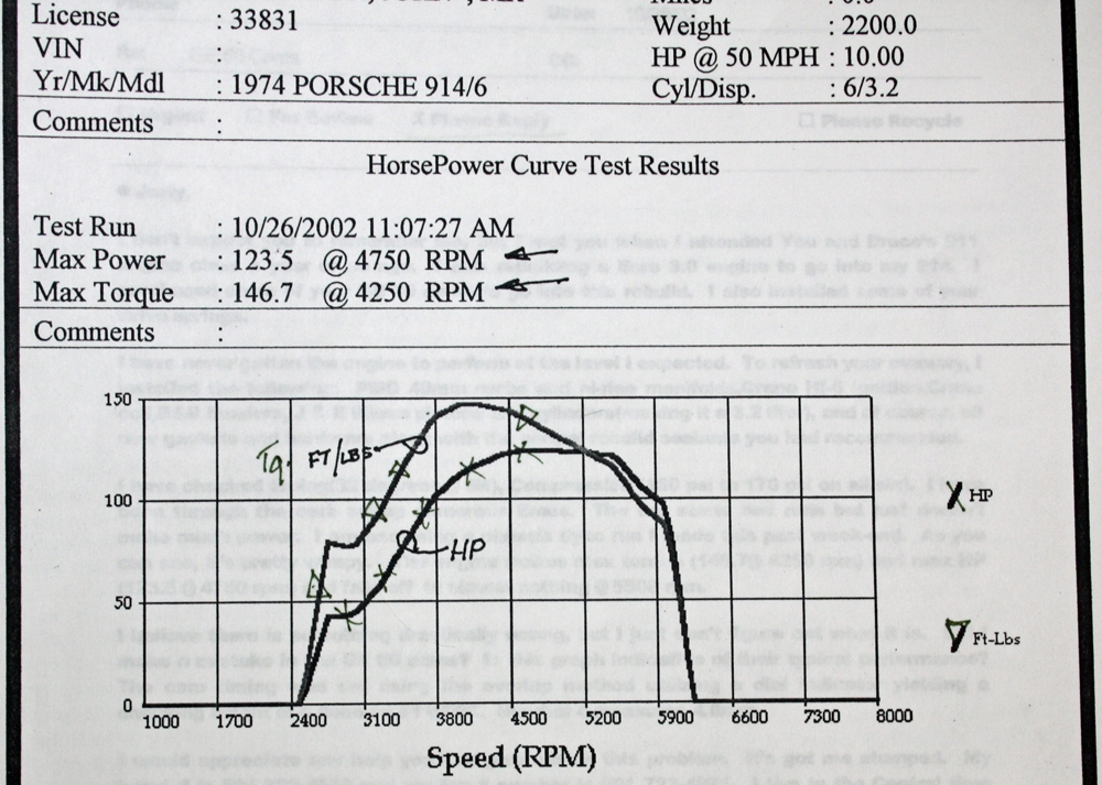

This prompted Cody and John to begin looking at the overall health of the motor. They had done a leakdown test prior to installing the motor and it was good. They decided they should do a compression test. Cody got about 120 and John read about 130 on each of their respective compression testers. As their gauges were far from new, they each decided to order a new compression tester from Snap-On so they could check it again. This was on Monday a week ago. The gauges were to come in on Wednesday.
The car had come with a large box of records which I had gone through nearly a year ago when I first got the car. John and Cody's issues with spitting and not having the power they thought the engine should have sounded familiar. I dug through the records and found some documents showing that the original builder of the motor had these very same issues. Below is a letter from him to Ed Mayo in Dallas concerning these issues along with a dyno report showing only 125hp at the wheels. Also below is the bill from Ed Mayo outlining some of the things he found. None of these were going to restore lots of power but, evidently, made it better.
(IMG:http://www.914world.com/bbs2/uploads_offsite/i188.photobucket.com-22140-1558835713.1.jpg)
(IMG:http://www.914world.com/bbs2/uploads_offsite/i188.photobucket.com-22140-1558835714.2.jpg)
(IMG:http://www.914world.com/bbs2/uploads_offsite/i188.photobucket.com-22140-1558835714.3.jpg)
I had some business to take care of near John's shop so I headed there with these documents. Upon reading them, John thanked me for bringing them as there were going out of their minds trying to tune the car. Shortly, the Snap-On truck arrived and John immediately did a compression test. The new gauge showed 135. John commented that not only was it low but the way it moved the needle on the gauge was telling. Normally it jumps to the reading where here it was a somewhat gradual climb. He said it should be at least 150 and that his race motors will typically be 180.

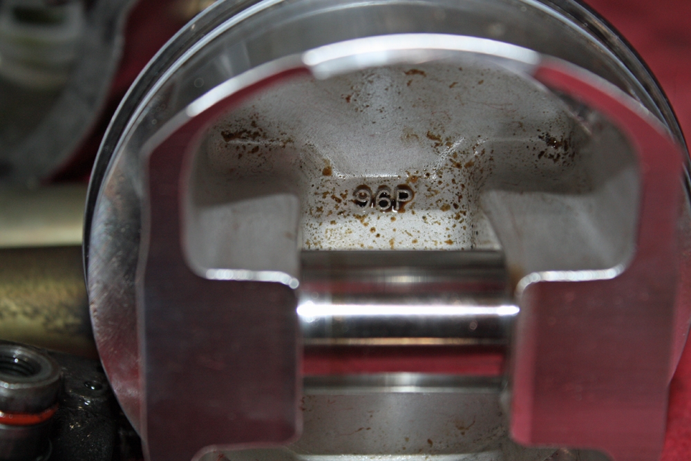

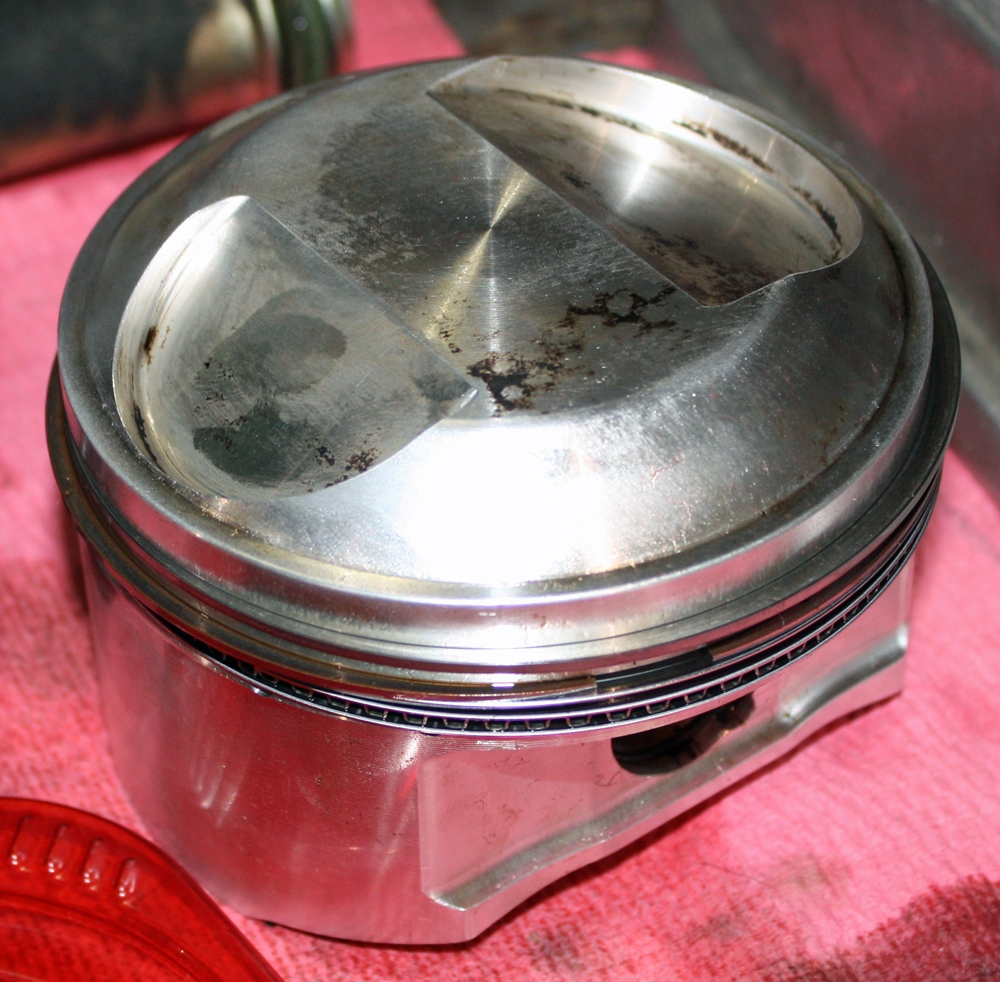

John's best guess was that the car had the wrong pistons. I told him to do whatever he had to do to find out what was wrong. Cody and he were taking their 30's Ford roadster with a flathead V8 to a big car show in Maggie Valley, NC last weekend. so nothing happened on the motor until this week. John called me on Thursday to tell me that he was right about the pistons.

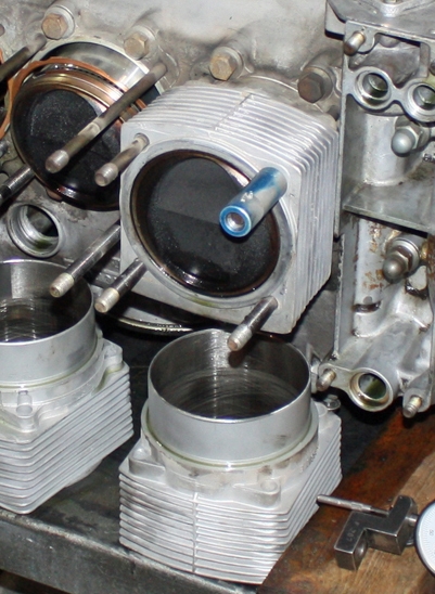

I drove over there Friday morning to give John some more money and to see what he had found. It is a little out of focus in the photo below but, when at top dead center, the piston is not flush with the top edge of the cylinder. It's not off my much but enough to make a big difference.
(IMG:http://www.914world.com/bbs2/uploads_offsite/i188.photobucket.com-22140-1558835714.4.jpg)

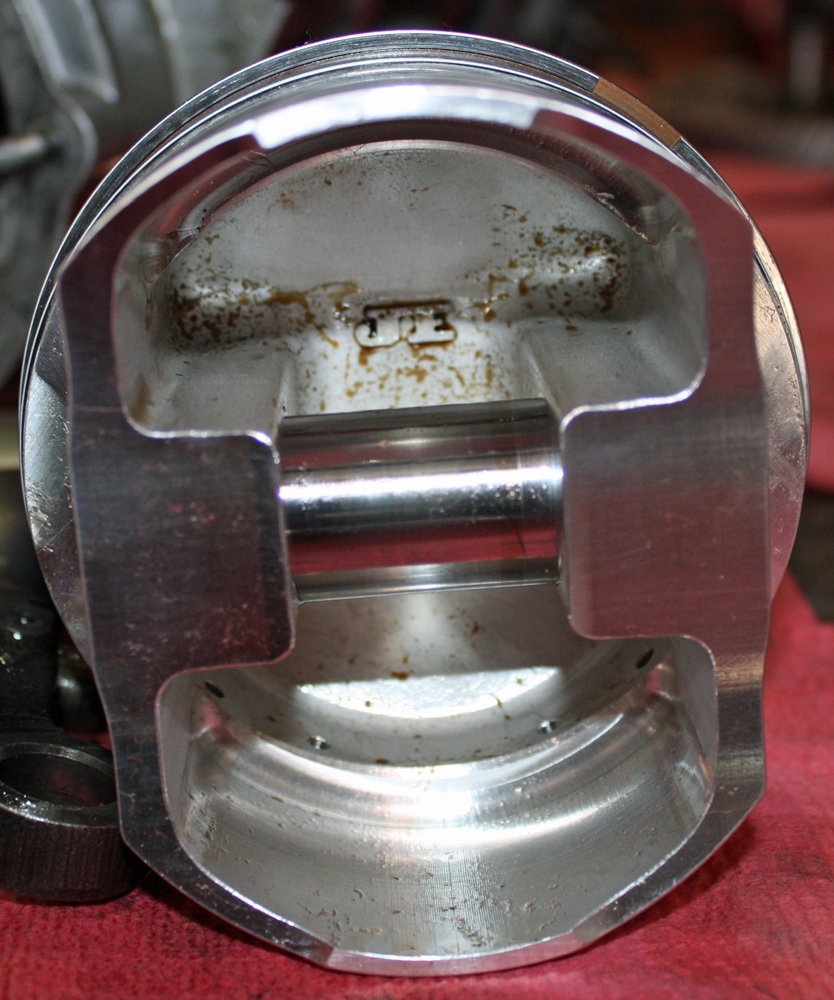

The pistons are J&E marked 96P. They are in excellent shape as were the rings, which explains why the leakdown test was good.
(IMG:http://www.914world.com/bbs2/uploads_offsite/i188.photobucket.com-22140-1558835715.5.jpg)
(IMG:http://www.914world.com/bbs2/uploads_offsite/i188.photobucket.com-22140-1558835715.6.jpg)
John talked to J&E about these pistons. The engine had been running very rich with the carburetors and they wanted to see one of the pistons cleaned up so they could check for numbers. There were no other numbers besides the 96P. One their current pistons there are numbers showing when it was made and other tracking information. Evidently they were not doing this back in 2002.
(IMG:http://www.914world.com/bbs2/uploads_offsite/i188.photobucket.com-22140-1558835716.7.jpg)
The cylinders looked great with the crosshatching still showing. The guy who had this car redone back in 2002 also built the motor. He had attended a class put on by Bruce Anderson and Jerry Woods and then built the motor. I believe it was his first attempt. John found some other disturbing items. One was the lack of a spacer on the chain sprocket at the chain tensioner on the right side. John had not had this side apart previously as my boo boo was on the other side. The first photo below shows what it looked like before they took it apart. The other photos show a spacer, from John's inventory, in place. John said that on the later cars the sprocket assembly was different with the part being built in such a way that no spacer was needed. John didn't recall this issue on the other side as would have noticed it.

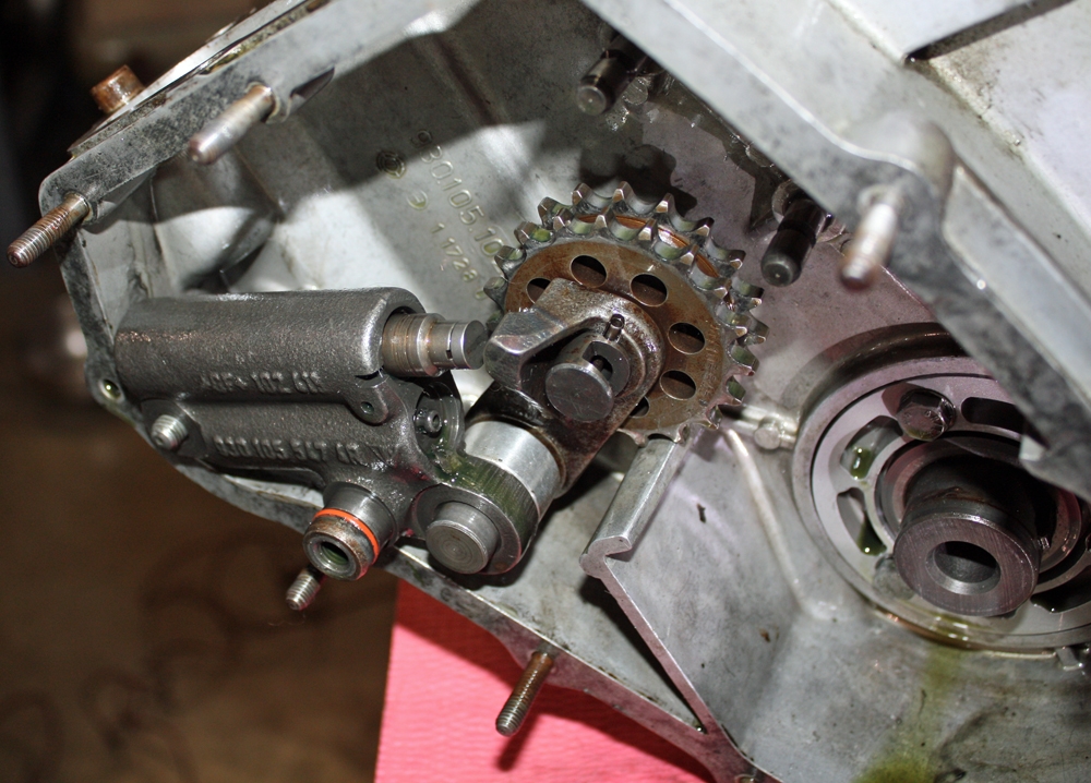

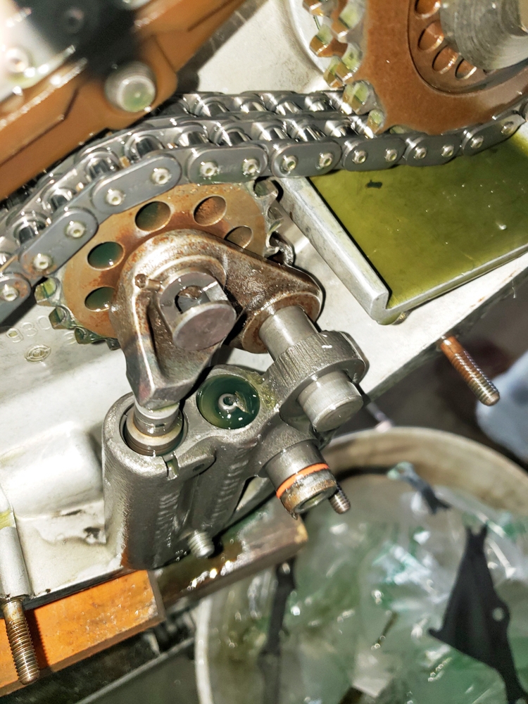

There was also an issue with the chain guides as there were five of one type and one of the other instead of them being evenly divided with uppers and lowers.
The rod bolts were stock but John said he would have used competition bolts and nuts on a motor putting out the power this one should. He also found the use of crush washers where wave washers should have been used. Because of all of these issues, he said the case should come apart so they can check everything. And that is where we are at today.

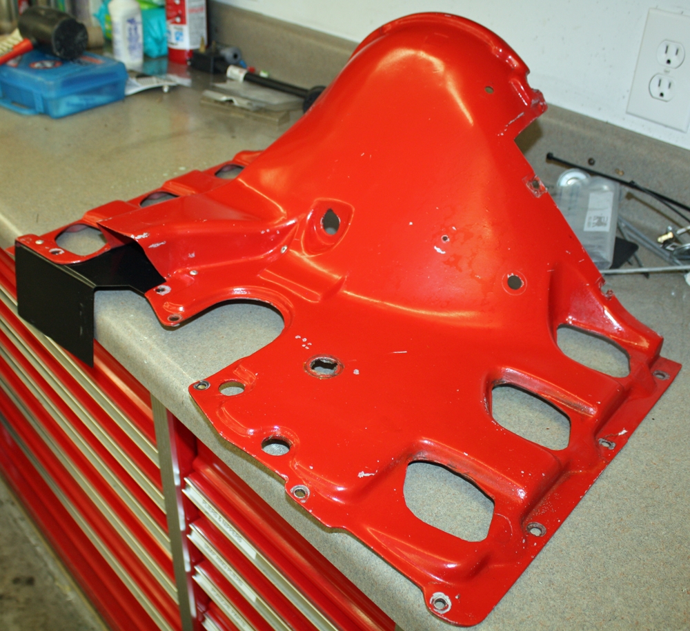

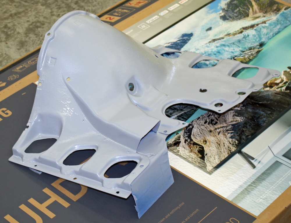

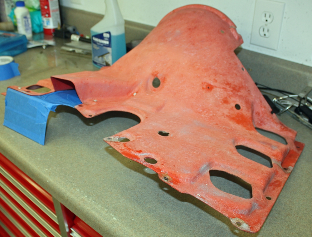

While I was at the shop, I took the fan shroud with me. It has some paint issues that I had not addressed as I didn't want to tear down the motor to the extent needed to remove the shroud. I bought some very mild plastic bead for my bead blaster, turned down the air pressure and removed the old paint. After cleaning everything, I hit it with some primer. I will do a bit of sanding on that and then add the color coat.
(IMG:http://www.914world.com/bbs2/uploads_offsite/i188.photobucket.com-22140-1558836203.1.jpg)
(IMG:http://www.914world.com/bbs2/uploads_offsite/i188.photobucket.com-22140-1558836204.2.jpg)
(IMG:http://www.914world.com/bbs2/uploads_offsite/i188.photobucket.com-22140-1558836205.3.jpg)
(IMG:http://www.914world.com/bbs2/uploads_offsite/i188.photobucket.com-22140-1558836205.4.jpg)

Sorry to hear about your troubles.. One note I thought I would point out is the chain ramps should be 5 of 1 type and 1 of the other.. So 5 black and 1 Brown..

I'm no engine builder but the sprocket spacing is important. It has to be measured and adjusted until correct. And like John said, rarely do you use a stock rod bolt on a high performance engine. That engine should have 200+ rear wheel hp. I'm sure John will make it right.

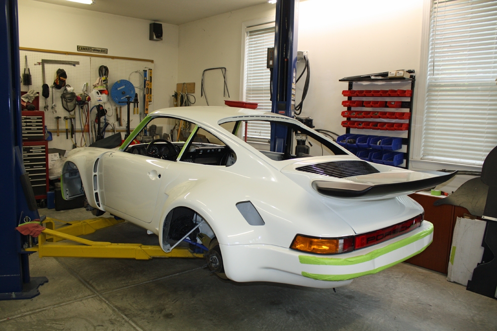

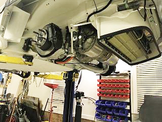

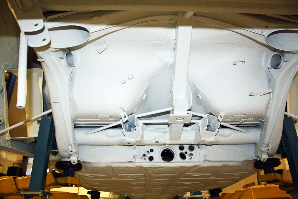

On the good news side, my son's car arrived at his house from the body shop. Adam, from Backyard Legends in Concord, NC, delivered it in his closed trailer. Adam has prepared cars for Amelia and does fantastic work. The paint quality cannot be seen in photos. It has to be seen in person. The complete bottom and the engine and trunk bays are painted with a matching color bedliner material.
Last summer Hendrick Porsche of Charlotte hosted a 70th birthday party for Porsche. Numerous cars were on display with one of them being a RSR that Adam had recently completed in a stunning orange.
(IMG:http://www.914world.com/bbs2/uploads_offsite/i188.photobucket.com-22140-1558839331.1.jpg)

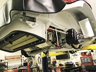

I struck up a conversation with Adam and told him about Matt's project putting the Tesla motor into a 1979 911. He was interested from the get go and said he wanted to be involved with the car. I put him and Matt together and the result is stunning. The first photo below shows the car as Matt bought it. It was a roller that had been flooded during Katrina. Matt had some rust repair to do before he could begin modifying it for the Tesla motor installation.
(IMG:http://www.914world.com/bbs2/uploads_offsite/i188.photobucket.com-22140-1558839332.2.jpg)
(IMG:http://www.914world.com/bbs2/uploads_offsite/i188.photobucket.com-22140-1558839333.3.jpg)
(IMG:http://www.914world.com/bbs2/uploads_offsite/i188.photobucket.com-22140-1558839333.4.jpg)
(IMG:http://www.914world.com/bbs2/uploads_offsite/i188.photobucket.com-22140-1558839333.5.jpg)
(IMG:http://www.914world.com/bbs2/uploads_offsite/i188.photobucket.com-22140-1558839334.6.jpg)
(IMG:http://www.914world.com/bbs2/uploads_offsite/i188.photobucket.com-22140-1558839334.7.jpg)
(IMG:http://www.914world.com/bbs2/uploads_offsite/i188.photobucket.com-22140-1558839334.8.jpg)
(IMG:http://www.914world.com/bbs2/uploads_offsite/i188.photobucket.com-22140-1558839335.9.jpg)
(IMG:http://www.914world.com/bbs2/uploads_offsite/i188.photobucket.com-22140-1558839335.10.jpg)

QUOTE(mb911 @ May 25 2019, 10:20 PM) *
I may have misunderstood John and have what he told me reversed. I am surely no expert on building a 911 engine. That's why John has the car.

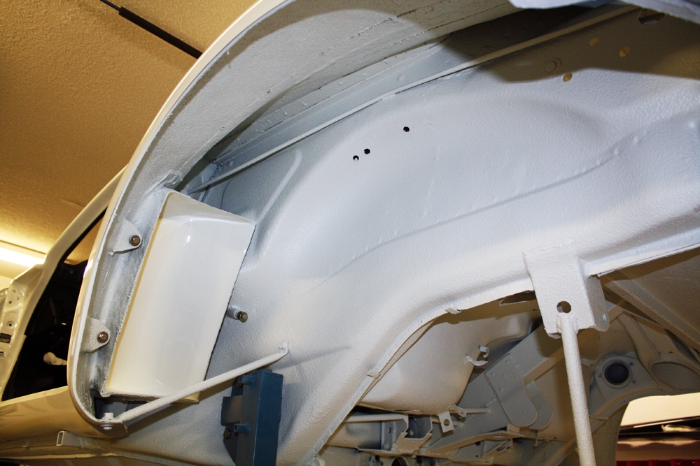

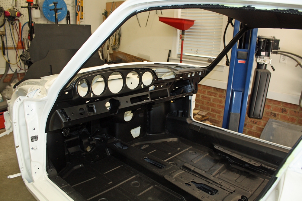

As I mentioned, Matt got the car back Saturday morning. We spent the afternoon seam sealing some of the panels he had added. I had to leave around four but a neighbor came over to visit that evening and helped Matt get the suspension on. He had Monday off for Memorial Day so he had two good days to work on it. Besides the suspension, the batteries, the motor and half the wring harness are now back in the car!!
(IMG:http://www.914world.com/bbs2/uploads_offsite/i188.photobucket.com-22140-1559094349.1.jpg)
(IMG:http://www.914world.com/bbs2/uploads_offsite/i188.photobucket.com-22140-1559094349.2.jpg)

After working with the shroud, I decided it needed a fresh coat of gelcoat. I have it at a boat company to have that done. They are busy so I am at their mercy.
About seven years ago, I did a full body-off restoration on a '64 Corvette coupe. I did that entire project in nine months. And that was with me breaking my wrist about two months into the project resulting in my not being able to work on it for about six weeks. This 914 has been my most frustrating project to date. Everything is taking longer than I expected it to. One of these days it will be finished.

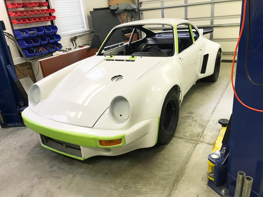

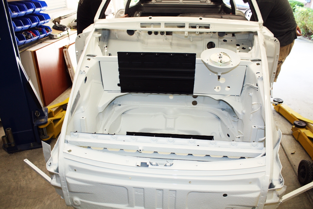

On the other hand, my son's 911 Tesla project is moving right along. He has it mostly complete. On Sunday the body shop guy came to Matt's house and we installed the doors, bumpers, hood, and deck lid. It looks fantastic!!
(IMG:http://www.914world.com/bbs2/uploads_offsite/i188.photobucket.com-22140-1560374381.1.jpg)
(IMG:http://www.914world.com/bbs2/uploads_offsite/i188.photobucket.com-22140-1560374382.2.jpg)
(IMG:http://www.914world.com/bbs2/uploads_offsite/i188.photobucket.com-22140-1560374382.3.jpg)

I would wager a guess that those pistons are big bore for a 3.2, not a 3.0 the rod length (from the pauter site) indicates a 3.0 rod is 127mm and a 3.2 is 127.8mm so the piston pin height I would assume would be higher, making the piston sit lower in the cylinder. But that is just a guess, I am no engine builder.

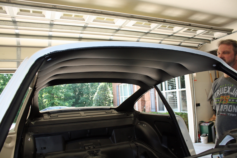

On the plus side, my son's car made its debut today at the Charlotte Cars and Cappuccino. And it was a huge hit. A local outlaw Porsche builder wanted to know if Matt would build more cars like his as this guy thinks he could sell them. The number he threw out was $150K. Some friends of mine were there and were duly impressed. I was a proud father. I actually talked to more people about the car than my son did as he is a reluctant public speaker. Having spent most of my career in sales, being a reluctant speaker is not one of my traits!!
(IMG:https://i188.photobucket.com/albums/z76/jerhofer/1979%20Porsche%20911%20Tesla/7-21-19%20911%20Tesla%207_zpshfgemi4j.jpg)
(IMG:https://i188.photobucket.com/albums/z76/jerhofer/1979%20Porsche%20911%20Tesla/7-21-19%20911%20Tesla%205_zpsyxtms7ol.jpg)
(IMG:https://i188.photobucket.com/albums/z76/jerhofer/1979%20Porsche%20911%20Tesla/7-21-19%20911%20Tesla%203_zpsiqprgxcx.jpg)
(IMG:https://i188.photobucket.com/albums/z76/jerhofer/1979%20Porsche%20911%20Tesla/7-21-19%20911%20Tesla%206_zpsilx5lsgk.jpg)

I'm sure it was a hit. It looks very "finished". Most electric cars don't. Congrats to both of you. I hope we can meet up next time I'm in Charlotte.
