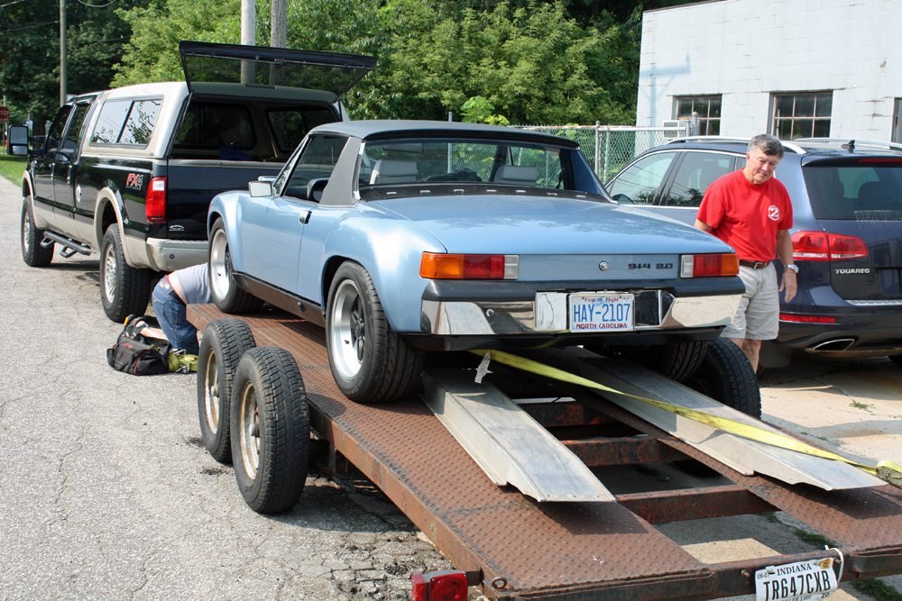

My good friend Dave and I both turned 75 abut three weeks apart this spring. One of Dave's two sons bought four tickets to the vintage races at Road America and rented a four bedroom house. They asked me to be the fourth person. As you can imagine, I said yes to that proposition. That all happened this past weekend and we had a great time. We also bumped into our old friend Ben whom we had not seen for some time.

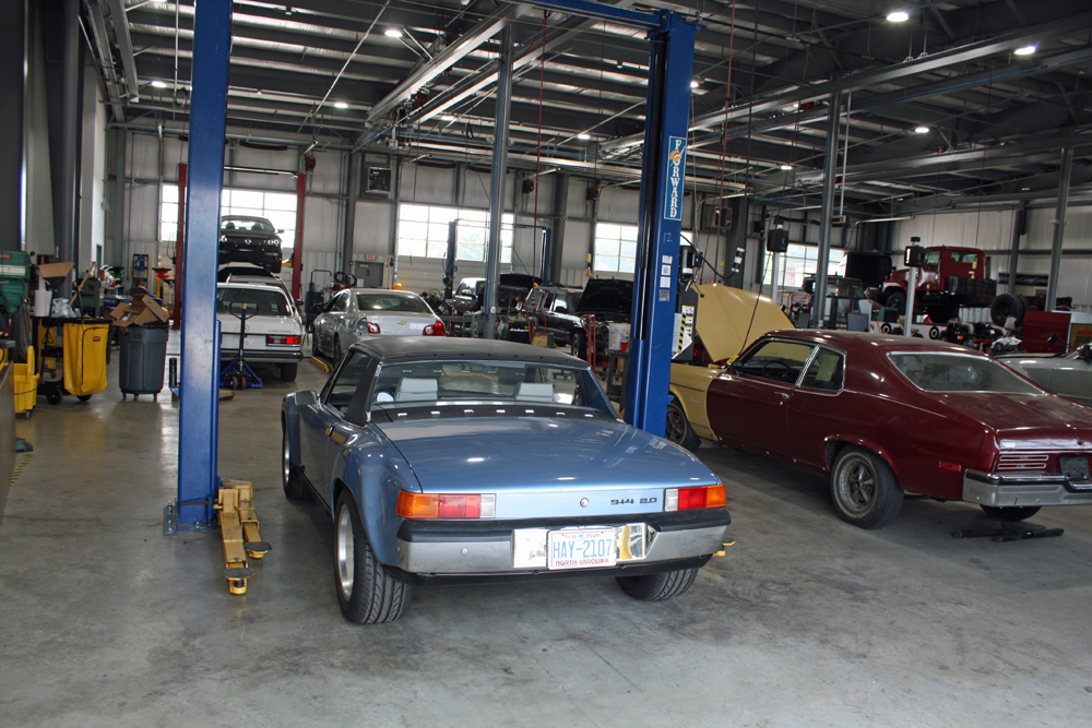

After accepting, I called Marty to let him know I would be in Indiana and wondered how he was coming on the motor and if I could be of assistance while I am there. He said he was close on the motor and that I should bring work clothes.
This morning we picked up the car from my friend Harry's building and took it to the Elkhart Career Center. I hooked up the alternator and installed the other shroud wiring. Marty then did the cam timing. We are meeting tomorrow morning to button up the motor and may put it in the car if all goes well. Progress!!

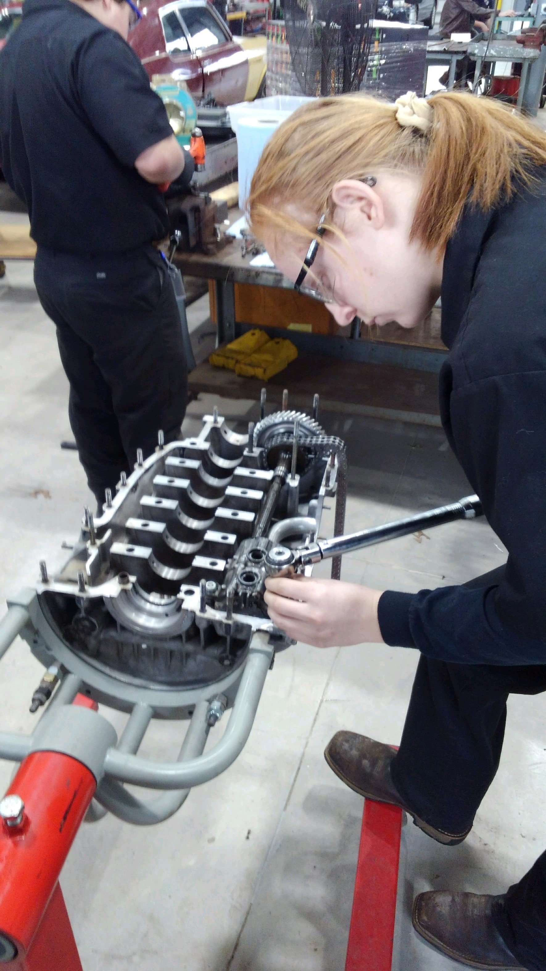

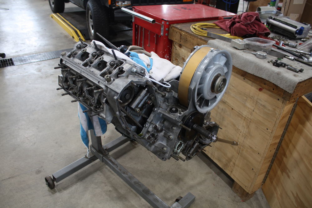

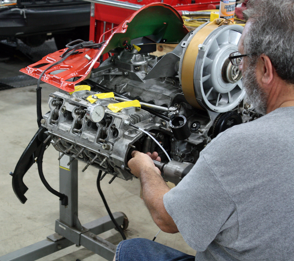

We have the engine all buttoned up. We were about to remove it from the engine stand when we noticed the pilot bearing was missing from the flywheel. It must have been knocked out when the flywheel was removed at John's shop. I needed to get back to NC. Marty is ordering one. His students will be there in a couple weeks and he will have them help him with the grunt work of attaching the tranny and installing everything in the car.
My wife's mother passed last December and, because of Covid, we did not have a service. Sharon's sister has organized a memorial on Labor Day weekend. We will be traveling to Indiana in the motorhome so I will be able to check everything out then. Hopefully, it will be running. But, if the past three years have taught me anything, it is to not assume!!

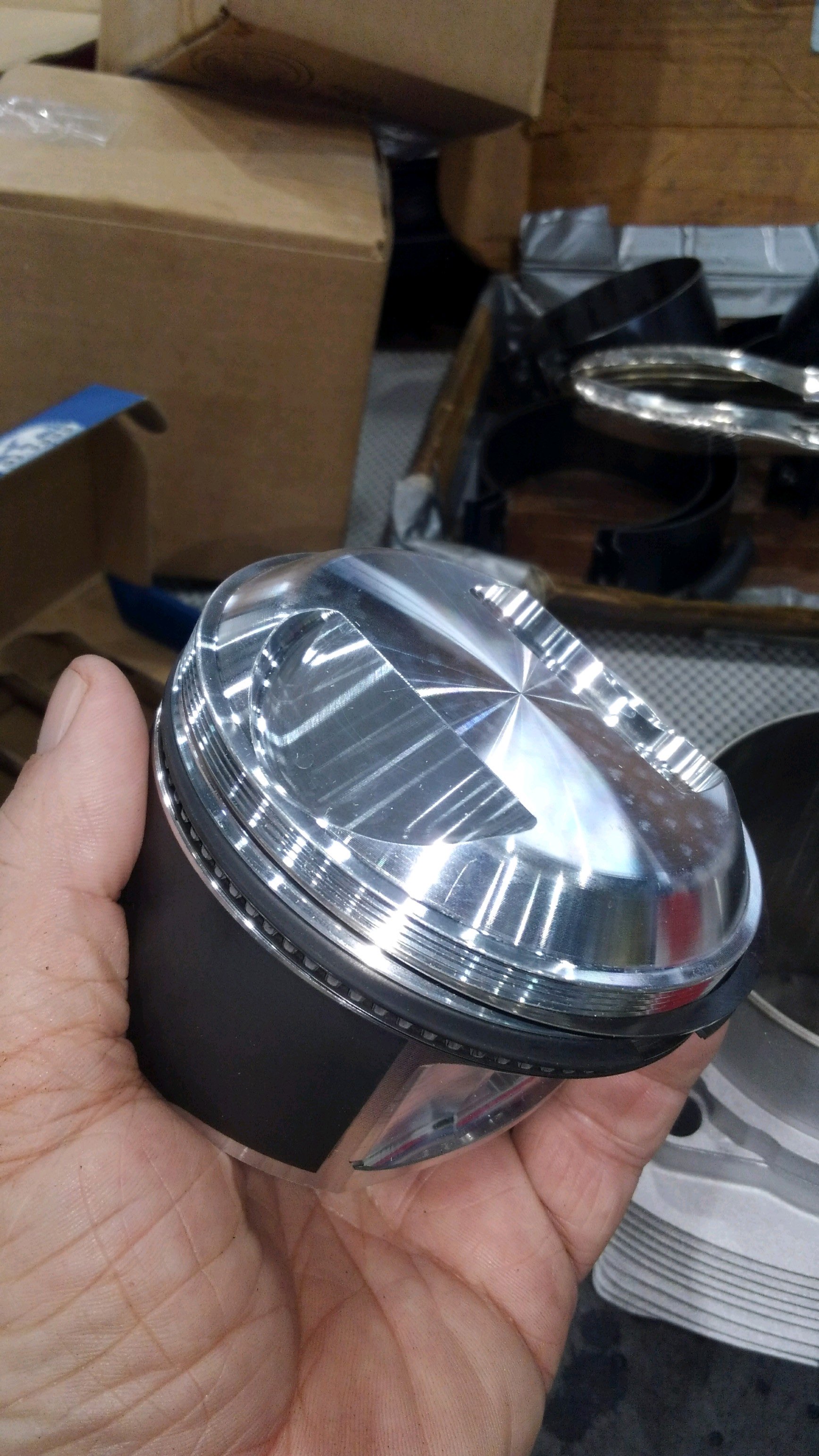

These are some photos taken when the motor was apart by Marty.

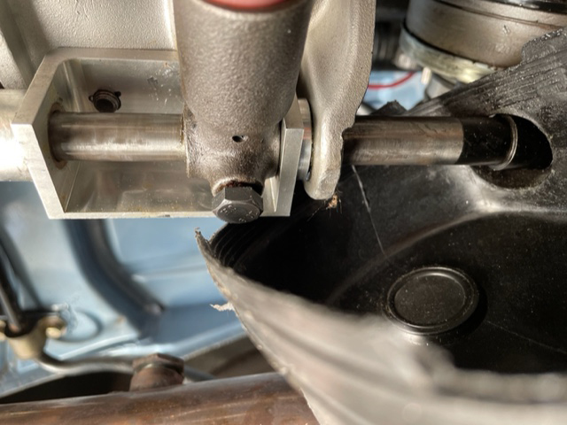

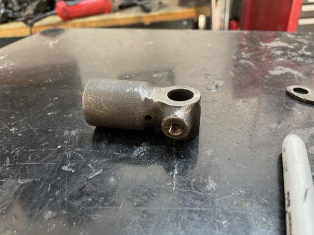

Matt, with the help of son Garrett (who just graduated with his bachelor's in computer science), have been fine tuning the car. When I installed the jWest shifter and rods (three years ago, believe it or not), I was having a problem engaging all the gears. I could adjust it to get third but not fifth or I could get fifth but not third. John Forbes worked on this as well but he also had the same issues. So he yanked the jWest gear out and installed a stock shifter...and still had the same problem!! Upon further investigation, he discovered that I had used too long a seat belt bolt on the inner belt for the passenger seat. The shift rod was hitting the bolt, thus impeding the throw. The jWest shifter never made it back into the car at that time.
Fast forward to the past week when Matt has finally been able to drive the car. The shifter was beyond terrible. Matt discovered a defective bushing. When that helped but was still not what he was looking for, he went over to my house and picked up the jWest shifter assembly. After receiving one bushing that had gone missing, he got the shifter installed...and was still having the third/fifth gear issues. He solved it be taking some metal of the bottom of the shifter so he would have more throw. Now it is staying engaged in all gears and is shifting about as well as a 914 can shift!!

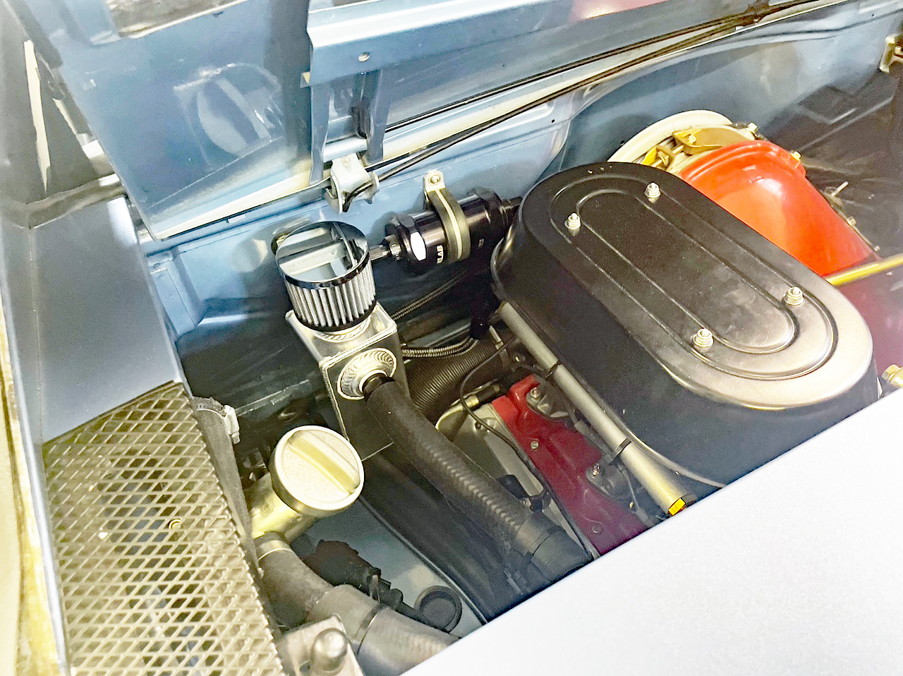

Matt said the engine was getting some blow by so he installed a puke tank.
