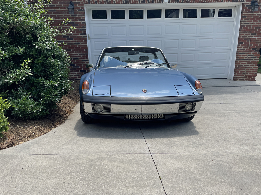

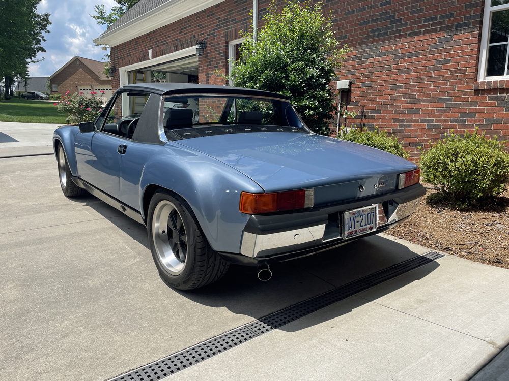

Car looks amazing! (IMG:style_emoticons/default/beerchug.gif)

Indeed- that is a great shot. (IMG:style_emoticons/default/beerchug.gif)

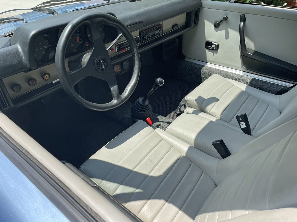

There is a company in Cornelius, NC called Sonderwerks who, among other things, does a fantastic job with Porsche interiors. Matt will be taking the car to him soon to see what can be done. Dave does really good work. He has branched out into bodywork as well. The guy who runs his body shop is the same guy who painted Matt's 911 Tesla. Adam has painted cars to show at Amelia so he is very good. If the 914 ever needs some paintwork, Matt knows where to take it.

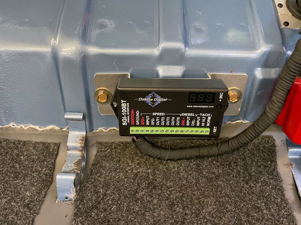

Matt had not been able to get the tach to work. He suspects that the CPU tach amplifier is not working. He called Richard Clewett about it and discovered that Electromotive is trying to sell their business and is not doing any service work on their equipment. So, getting the CPU fixed was not an option.
After doing some research, he ordered a Dakota Digital signal interface. He tapped into one of the coil wires that had a five volt output. Now the tach works perfectly.
We changed the oil today and then took a short ride. It is running great. Matt has a sport exhaust on order which will be the next project.
