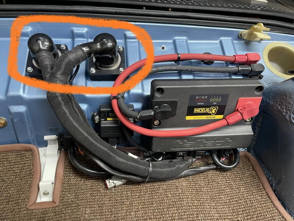

jerhofer   I wasn't happy with the front trunk junction b...   Sep 16 2018, 01:30 PM

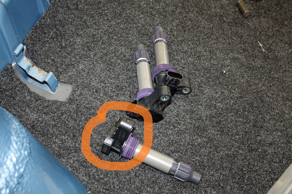

jerhofer   I worked on the power harness wiring for the EFI t...   Sep 26 2018, 06:40 PM
jerhofer   First thing this morning I received a text message...   Sep 27 2018, 05:01 PM
jerhofer   Now I could finish up the fuel pump wiring. I use...   Sep 27 2018, 05:13 PM
